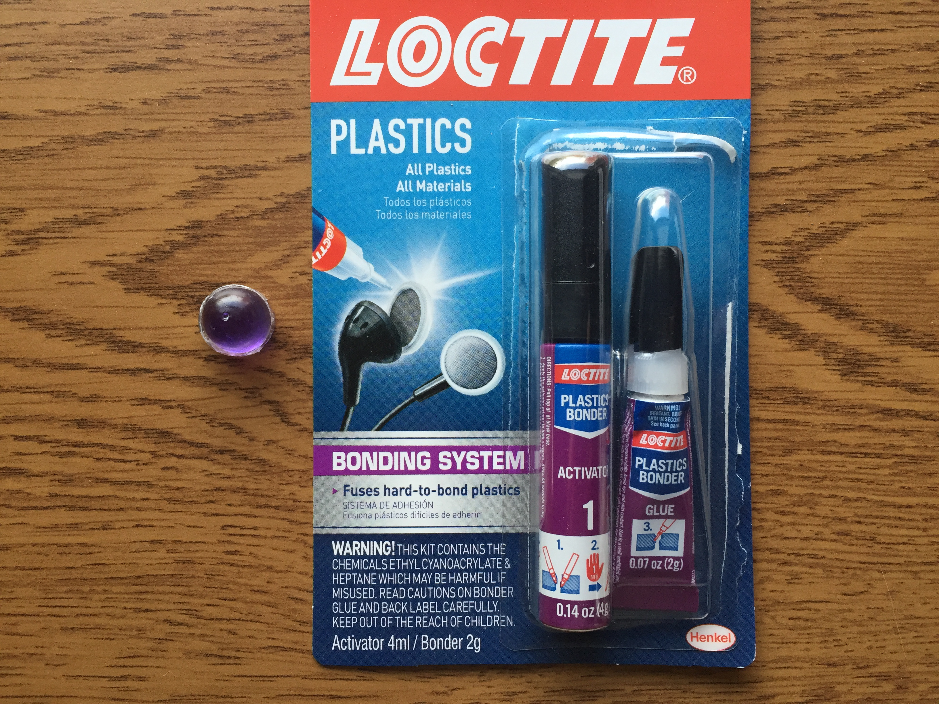

And the two-part epoxy also did not hold to the polycarbonate button caps (besides also yellowing after a week), so next I'm going to try Loctite Plastic Bonding System which I have a lot of leftover from another project.

Regarding the resin buttons (a PITA some plastics are to work with - the epoxy ended up not adhering permanently either), I've found an adhesive that permanently bonds the resin domes to the polycarbonate switch covers:
There is no separating the two without busting one of them. The bad news is, the bond is instantaneous, so each dome will need to be positioned EXACTLY centered on its cap with the first go - there are no re-do's. (Out of the 150 resin buttons I received, it was quite the challenge finding 6 without casting defects, roughly the same height, in the colors that I want. Poor product quality. So there are no spare domes if one of them goes awry.)
