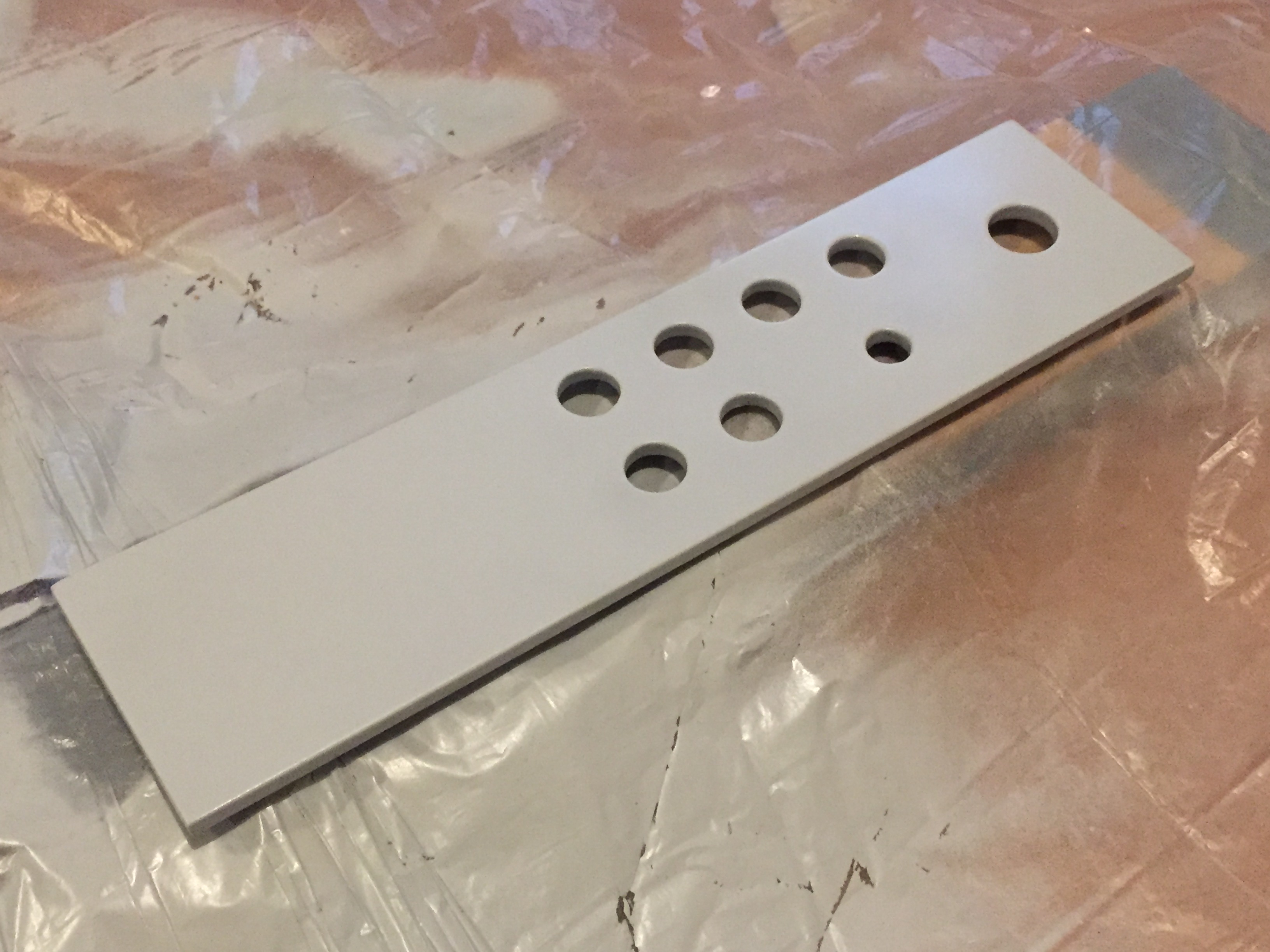

It is MDF, with a primer coat, sealer primer, then another primer coat, then the gray color coat, and everything is fine up to that point - no cracking. It is the satin clear coat that is cracking up when applied over the gray paint, same painting conditions as when applying the gray paint. It is cracking all over the board, I simply photographed the same area. I had no problems with the cabinet and the backsides of the door and buttons face, it's just the front sides of these last two pieces that will just not take the clear coat as all the other surfaces did. They are sanded down again and drying in the house near a furnace vent for applying gray paint again tomorrow.
The green areas crack, the red areas don't crack. This may be coincidence based on limited sample size. ;)

Are they all the same type of paint though? When you look on the cans under "cleanup" does it say to use paint thinner/mineral spirits or lacquer thinner/acetone? If they're not all the same then that is most likely your culprit, especially if that last coat is lacquer and the rest are enamel. Been bitten by that one a few times myself.
EDIT: I notice in your previous photos that you were using Duplicolor primers, which are definitely lacquer, and the Krylon paint, at least, is enamel. Even if the clear is enamel, clear coats run a little "hotter", i.e. more solvent, so I'm betting that's what's going on. As for why it's wrinkling in specific spots, that could just be that one of the finishes has been sanded thinner in those areas or there's more of something that the clear is reacting with.
There is cracking in the red marked area of the second image, along the edge.
Primer = Dupli-Color Automotive 2 in 1 Hi-Build Primer
There is no indication anywhere on the can of what base type it is (annoying that so many manufacturers omit this information from their products), and there are no cleanup instructions either. Had to go to the Dupli-Color web site product information page to confirm that this is indeed lacquer primer. There is also a Dupli-Color Sealer Primer applied, which is also lacquer based.
Gray = Krylon Gloss Pewter Gray
Again, the manufacturer felt no need to indicate anywhere on the can what base type it is, but at least this one does say to use mineral spirits for cleanup. The Lowe's web site specifies this as an acrylic paint.
Clear = Krylon Satin Crystal Clear
Again, no bloody paint type mentioned on the can, but cleanup is specified as mineral spirits. This is also indicated to be an acrylic paint at the Lowe's web site.
All the surfaces have been prepped and painted the same way, and none of them have had any problems except the outside/front faces of the door and buttons panel. The backsides of these two parts came out as clean as the cabinet box. Gray has been re-applied this morning, and I'm doing a second coat of gray this afternoon. It will get a few days to cure before trying the clear coat again.
Well, today's gray color coat cracked all up so I'm sanding it back down to wood and will use either a Krylon primer, or no primer. What should have taken just a few days to paint is now in its second month.
My guess is that automotive paint is enamel, and therefore that you are mixing enamel and acrylic.
The Dupli-Color paint is stated as lacquer on their web site. I'm going to try a different paint.
Good call. It has to be some interaction between the paints.
If lacquer is solvent based, and acrylic is water based, then the lacquer undercoat with it's solvent may be eating up the above coats of acrylic paint. Really, even if that didn't seem likely, it still seems to be the only explanation.

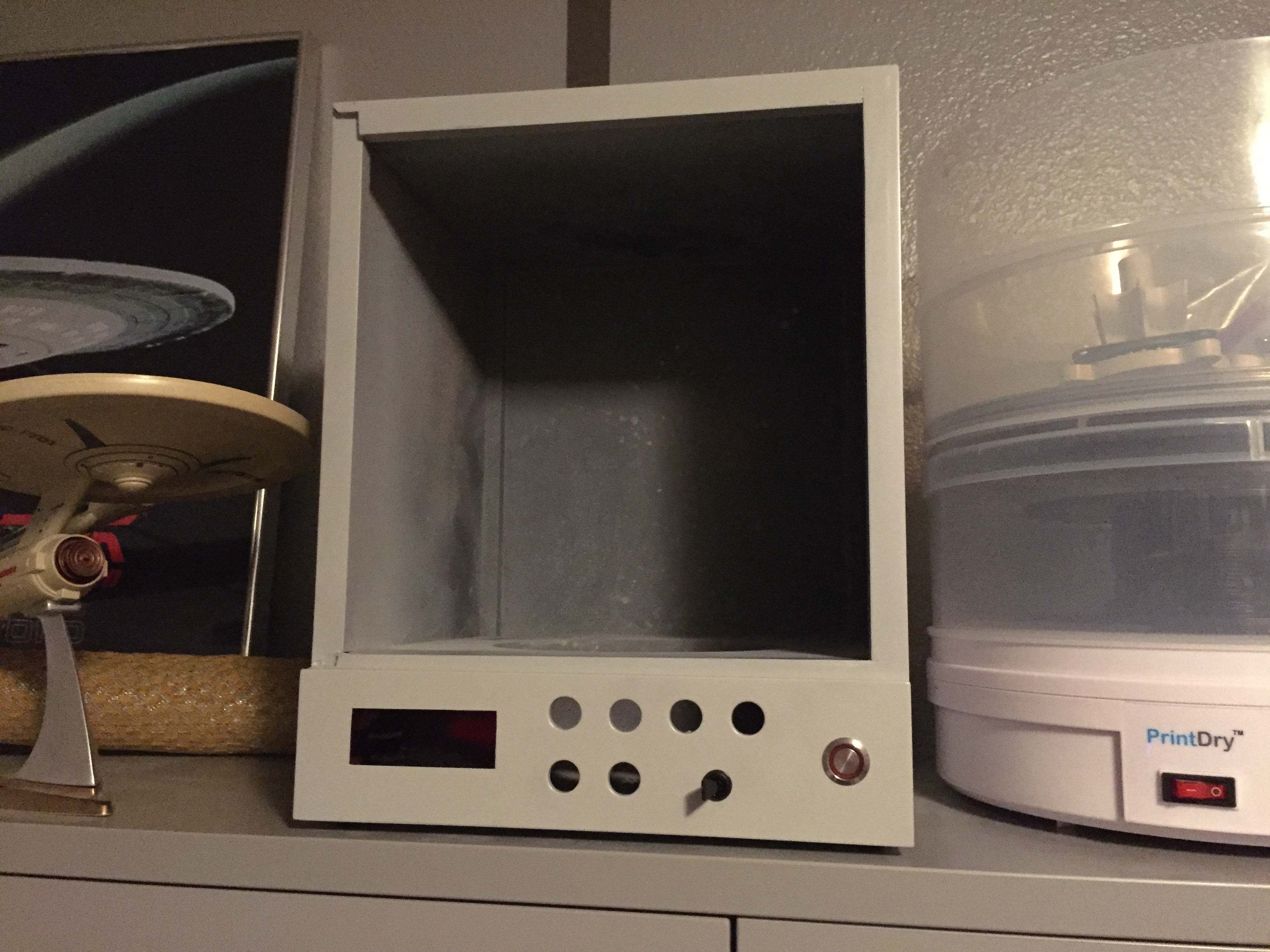

Life events have been on overdrive for the last few months so there hasn't been much time for hobbies. The latest issue with my UV box project is the MDF warped from painting, so the plan of magnetic attachment is now not good enough for me. The magnets are not strong enough to correct the resulting gap:
Now I'll need to MacGyver a metal bracket/hook arrangement for locking the panel in place. It's always something...
