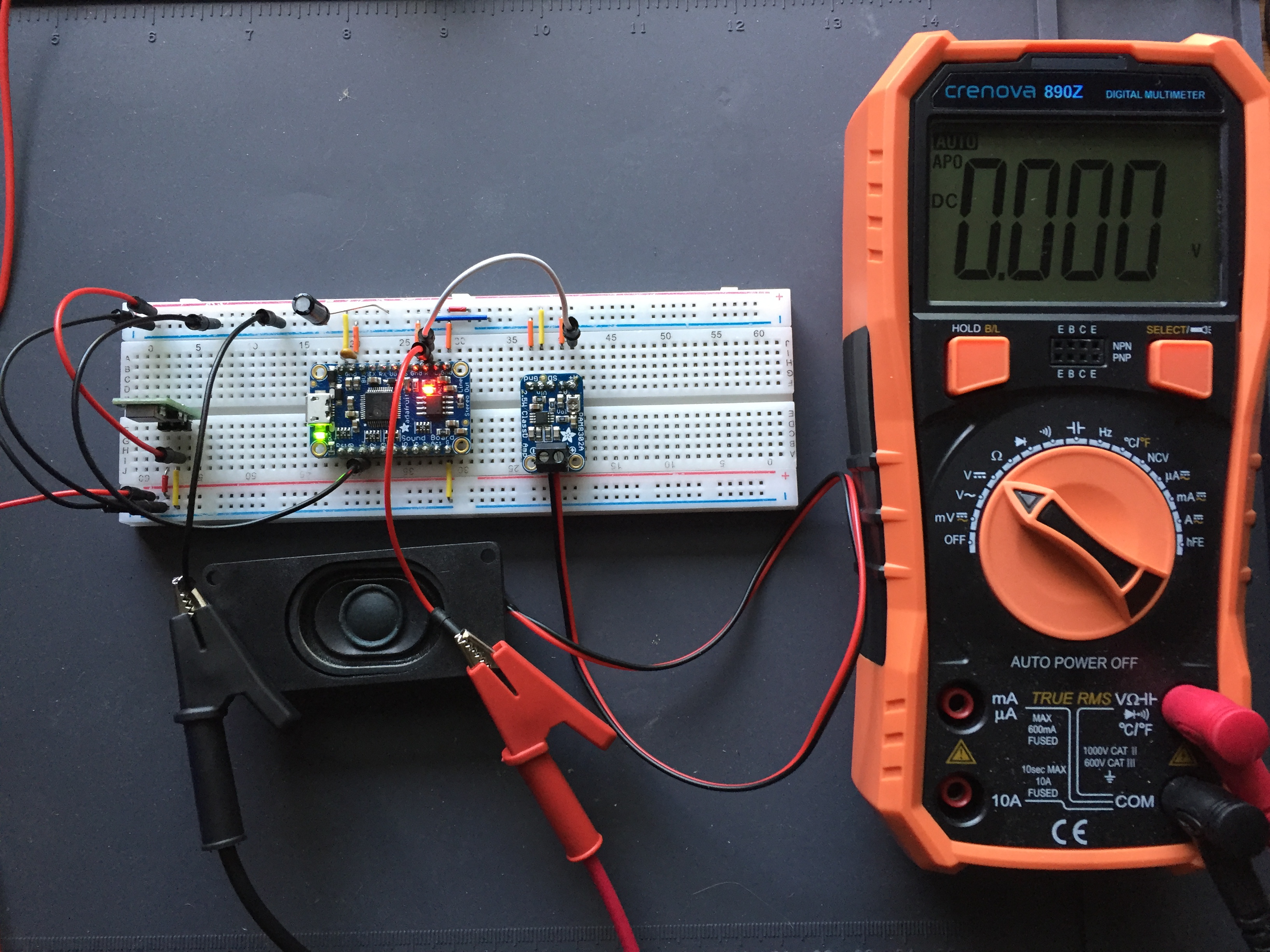

Another delay - the Adafruit soundboard isn't putting out any sound. 0V on the output while a sound is "playing":
I've got Adafruit tech support helping debug this, but their only support is forum-based so responses are very slow.
You might set the meter to millivolts AC. The audio will be hard to see in Volts DC... the averaging may smooth out the audio as noise.
There is some activity on the mV setting (very small readings that fluctuate) but still no sound from the speaker. If it doesn't get resolved by the weekend when I've got more time I'll try swapping out the Adafruit boards since I bought multiples when ordering.
