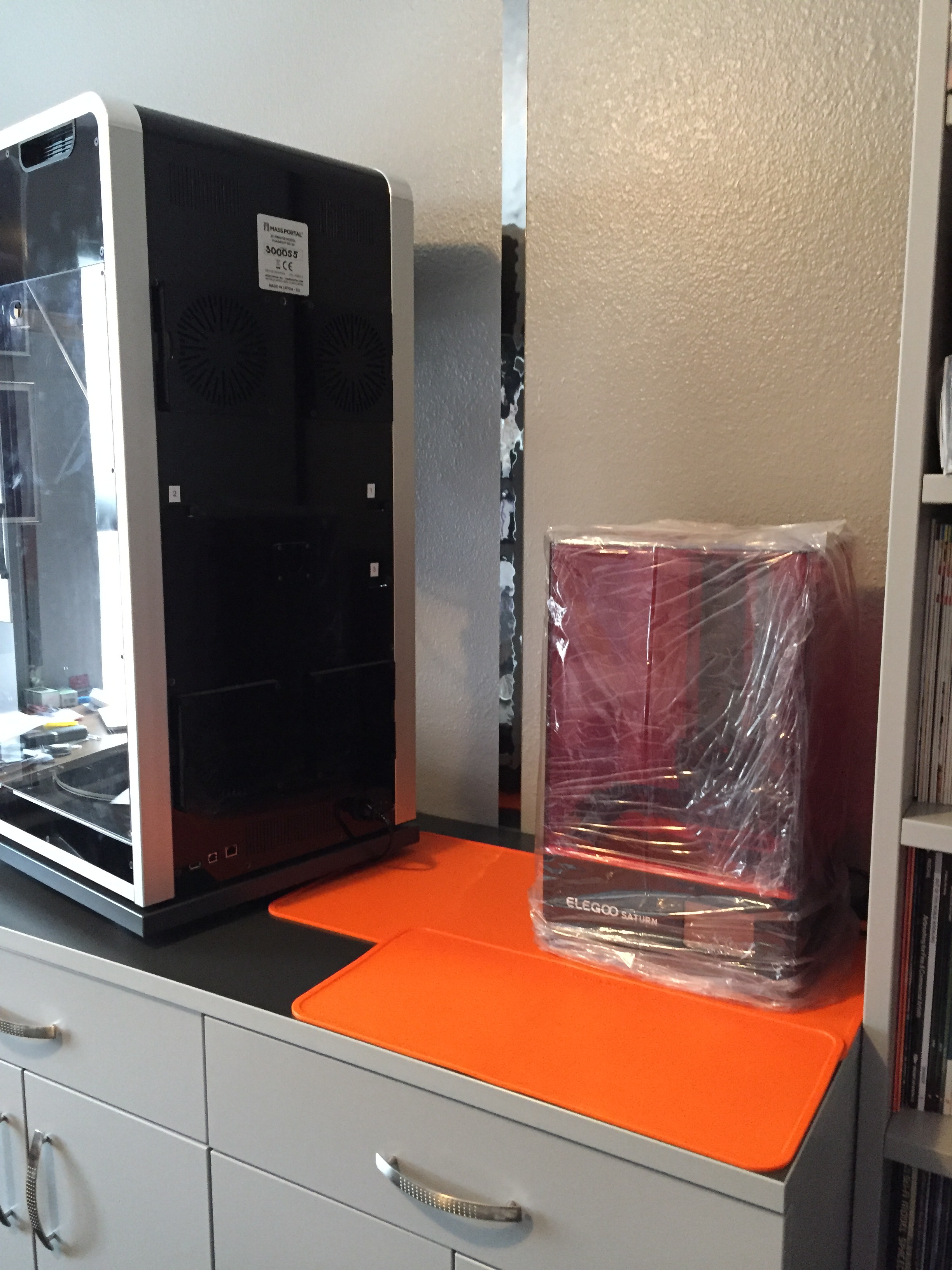

Starting to set up the new workbench, and my oh my the Saturn looks so tiny compared to the Pharaoh (and this is Elegoo's "large" printer):
I love the easy access now to the Pharaoh's backside for loading/unloading filament:
It turns out I sacrificed vertical space for shelving in exchange for under-counter storage (drawers and cabinets) but I don't mind - it's a much cleaner front than the previous cube organizer with custom countertop that I was using previously. It looks like there will be space above for only one shelf with the taller workbench top:

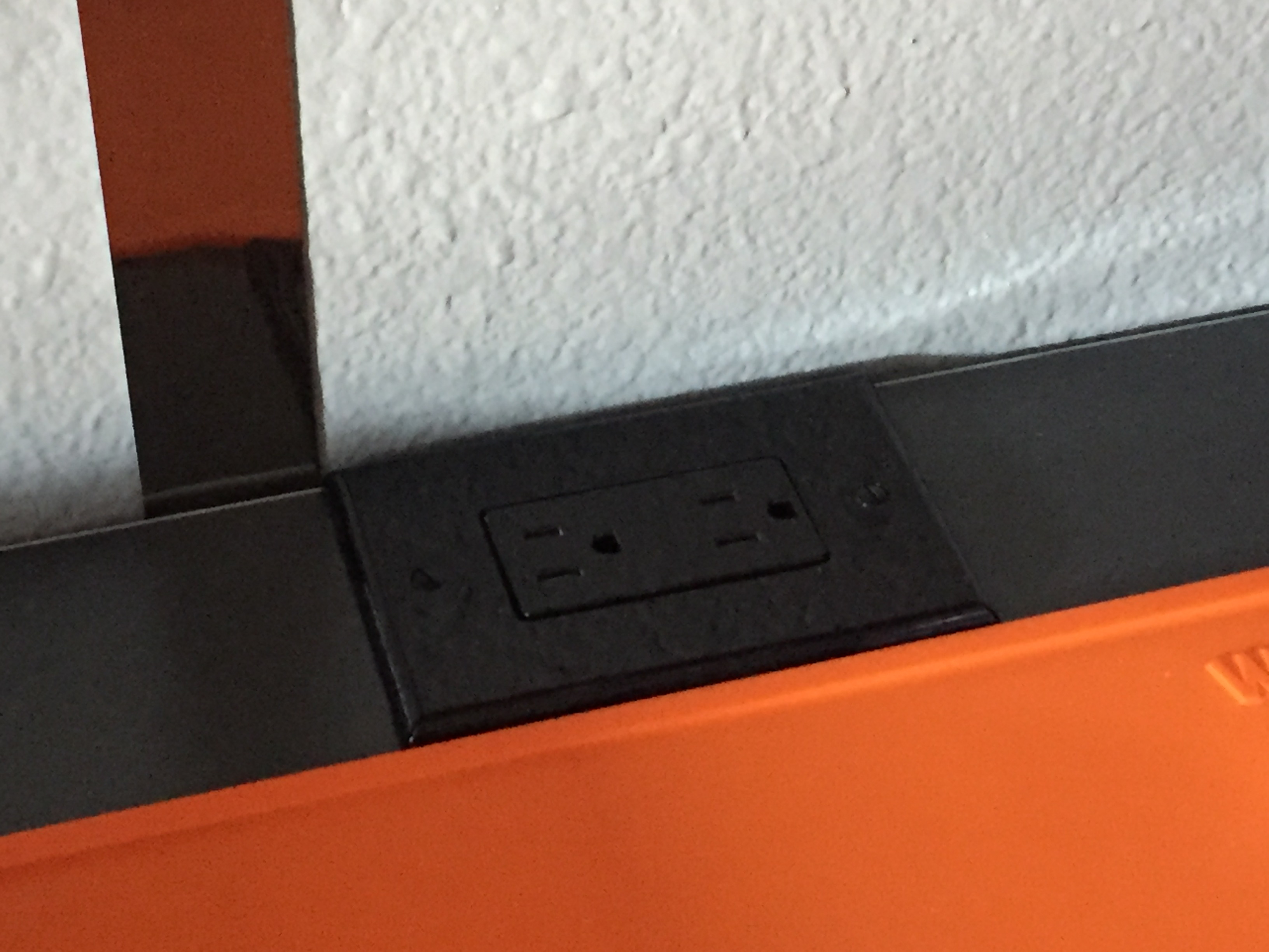

Two steps backwards before another step forward again. Like repainting the walls with a different gray which was a real bummer but I'm glad I did it, I'm realizing the workbench electrical will have issues and now is the time to fix it rather than later. Had I known how the drawers would be set up (as in, not the full depth of the cabinet) I would have not done the 4" overhang in the back and just run power cords behind the drawers inside the cabinet. Having cords behind the cabinet is not so smart when later deciding to switch things around. The Pharaoh isn't going anywhere with its custom turntable, but the Saturn might get a different home in the garage depending on how smelly the resin is. (I've heard very smelly.) Granted, I can wear a respirator, but the cats can't. (Well, technically they could, but then we're causing grudges against humanity....) I've also decided it would be good to have a power outlet between the printers for miscellaneous temporary items like the ultrasonic cleaner and a UV curing cabinet I'll be building. So, this weekend I'm pulling the furniture out from the wall for more modifications (which means emptying the workbench and bookcase again).

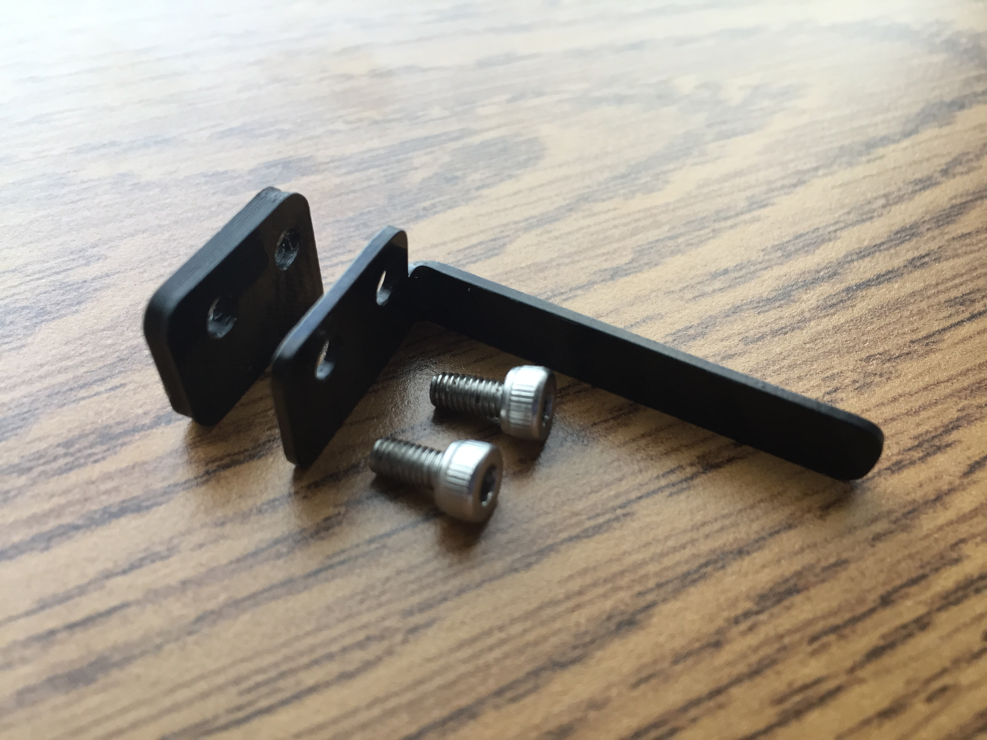

I also got a little more of the resin side set up, but a Wham Bam flexible magnetic build surface is to be installed before the first Saturn test print. The accessory adds 2.3mm thickness to the build plate and can damage the printer if not accounted for. Some people simply attach the plate and re-level the printer (which may work, but Elegoo doesn't recommend this). Some people use a Z-stop extender which can be found on Thingiverse, but after consulting with Elegoo they've recommended to me the optimal way to modify the printer. I'll need to design a part for printing on the Pharaoh to implement Elegoo's suggestion.
The big news for me is there's now "auxiliary power" on the workbench for other devices:

Saturn Z-stop spacer to compensate for increased build platform thickness added by a Wham Bam plate:

This Z-stop adjustment is a much better solution for the magnetic build plate installation than the options provided on Thingiverse. However, resin printing won't be happening until the weekend when I can cure a test print outside in sunlight (since I haven't built a UV curing station yet and I work during the daytime on weekdays).

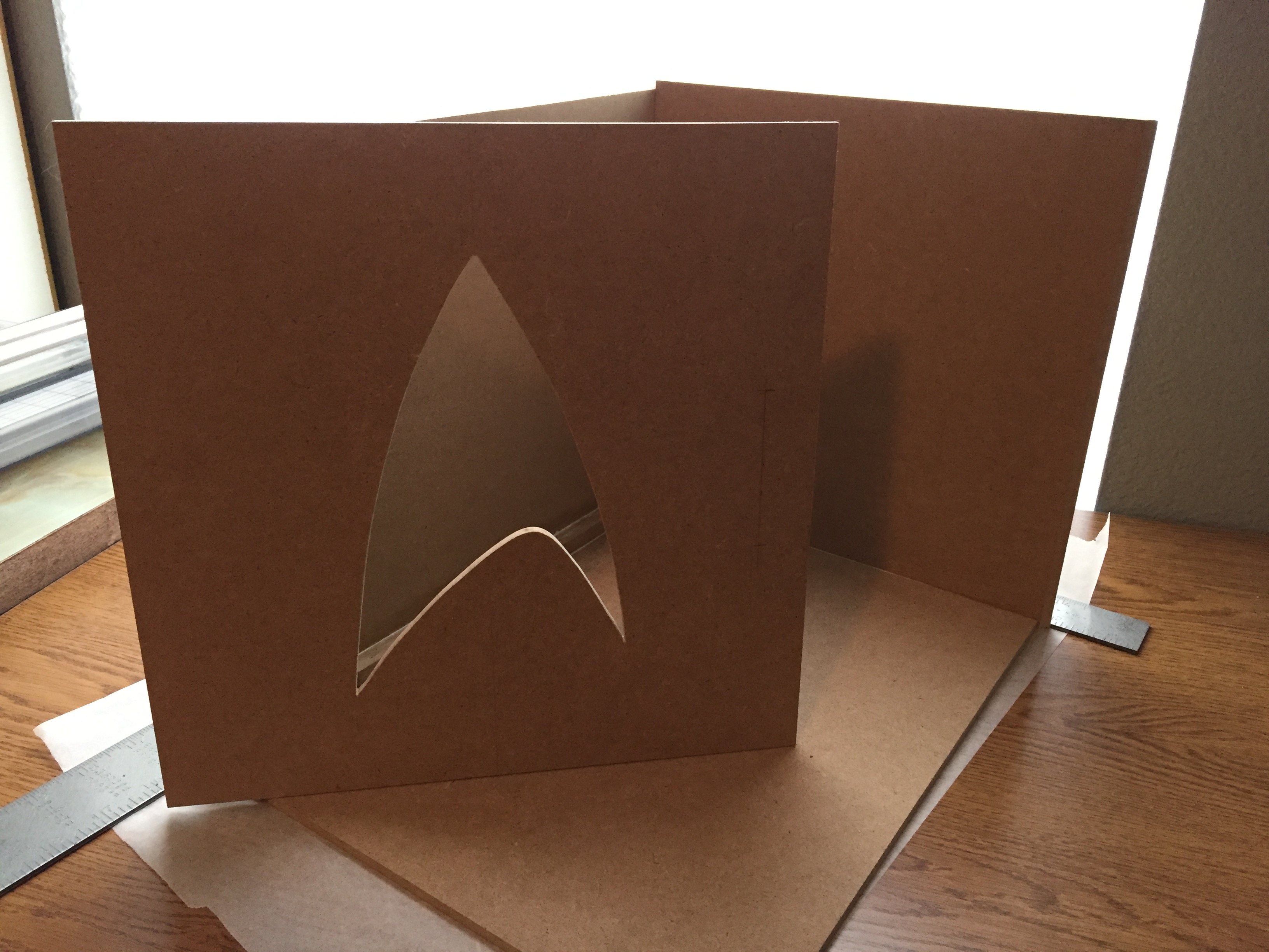

It's been busy here lately, taking time away from this project but I thought somebody might be curious to see one of the items I've been working on. I'm almost done designing a UV curing box for resin prints and it starts construction on the weekend:
All of the interior will be lined with mirrored chrome and six hundred 405nm UV LEDs, and there's a dual-speed turntable on the bottom. The front has a digital timer and all the LED-lit buttons will be functional (and with sound effects). Not pictured (because it hasn't arrived yet for me to model) will be a black toggle switch beneath the green and purple buttons. There are other components ordered as well but have not arrived yet.

UV curing box parts were cut today from 1/4" and 1/2" MDF board. Tomorrow I'll start the panel cutouts, and also begin gluing together parts not having cutouts. The initial design was 10" x 10" x 12" but that was looking smallish so I increased the size to 12" x 12" x 15" for more "elbow room".
Is anybody interested in following along with the UV curing box construction? Should I refrain from pics of the construction and just show the result when it's done? Should it have its own thread or just continue posting updates here?
You should go ahead and keep everything here. Do you intend for the oven to be like an "in universe" piece of lab equipment? I ask because I don't think 2260s Starfleet designers would make a Delta shaped window. However if you aren't going for "in universe", it looks really cool.
It's a sort of mash-up with in-universe and non. I wanted to include a monitoring window like all the ready-made units, but a rectangular viewport is boring so I thought it would be fun having the delta shape. This now essentially screams "Star Trek" in the box's design. The control panel is inspired by the TOS computers and lab equipment. If I had the workbench space it would have been fun to build this styled as the lab analyzer, but in this circumstance it needs to be function over form and fit within my limited workspace. I'm still waiting for LED tactile switches, a black toggle switch, and a 5v regulator to arrive and then I'll have all the components ready for a photo and placement planning.
