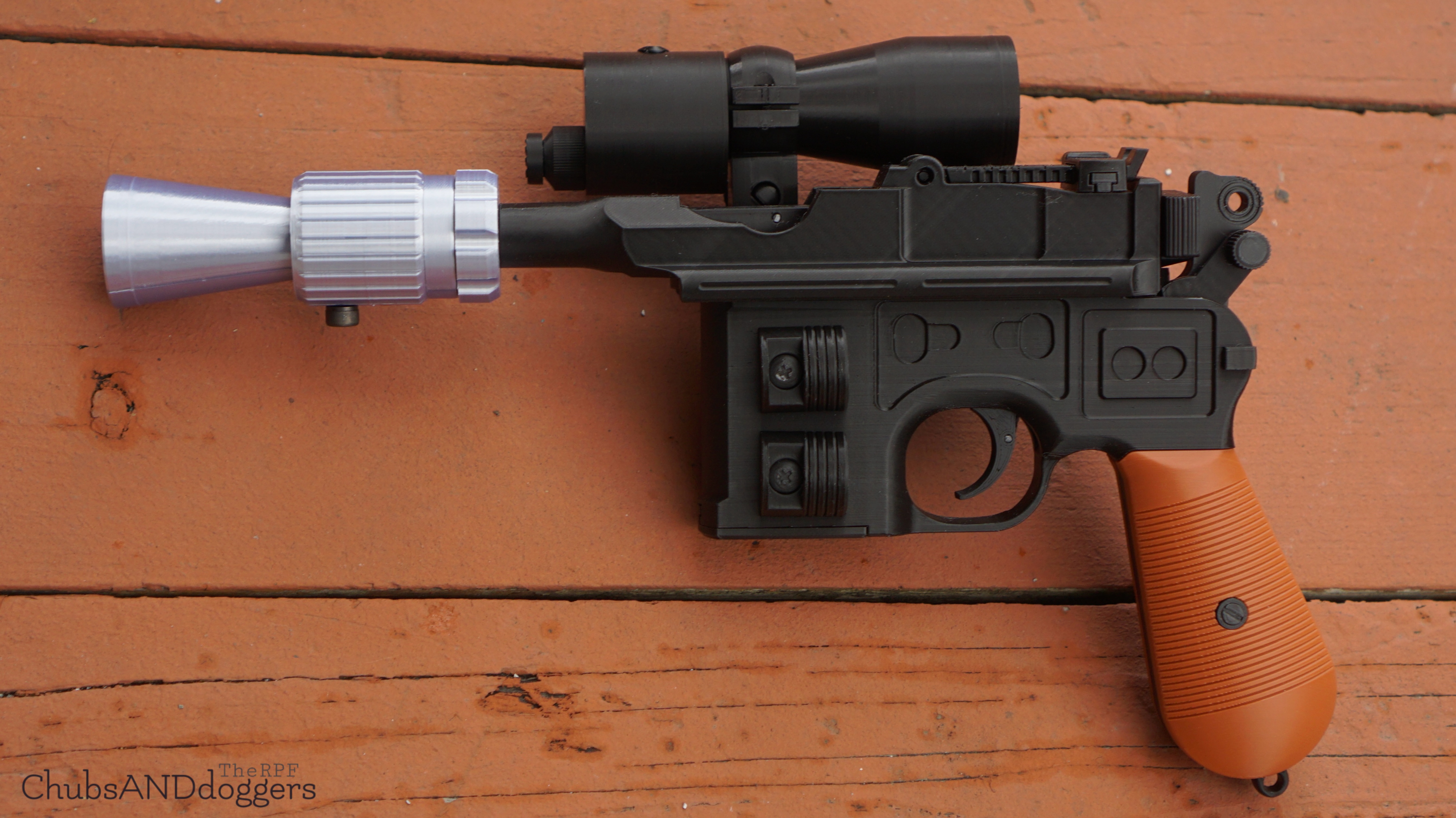

Unless you choose to go the route of not hiding the 3d printed origin, of course. I've done that too, printing a Baddeley v2 in Silk PLA. But I also have a Baddeley dome and a lot of 3d printed accessories on my R5-D4 build (on a TEX-MEX wood frame) and even in ABS, the amount of sanding you will do before painting is hard to believe. And - chubsANDdoggers results here notwithstanding - you will almost certainly want to sand a droid smooth. The larger the surface the more obviousl print lines become, and there's a lot of long, mostly flat surfaces on a full-size droid.

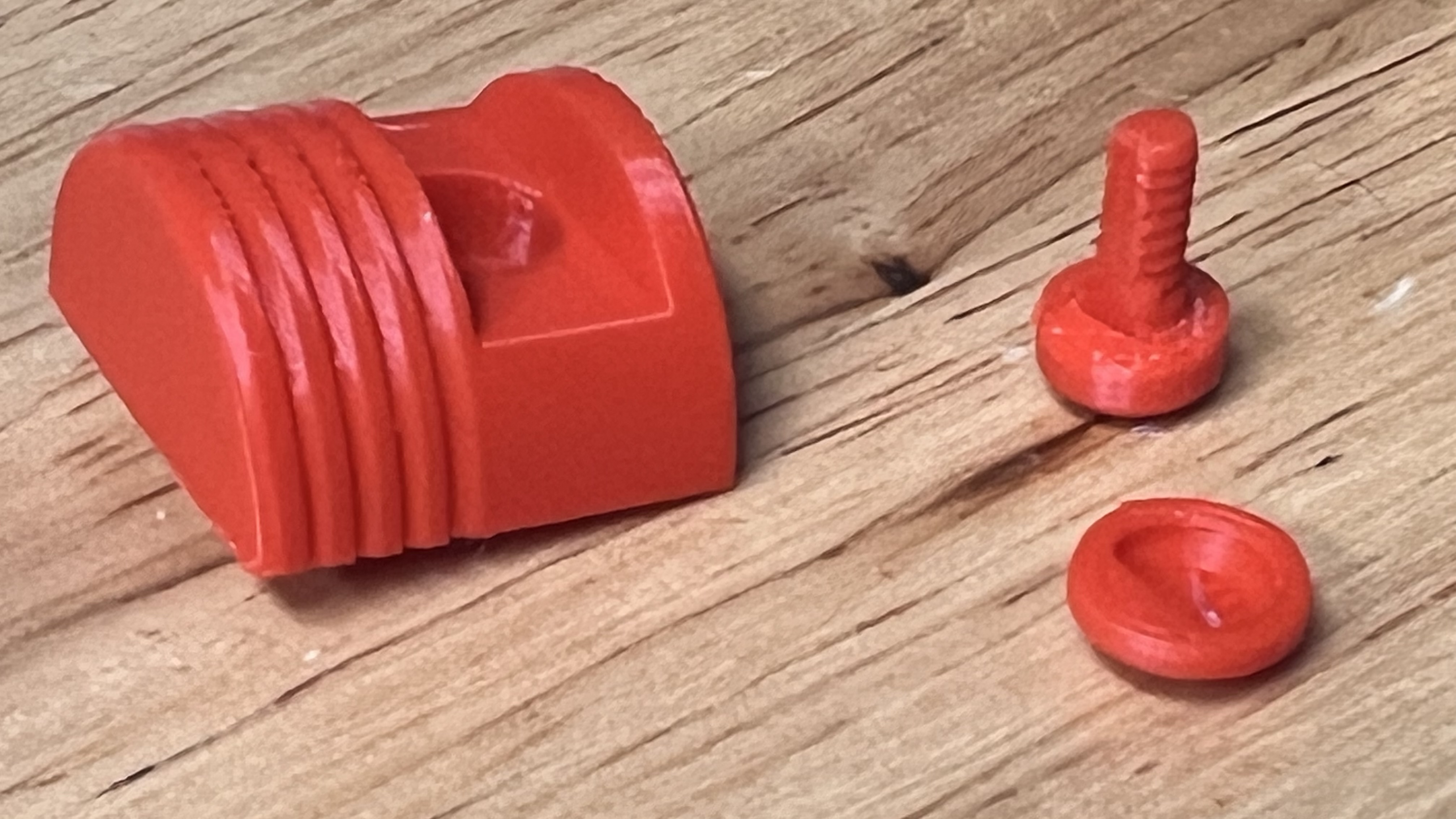

I’ve yet to really paint my FDM prints but I do use all BL filament for now. I use all levels of their PLA as well. Don’t really notice any difference in print quality or strength for what it’s worth. What I find most important for strength though is how it’s simply printed. I print screws for example and I generally print them in two parts. The threaded part flat on the print bed (I cut the underside so it will lay flat) and the head of the screw resting normal. I also cut into the screw head specifically as well so the screw turns with strength and resistance. Glue them together and you have a very strong screw that simply won’t break. This one is already glued together but you can see an unglued cap here as well to give u an idea of what I mean…
I’ve yet to really paint my FDM prints but I do use all BL filament for now. I use all levels of their PLA as well. Don’t really notice any difference in print quality or strength for what it’s worth. What I find most important for strength though is how it’s simply printed. I print screws for example and I generally print them in two parts. The threaded part flat on the print bed (I cut the underside so it will lay flat) and the head of the screw resting normal. I also cut into the screw head specifically as well so the screw turns with strength and resistance. Glue them together and you have a very strong screw that simply won’t break. This one is already glued together but you can see an unglued cap here as well to give u an idea of what I mean…View attachment 1780761
Within it's temperature tolerance, PLA is actually the strongest of the common hobby filaments. PETG is slightly flexible so it's often more durable - especially if you're going to have a plastic-metal interface - but PLA is better for loadbearing. Unless it gets too warm, of course.
The reason I don't like it for prop-recreation is because usually those end up being sanded, and the very features that make PLA so strong also make it a lot more work to sand. ABS is actually the softest of the common hobby plastics, which makes it much easier to sand - while it is usually strong enough for the job.
And yes, the weakest part of any 3d printed object is the layer lines so for anything load-bearing it's important to consider orientation, just like the grain in a piece of wood.
masterjedi322 There's lots of threads talking about best filament for a droid over on Astromech, and if you every want to chat about it over there, I'm happy to do so. One last thought: PLA+ isn't a standard. It's marketing hype. It means "PLA with something added to it" and that's usually completely different for every brand name, and often there's absolutely zero information on how the "+" part affects the final printed parts. So definitely do your research if you're headed that way. Me, I buy generic ABS for 2/3ds the price of generic PLA and almost half the price of brand-name PLA, and I'm perfectly happy with the results.

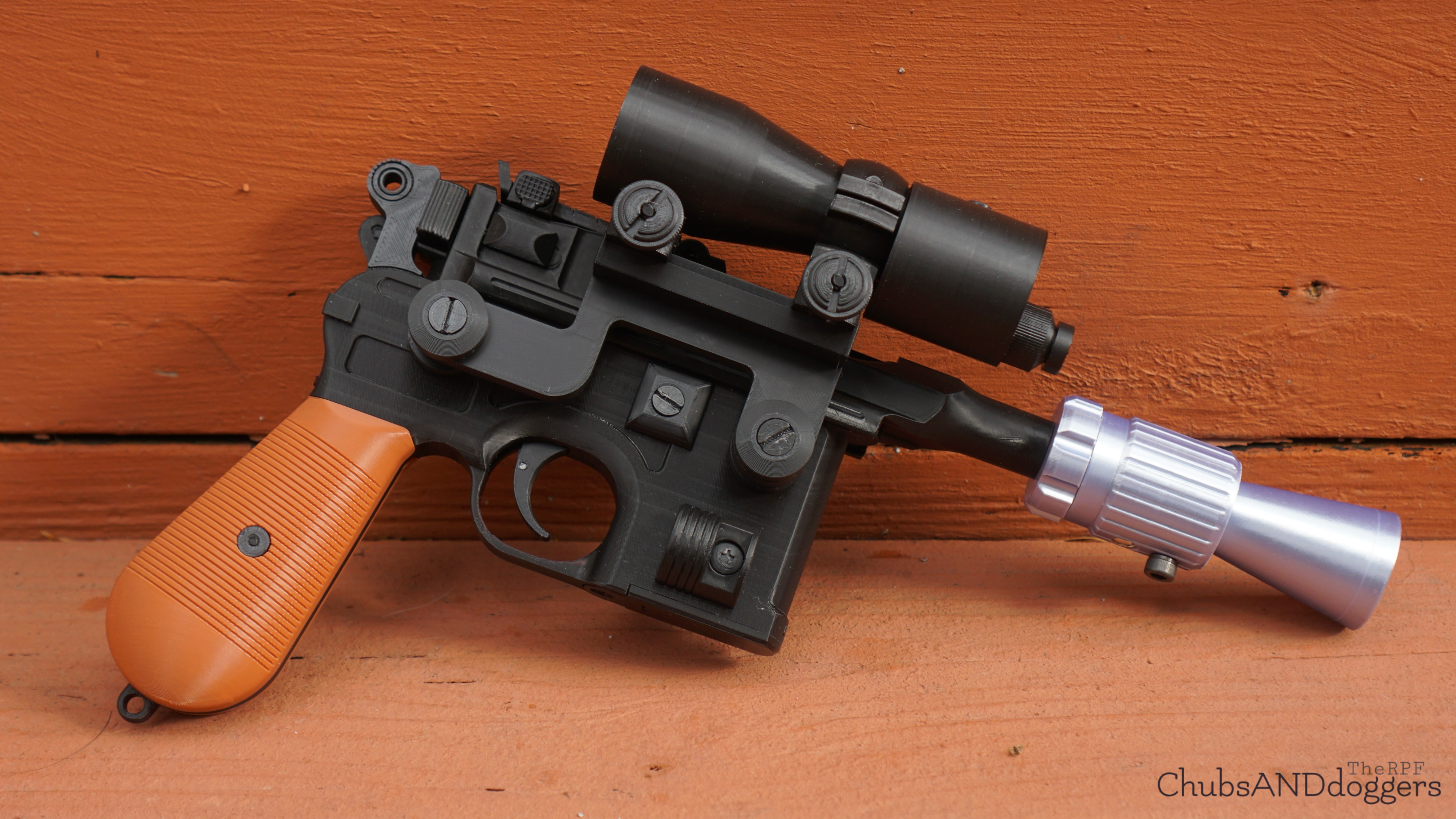

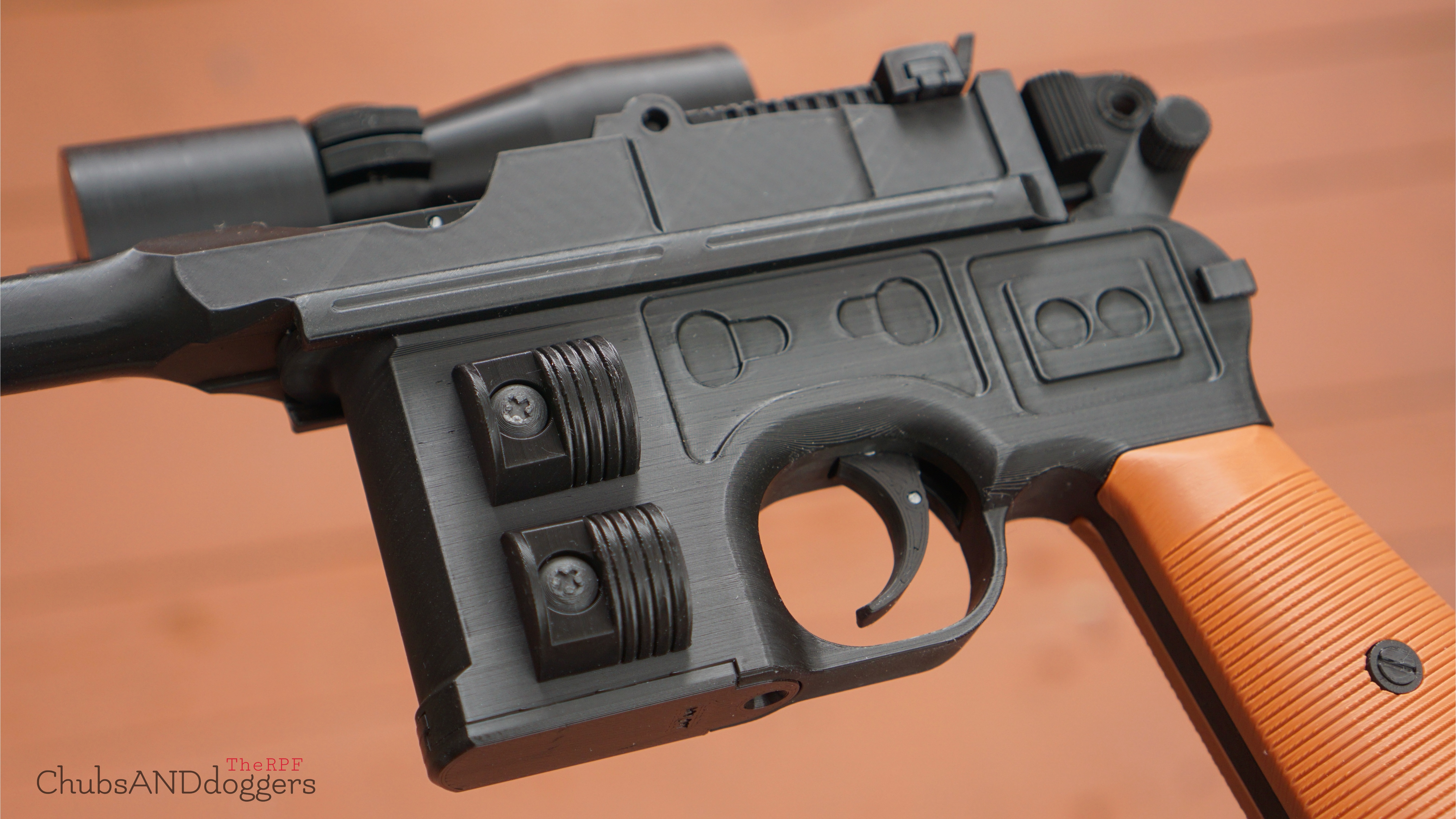

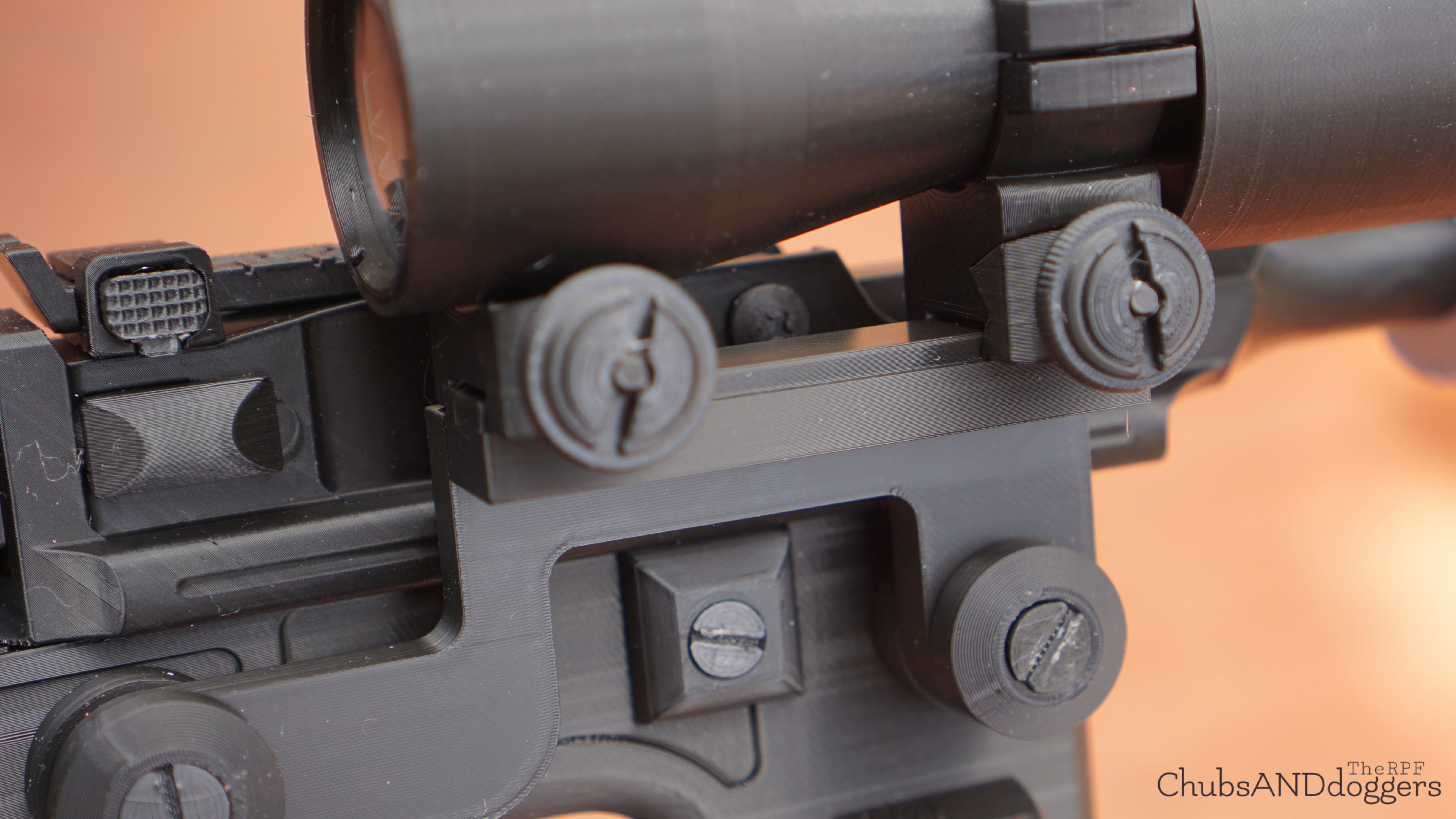

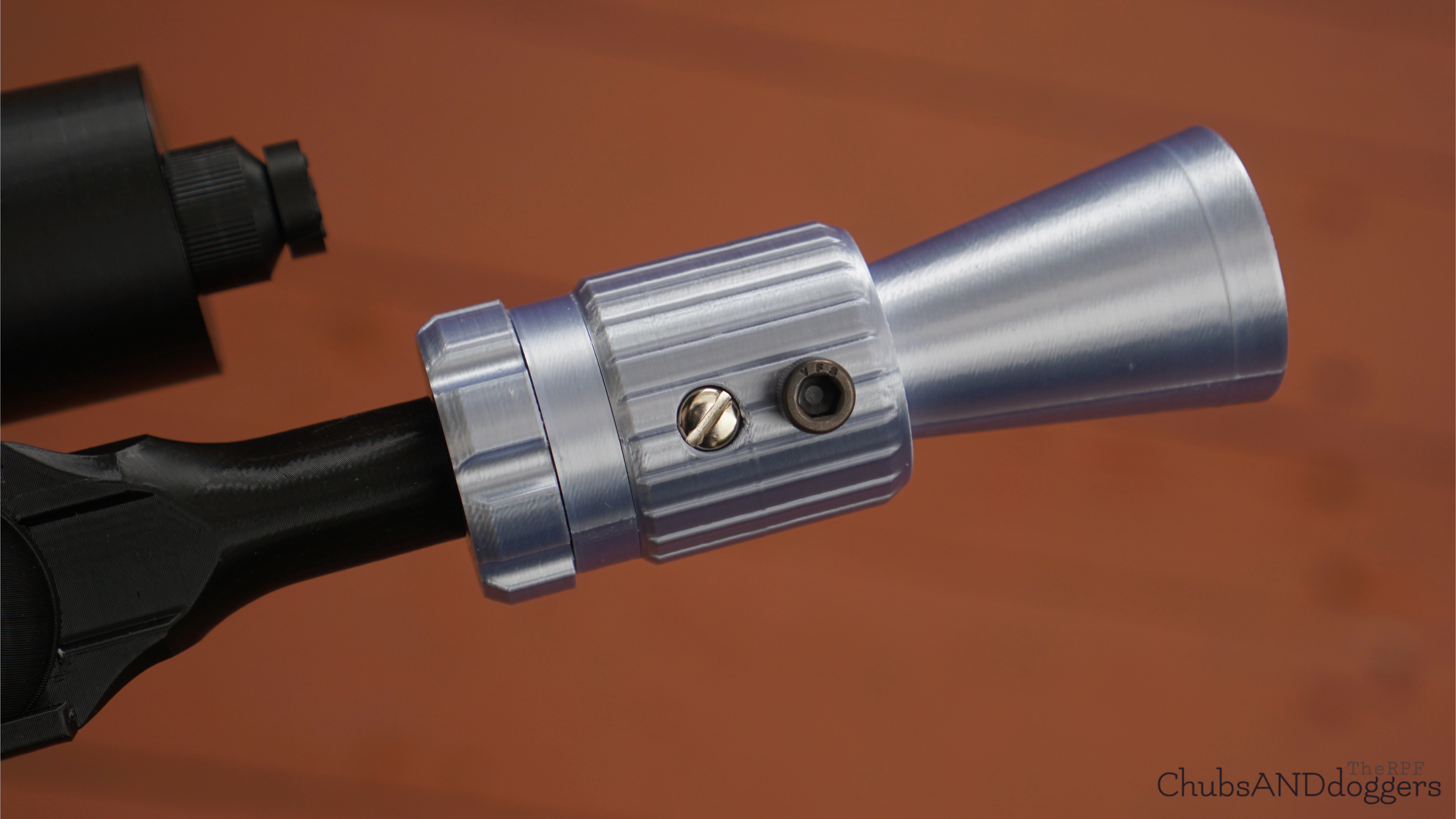

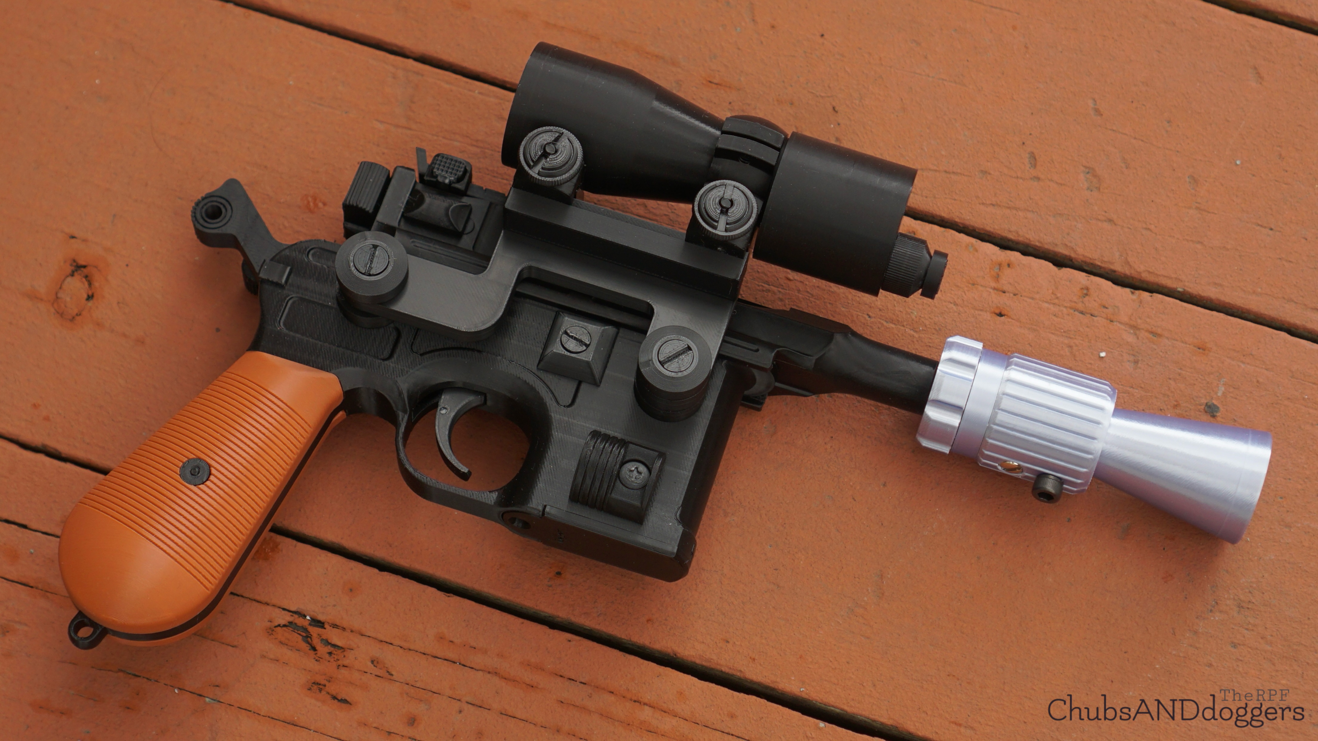

Still working out kinks but the Endor blaster is definitely coming along. The screws for the greeblies and the mount are all 3-D printed. I do have some real ones on order but I didn’t wanna wait so I just printed these up but they work..View attachment 1781035View attachment 1781036View attachment 1781037View attachment 1781038View attachment 1781039View attachment 1781040View attachment 1781041View attachment 1781042View attachment 1781043View attachment 1781044
Very very nice
Sorry if you already covered this, but what kind of functionality do these have? Working triggers? Bolts? Hammers? Etc.
Looking great!
Sean

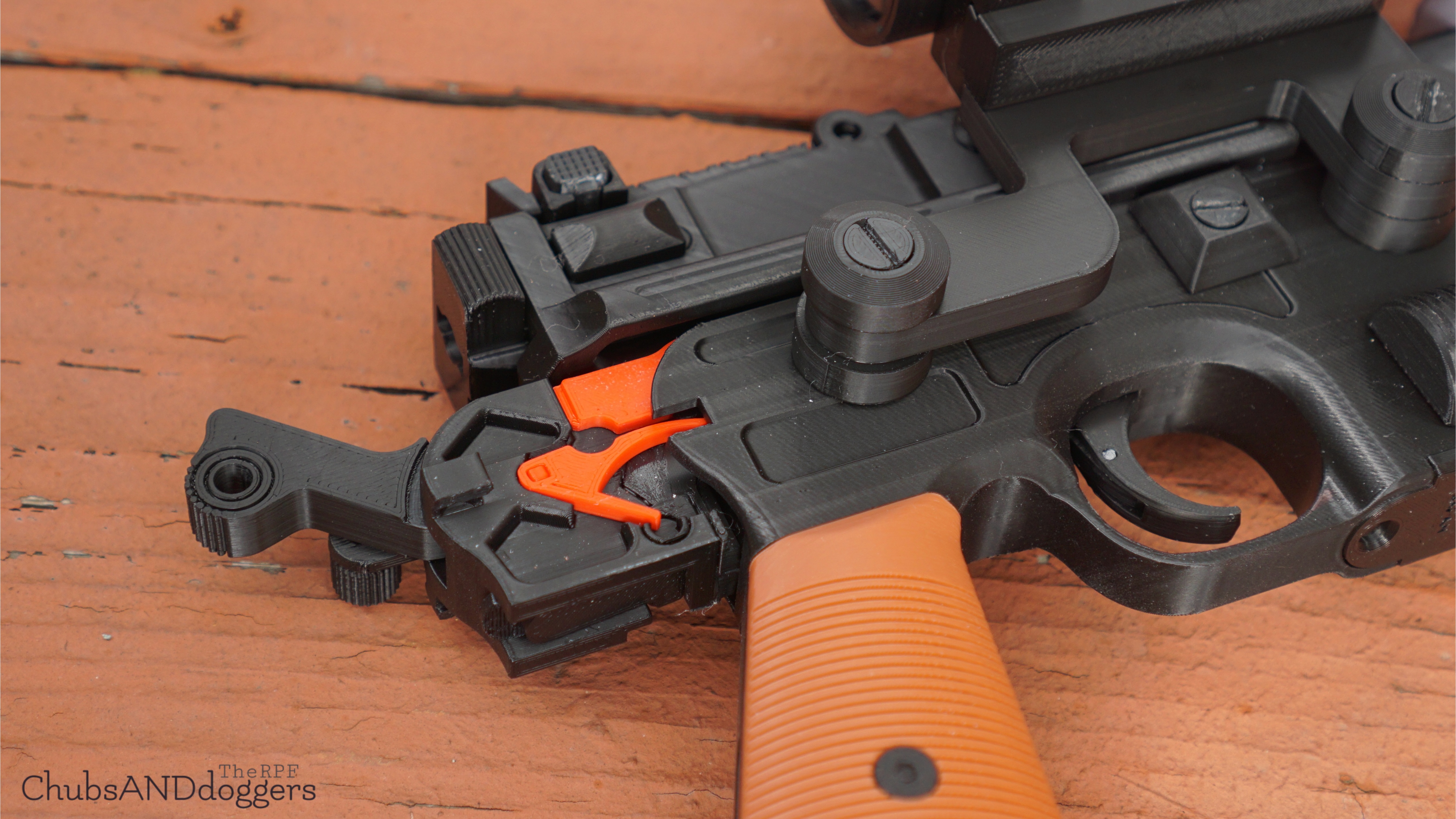

Short answer is yes to all your questions but this video will get more specific. I don’t upload videos to YouTube often and have yet to do one of these FDM prints but this video will answer all your questions and then some I believe. These are all 3d printed in MJF though not FDM printed but they are from pretty much the exact same CAD file so the functionality and cosmetic designs are the same. If you are wondering what the difference is between MJF and FDM it’s strength (and price). FDM is much more delicate where MJF (industrial printer) is on another level of strength all together. MJF printers cost literally 250x the price of these FDM printers so that obviously say something there as a well. Regardless, the way these blasters are designed are basically the same so my FDM prints will do everything you see in this video..

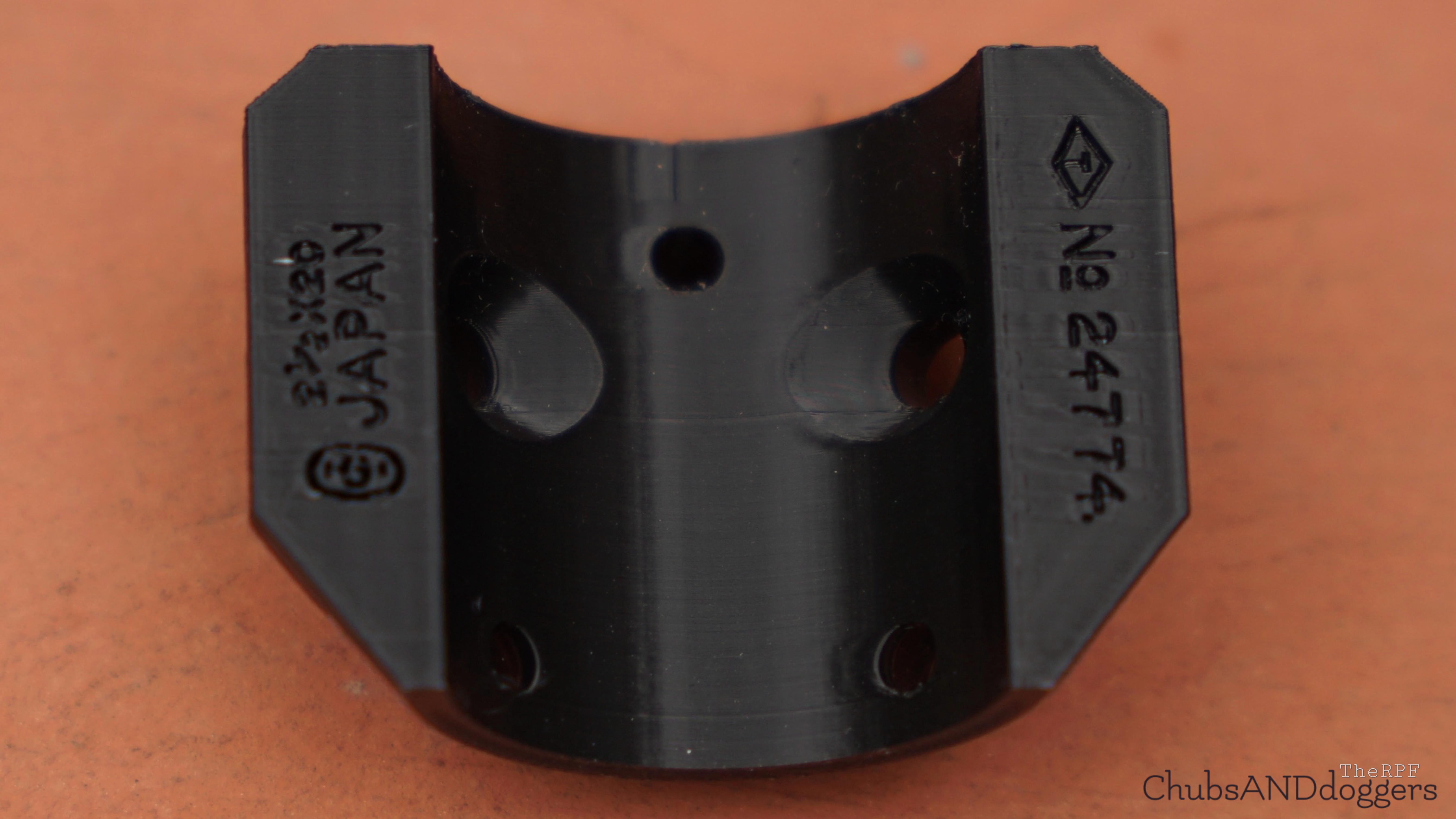

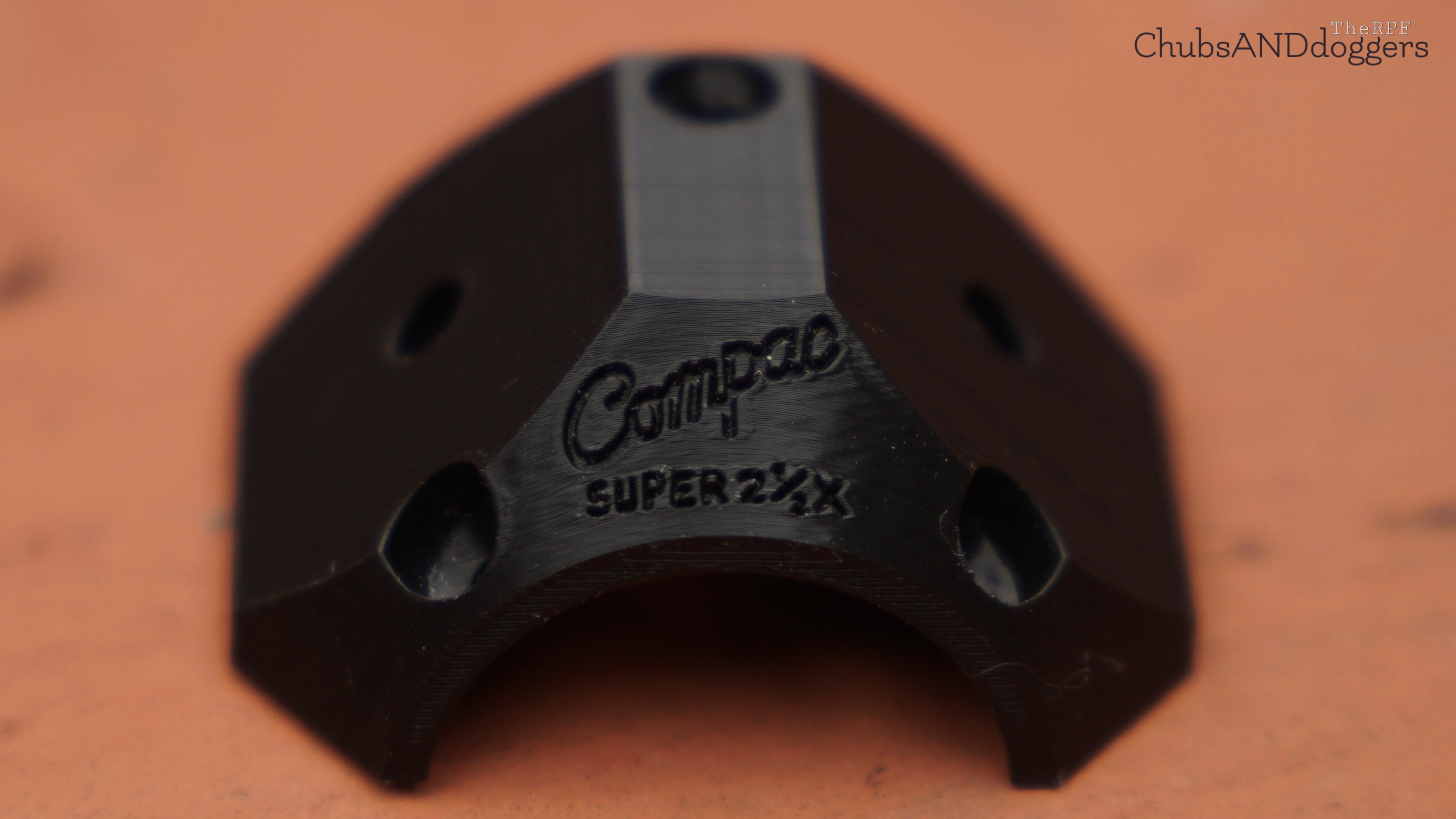

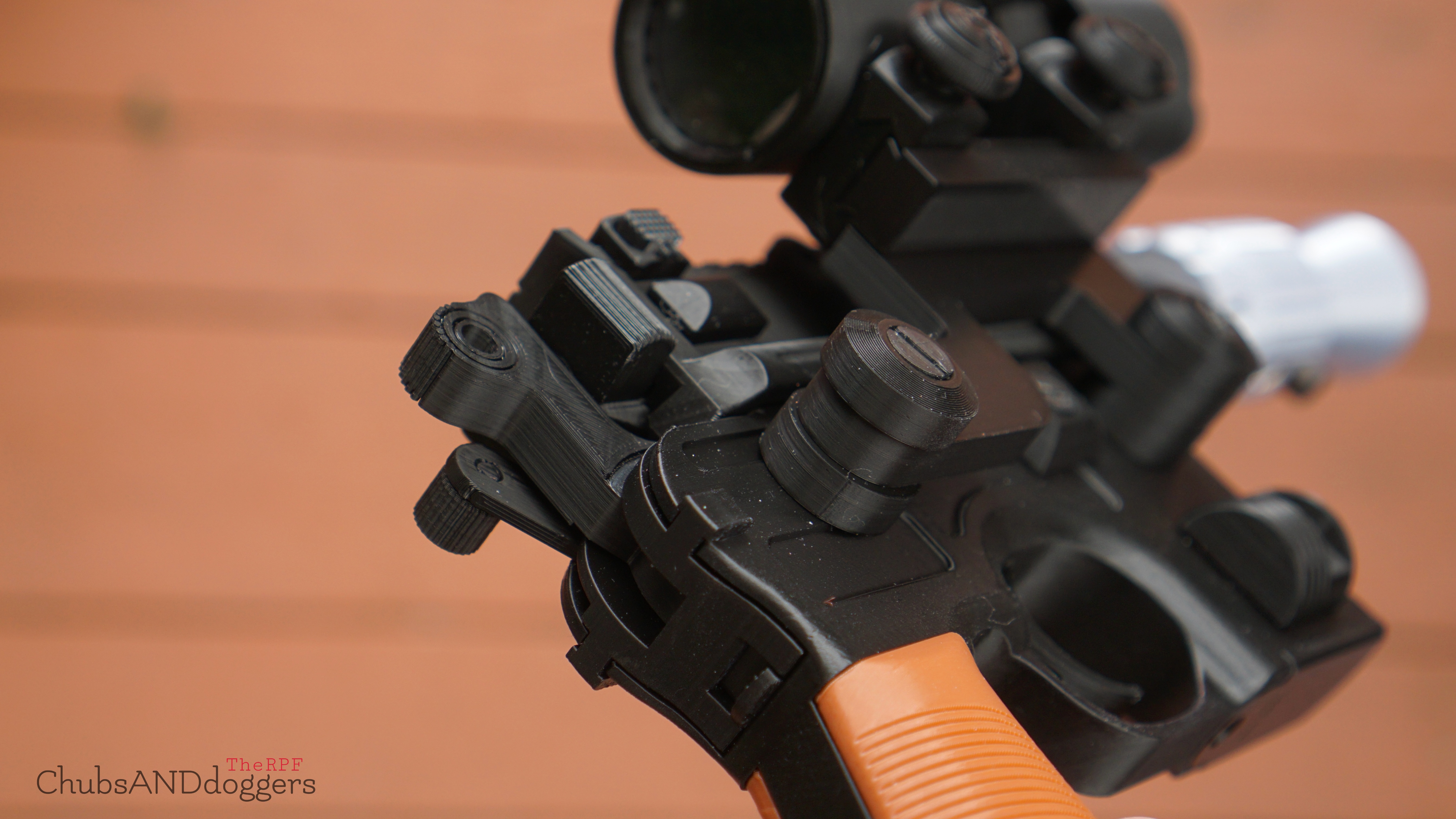

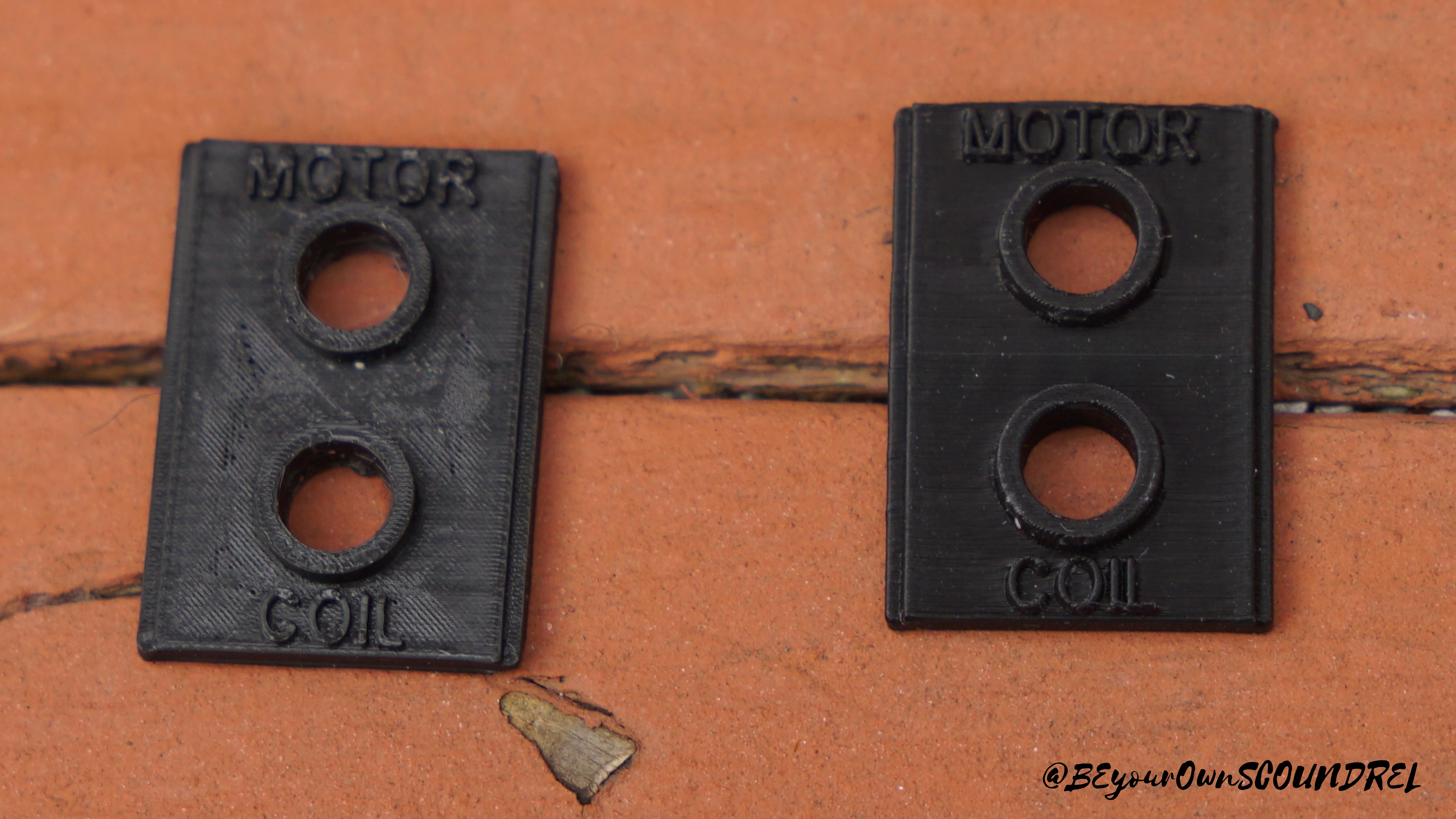

This is pretty amazing. These are all printed with a .2mm nozzle to be able to capture the minute details of each design. For the motor/coil greeblie the one on the left was my test print to make sure it was able to do just that and as you can see it did pretty well. On the right is the same design just printed on an angle so it’s more “smooth” in appearance..

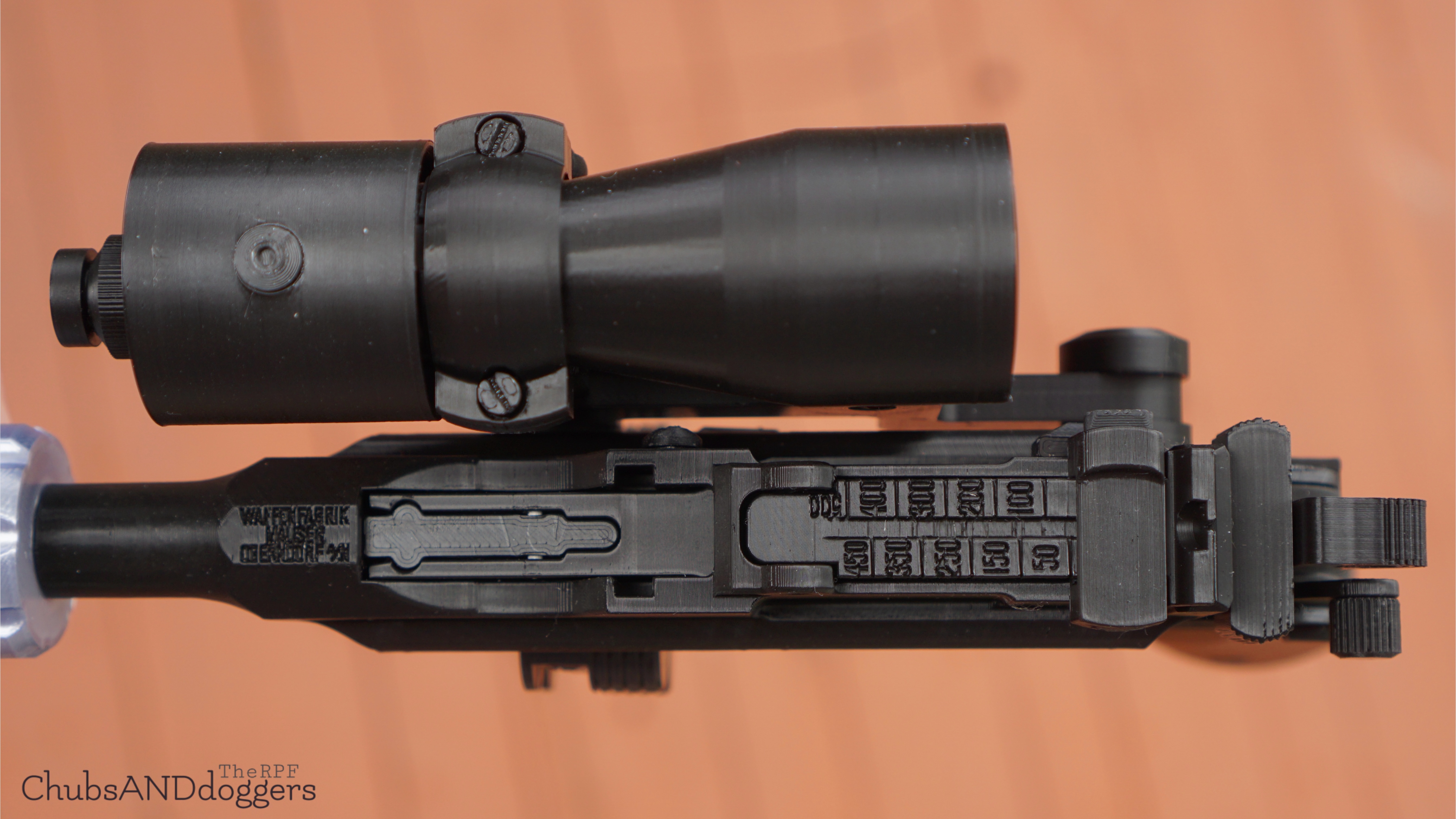

This one though is really crazy. The Greedo Killer Windage base. I had to modify my original design to space things out a bit so the numbers and letters wouldn’t blend together. I didn’t increase the size of the design at all just marginally spaced them out. I’m talking .005 of an inch but after which it was able to print everything simply beautifully..

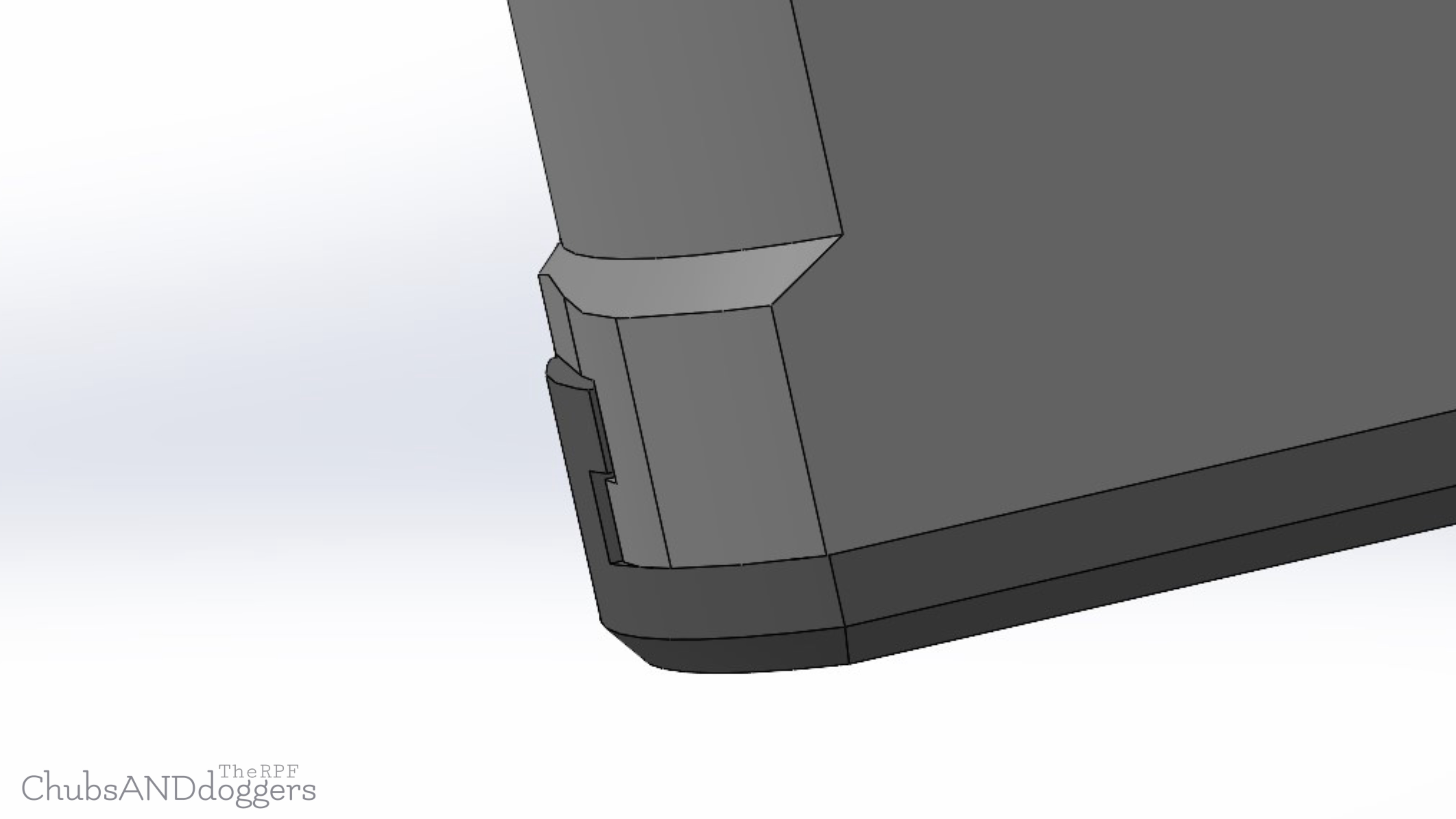

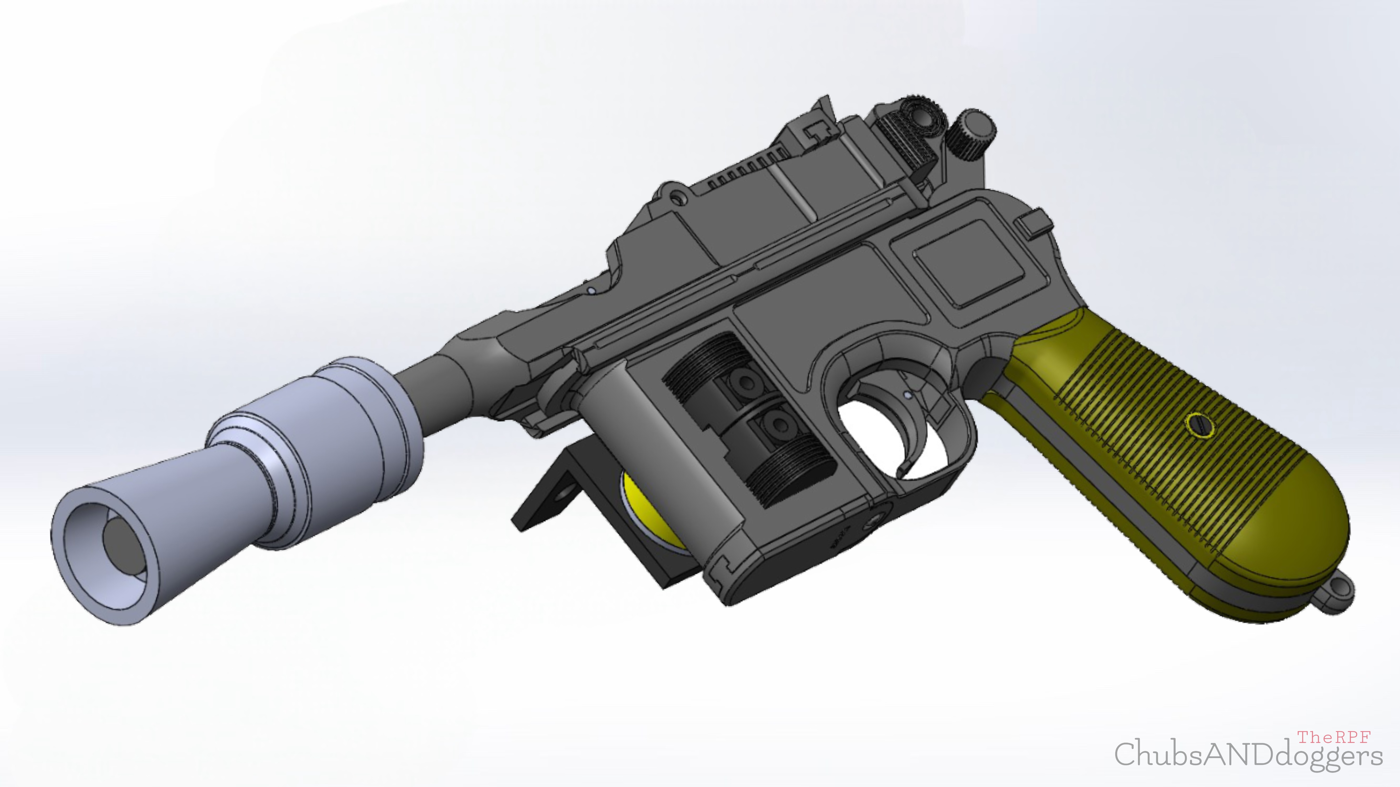

It’s always a bit of a tail chasing game CAD is. For me anyways. I’ve noticed a detail that I wanted to try and incorporate into my MGC design which ultimately has a domino effect on other designs for everything to fit. But all in the pursuit of that ever avaiding excellence. On the front of all the MGC’s that I’ve owned I’ve always noticed that the mag plate doesn’t line up perfectly with the lower receiver. It always seems to stick out just a little bit. That and I wanted to improve my front radius as well..
It’s always a bit of a tail chasing game CAD is. For me anyways. I’ve noticed a detail that I wanted to try and incorporate into my MGC design which ultimately has a domino effect on other designs for everything to fit. But all in the pursuit of that ever avaiding excellence. On the front of all the MGC’s that I’ve owned I’ve always noticed that the mag plate doesn’t line up perfectly with the lower receiver. It always seems to stick out just a little bit. That and I wanted to improve my front radius as well..View attachment 1782654
That’s awesome. Were you able to solve for the dominoes?
