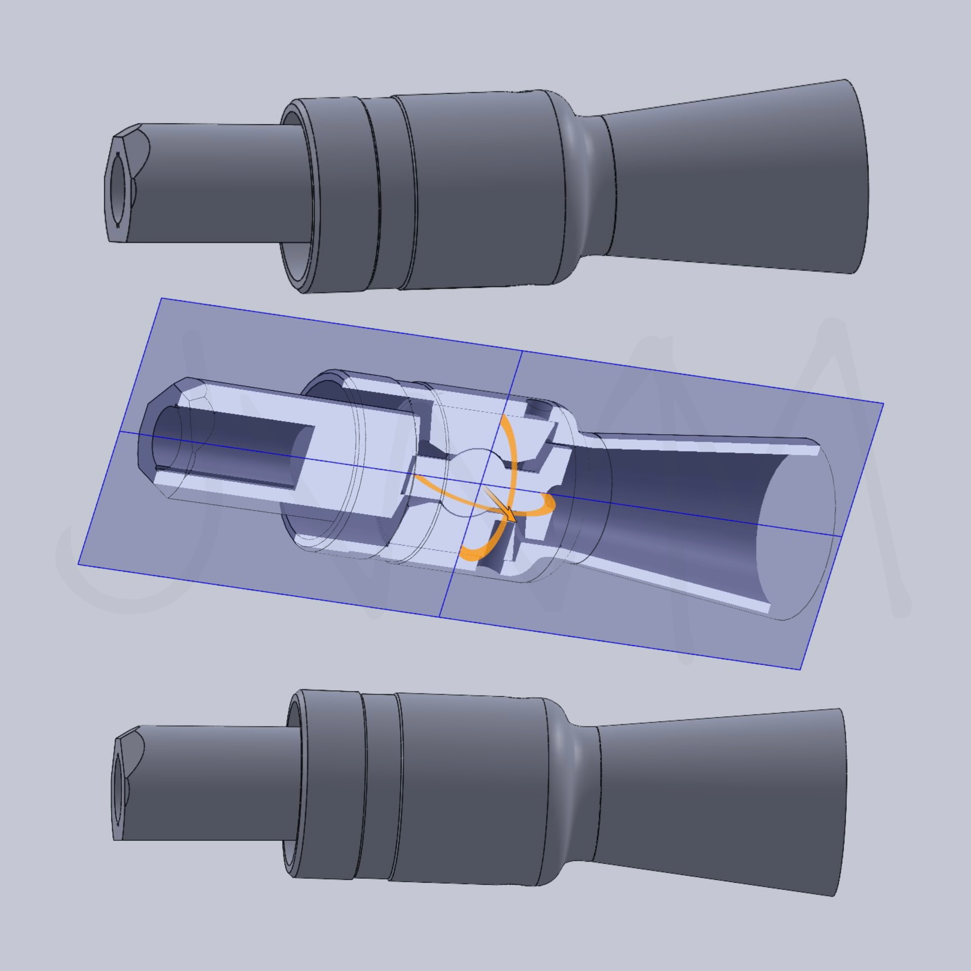

Seeing if I can add some sort of pivot for the FH and BB..View attachment 1597519
Haha!! You’re crazy man, I love it!! I will gladly contribute a ball joint for this, either real Bandai P.C. or printed. This is SUCH a weird and cool idea!
Aside from that, your model is looking so very good, wow. I envy the fun of adding those little details, I love that stuff! I have not pored over your pics, but overall it looks spot on. So good!! :love:
Pedro thanks! Ya it’s definitely a little strange but since the FH isn’t securely attached on the original I wanted to try and emulate those different looks.

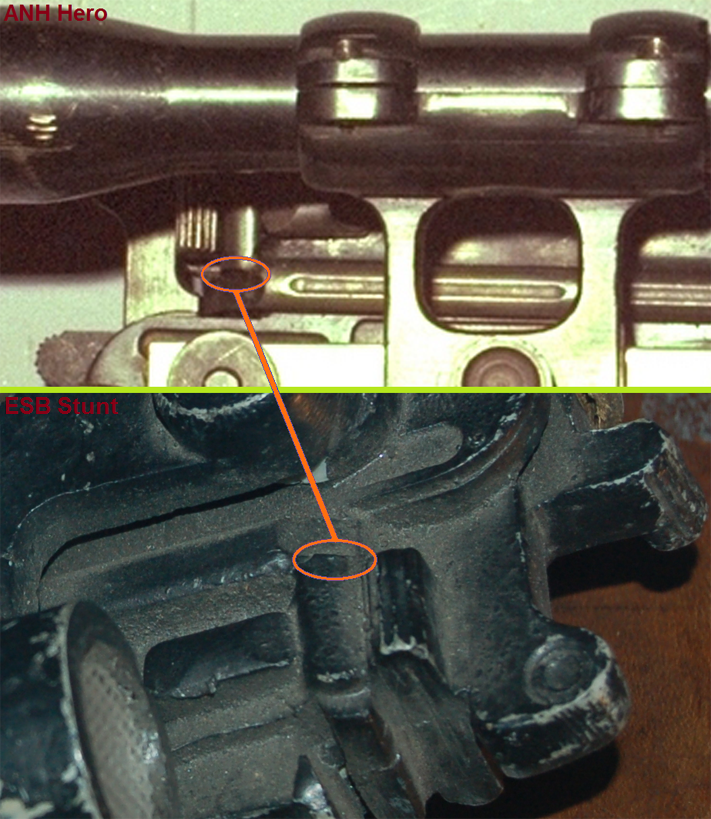

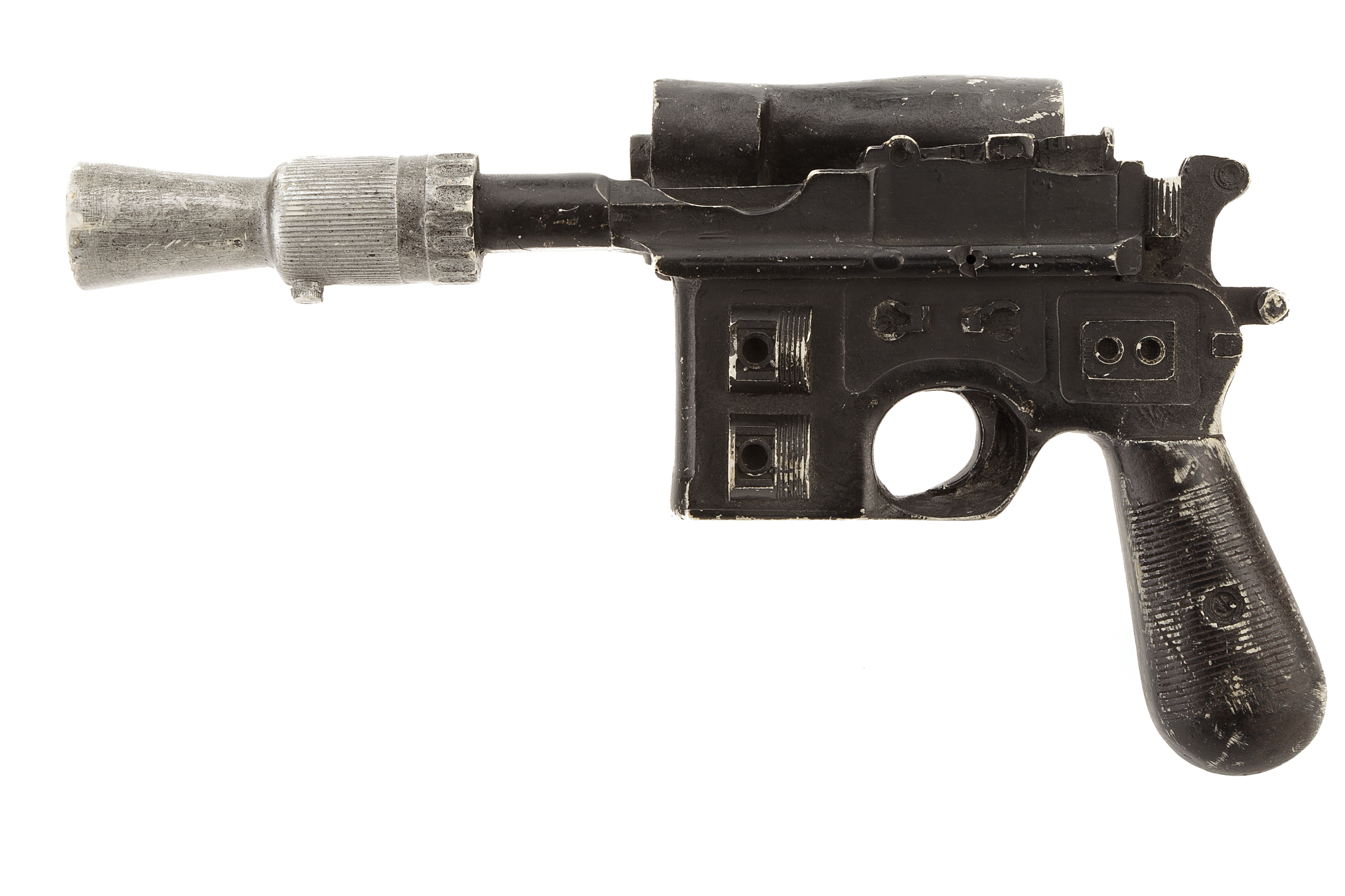

So I wanted to add Pats patch but I can’t get a good enough look at exactly what’s going here. The stunt blasters don’t seem to show much either unfortunately. If anyone has a better look please let me know, if not no worries..
I'd really love to know what they had there on the Hero and in the same exact spot as the Merr Sonn blasters as well, Pat's Patch may be the greatest mystery of all! We have no photo reference whatsoever of what greeblie they intended to be there on either blaster.. I really doubt it's a plug greeblie since the Merr Sonn already had one up top, so...?
This is the best photo I've seen of the Hero Pat's Patch, courtesy of our mystery Hero:

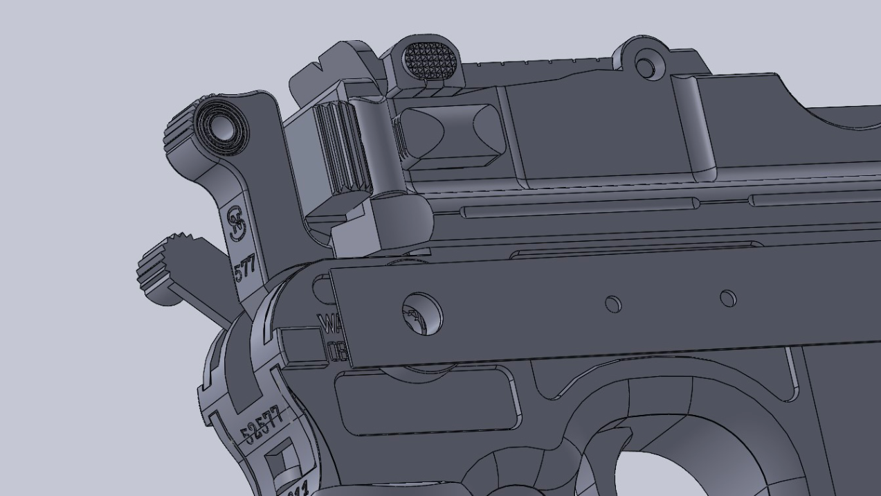

Looking good as far as the Lump is concerned too, though I did notice that the very bottom of the Hero's lump has a small radius transition into the Mauser's side-rail, and the Mauser's pre-existing radius (the large horizontal one below the lump at the very end of the rail), appears to be flat rather than a large radius as per the Left-Side and the Right-Side of every other Mauser we've seen. It seemingly had been redone during the addition of the lump. :unsure:
-Carson
..though I did notice that the very bottom of the Hero's lump has a small radius transition into the Mauser's side-rail, and the Mauser's pre-existing radius (the large horizontal one below the lump at the very end of the rail), appears to be flat rather than a large radius as per the Left-Side and the Right-Side of every other Mauser we've seen. It seemingly had been redone during the addition of the lump. :unsure:
-Carson
Thanks for the photo! It’s really hard to see exactly what is happing there to be honest. I’ll mess around with it and see what I can come up with.
For the lump I think I see what ur saying. I’ll play with that as well. That should be pretty straight forward, especially with that 2nd close up pic of the stunt blaster you shared. You can see the flat. Thanks Carson!

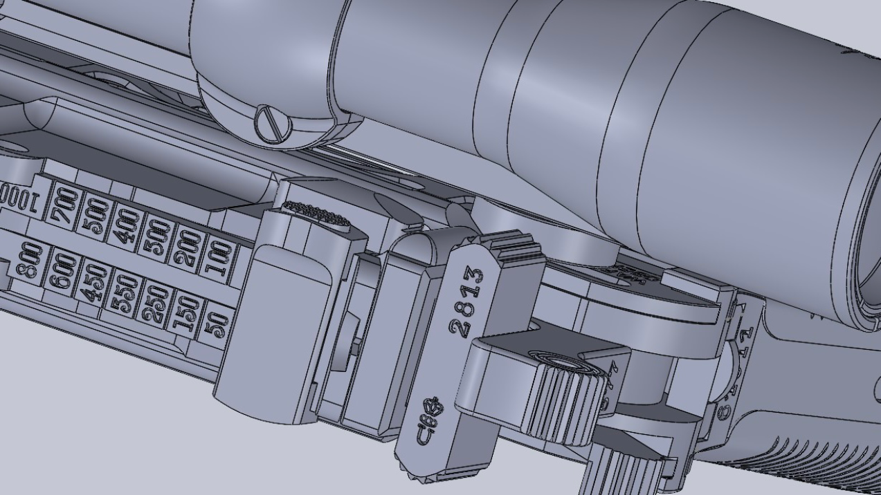

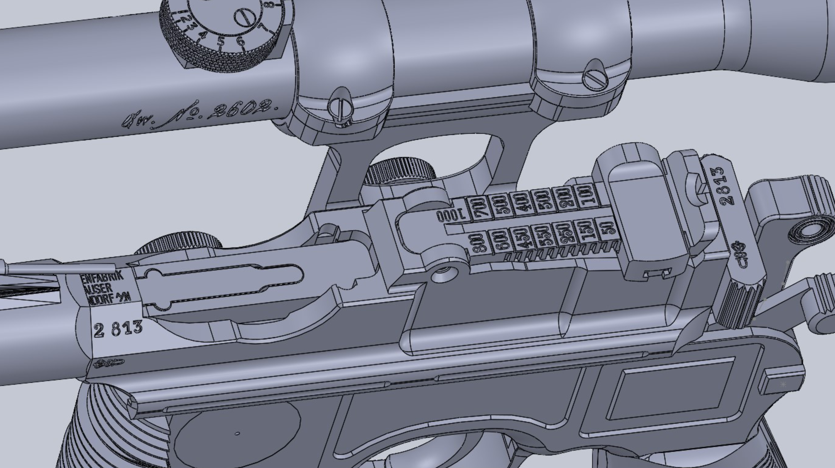

One nice thing with this PS blaster is it’s allowing me to measure up this scope. Looks pretty good scale wise..
Beautiful work bud, it looks fantastic. I always loved that V spring there, it serves 3 purposes and was the only spring I just had to model simply because I loved it for some odd reason..

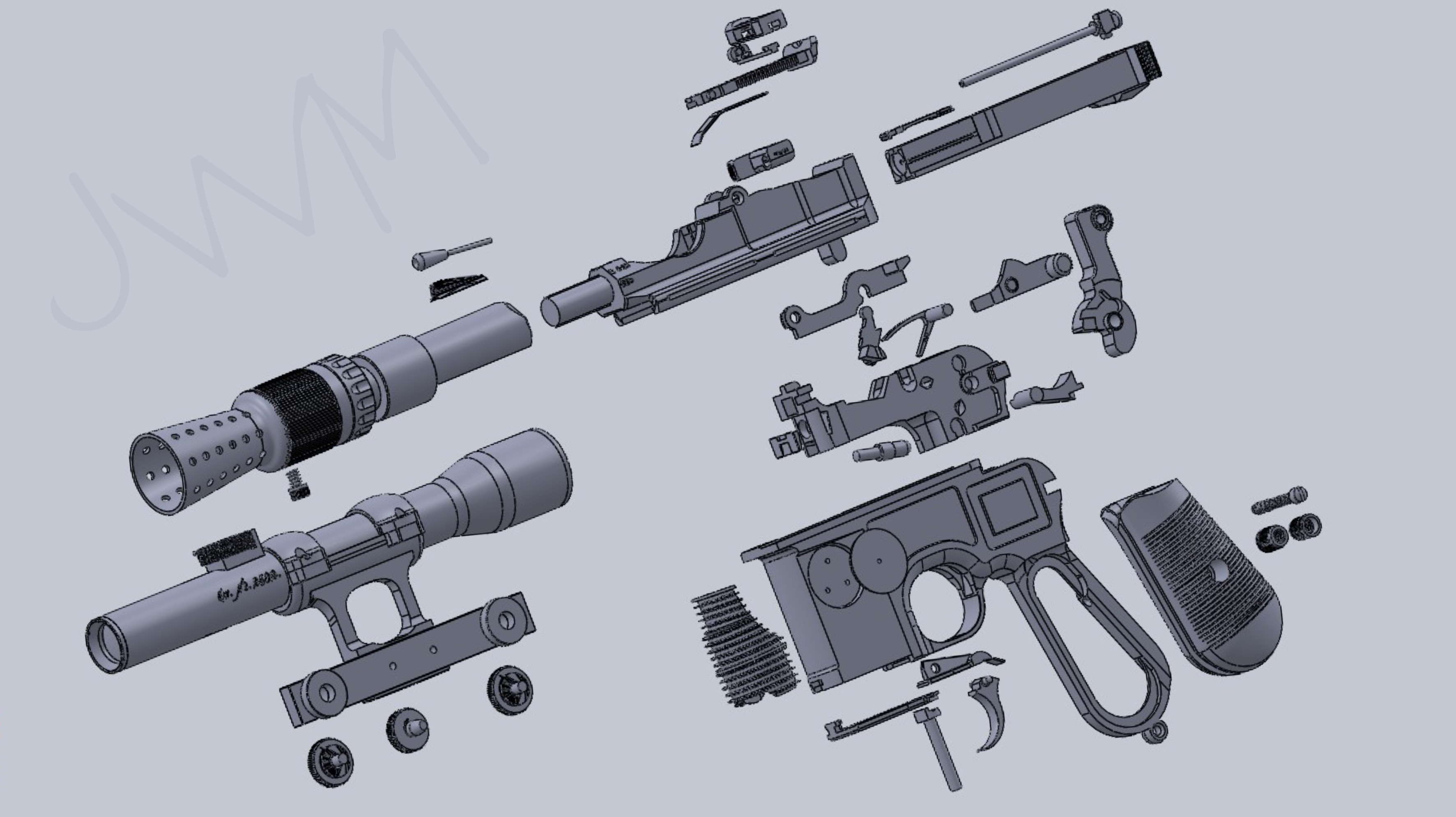

I’d still love to chat sometime when ur free to put some of my insecurities behind me with how all this is going to work. The springs and screws will be actual springs and screws as much as possible. I bought some springs and designed the parts around those so hopefully that works out.
I’m going to prints the grips screws though as I couldn’t find anything that would work appropriately. But I’m doing something with those screws I’ve never done before and that’s printing them with the threading already designed into it.. so it will be interesting. That V spring will be interesting as well but both should come out fine. Everything will be printed in MJF which will cover the strength, tolerance needed for each. The only issue with MJF will be the lettering and numbering details. They might come out a little soft?
As far as machining well that’s probably a little out of my league but I’m sure with the guidance from likeminded, good natured folks like urself anything is possible. ? Also as far as who to trust.. well I’ve learned (unfortunately the hard way) at least who to avoid that’s for sure.

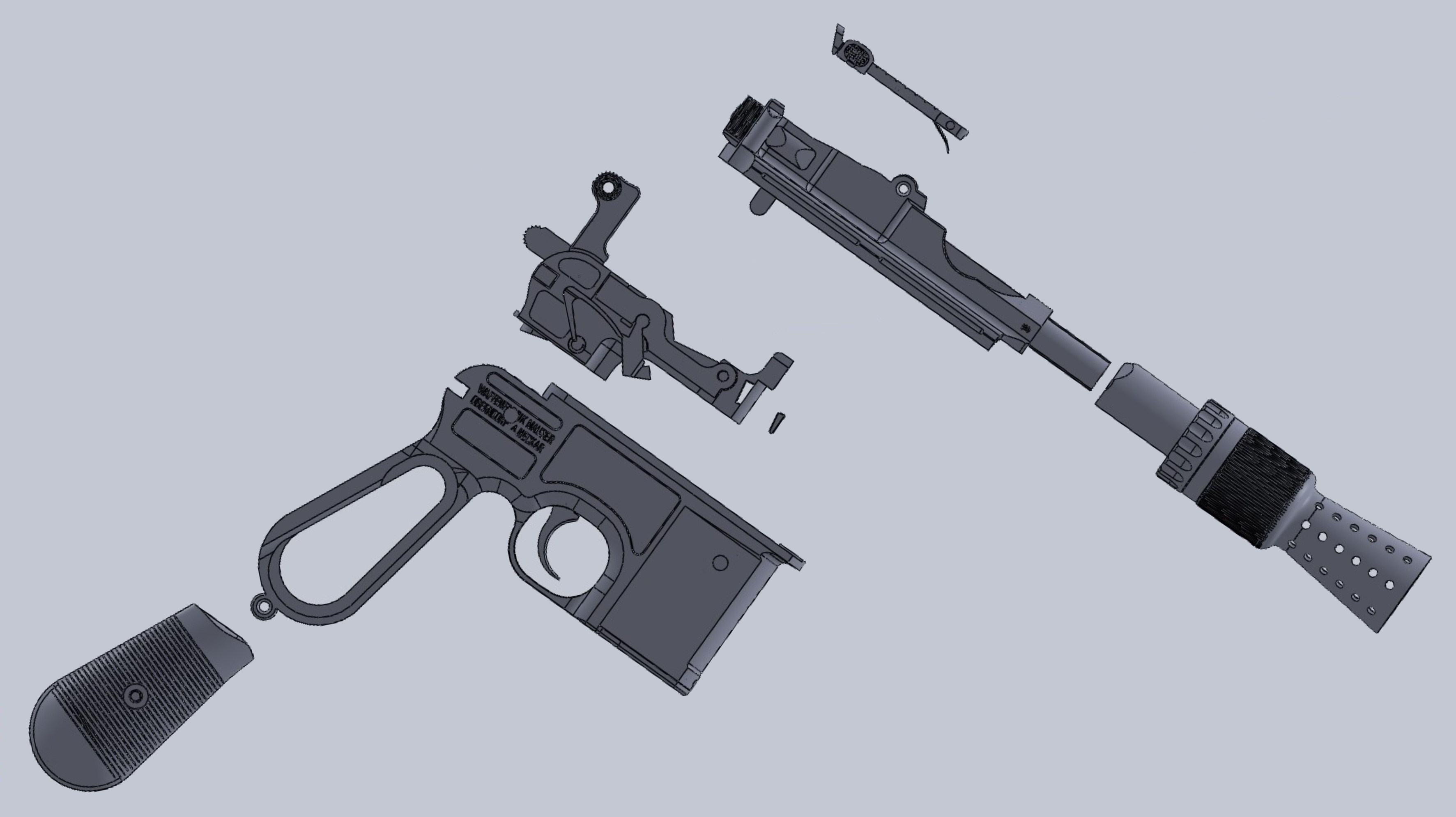

Here is all the parts broken down for this model (except the scope, mount, HSG and such - those are all individual as well). Kind of fun to see it this way..

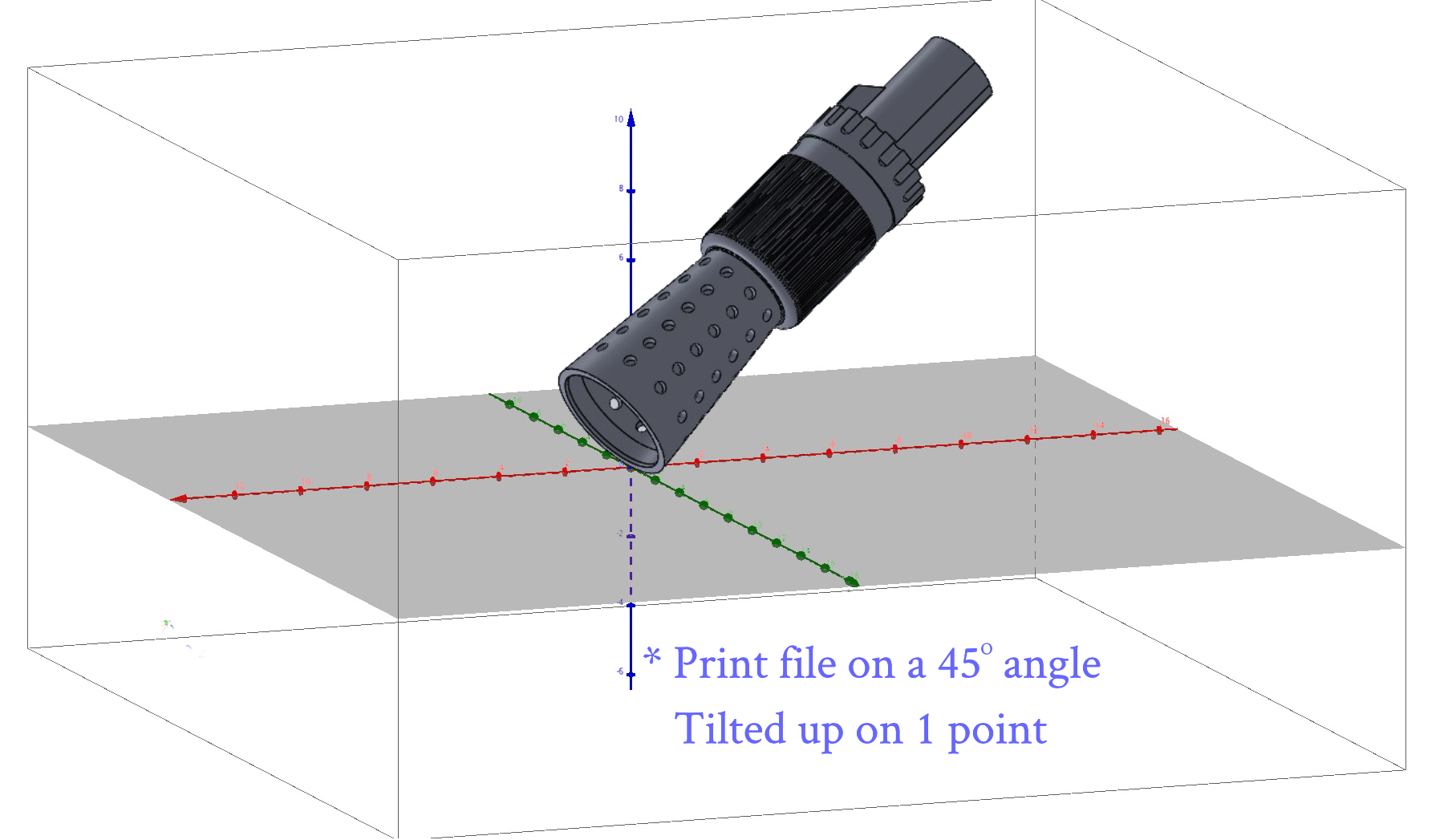

I just need to do the tedious task of orientating the parts for printing to avoid melt pooling. Something similar to this (TFA flash hider)..
