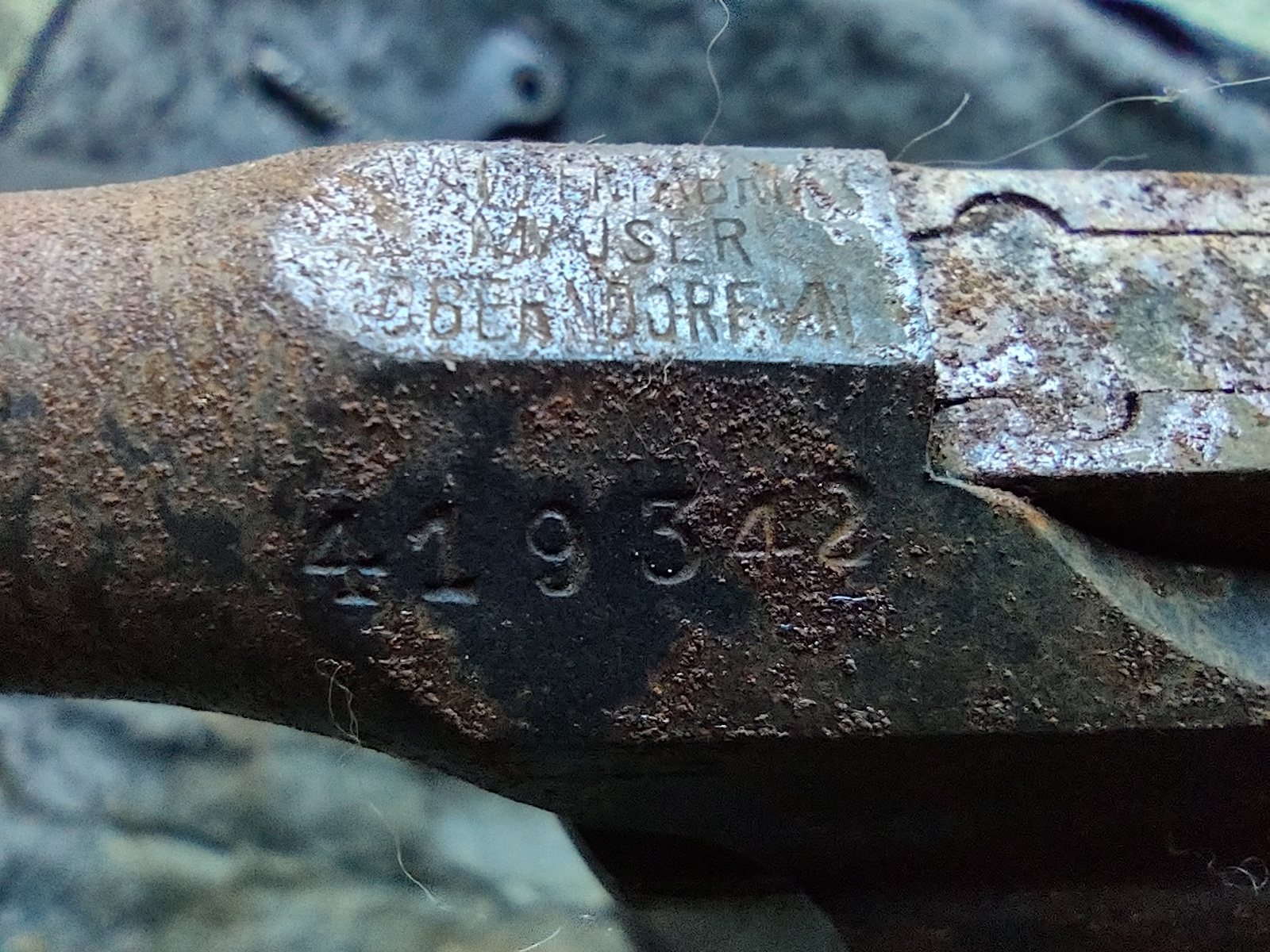

It's a real shame we can't see the rear of the Mauser though. Not just for the serial(s), but even the SN stamp varies in shape and depth as well as alignment of any and all markings stamped in anywhere.

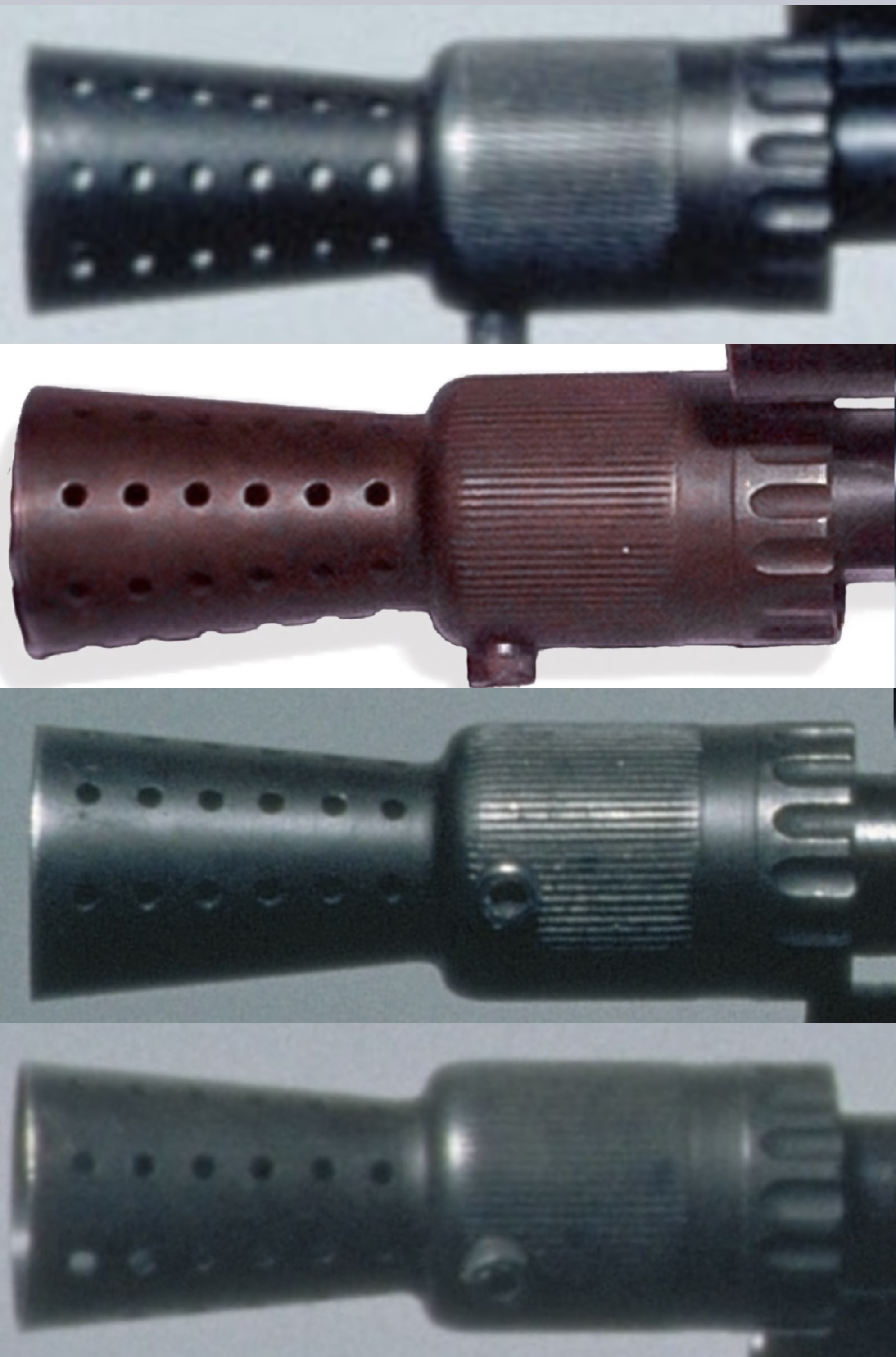

The original flash hider is something to look carefully at, especially at the front-most radius size and transition to the cone, there's some (hand machined) uniqueness there too. OdiWan72 has the closest Real FH variation to the Hero's FH that I've ever seen, barring many similarities to the original..lucky ducky :D

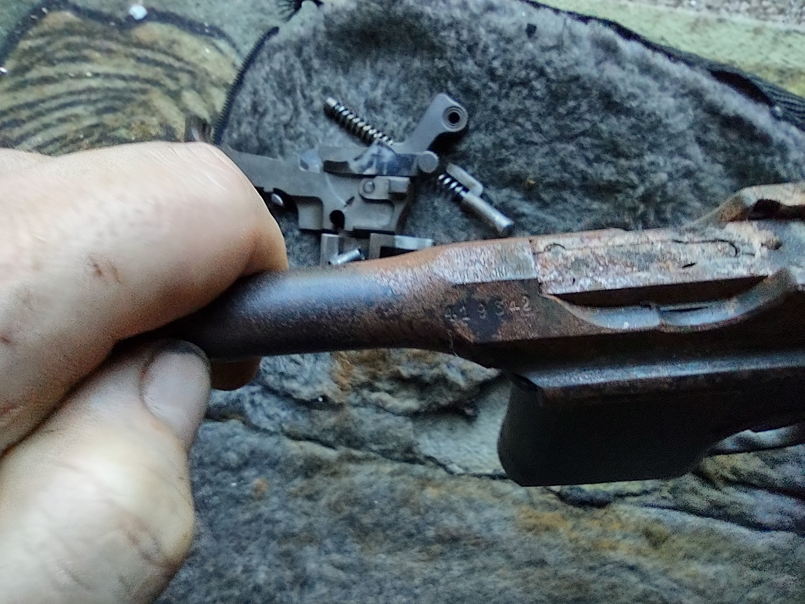

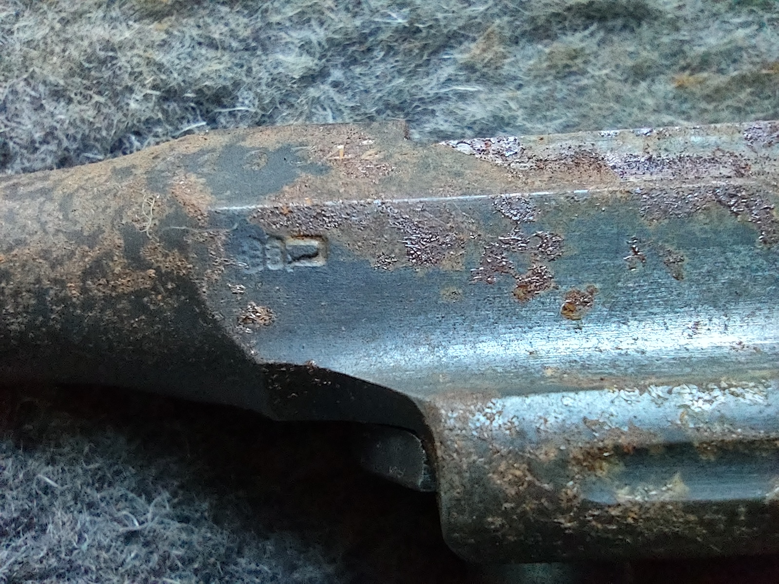

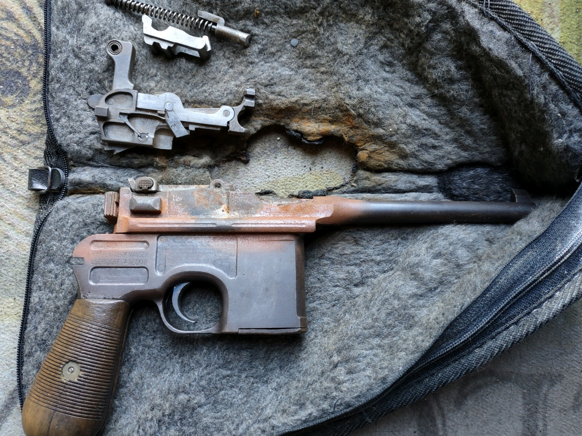

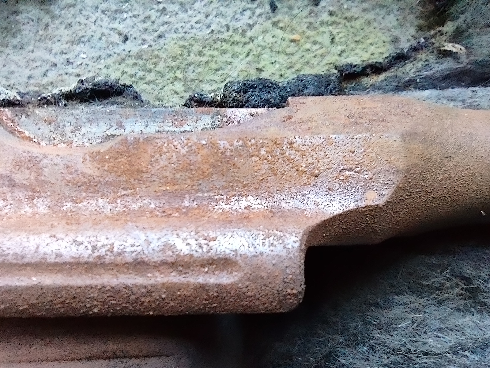

I'll see soon if I can get a decent photo of the proof-marks from my C96 as mentioned. Mine was pretty well damaged by a small house fire a few months ago, so I can't guarantee it's very legible.

..a small house fire a few months ago, so I can't guarantee it's very legible.

Your point about the stamping is well taken. Every picture I have or collected differs a bit from the next. The FH’s radius certainly looks to have more of a radius that your mentioning. I’ll definitely give that another look.
I’ll go see if I can find a pic of Odi’s FH as well for reference. Thanks Carson and again I hope everyone is doing alight.

Sorry for the damage to your c96.
I'm sure it can be restored to a nice finish even if some details are diminished.
I wish I could help you but I'm sure you will be able to bring it back to a beautiful finish.
Try some of those rust removers like Vaporust to stop the surface rust and get down to metal without damage. See what your dealing with.
Post your progress when you decide to tackle it.
Good luck buddy!

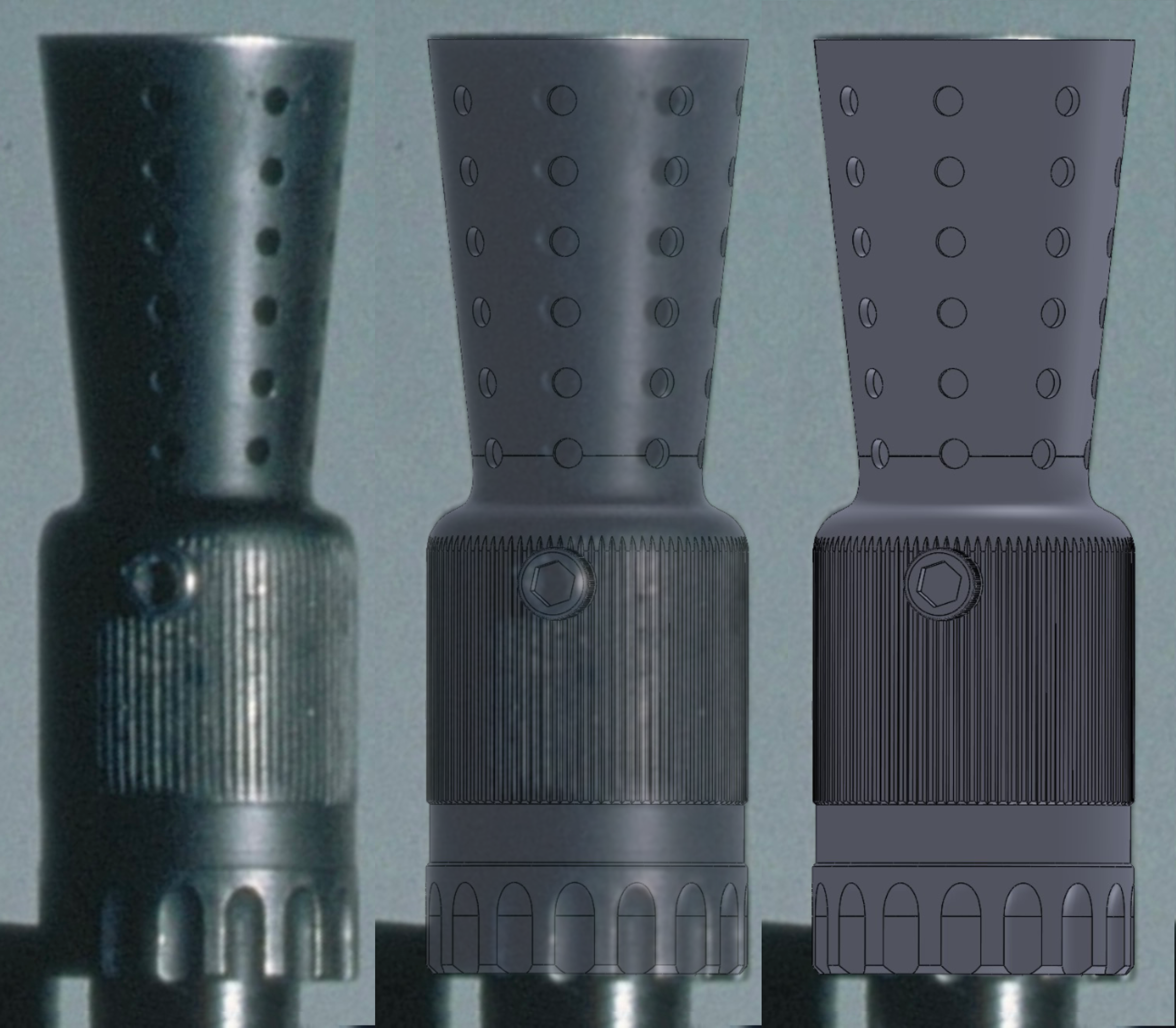

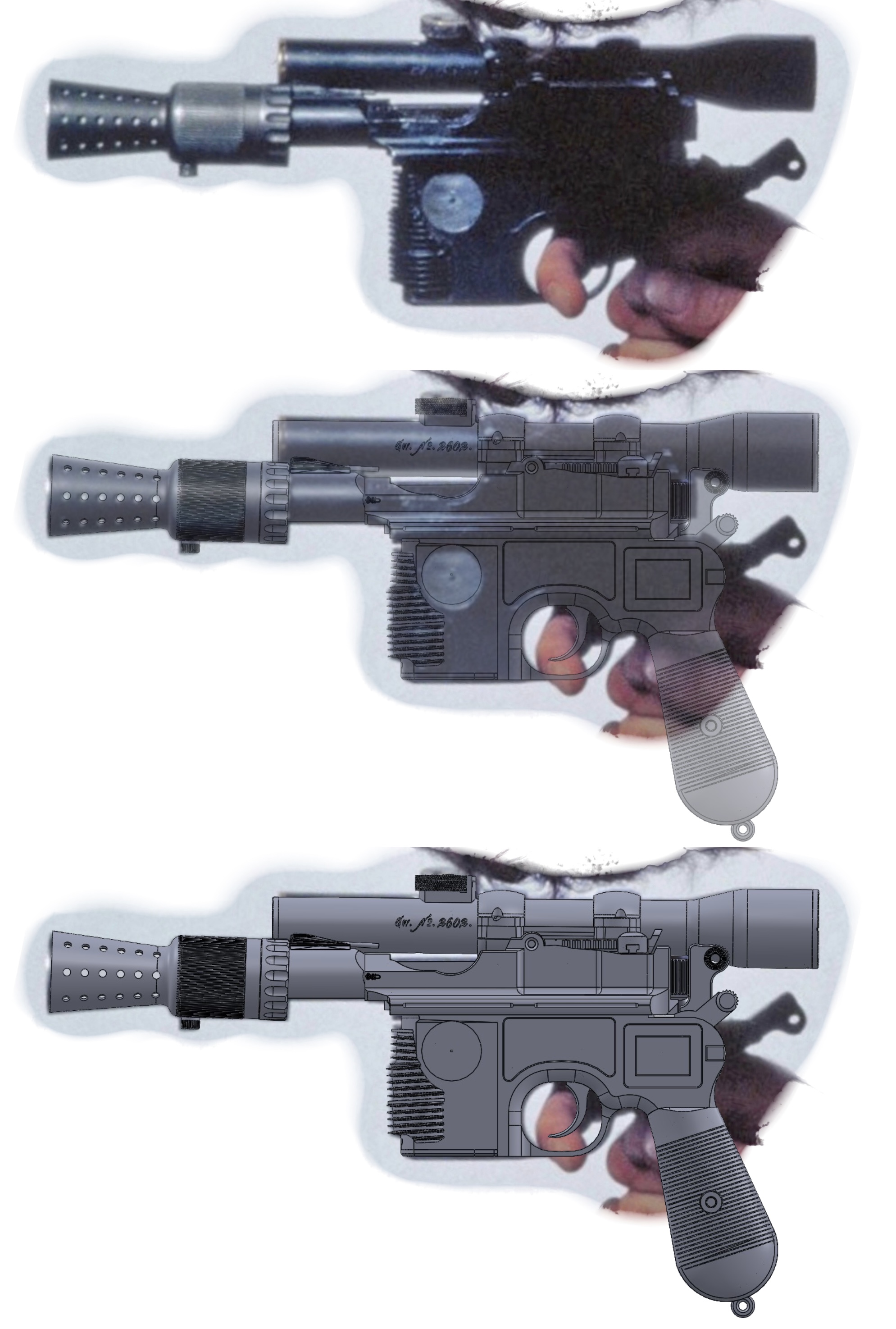

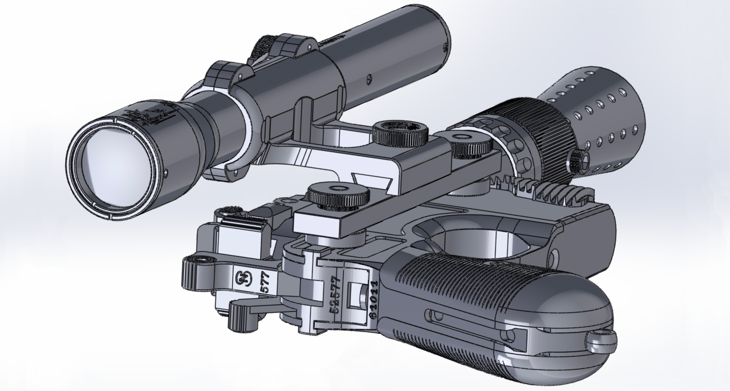

Two steps forward, one step sideways. Spent some time reworking my FH a bit. My diameter is right around 1.3in but I tweaked a couple points, including said radius, as well as rotating the bullets a bit and elongated the cone by about .050 from what I had it before. I think it’s even more so now looking the part..
Looking really fantastic, man!
As I've said before, there's always room for improvement and new realizations. AutoCad which is what I used, isn't perfect for free-form modeling at all. Asymmetries, hand worked stuff and etc. are very difficult to recreate. I always wanted to learn some of the other software that's out there (3DX would be handy to know for full free-form stuff, trooper helmets and such, digital sculpting). I just simply haven't had the time to pour into anther program as of yet.
Keep up the good work!

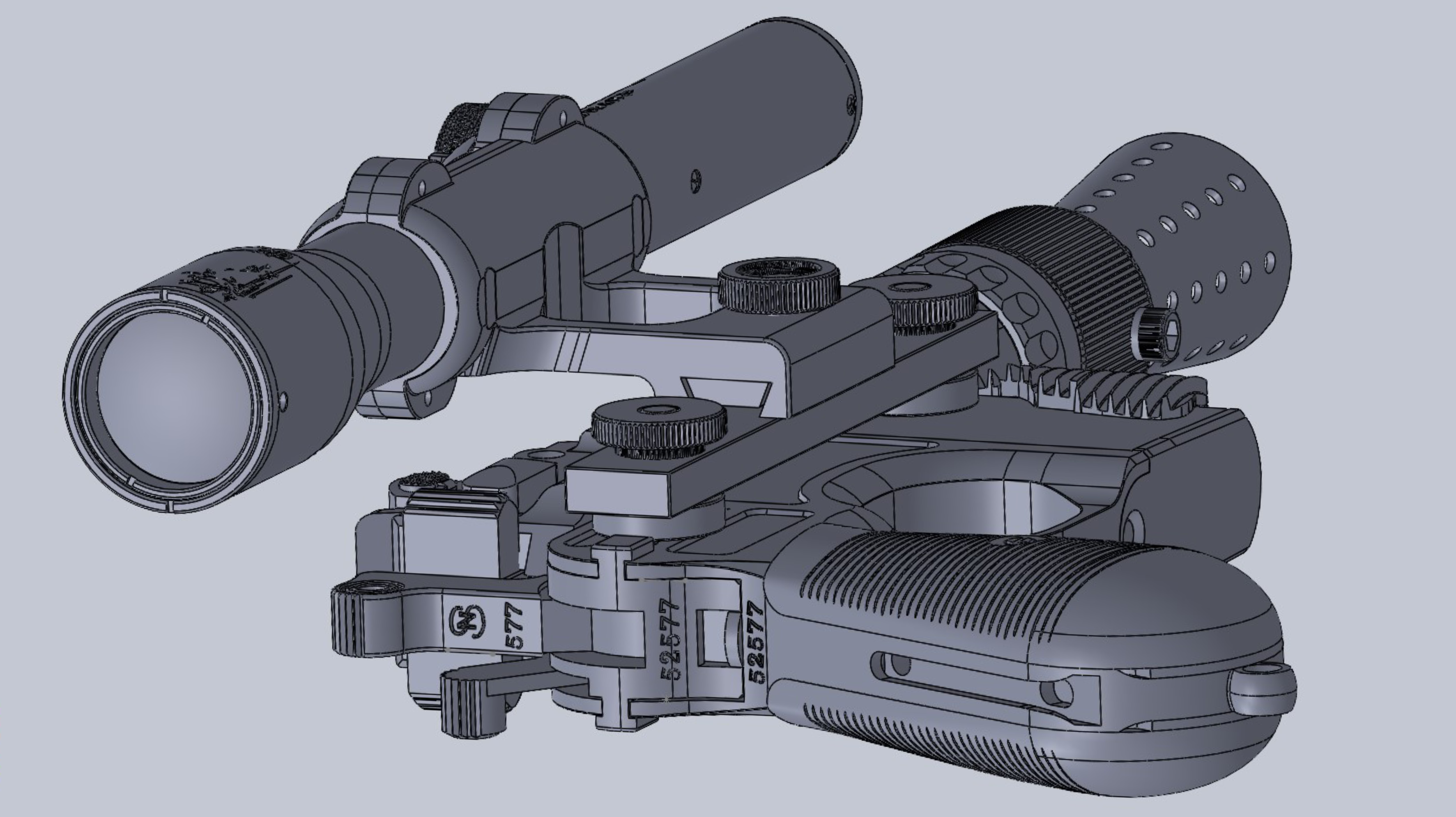

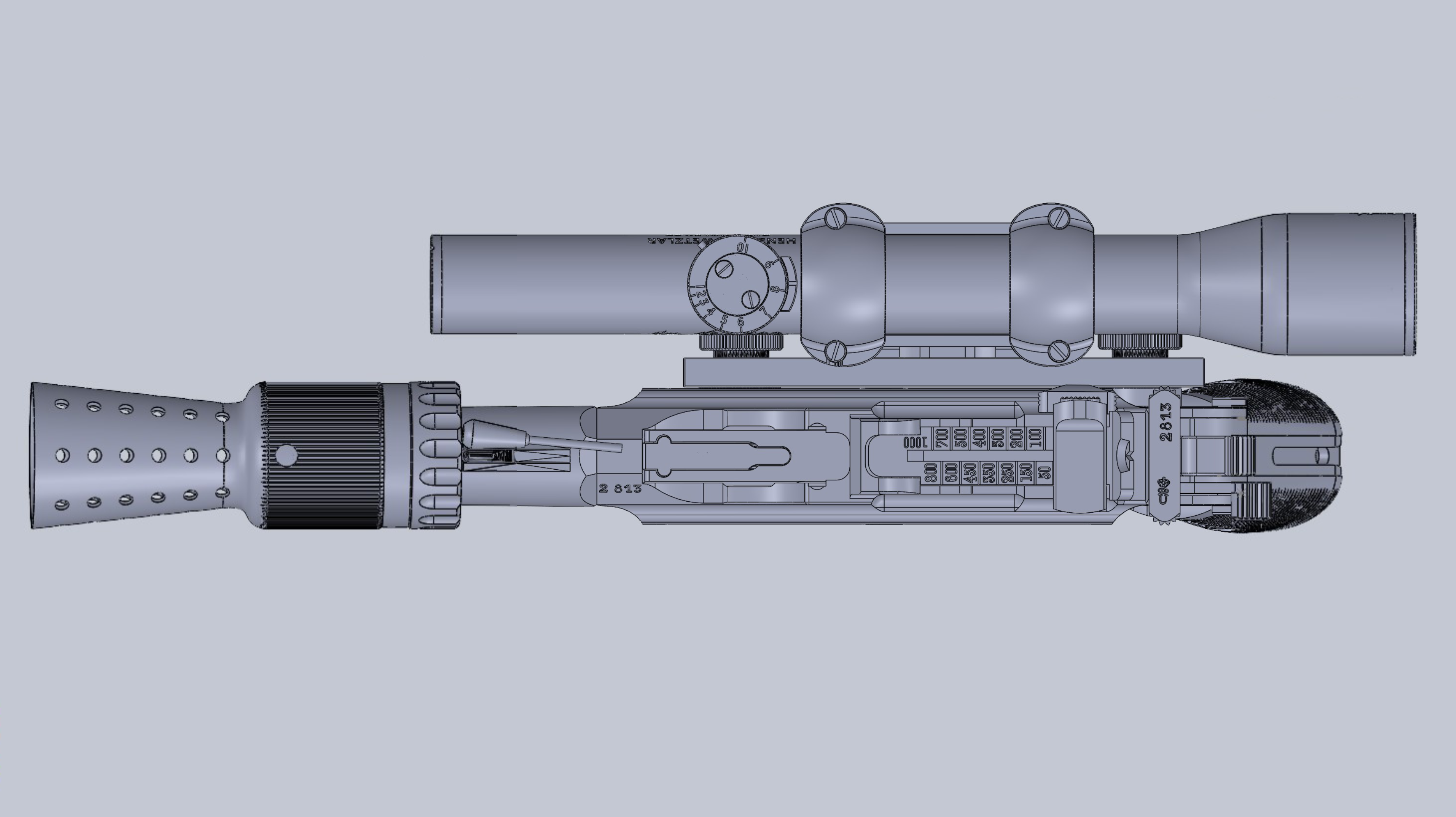

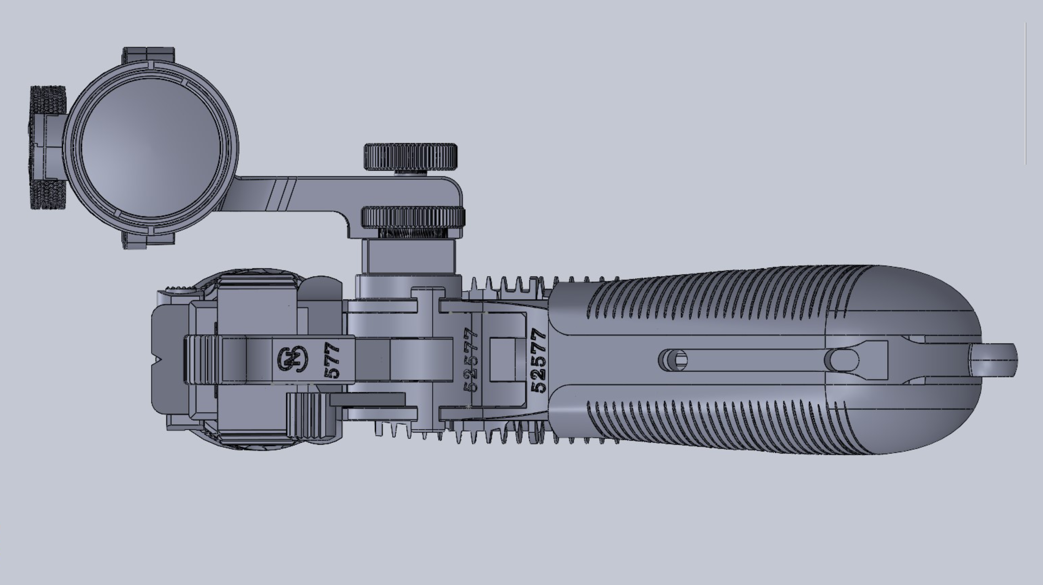

Finally started the tedious venture into redrawing all the stampings. Just finished up the sight. Honestly not sure if it will print in the needed details but it’s certainly nice to see it on there..
Here another small update. The font style is one that needs to be fully replicated I believe. Bottom writing is still the old template for comparison. It’s very clean compared to the top as you can see..
Looking good!
Keep in mind the scalloped rear knurls on the flash hider too, they were originally made with a radius cutter, similar to the one below. It creates a 'somewhat' parabola/egg shape to the front end of those cuts, it makes for two different radius' causing the 'egg' like look..=bView attachment 1592493
This was as close as I could figure those 'bullet knurls'. Also a nice comparison of DEC Dave's replica vs. OdiWan's real Flash Hider:
