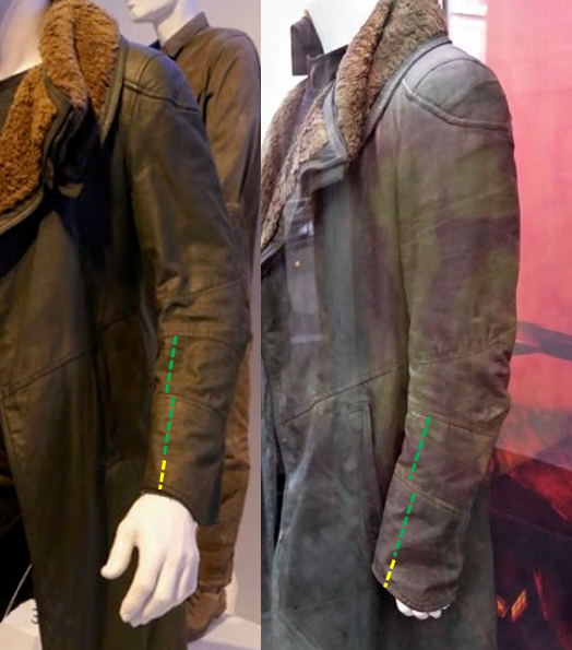

The movie coat's cuff and forearm sections have a specific proportion and a slight angle along the cuff's top edge where they meet. Essentially, the cuff section should be longer than the forearm section. Bearing in mind that the coat dimensions and panel size will differ according to each wearer, proportionately it should nevertheless conform to the same design parameters. So:

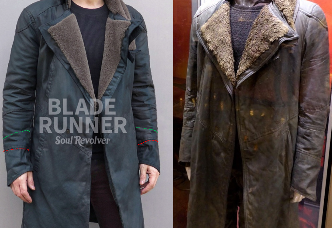

Soul Revolver: X (forearm panel is proportionately longer than the film coat, cuff's top edge is horizonal)
Zlurpo: X (forearm panel is proportionately longer than the film coat, cuff's top edge is horizonal)
Magnoli: X (forearm panel is proportionately longer than the film coat)
WSL:
/ X (forearm and cuff sections similar to film's coat proportions)

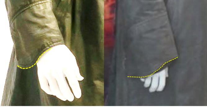

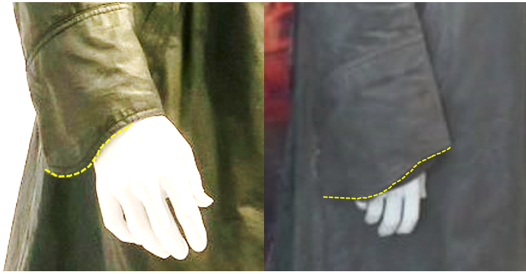

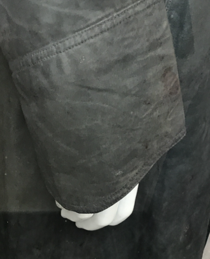

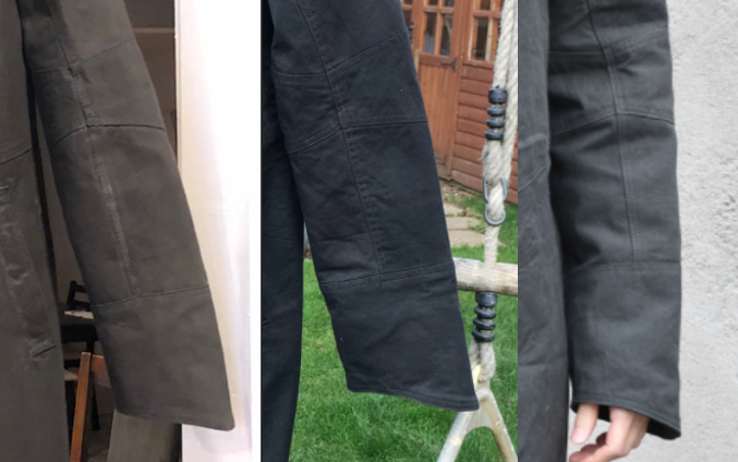

The movie coat appears to have a distinct swoop along the edge of the cuff. This is a harder subject to tackle since the angle at which most pictures of the coat are taken, this isn't always obvious. Here are some photos of that curved pattern:
I've only seen one photo of Magnoli which appears to have this "cuff swoop" but then, surprisingly, it seems to narrow or taper, which doesn't appear to be the case with the movie coat (which is either un-tapered or even widens at he end of the cuff). Nevertheless, that swoop is still there, which is nice to see.
I can only speak for WSL which does not incorporate this aspect to its cuff. So with that said, if you Soul Revolver owners and @Jameel could elaborate on this and the above, that would be great to get a fuller picture.

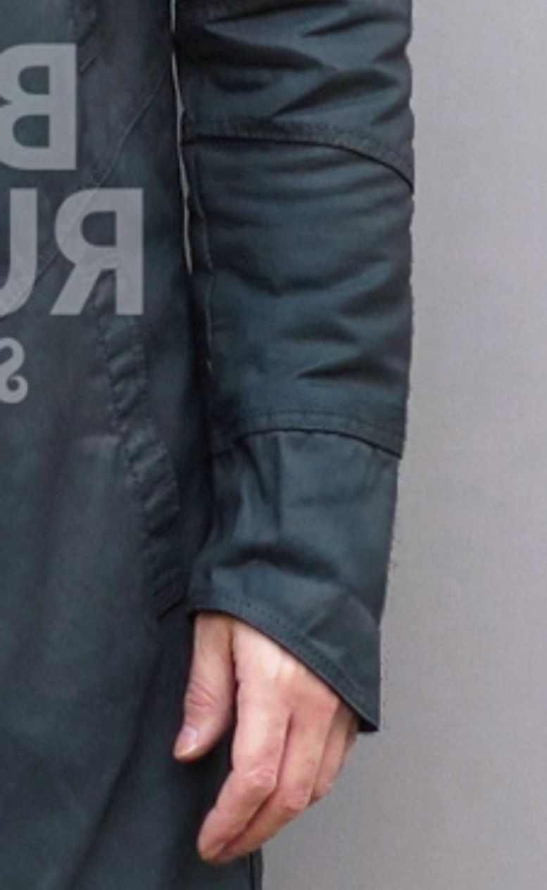

Anyhoo... Since this is an area we really haven't covered yet, all you SR owners out there: it would be great if someone could post some side view pics (like the ones below) of the cuffs to discuss this distinct curvature.
My SR does swoop like that but it is not pronounced in the middle. It is a more even swoop from seam to seam without the pronounced high point . So I am gonna say it’s there but not quite screen accurate.
Do you think you could post a quick side view pic of the SR cuff when you get a chance? Thanks!

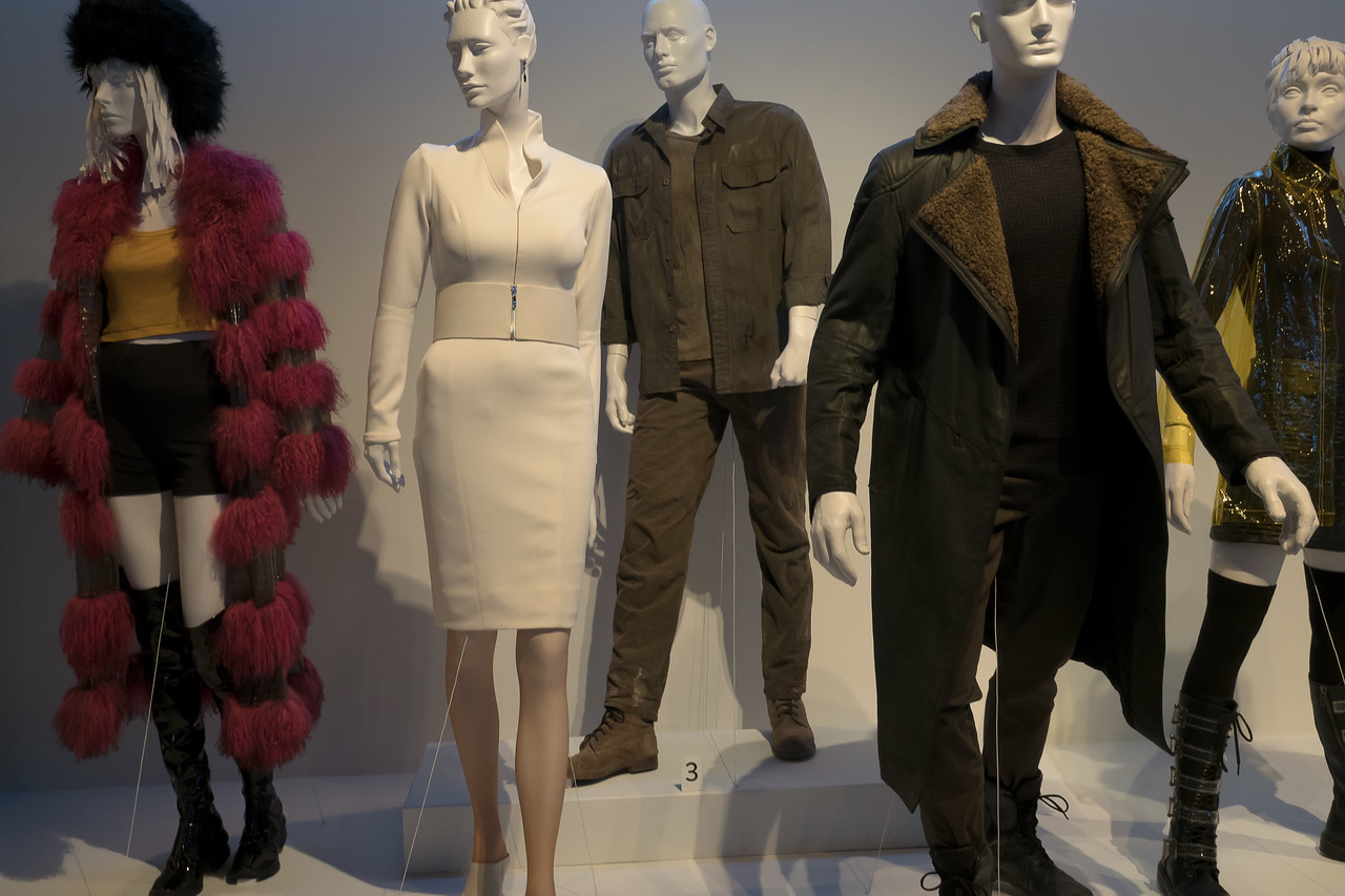

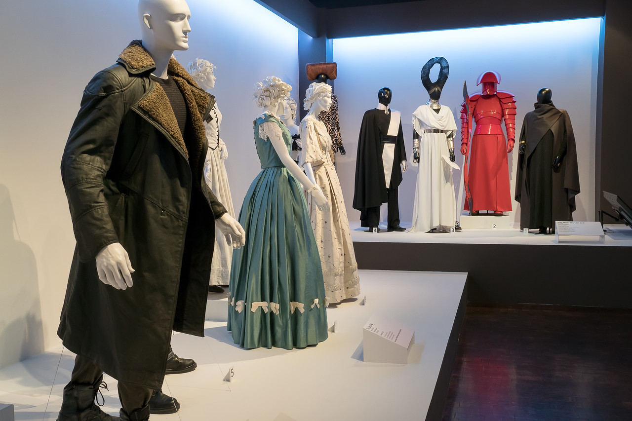

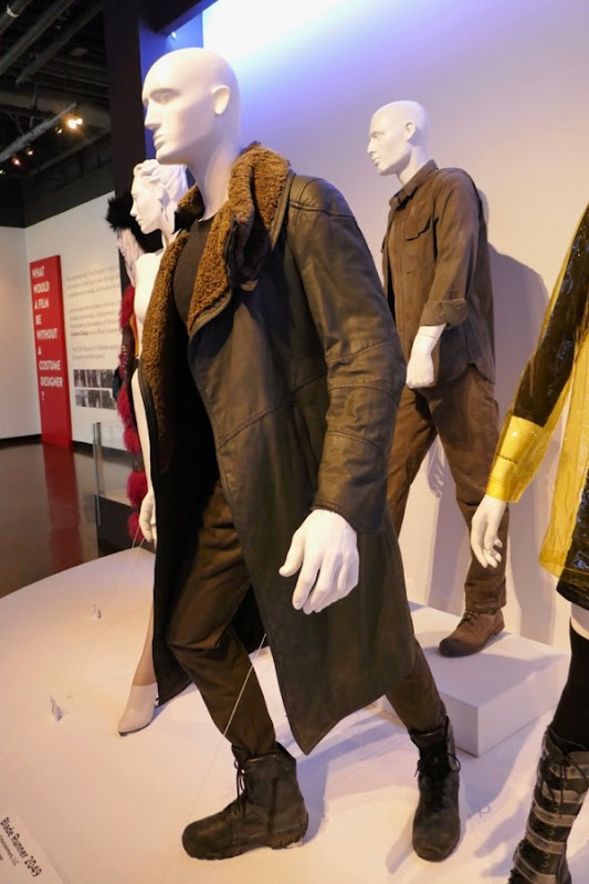

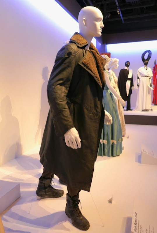

First: careful about the "curve" of the sleeves. Take a simple shirt with French cuffs, put the cufflinks on and see how the sleeve "curves" on top of your wrist. The fabric of the coat doesn't "fall" normally like other type of fabric.
Second: some of the pics, showing the original costume are not properly placed on the right mannequin. Museum quality mannequins are a + while doing your research! Same shape/height of the actor, arm length, sweater on, etc.
Third: it's possible that the sleeve has a slight angle (not curve) from front to back sweep.
All of the pics are from the L.A. Museum of Motion Pictures - Fashion Institute of Design & Merchandise.

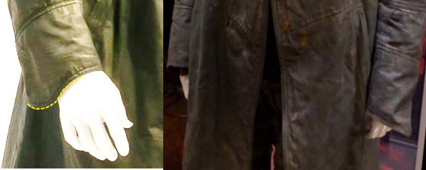

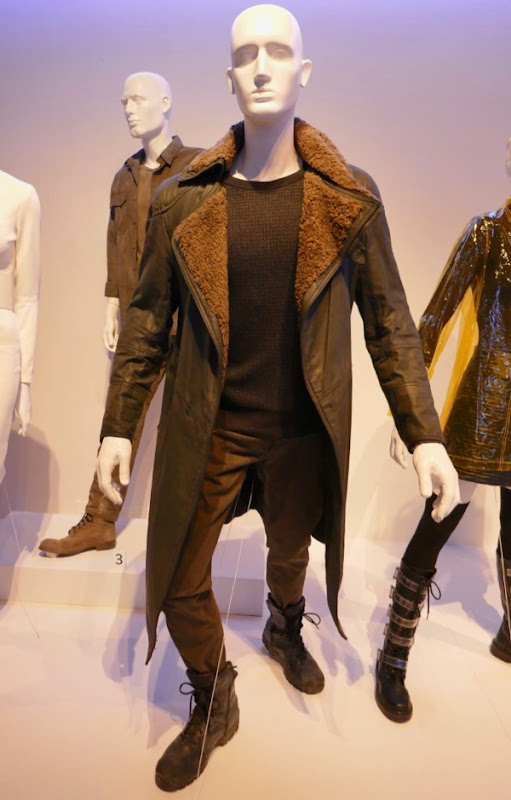

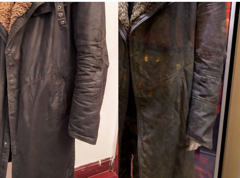

Are those cuff looking same size?View attachment 1541649
Here's another view of right hand cuff (of the coat on the right):
These are both photos of the film coat prop displays and I agree, they seem to have different cuff sizes with the coat on the right having a longer cuff (and most likely, a longer sleeve in general) . *This is interesting to note about the 15 production coats and how they weren't necessarily identical.
However, having said that, this also speaks to my point from yesterday: no matter what size the sleeve size may be, the coats show how the forearm section should be proportionately shorter than the cuff section. So this...
...instead of this:

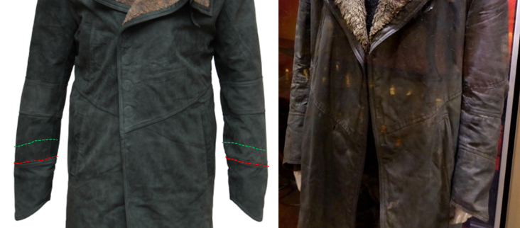

Regarding the cuff section, the pattern on the movie coat seems to suggest that the top and bottom edges run parallel, at an angle. However, Zlurpo's current coat and Soul Revolver appear run at an angle along the bottom edges but horizontal (or exactly perpendicular to the central sleeve seam) on the their top edges, rendering this section asymmetrical when they should be (more) symmetrical. WSL gets this pattern correct.

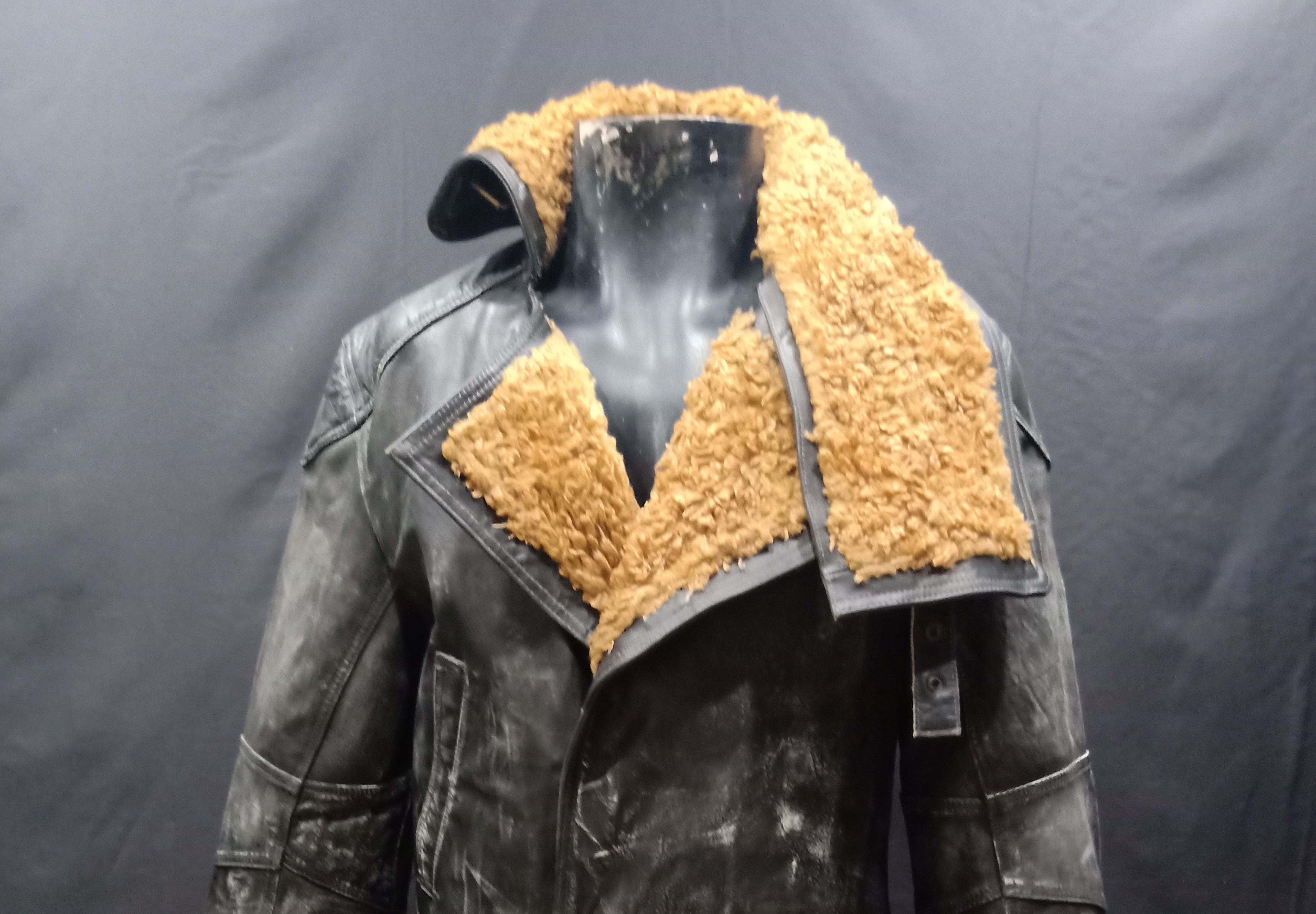

Dear Mechanismo again, you took wrong angel image as I saw our collar image somewhere in this thread.
Please don't messed up coat shape,
Your suggested cuff shape is wrong, please take look at reference.
