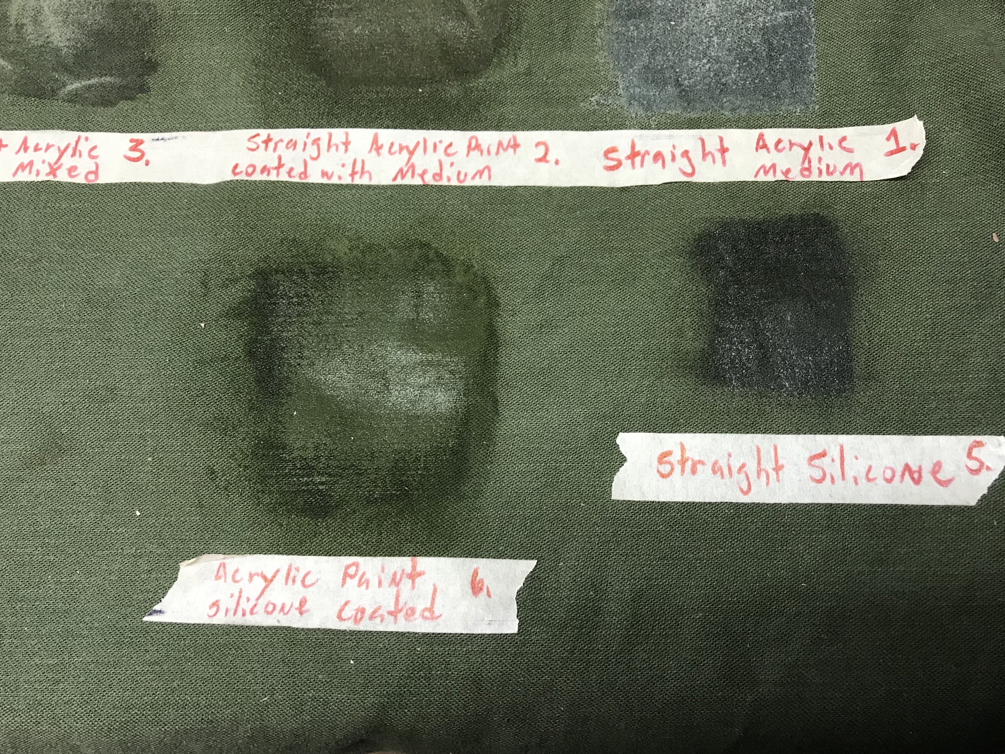

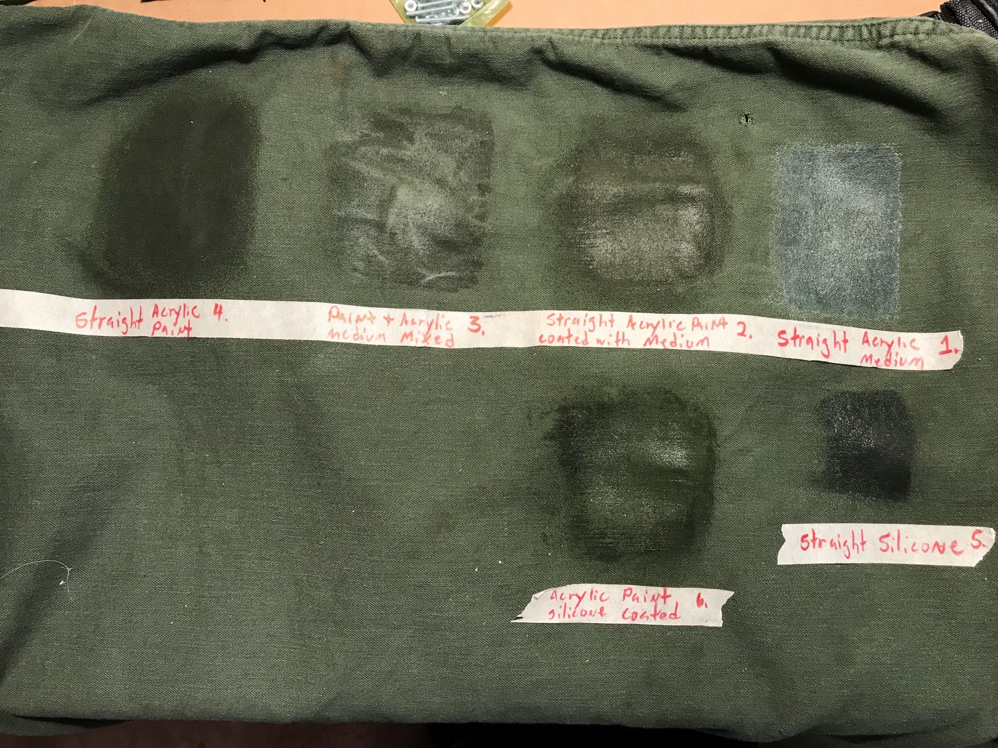

Ok, here’s my take on the laminating fabric discussion. I’ve tried many variations of acrylic mediums, I am using a product that’s meant for awnings to seal them and still be able to flex and move with the varying winds and temperatures. I’ve used it straight out of the bottle, thinned it by 30%, 50%, and even added color to it. I’m sad to say the acrylic mediums leave the canvas material I’m testing, crunchy and ruff like hardened material. It really doesn’t flex or wrinkle like what we all saw in the movie. What I have tried next was, I used acrylic paints to get a color I’m feel is close to what I think is suitable. I thinned the consistency down by 30-50%. I wanted it to absorb into the fabric, not soaking it, but not just sitting on top. I only did one coat (making sure I saturated the area). I forced dryed it for time purposes only. I then took a clear silicone and thinned it just a touch, and literally worked it in to the paint fabric the silicone results are by far the best in appearance and feel and it moves like leather. Next I plan on trying the same meathod but using a wax instead of a silicone.
View attachment 790508View attachment 790507
I'm really digging the color on #1
