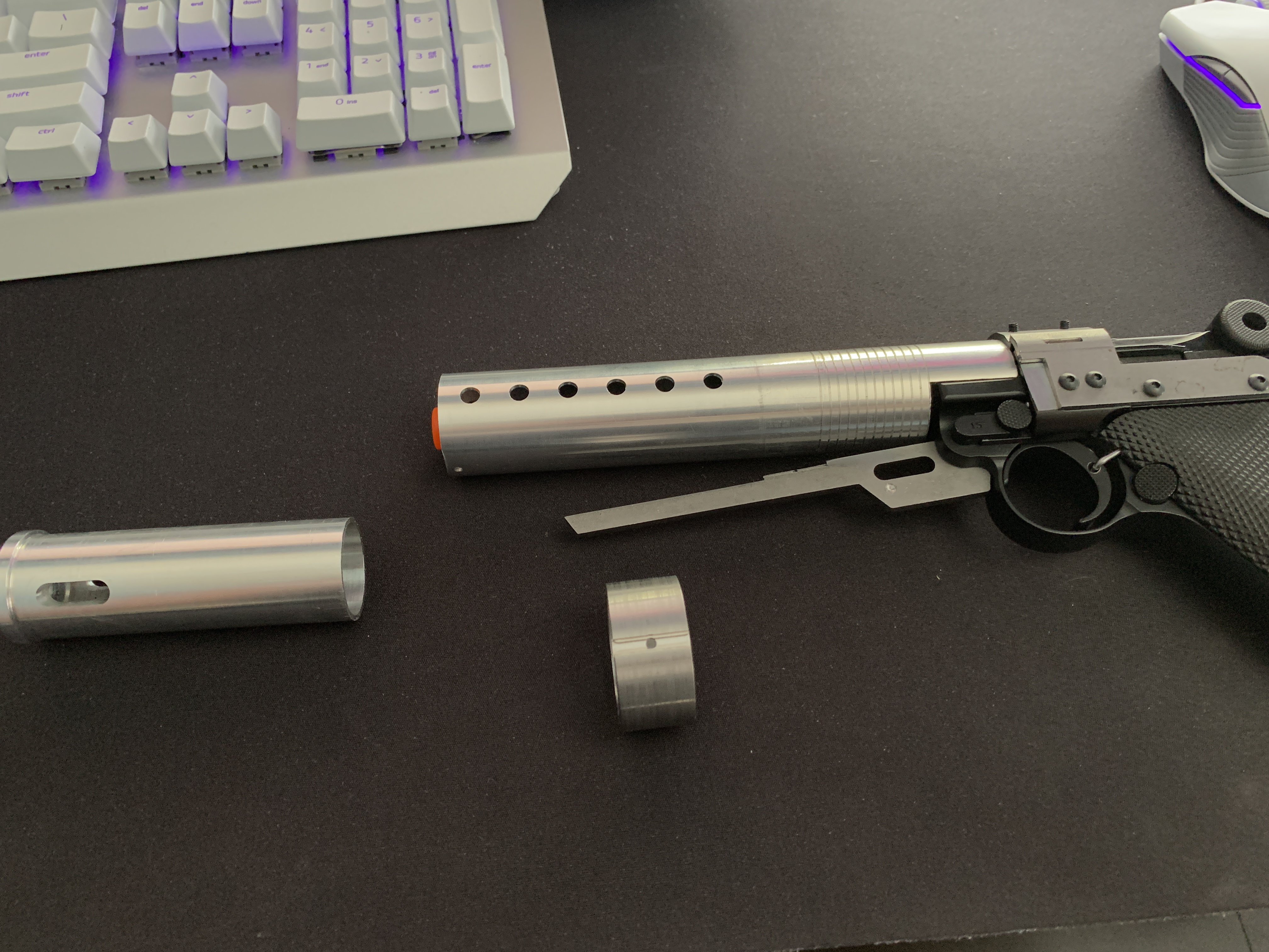

Got my War Machine A180 in yesterday! This thing is fantastically accurate! For any of you that have this one, did yours come with screws for the barrel tip and band? Mine aren’t screwed into anything and I want to secure them before I start weathering it...
You’ll need to epoxy the band to the blade. The tip should have a grub screw
Yeah, I saw the epoxy in FM's build but since there's a hole in both the blade and the band I wasn't sure if it would be best to just use a set screw instead. Also the tip doesn't have any screw.
There should be a TINY grub screw for the barrel tip. Maybe it fell out?
I re-tapped mine for M3 and made a custom slotted grub screw for mine.
Just use a little dot of glue on the barrel band. You never know when or if you want to take it back off. The dovetail should fit relatively tight.

Yeah didn’t come with a screw for the tip. I just ordered a tap set and i’m gonna do an M2 or M3 screw in it. I ended up using some two part epoxy on the band! :)

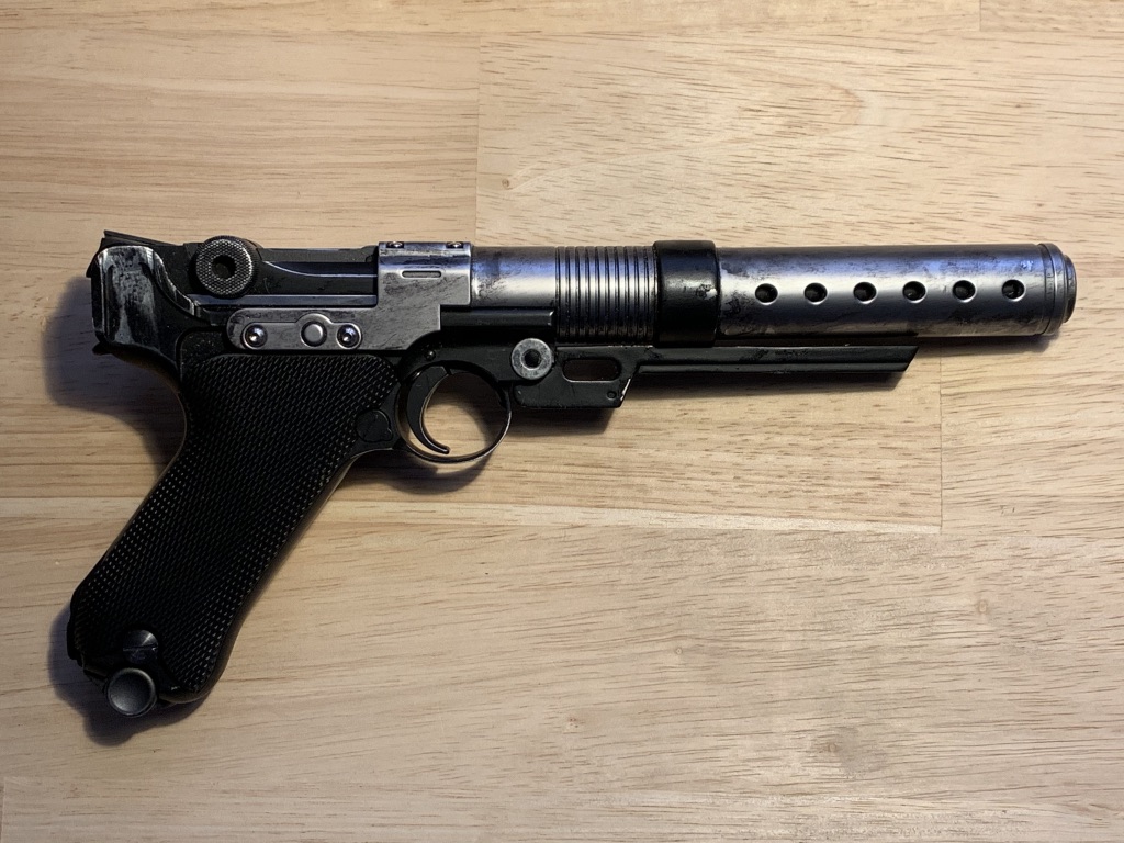

OK here's my take on it. I have has this Evike kit sitting around for over a year and decided yesterday to put it together. I know it's not 100% screen accurate, but I already had it so I figured I ought to use it. I tried to add enough details to make it respectable. I almost replaced it with the War Machine kit as a little more screen accurate and easier to pain with the separate pieces, but all in all, I'm pretty happy with it. I think only I and the people who have studied this thread will note the inaccuracies. I had some WWII Bakelite grips I wanted to use instead but they are made for a real Luger so would require some real modification to use. They are not screen-accurate anyway but are more substantial than the plastic grips on this weapon and I feel like production would have gone for them if they had them. Maybe someday I'll figure out if I can make them work.

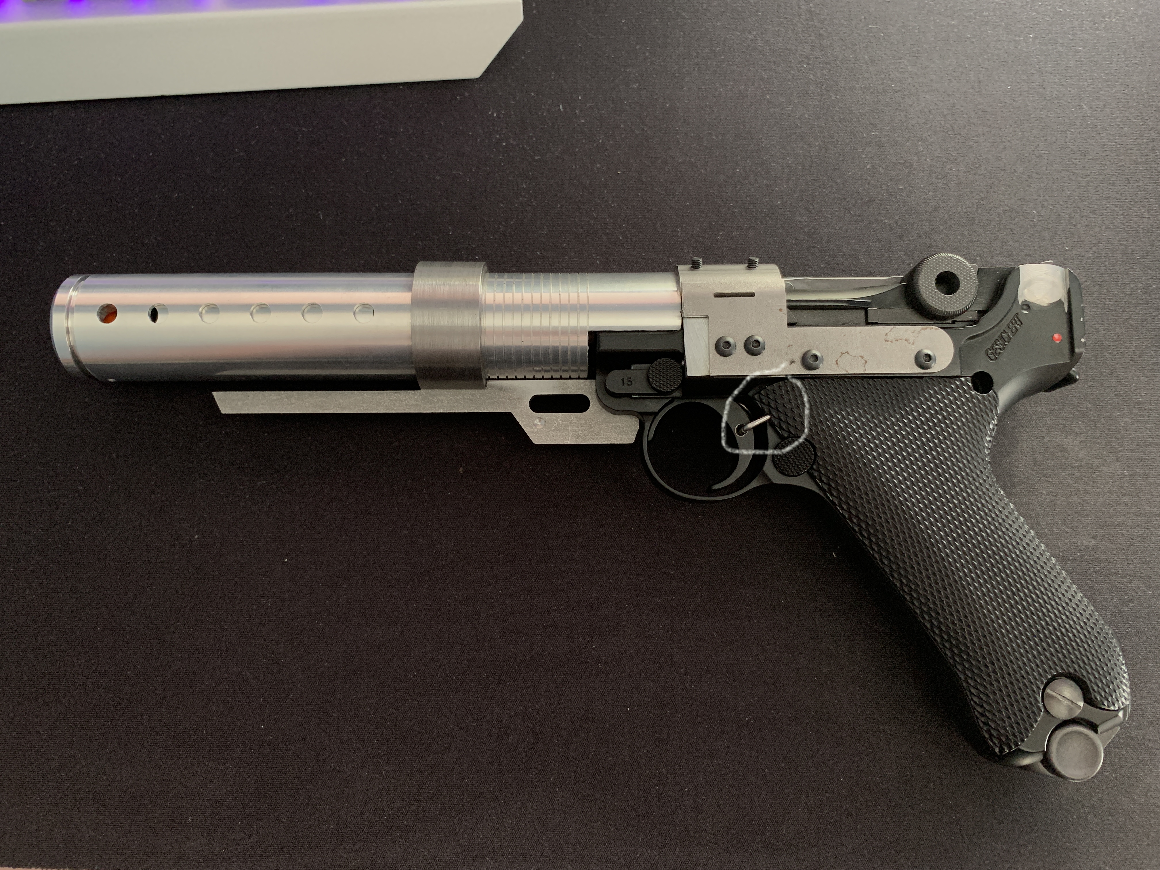

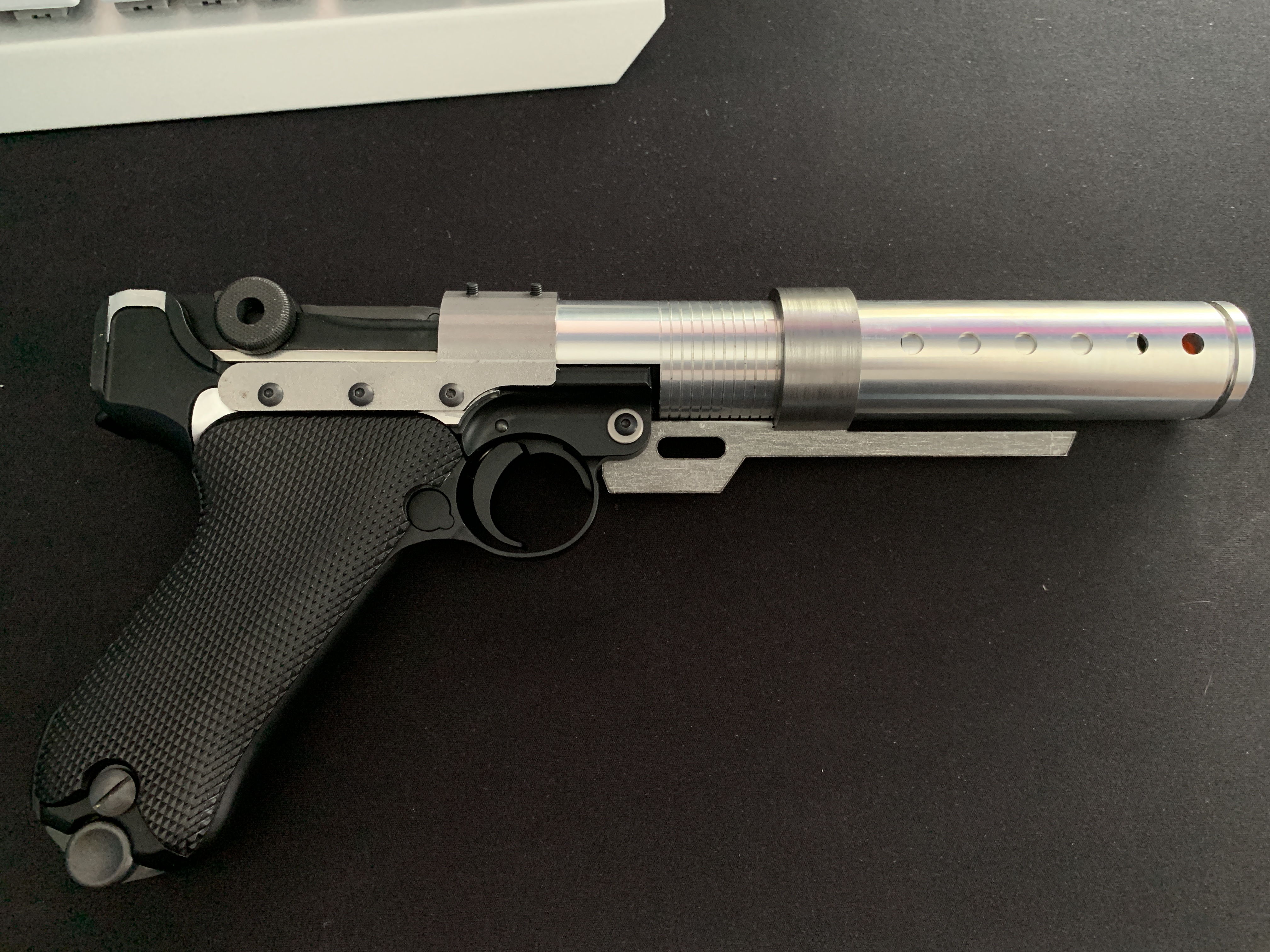

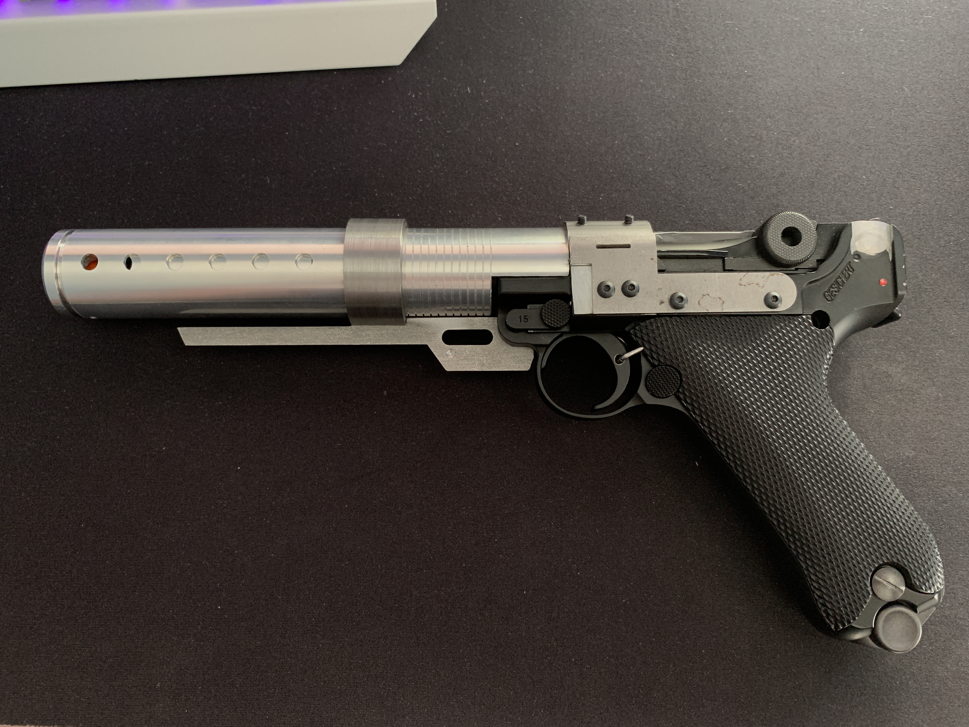

Using this thread as a little guideline, i tried my own approach on the Blaster Pistol, made a few adjustements that i liked more like rivets instead of screws, but i think i got the overall look just right.
Everything is made out of metal, mostly aluminium, no kit used, base was a P08 from Denix.
