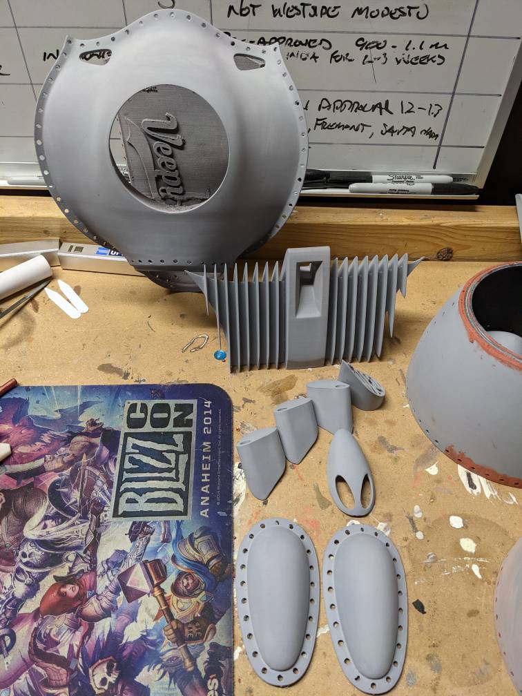

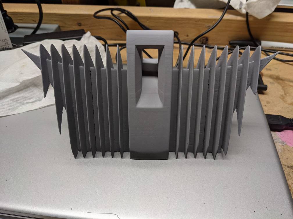

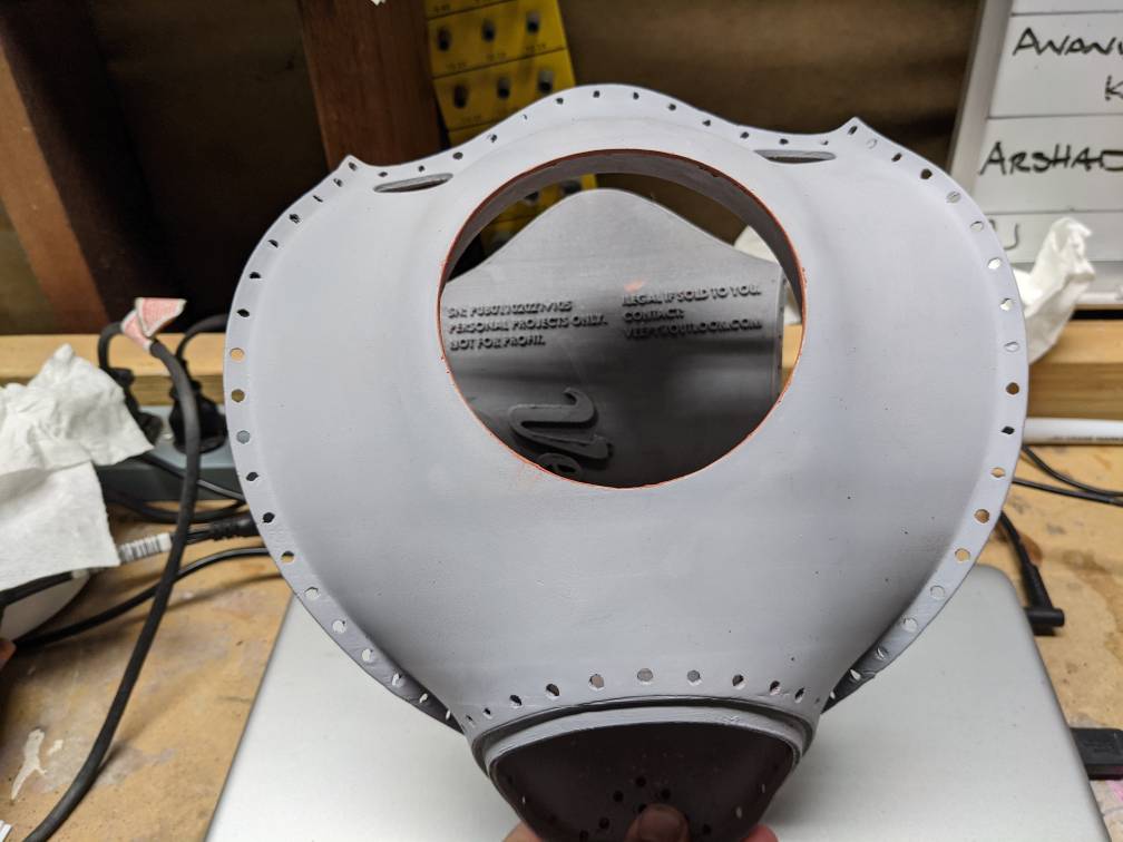

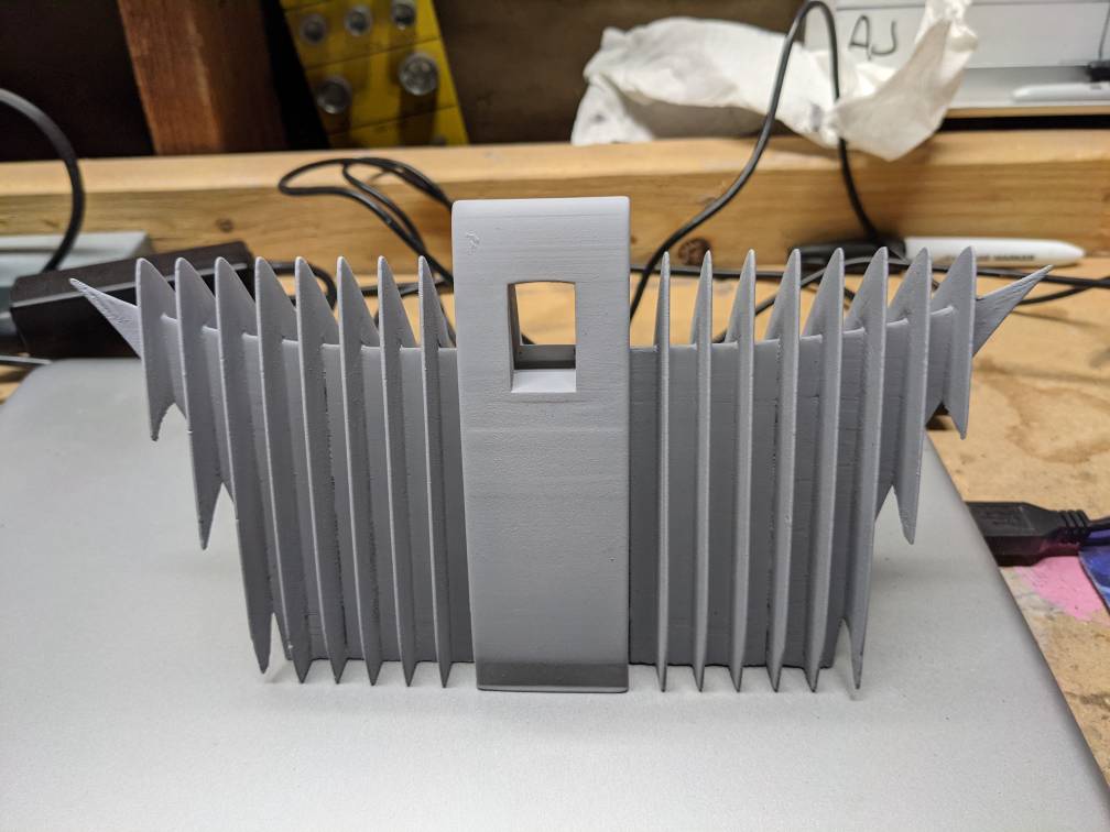

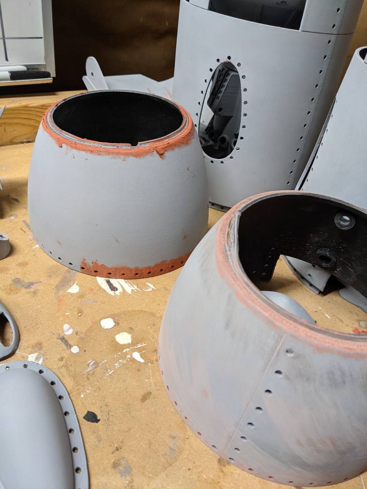

I've made some progress. I sanded, puttied, and primed the hull. It will need a little more work as I still see some print lines. I was able to get the radiator sanded, puttied, and primed as well. But it still need slot of work. I see far too many lines. I finished all the small parts they are ready for paint. I've worked on tht cones a little, I made the edge a little more square so the top cone fits better and the gap is more even (this was due to printing not the model).

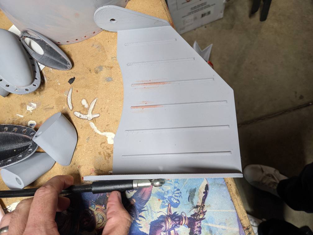

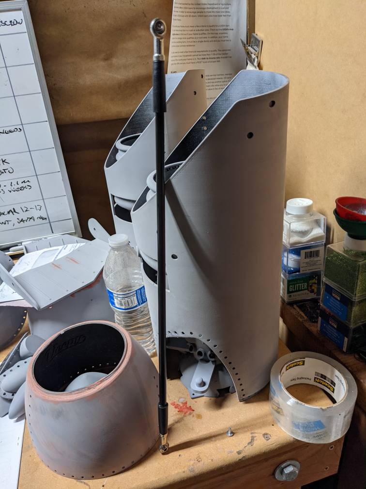

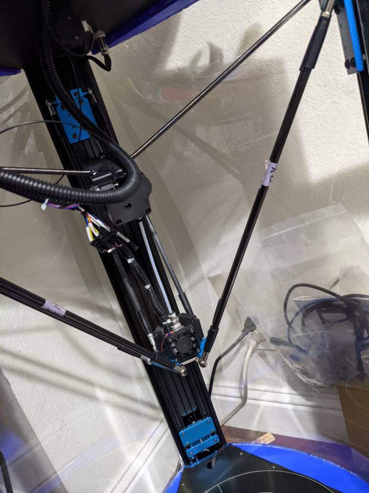

As for the flap rods, I think I'm going it use some spare arms from my printer. The rodents are almost the same size. I will be cutting the black sleeve to where my thumb is in the pic where it's next to the flap. Not sure how it will look finished but I'm going to test it.

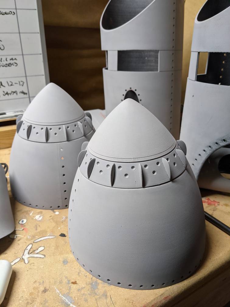

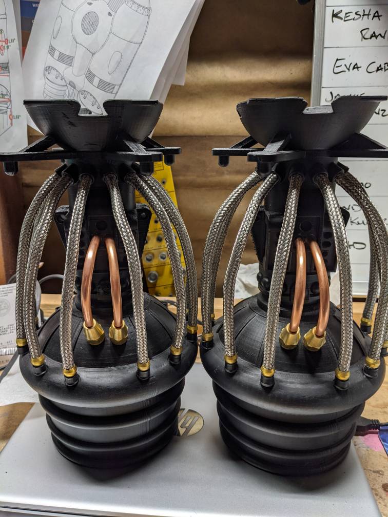

Yep! I was waiting for the engine parts to come in. I installed all the lines, nuts, and rings. I ran out of braided line so I only did the fronts for now. I also got the hull 98% done, still has a few imperfections Im going to fix. The radiator has been taking some time, its about 80% done. I need to give it one more round of spot putty and sanding then is should be done. The cones are 99% done, taking these pictures I just saw a few more spots that need to be fixed.
I'm going to finish up all that and then give it a high gloss black base coat. I haven't fully decided on the silver yet, but leaning towards this one: Alclad 1oz. Bottle Polished Aluminum Lacquer - Hobby and Model Lacquer Paint 853328001057 | eBay
They also have a dull Aluminum, might have to get both and do a test run.
I also have the fan and motor on its way. I'll post those when I get them installed.

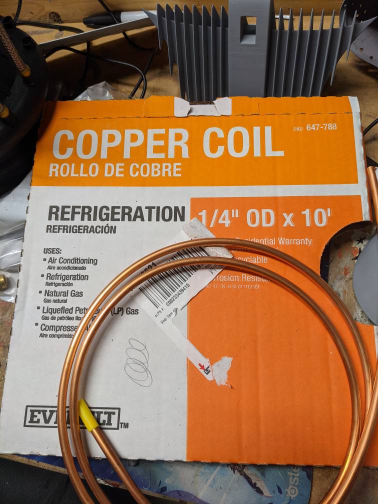

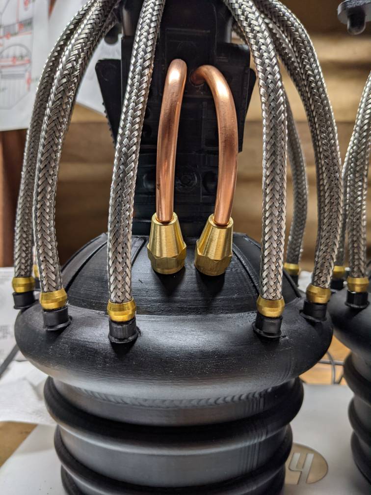

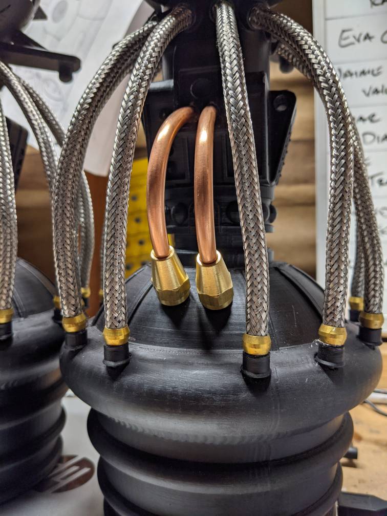

Where did you source your braided line and was it all a good fit into the existing holes?
I got the one from your link, it fit perfectly. It just took some time because when you cut the line all the strands start to fray out. There was some blood that went in to this cause the strands kept poking me lol. Also you will need more than 10ft if you want to go all the way around the engines.
I got the flared nuts and the compression sleeves from this site for $16 shipped:
Www.DiscountHydraulicHose.com
Here are the model numbers:
341-04 - Flare Nut, Long, 1/4"
360-05 - 5/16" Brass Compression Tube Sleeve
The copper pipe I got from Home Depot for $10
It works great cause its really easy to bend. I didn't see anything shorter than 10 feet but I figured I'd use it on another project some day.
The last pic I posted with it setup and displayed with the map is where it sits. I have the tubes to connect to the engine but I am still kinda burned out on the build so I have started a few others things till I get motivated again :) Till then its setup like it's being worked on with blue prints and the other parts laying next to it. Not sure when I will go back to it, hopefully when you finish yours I will get motivated ;P
