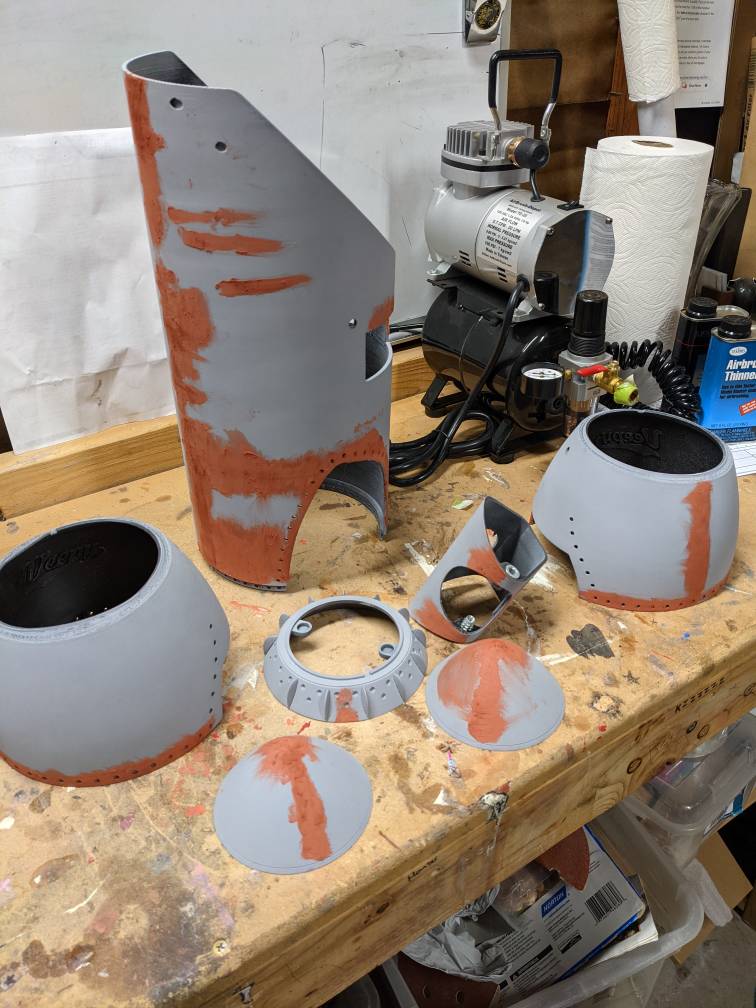

I have a small update, I was able to spot putty all the inconsistencies.

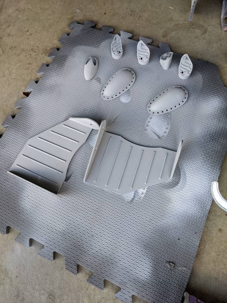

Also made some progress with sanding and painting the little parts. I've been going a bit slow as work has picked up for me but also I like taking the time in sanding and filling. I don't want print lines on the final product.

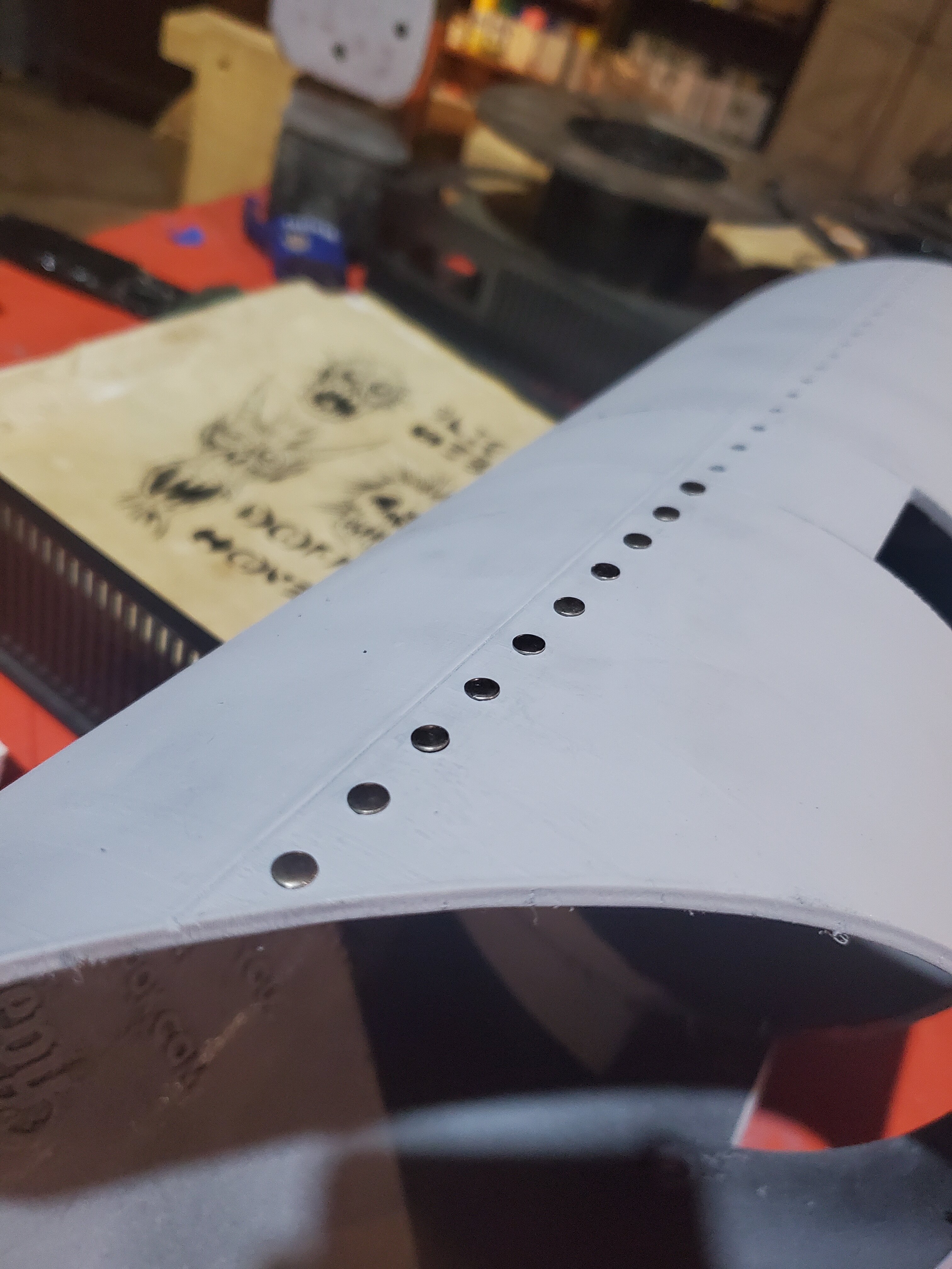

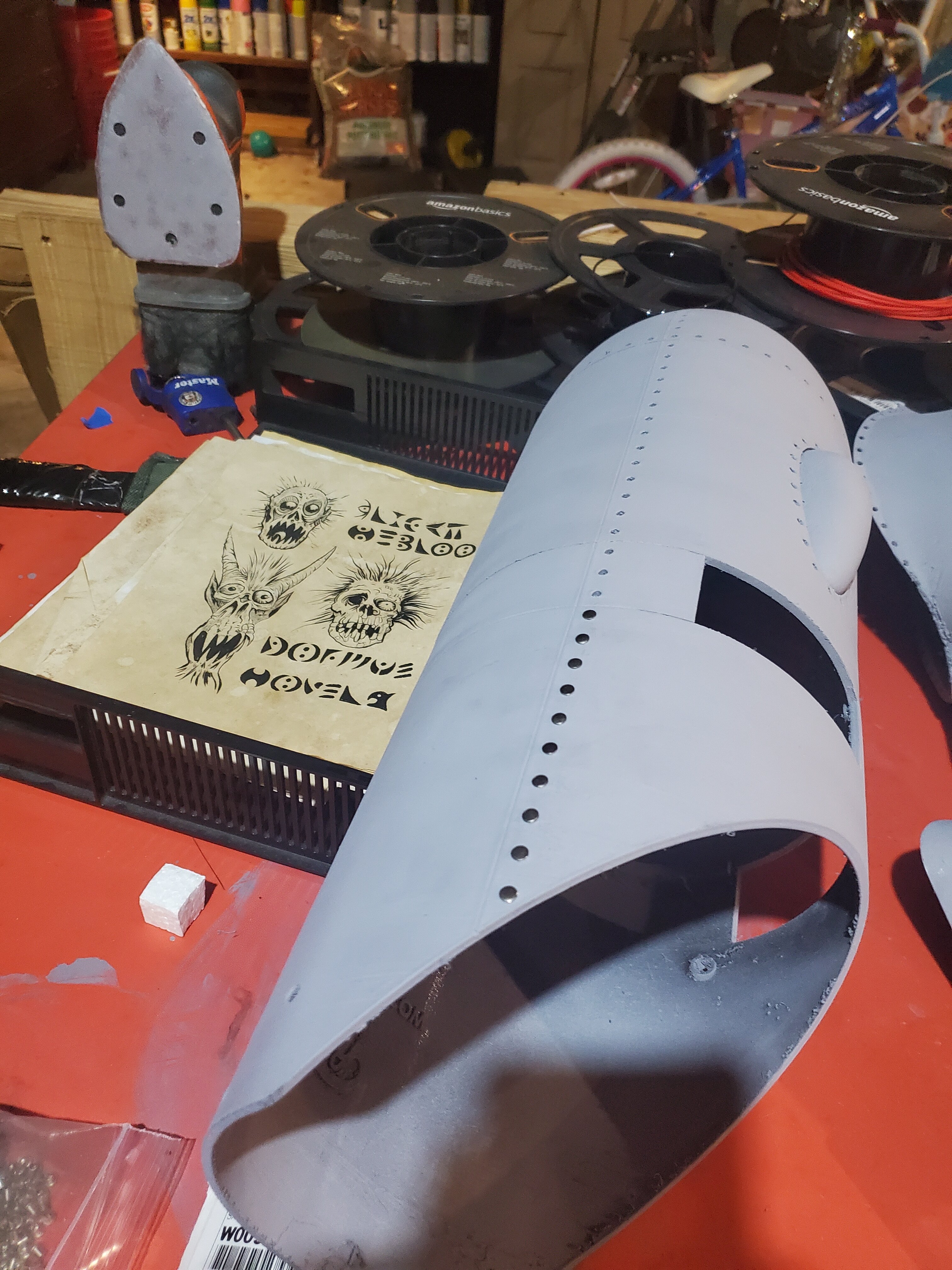

I ordered the rivets recommended by Ginolivos in his veepy files and they are perfect, and omg just this row took forever to put in not looking forward to dropping 300 of these lol.
Glad you like them. I dimensioned everything based on those rivets. Every detail counts. Nice work so far! Keep us posted on progress.

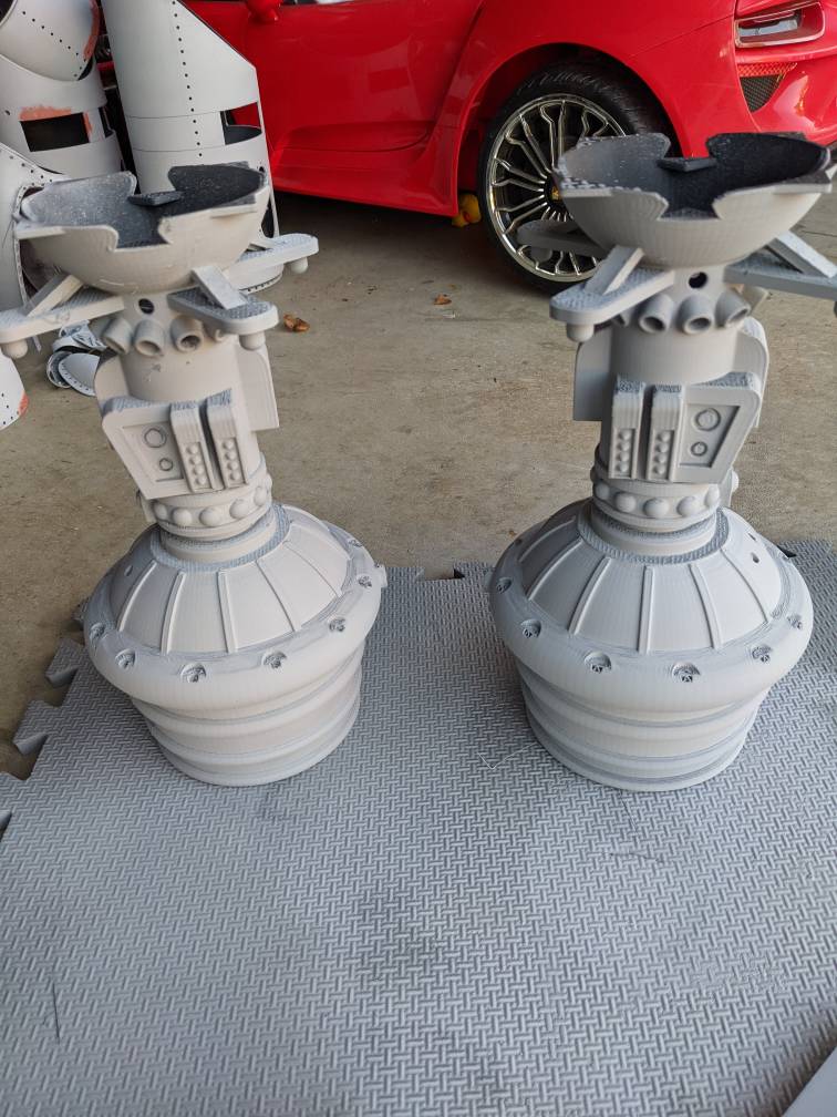

I did manage to get the engines primed. I didn't clean them up as much as the rest of the rocket because I'm going to weather them up a lot so it will hide all of the print flaws.

This is how you add the rivets, use one of those shop screw pickup magnets dip in glue puddle, bob smith if your classy and shove in hole and slide. Works perfectly and many times you snag a rivet and it will land perfect letting you move pretty quick. I did a row of 20 as a test at about 5 seconds per.
