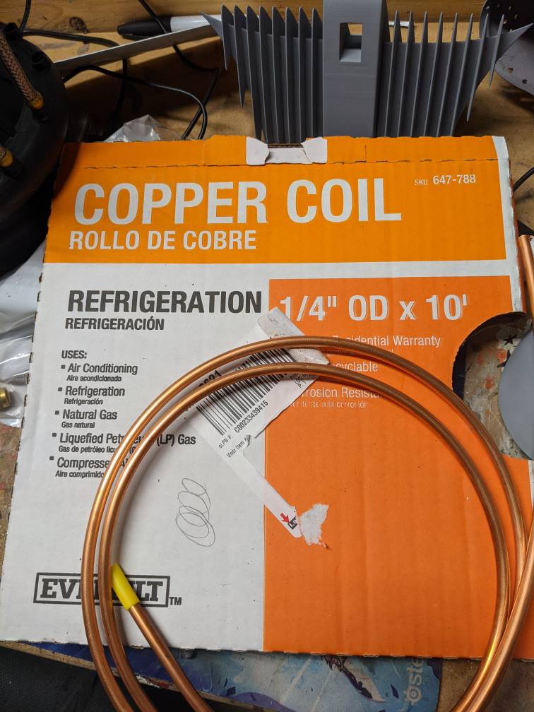

I got the one from your link, it fit perfectly. It just took some time because when you cut the line all the strands start to fray out. There was some blood that went in to this cause the strands kept poking me lol. Also you will need more than 10ft if you want to go all the way around the engines.
I got the flared nuts and the compression sleeves from this site for $16 shipped:
Www.DiscountHydraulicHose.com
Here are the model numbers:
341-04 - Flare Nut, Long, 1/4"
360-05 - 5/16" Brass Compression Tube Sleeve
The copper pipe I got from Home Depot for $10
It works great cause its really easy to bend. I didn't see anything shorter than 10 feet but I figured I'd use it on another project some day.
How many total feet of hose did you need?
Iirc I had about 2-3 feet left. Sorry I gave the rest away so I can’t measure what was left.
So how may total feet of hose did you use? You mentioned that 10 feet wasn't enough
Also, just to be sure, you bought 24 Compression Tube Sleeves and 04 Flare Nuts, right?
My apologies I thought you were talking about the copper tube.
The braided lines I only used the 10ft as I didn’t go all the way around the engine. I believe I only did 8 lines on each one. So I used 16 compression sleeves. The flare nuts are only on the fronts so yes 4 only needed.
