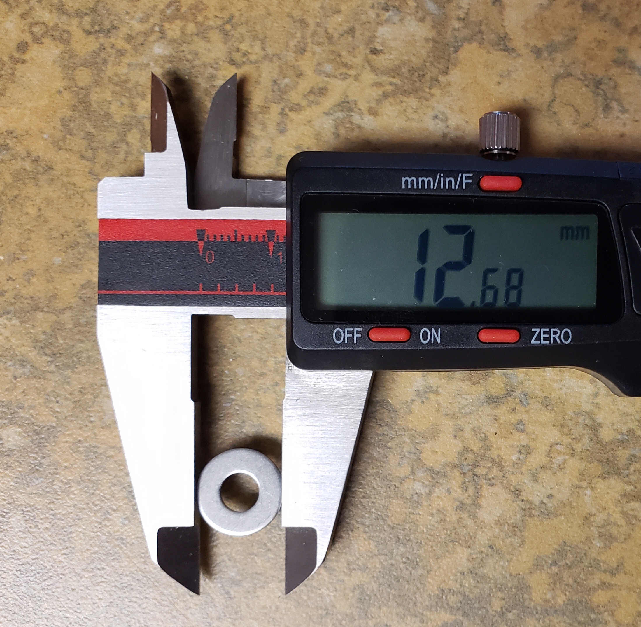

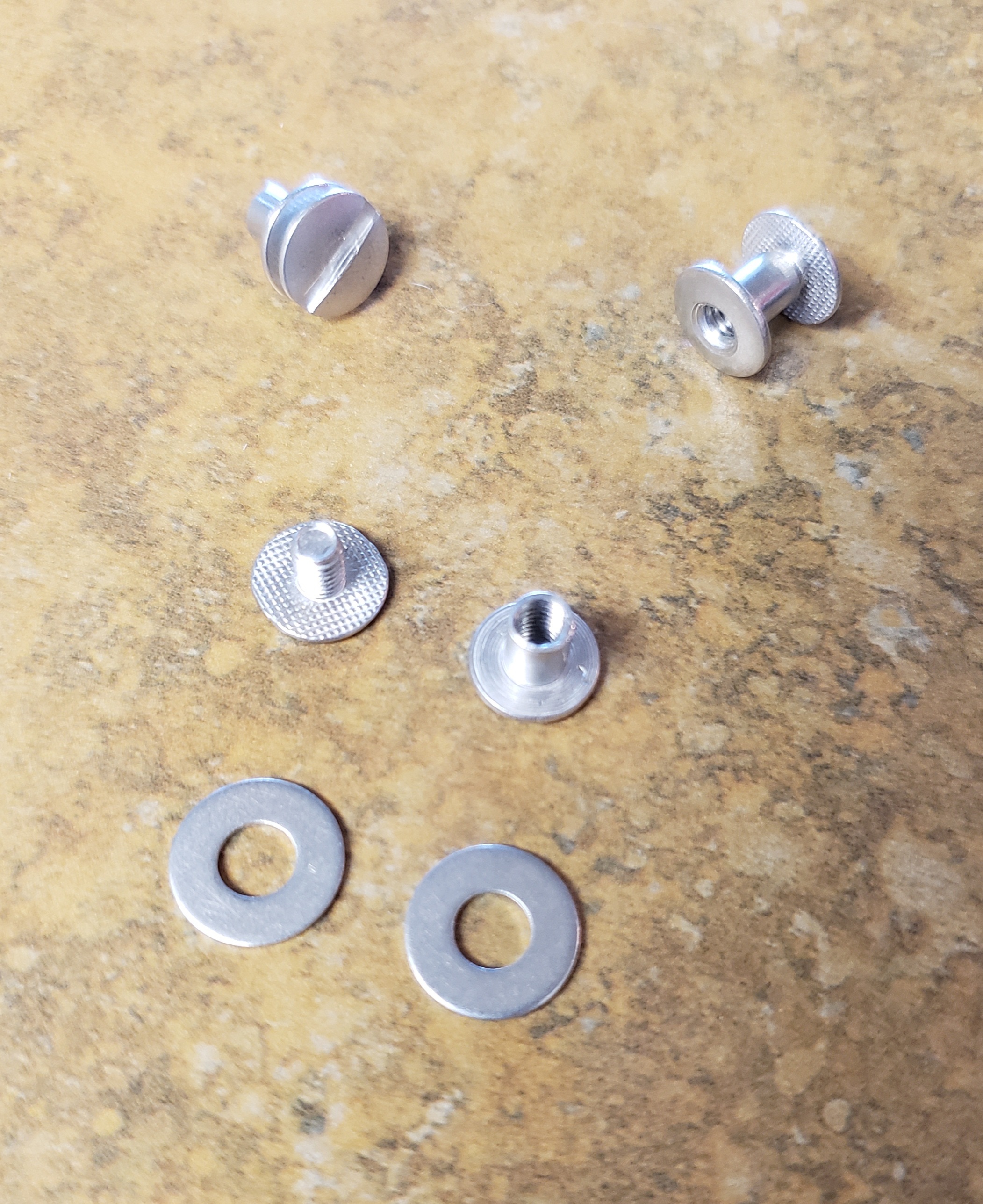

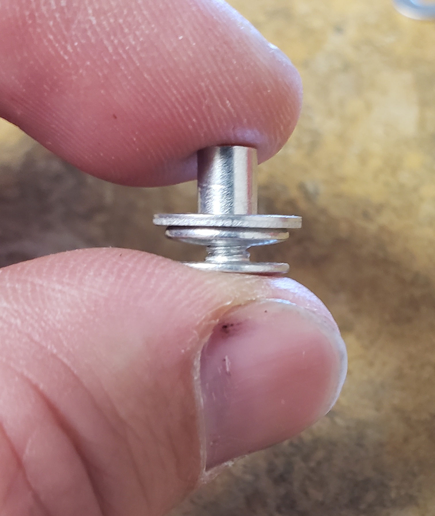

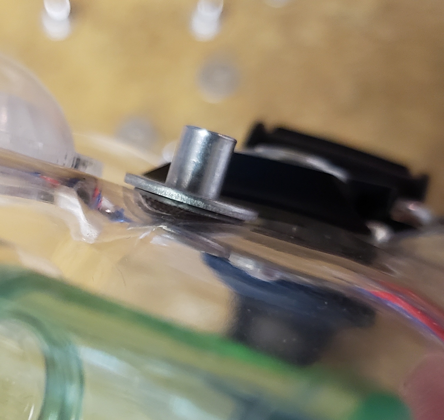

Thank you very much, the posts are aluminum Chicago screws. I painted the inside so you wouldn't see the threads. I filed down the flange of the screw so it was very thin. Then I glued the aluminum washer to it. Aluminum has a more accurate color. Then I just drilled a hole and screwed it in place.View attachment 1496866View attachment 1496867View attachment 1496868View attachment 1496869

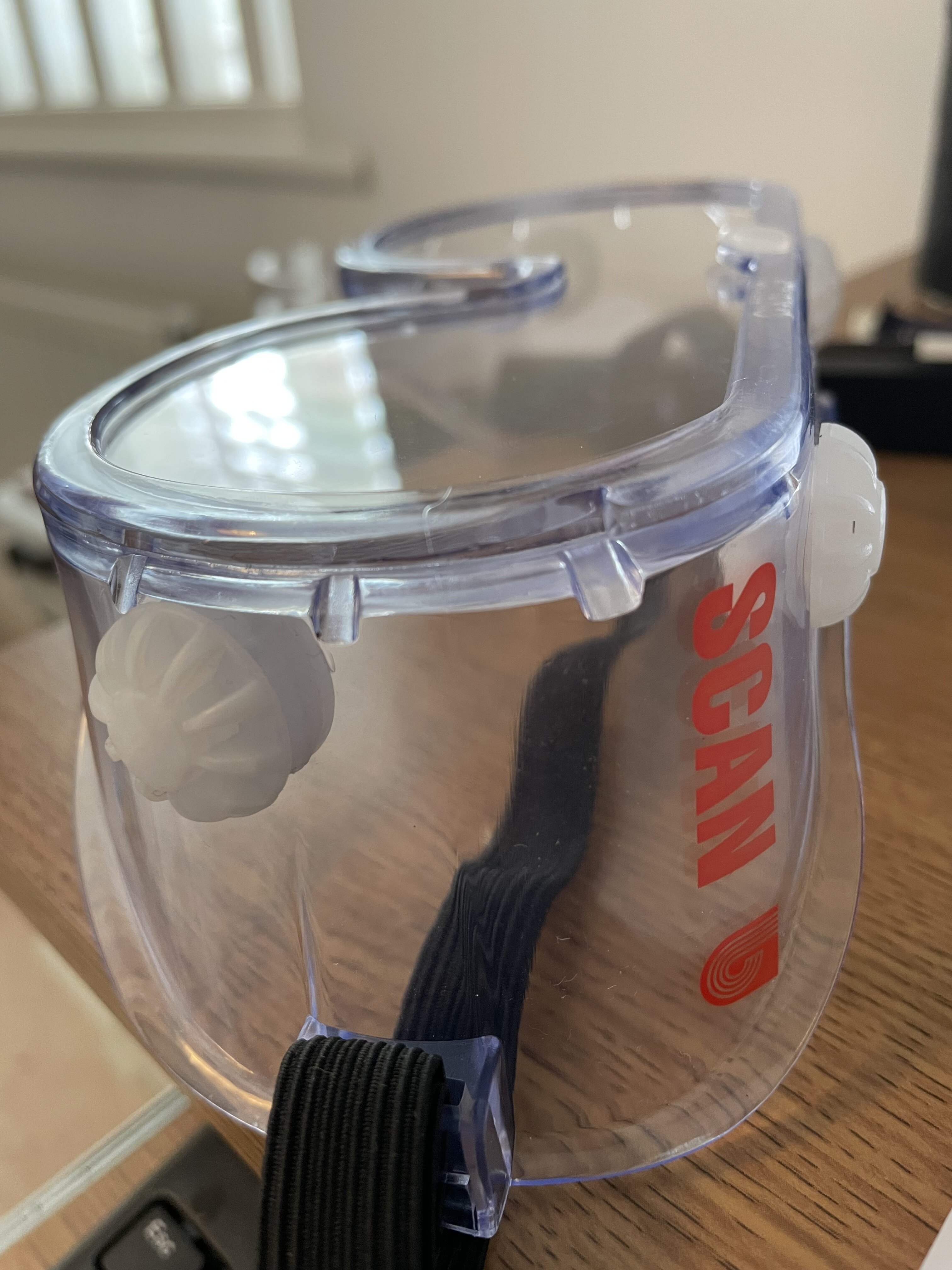

Managed to find some goggles with vents in the uk, they are not the right ones but they may have to do as they are all I could find in the uk.
View attachment 1497372Managed to find some goggles with vents in the uk, they are not the right ones but they may have to do as they are all I could find in the uk.
The ones I got were in Germany. I'll check and see if I have any extra vents. I did make casts of the correct boc charger holder. You'll have to cut it to the proper length. Its solid so mounting is easy. Its ready to paint as well.
Thanks - Vents would be great if you have any :)

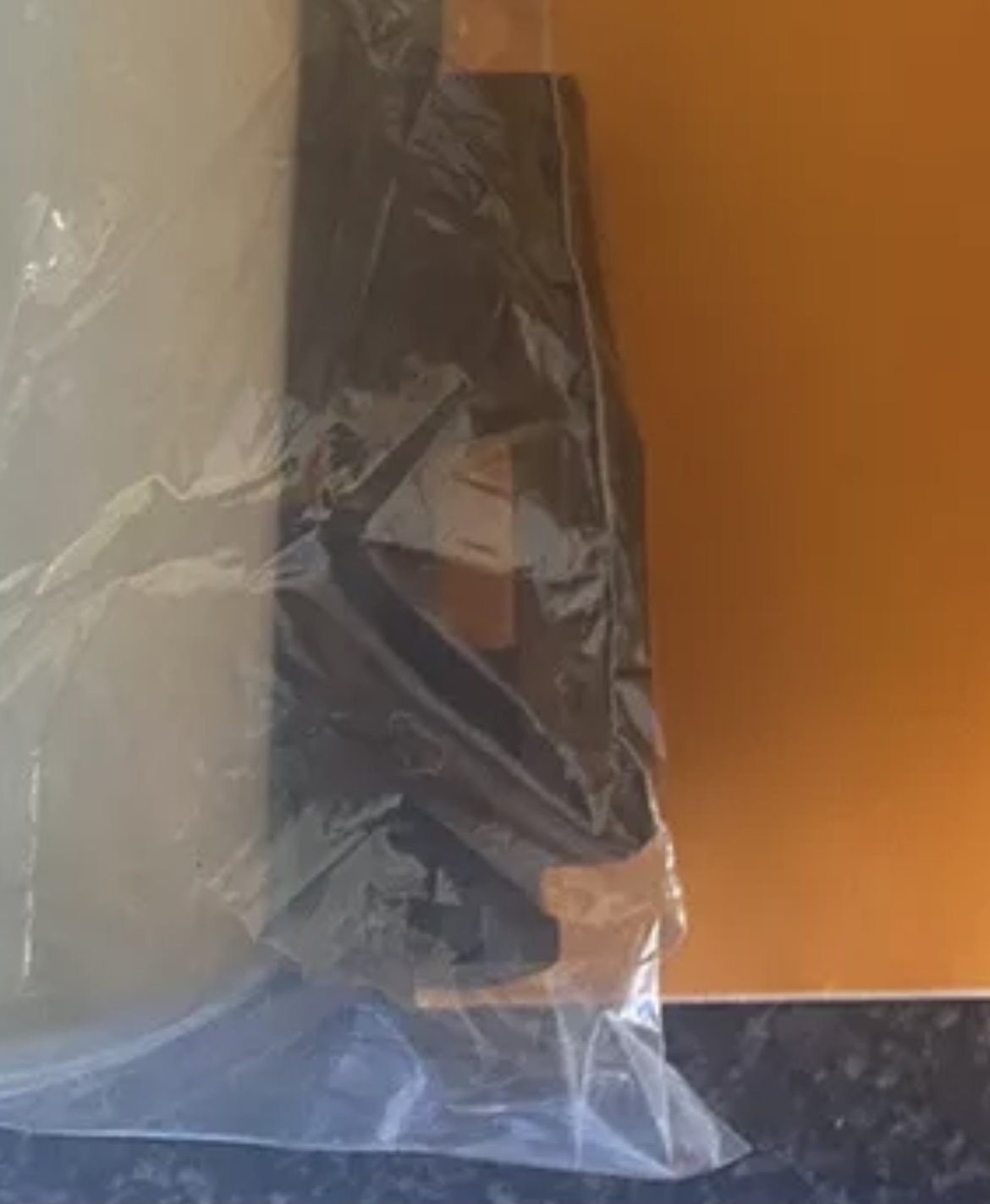

Nice clean cast - I have a charger holder on its way, so keeping my fingers crossed it’s the right one, in the images it was under plastic so difficult to tell but it looked promising, these were the only images:
If it’s not right when it arrives I’ll let you know

I looked at that one myself. I found a few of them. When I made mine they were near impossible to find. That one looks promising
I only used a cast because I didn't want to chop up an original part that was very difficult to find.
