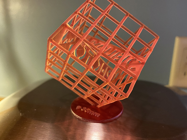

So I tried the exposure test, and two things I immediately noticed...
  1. I am using the Lychee slicer program. I put in the AnyCubic Photon Mono X as my printer and have been using the defaults for the resin, which I thought would be matched to the printer and resin type. They were not. The burn-in layers settings were way off along with the general exposure settings being much shorter than recommended.
  2. One of the reference sheets included in the video specifies a 16 sec exposure time for the resin I'm using. The resin itself specifies 3-15 secs. Based on my test results, I think 16 sec is way too much, and I'm actually leaning toward 3 sec based on the fact that my 4 sec cure appears over exposed based on the video.
So for the AnyCubic Basic Gray resin, I think I am going to go with:
  • 4 burn-in layers each cured at 30 sec
  • 50 um layer thickness - default
  • 3 sec exposure time
Will try these settings with the exposure test again and report back, but happy to hear any thoughts in the mean time!

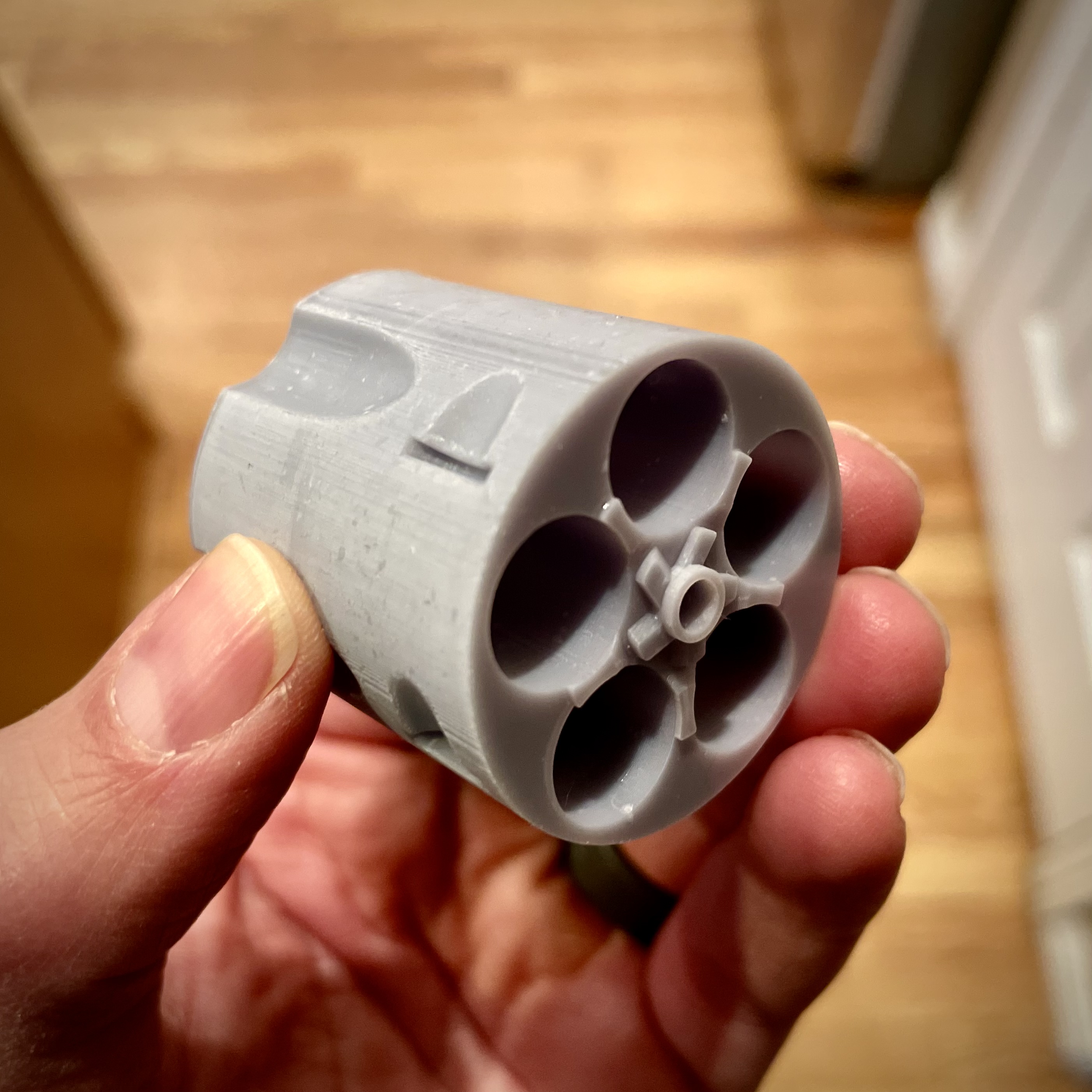

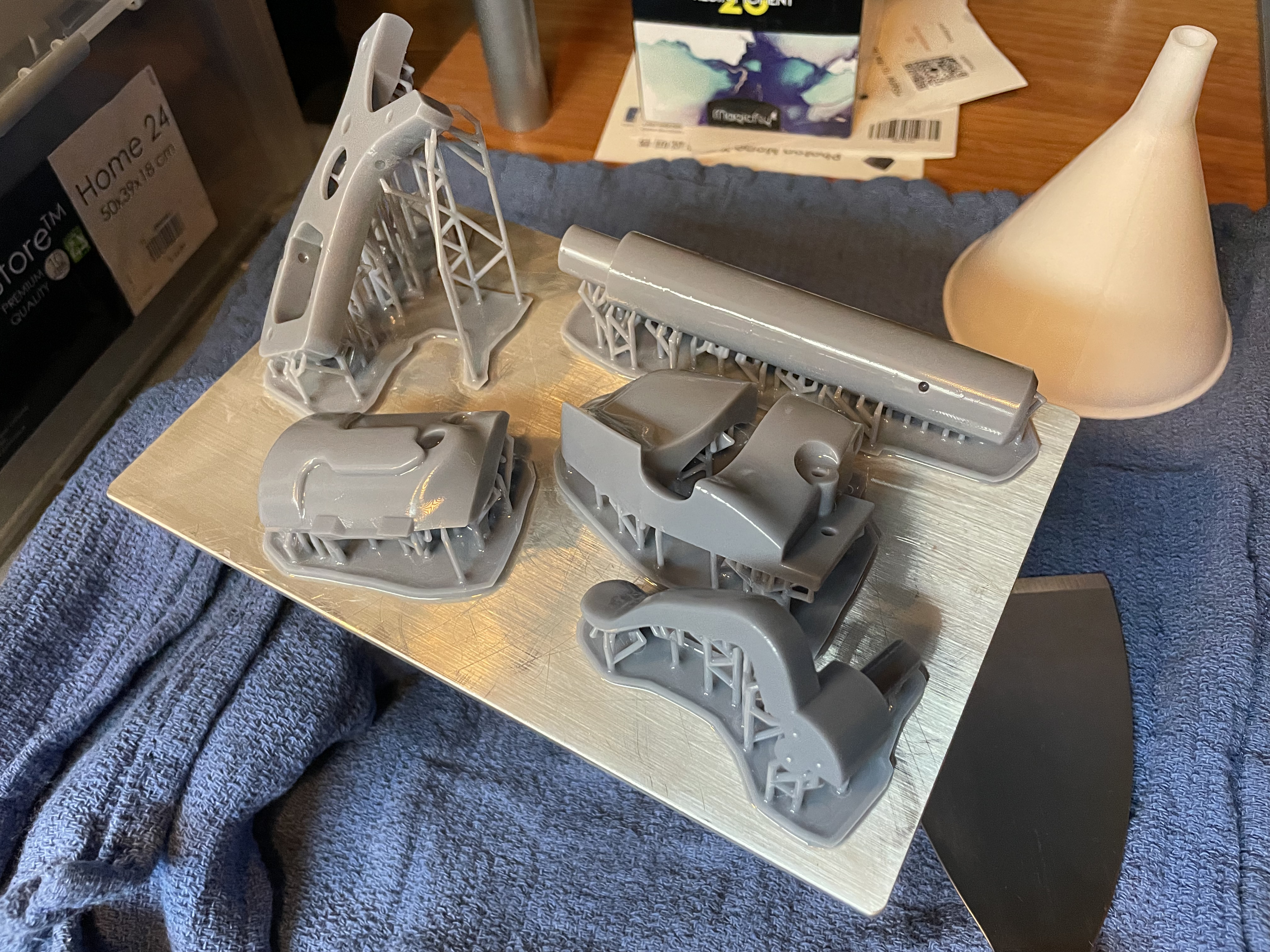

Following up to my previous post - I think I’ve got the resin settings dialed in! I’ve done a few prints now and they are kicking ass! For example - here’s the cylinder that was giving me trouble. Printed right on the build plate with no supports.
I even went back and retried my first big print - awesome!
I can’t thank you all enough for all the help in getting this going! Off to print the rest of the kit parts!

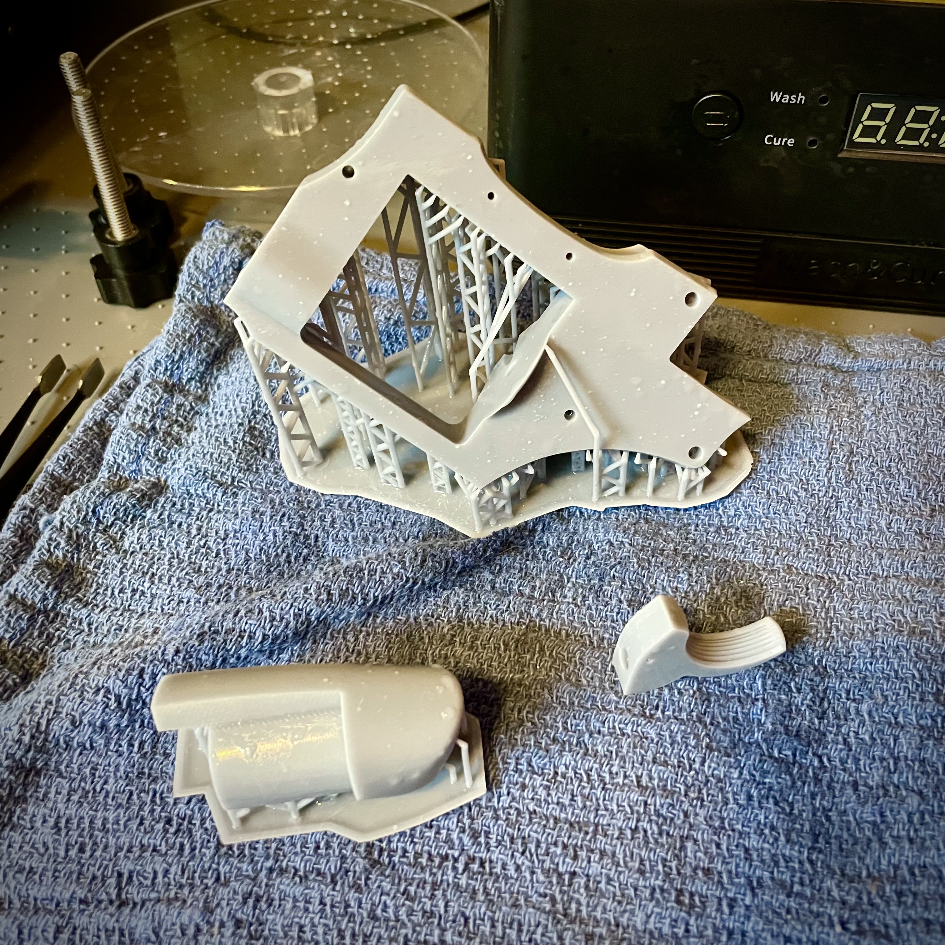

remember don't cure your prints with the supports on, remove them first. Warm water can soften them a little and help removal after the alc rinse.
Interesting. From what I’ve read so far, curing with supports is recommended, but I can definitely see both sides of the argument…

The supports post printing are much softer and are easier to cut. When they are cured solid, they tend to sometimes shatter (depending on the resin type). Sometimes it takes out a big chunk out of the model. But you can try both and see which you prefer.
However, sometimes it is best to cut the supports post curing, to prevent the part from deforming. But then again, depending on the support placement the thin supports will cure faster and actually cause deformation.
So the right or wrong answer is totally dependent on the object printed and the supports.

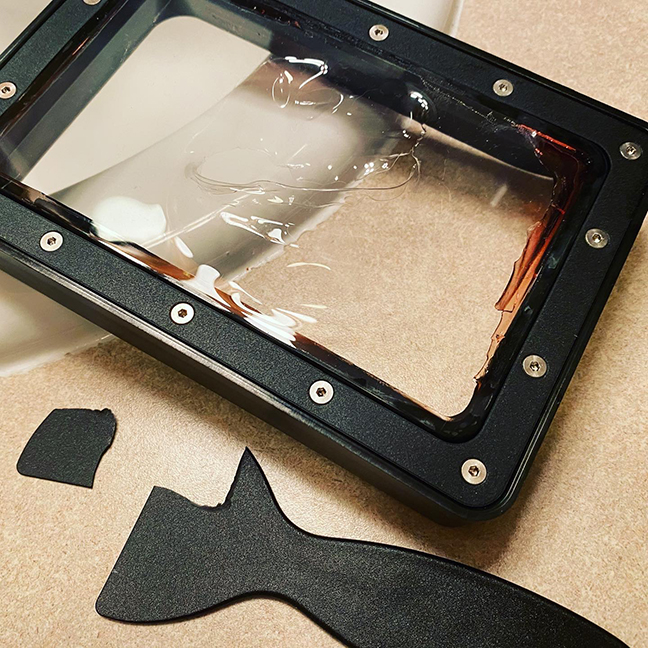

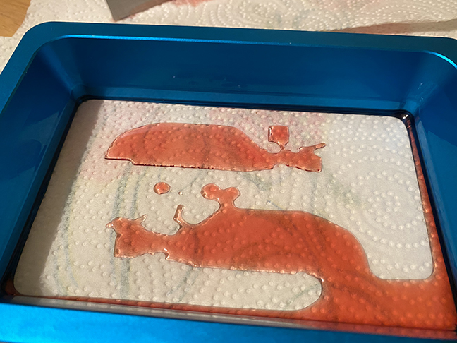

I've recently picked up the photon mono, and the wash and cure 2.0 and I promptly punctured the fep trying to remove cured resin from it when the little spatula broke very easily and cleaved the plastic open. After swearing like I had tourettes for about 2 hours (I have a habit of breaking things right after I get them) I ordered replacement frame/feps from anycubic (because the frame holding the sheet is glued together), which I've heard can take months to actually arrive, so I hit reddit to see what the "experts" are recommending. I then ordered an aluminum vat with an already installed fep. My first test print was pretty good, not perfect. Did the cube. It's wonky here and there. I was happy with it enough to set up some Silverhand grips (which is the reason I decided to finally get into resin printing) and YEAH, weeks have gone by now and I don't have a single successful print other than that first cube. I have some 3in1 PTFE lube on order, that is my next step to try and get a decent print done.
I also picked up a pack of feps for the aluminum vat, and that came with 2 plastic spatulas that are much better than the one that came with the anycubic.

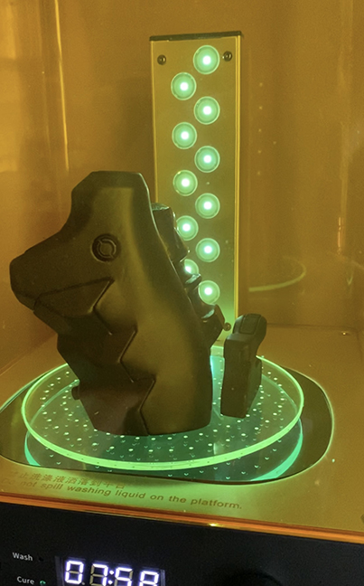

In the meantime I've found a use for the wash & cure 2.0. I'm using it to cure parts from the FDM printer than have been primed and painted. Works GREAT.
