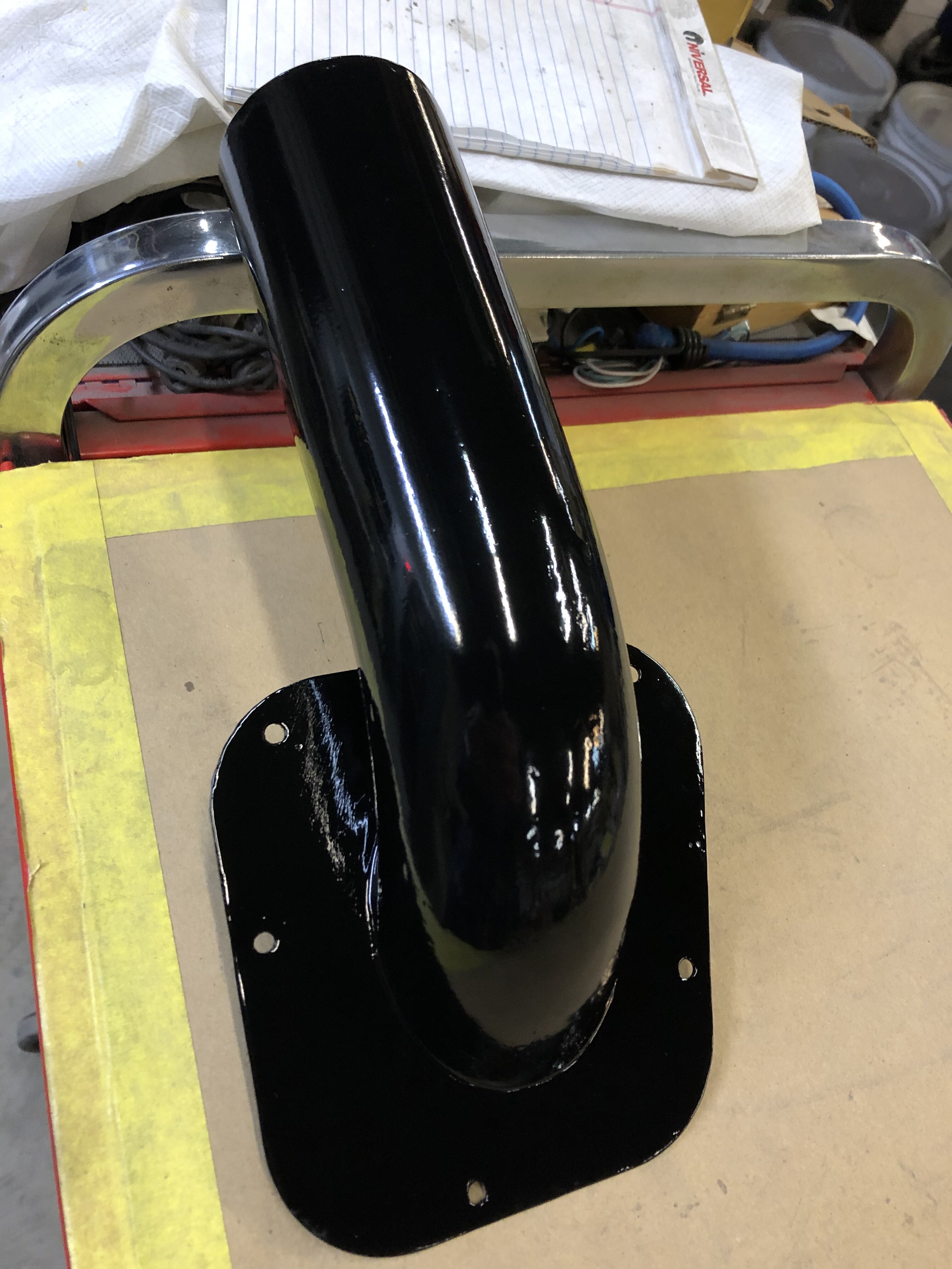

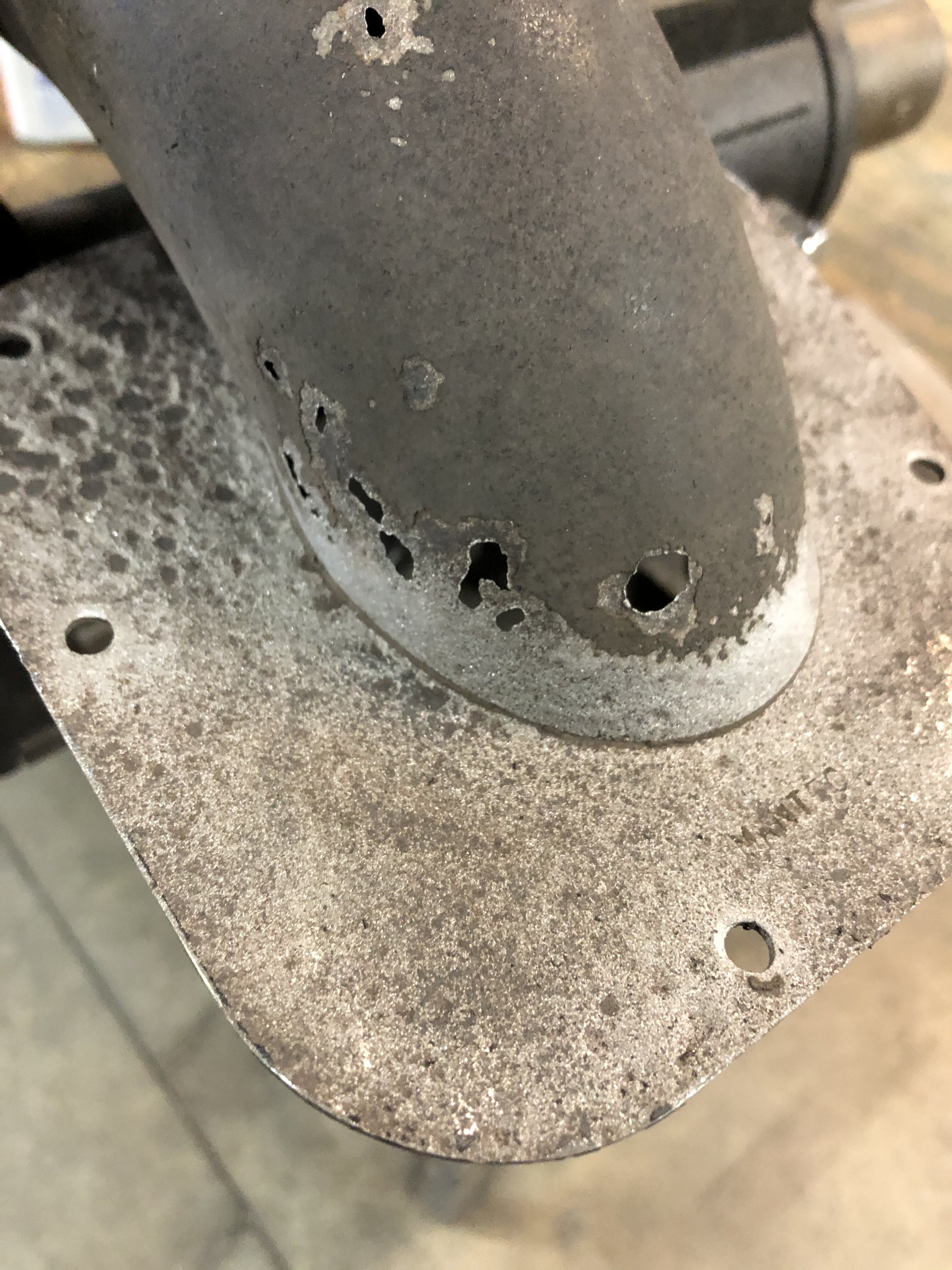

You could also use an epoxy, like the JB Weld clear stuff. (Home Depot carries it- two ~8oz bottles) It’s not as strong as the regular gray stuff, but it’s plenty strong. And clear, but sanding it will turn it white of course.
Billed as a “five minute” epoxy, that’s just the working window. It cures overnight.
I bought it to reconstruct a rusted snorkel on my Land-Rover and I’ve found many other uses since. And pretty cheap for the volume you get.

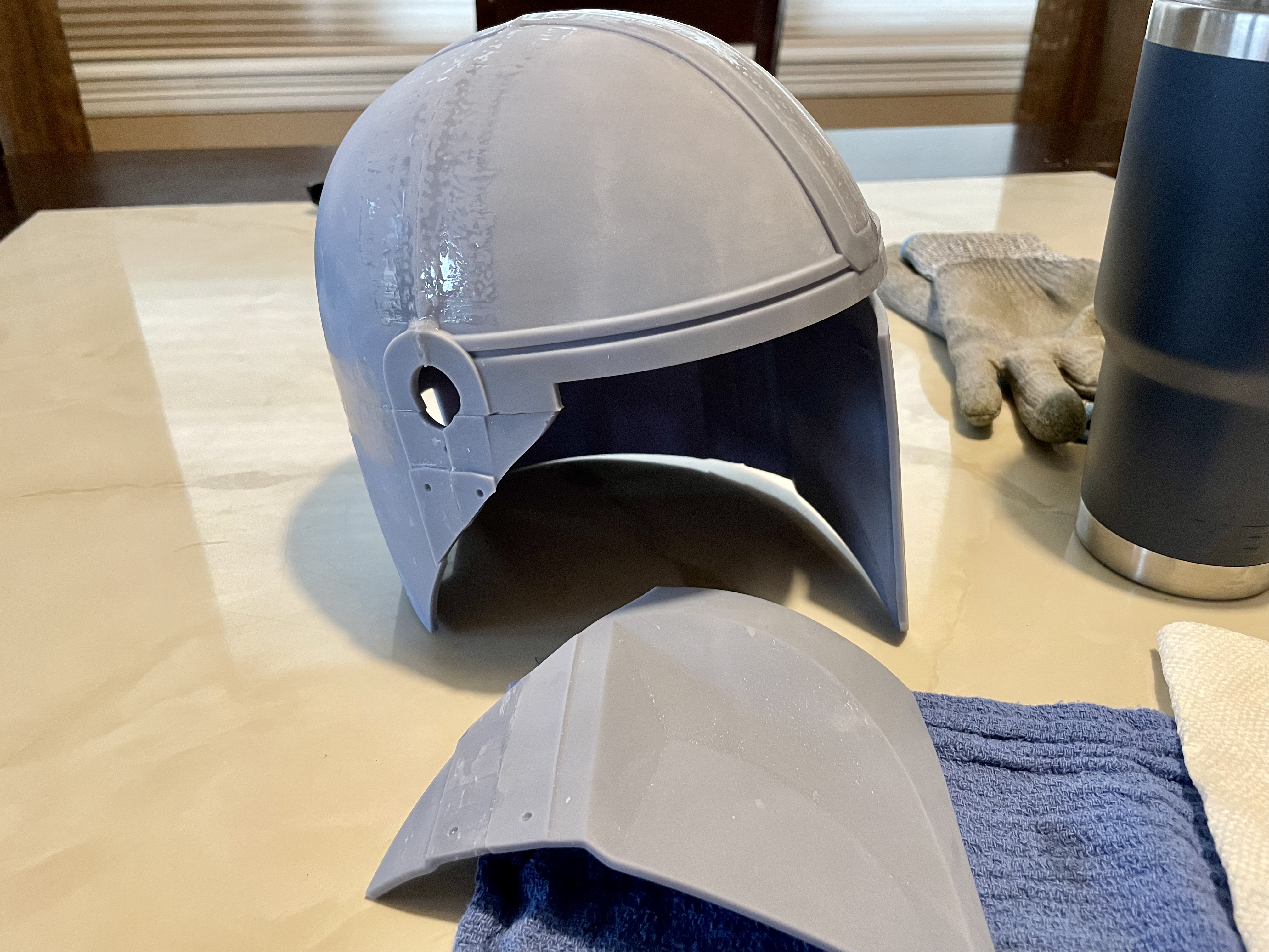

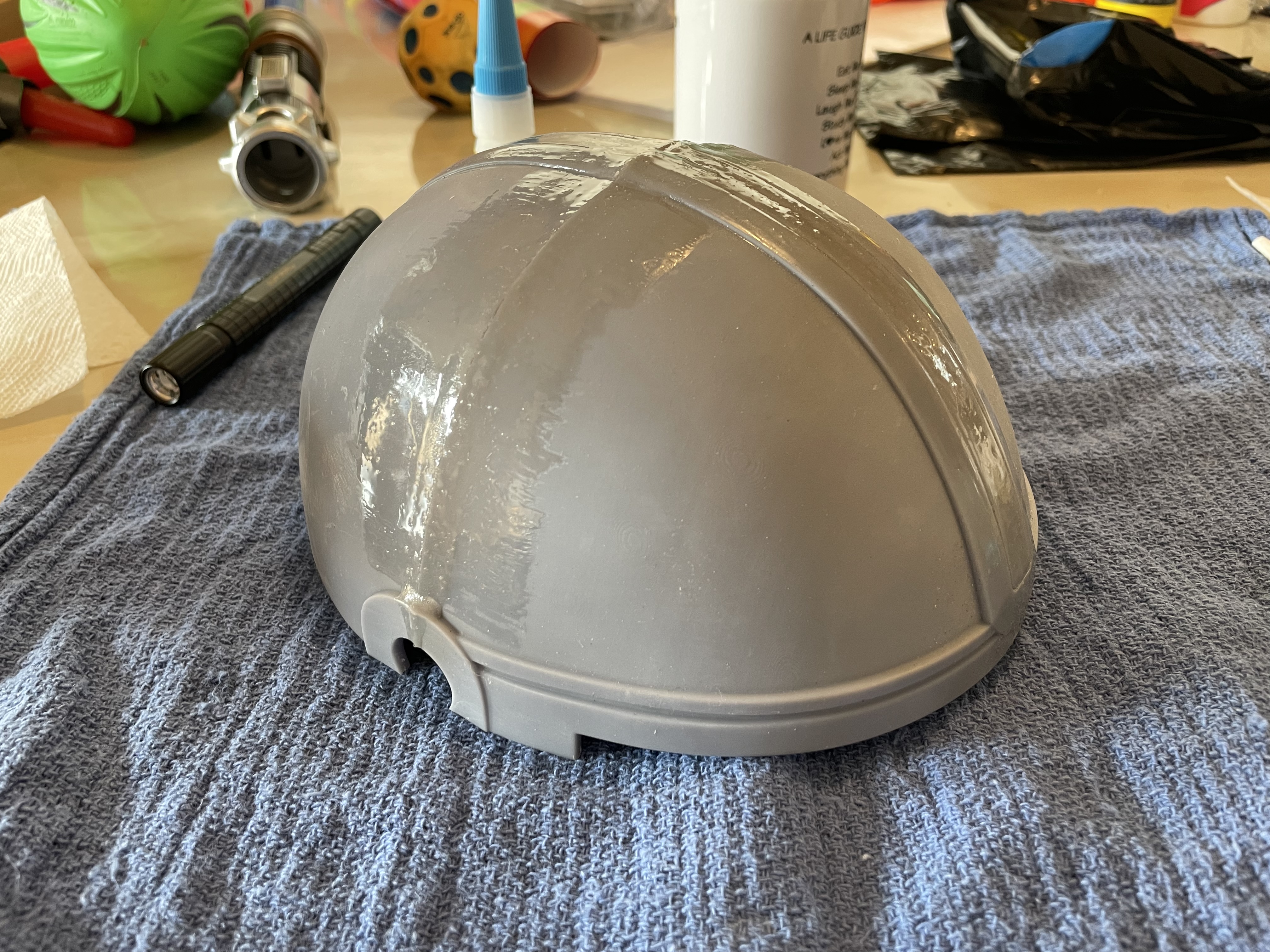

One of our neighbor’s celebrated his 8th birthday, and as he has recently been bit by the Mandalorian bug, I’m printing him a 3/4 scale helmet. I thought this would also be a good exercise for me to print a larger piece that’s been broken into sections, along with learning how to join pieces together.
For the most part, the pieces have needed little/no prep work to join up, aside from the soft corner I posted above. I’ve been doing the initial joining with Gorilla Super Glue and then going back over with some of the AnyCubic resin and curing it with a UV flashlight.

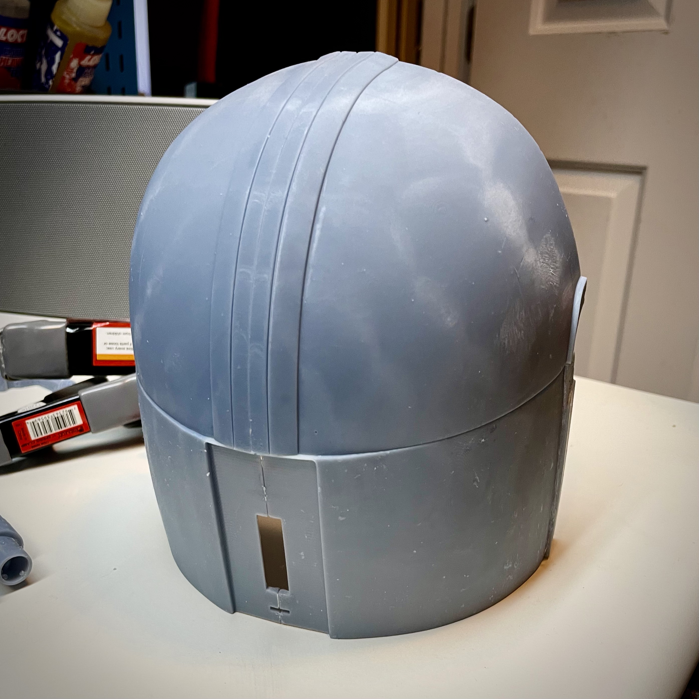

Back quarter:
Back half dry fit:
Top half put together. This will need a little sanding to touch up the seams:

Good news is - he does love it!
Bad news is - it’s too small…
Worse news - the kids were trying to force it onto their ends and snapped it…
I find it interesting that it broke where it did. Good to know the seam lines were pretty strong.
I learned a lot with this one. Off to print another (slightly larger) one!
