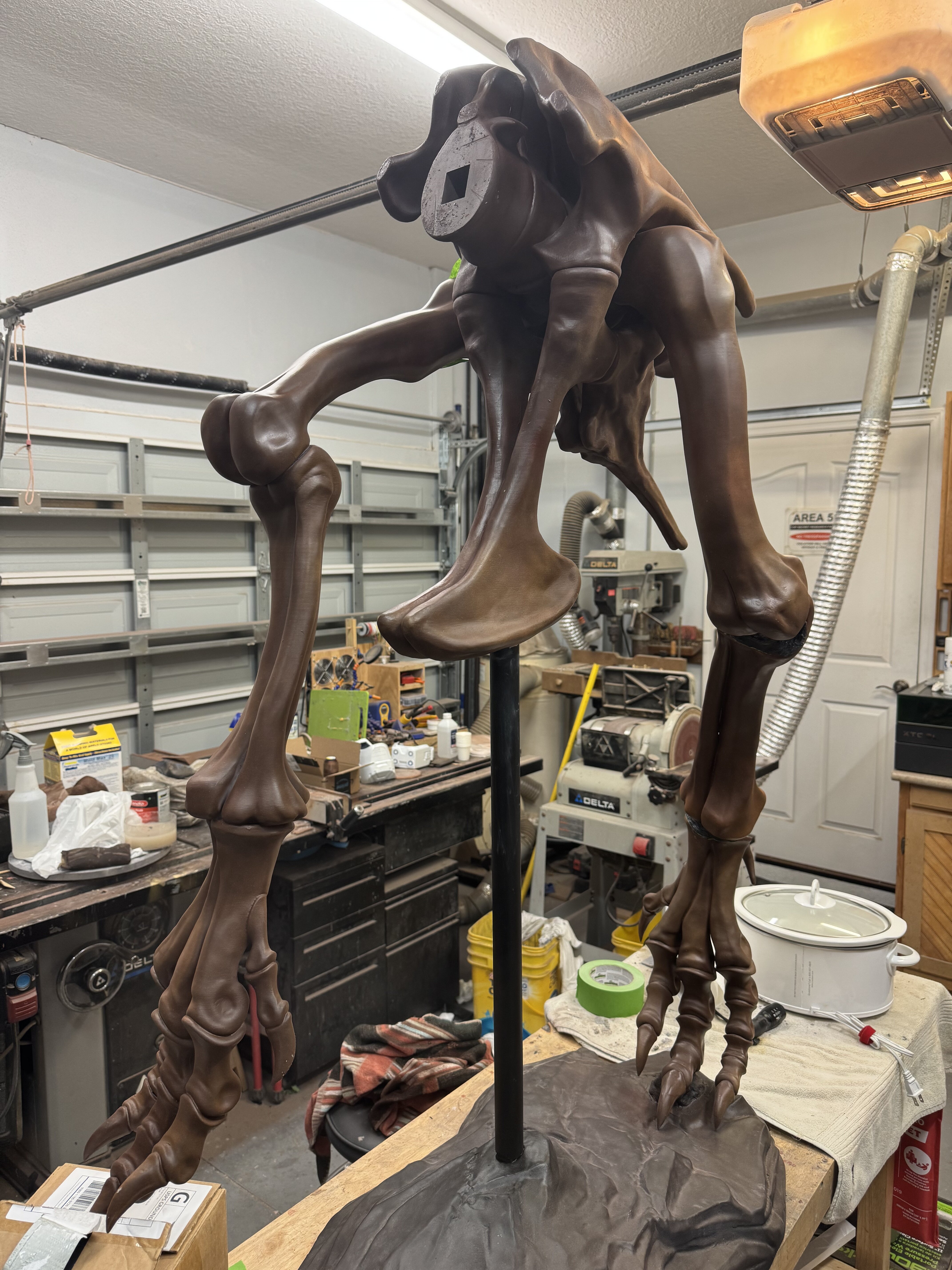

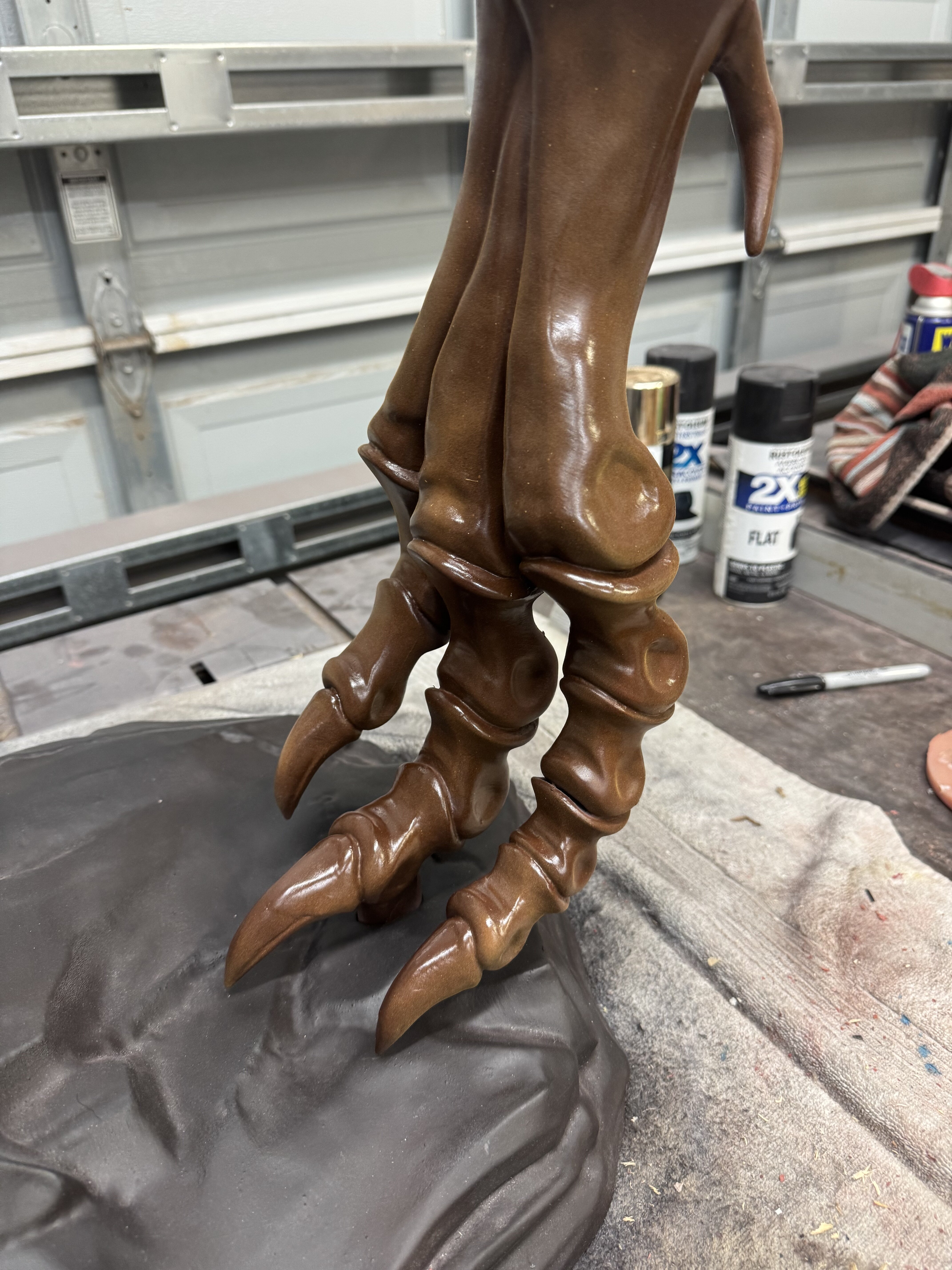

Both legs and feet are complete as is the main body and scapula ... used a matte clear to knock down some of the shine from the paints to give a more muted and modeled look
The skull and neck have the base coat of Krylon satin expresso but I'm having to do each different color in stages because I can't paint the entire piece (too big) at once so to ensure even coloration I'm having to let each layer dry overnight. Next up will be the Montana Gold chocolate followed by dusting with Kyrlon rustic orange and then the matte clear. Last pieces to paint are the tail and rib age and Then comes the fun part of assembling each major piece in the display location ...

Thx! I was originally going to use an airbrush but quickly realized it would take forever and so I reverted to rattle cans which meant a bunch of testing and practice to achieve the right look ...I could have still used an airbrush for the final highlights layer but that would have involved mixing paints and once I found that rustic orange in the rattle can that was the perfect color without having to mix up batches and try to get them all the same I just abandoned the airbrush altogether ...
She's starting to actually resemble a T-Rex ...

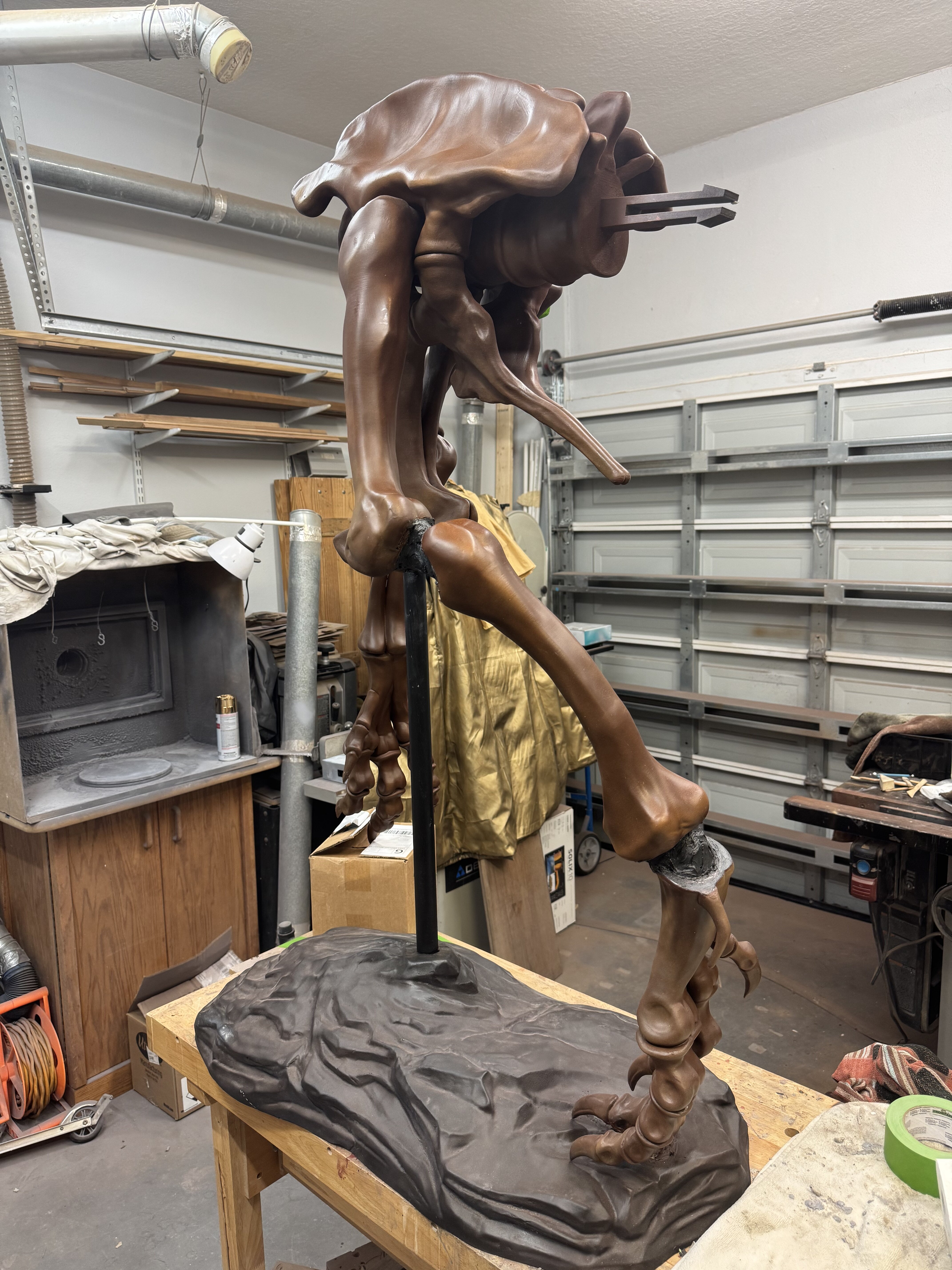

I had to lengthen her left tibia in order to make a solid connection between the left foot and femur. Not sure why but instead of reprinting an entire new tibia i just sliced off one end then reprinted that same section with the x-axis elongated so it would now reach the top of the foot ...
I also remembered i had a lot of Smooth-On epoxy putty from making my silicon CooperHoward mask which is a much better solution than 2part epoxy. It's already black and has a paste consistency so applying it to vertical surfaces is a snap and it hardens like concrete.

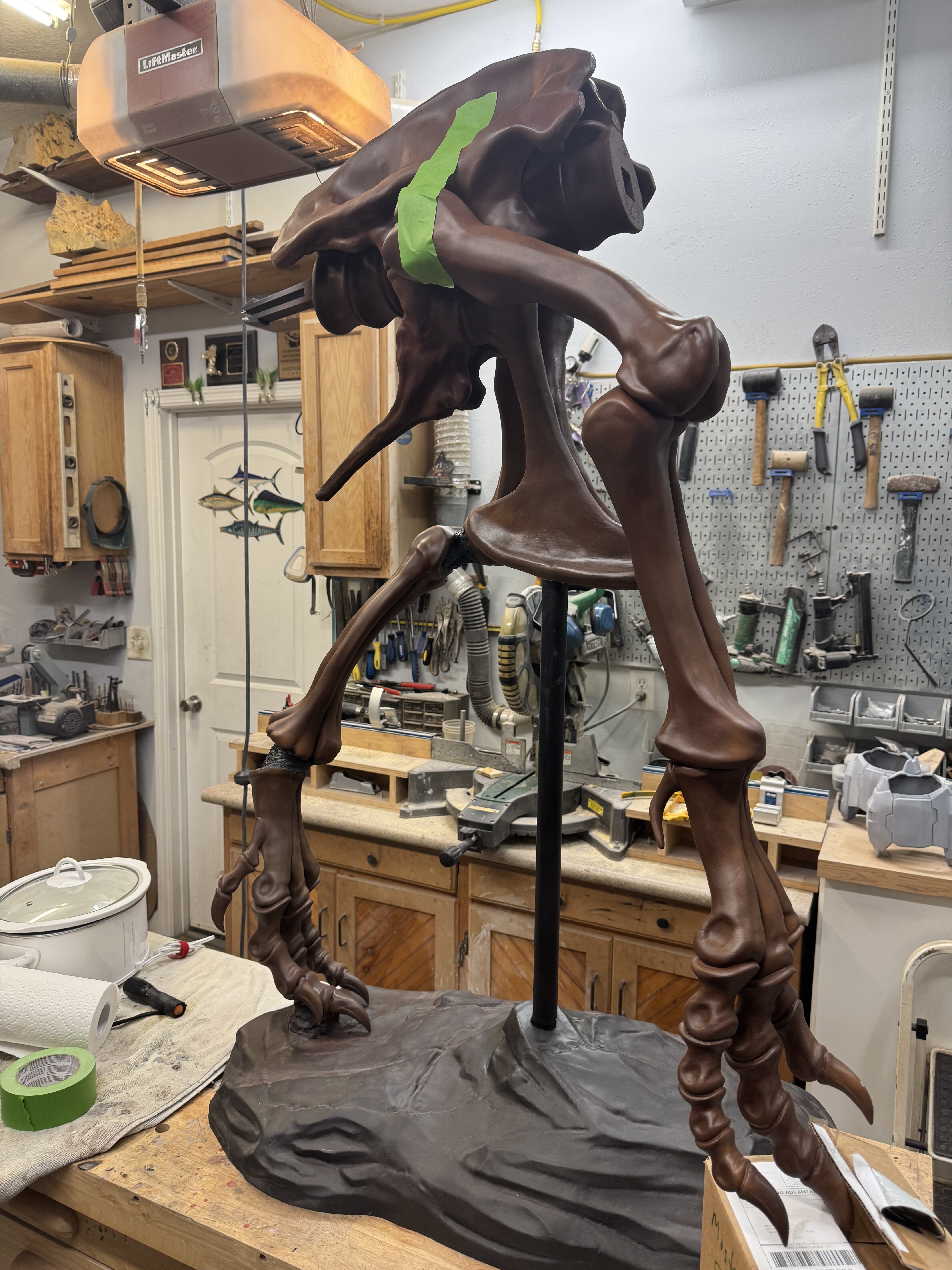

The scapula on the main support plus both legs and feet are now assembled ...
I've decided to add an additional support under the 2nd vertebra in her spine to help support the rib cage as once i add the neck and head it will likely be too heavy to go without it like in the original 100% scale model. I've got a 1" diameter acrylic tube which should be minimally evasive. I'm also looking at doing a support on the tail given that it is 57" long by itself ...
