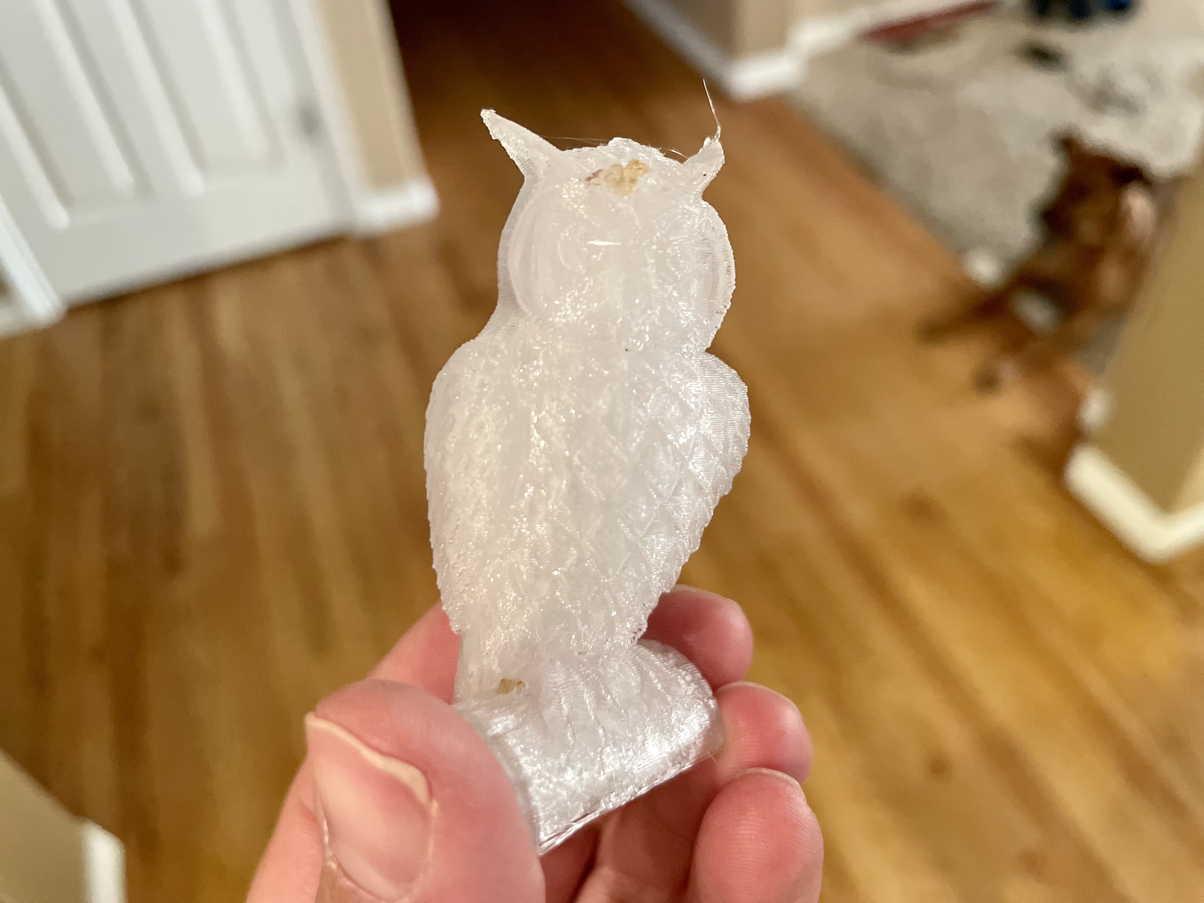

Having completed a few prints in PLA and ABS, I decided to try my hand at PETG. As with the other filaments, I have some adjustments to make, but not bad…

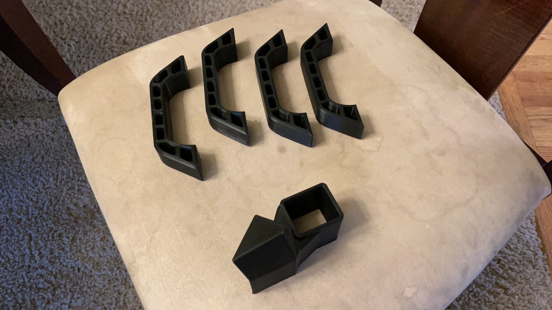

After experimenting with some other filaments, I went back to PLA to print some handles and a drip hanger for the Anycubic Mono X. The handles will be adhered to the sides of the UV covers for both the printer and the wash and cure station. The drip hanger goes on the printer, and is designed to hang the build plate on after printing so the excess resin drips off and back into the vat.
For those interested:

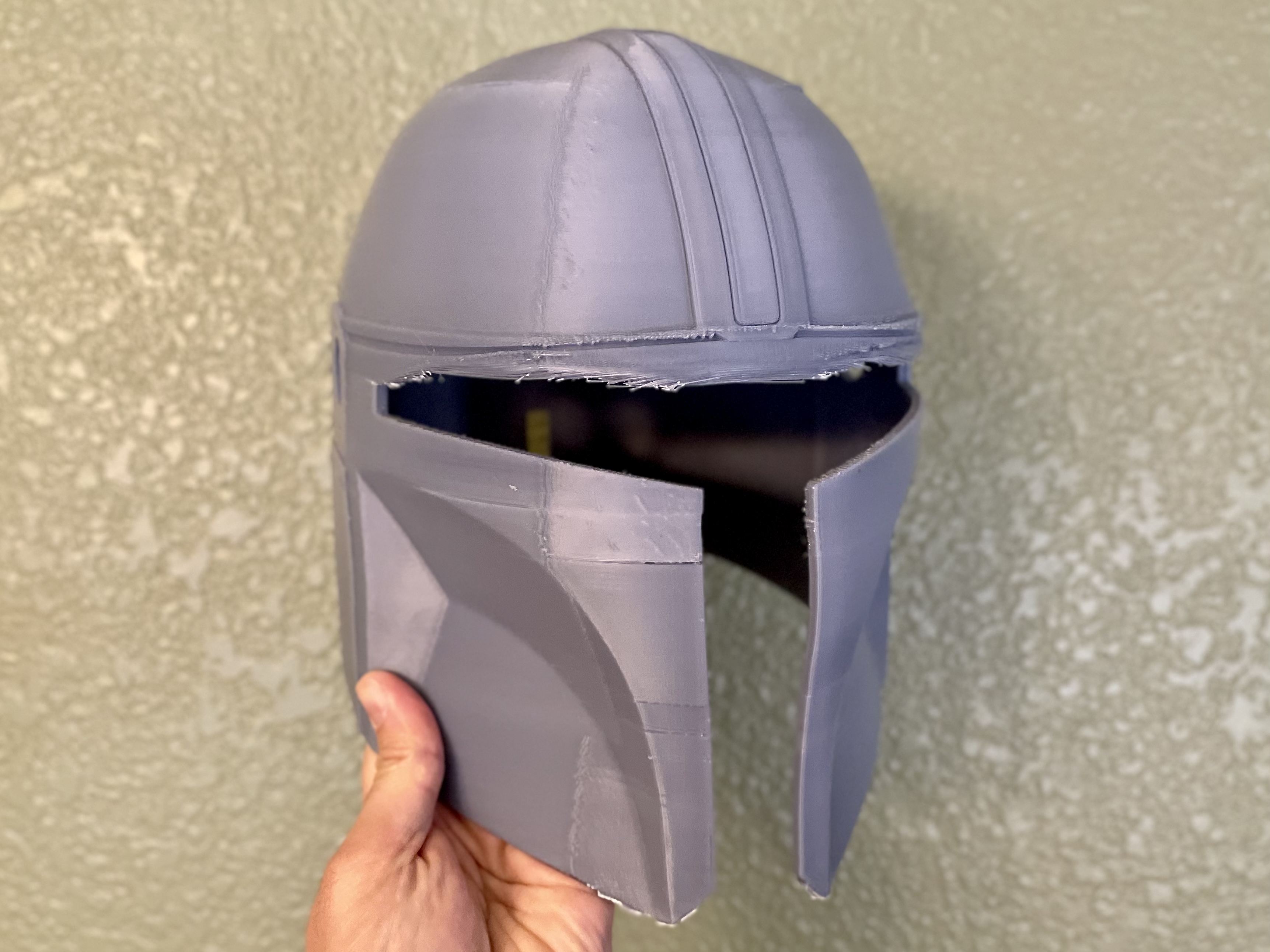

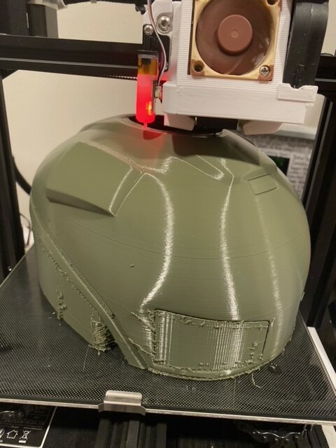

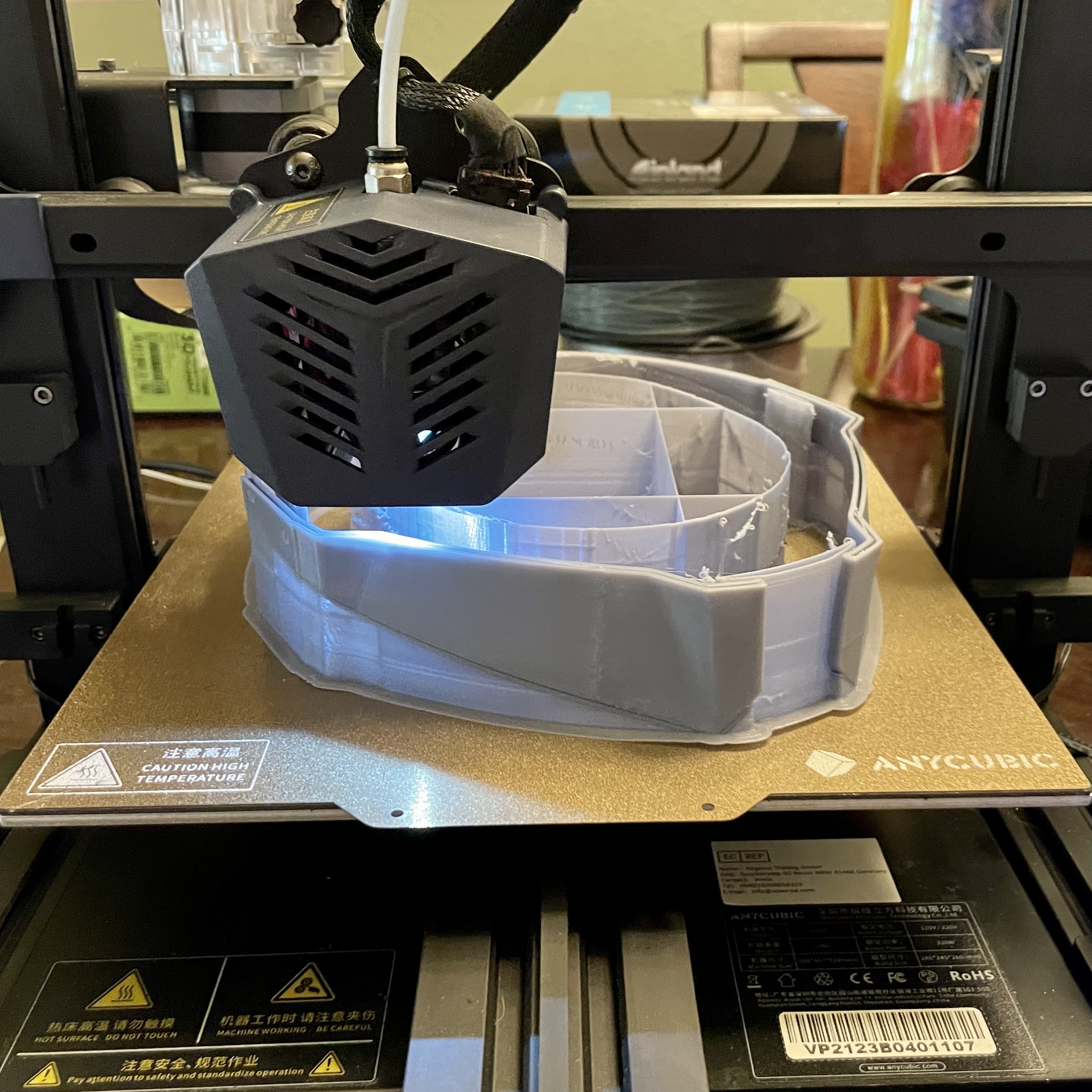

After working through the calibration, I’m going to give the Mando helmet another go. Printing at 85% in gray ABS…
Sean
Looks like it is turning out ok so far. I've always heard about ABS needing a heated enclosure since cooling stresses the material and causes severe warps.
TazMan2000

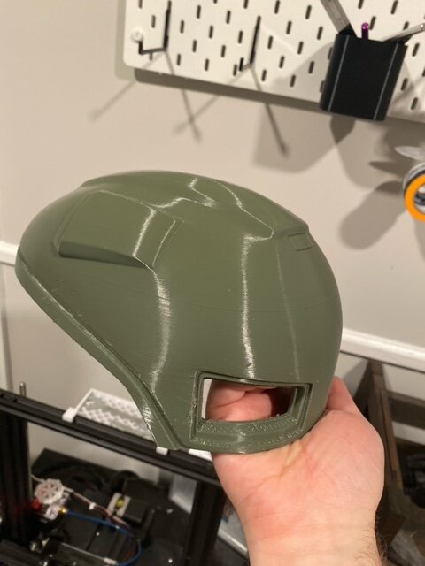

Looking good! Ditto what Taz said. ABS is very temperamental when it comes to drafts, probably why you're seeing the brim lift up there. Also, just as a mini PSA, ABS does have some pretty nasty off-gassing. Dont know where its set up in your home, but I would recommend setting it up in a remote room that can be ventilated easily once you're done
If you want to save on time and filament, Ive found that helmets dont usually require supports at the dome. The inside will string, but the outside layer prints fine-- this is one I printed this past weekend with no supports on the dome. Ignore the crazy stringing-- the 4.11 version of Cura changed my retraction settings and I haven't tuned them in again yet, haha:

Good news is the print finished!
Bad news is it has lots of issues…

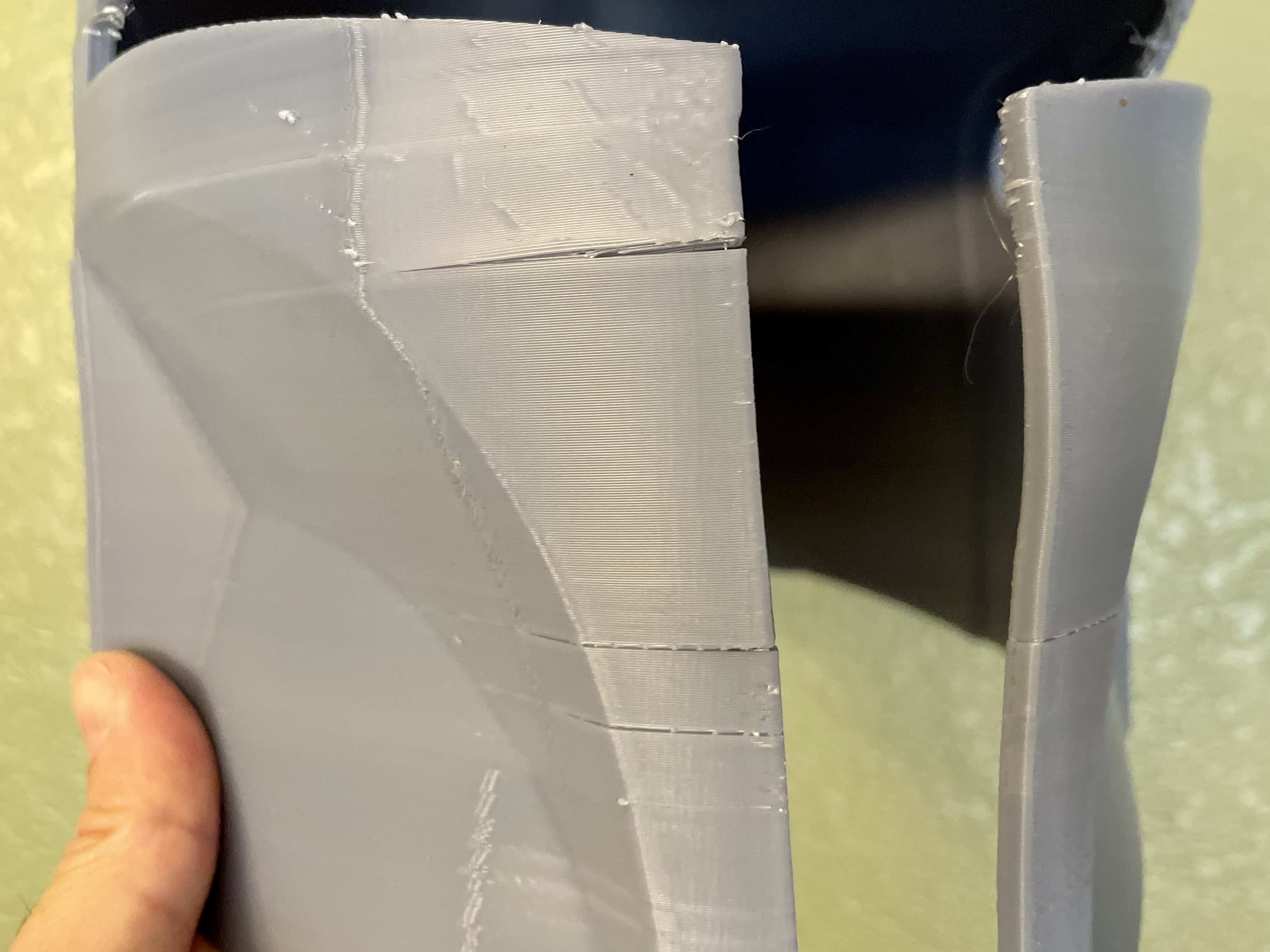

Layers separating along with the unsightly seam where my print head likes to change directions…
The visor area apparently needed some supports. Any recommendations for a good Cura tutorial on supports?

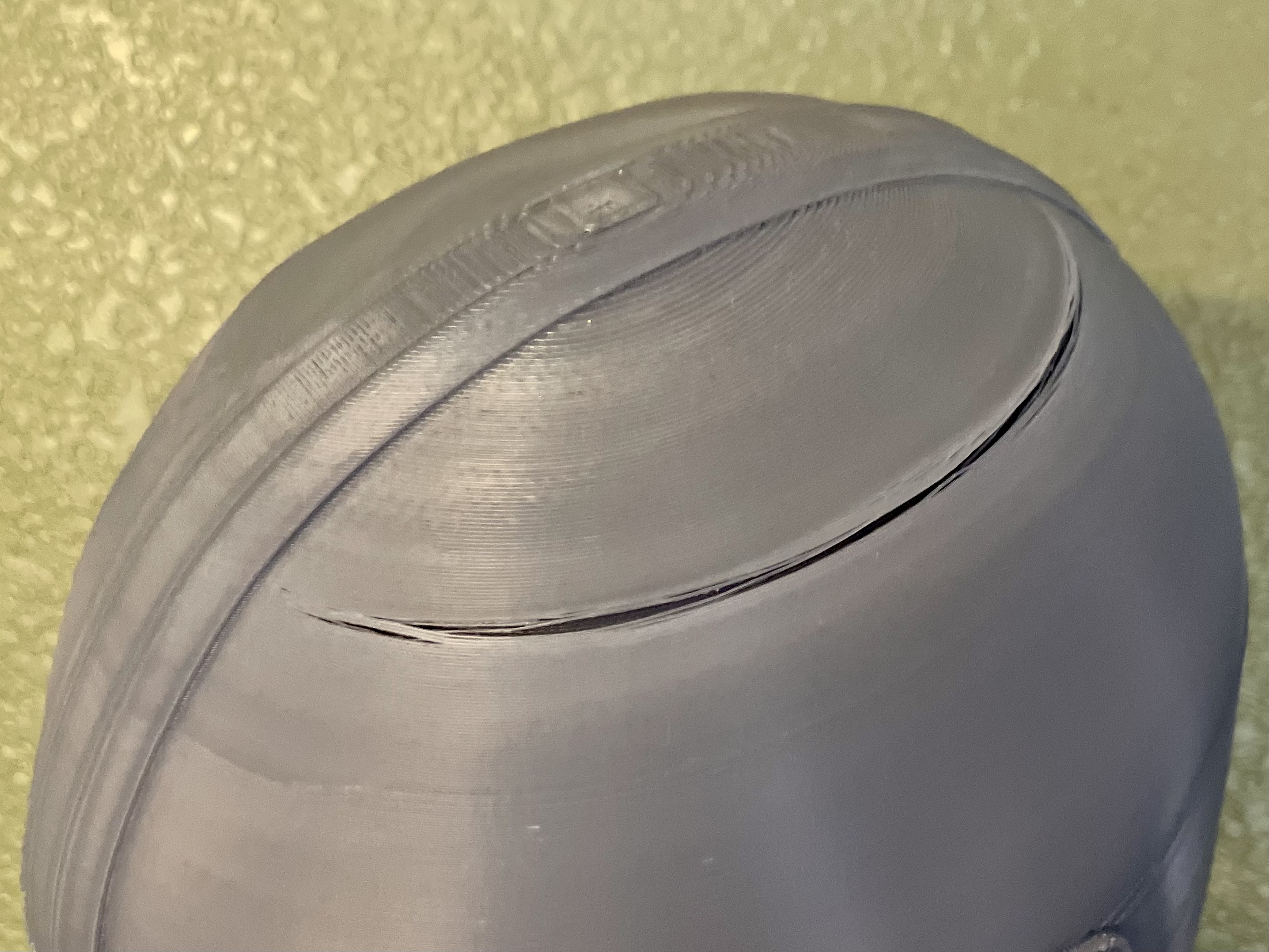

The dome cracked around where the internal support structure was…

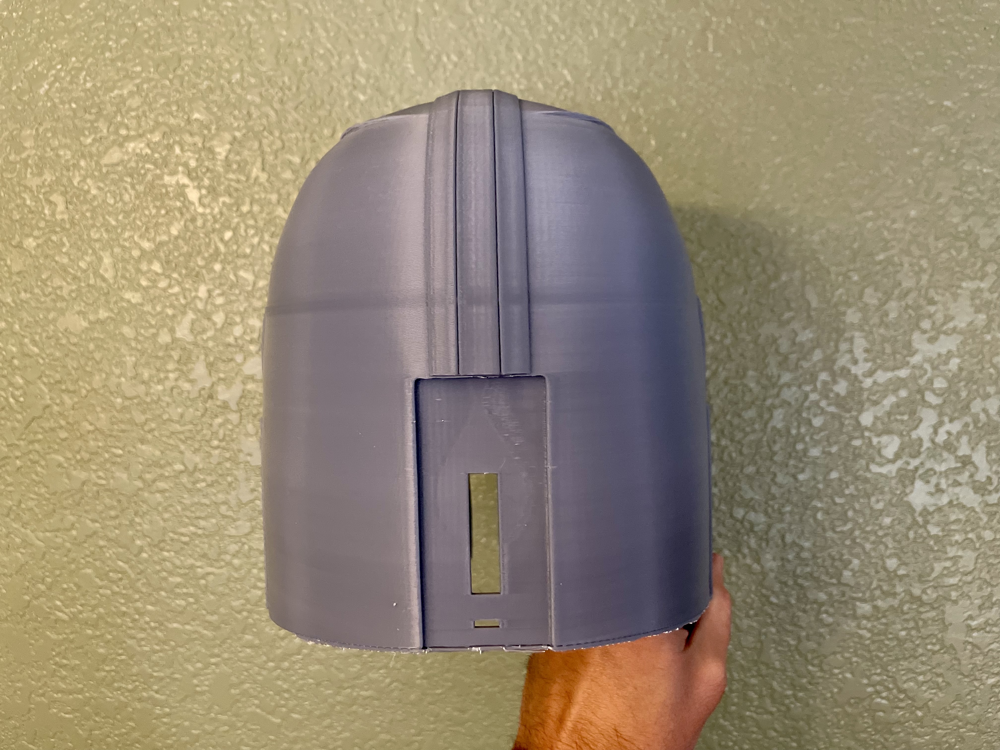

The back side is damn near flawless though, so there is hope!
Overall happy that I was able to complete such a large print, but still lots of room for improvement!
Sean
  • Like
Reactions: JPH
The back does indeed look great!
The seam will more or less always be present-- unfortunate side effect of the printing process. If you look for "zseam alignment" or something along those lines in cura, you can set where it happens. I usually set mine to "Sharpest corner"-- that way it aligns with an edge and is hidden better.
Chep or teaching tech always has great tutorials on supports. I usually just turn them on in cura and leave them at default. Only thing Ill do is add support blockers from the left hand menu if I dont want supports in certain areas-- like at the top of the dome like I mentioned before.
Sometimes you can get away with no supports on horizontal pieces and rely on your machine's bridging capabilities, but if the line has any curve it will get messy like the visor did; straight lines only, up to around 10mm depending on your machine and it's abilities. There are bridging tests on thingiverse you can print to test out how far you can push your machine.
Layer separation is probably from printing the ABS without an enclosure. Drafts of air hit it and cool the plastic before it can bond properly. If this was happening all over I would guess that your temp needs to be upped, but since the back is perfect I would guess drafts. If this was in another material like PLA I would guess you wouldnt see those splits at all.
One thing that looks really good-- your layer alignment on the back is pretty much perfect. I have had some of the toughest time getting my z motor and leadscrew to play nicely and have had some prints with some wobble in them as the printer moves layer to layer
