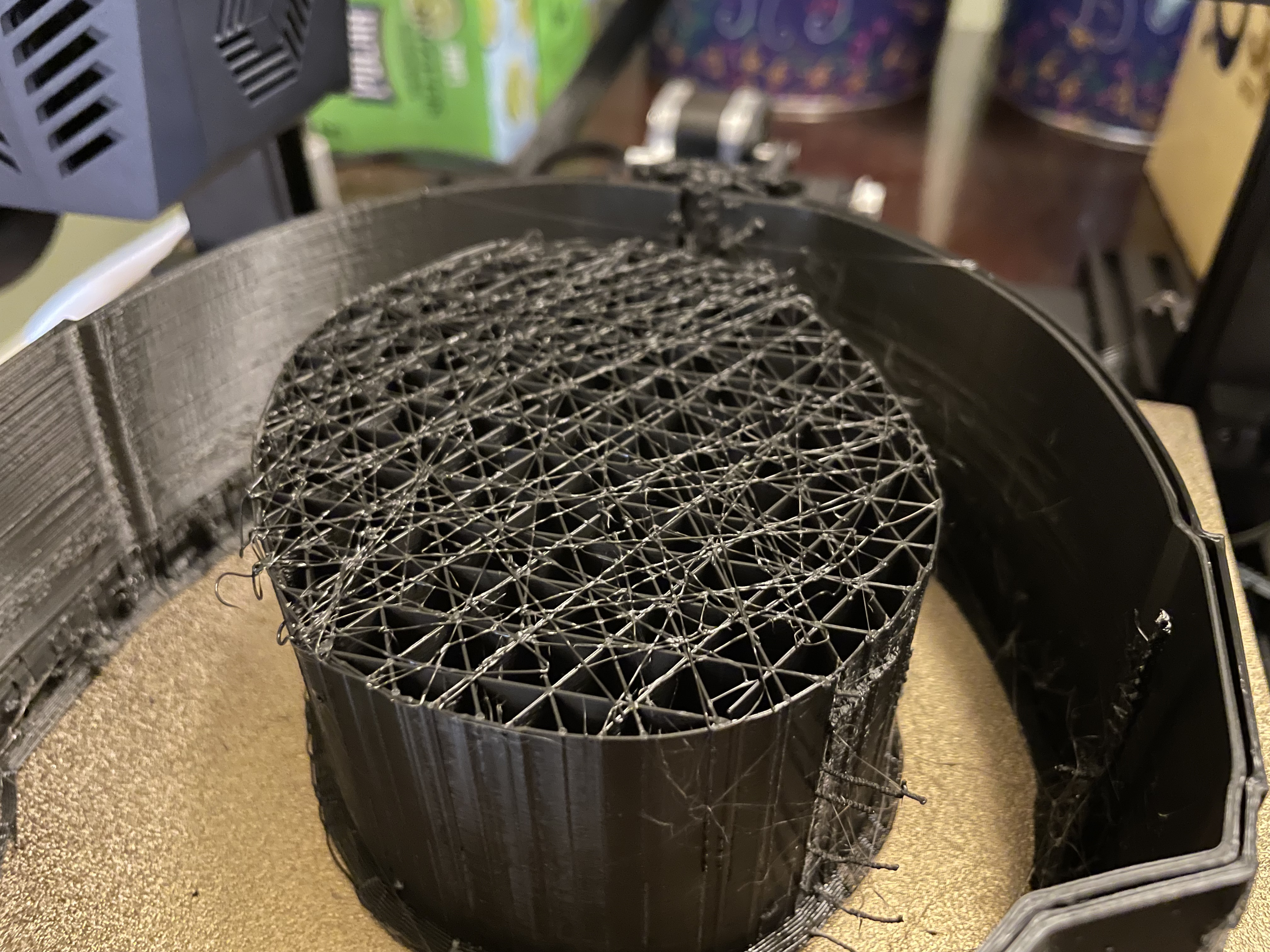

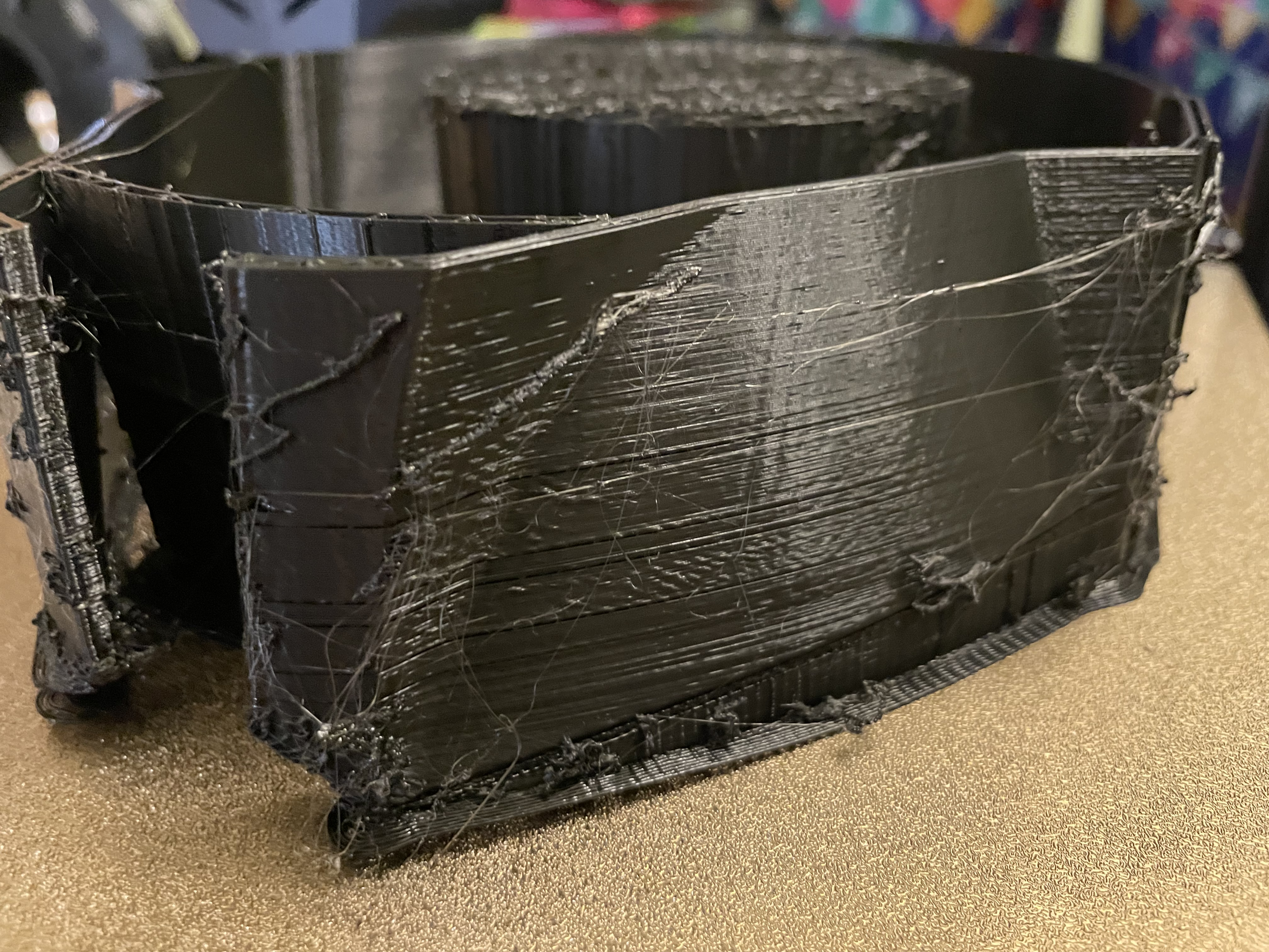

After some success with the owl test file, I decided to jump right into the deep end of the pool with a Mando helmet scaled to 85%. This was my first time using the support feature in Cura. Estimated print time was just over 2 days. Unfortunately, the two main support structures both popped off the build plate after ~18 hours.
Center support structure (which was looking nice until it popped off…)
In general, the helmet was looking ok. Some artifacts, which I’m not sure are expected for an FDM print, are visible.

Try cutting the model into at least two pieces. One for the crown and the rest, print upside down. This will dramatically reduce the amount of support needed and significantly reduce print times. Use Meshmixer to cut along a seam that can be easily sanded. Plus, if there is a problem on hour 47 of a 48 hour print, you have to do it all over again. With the sliced method, you only have to print whichever part that fails. (Hopefully nothing).

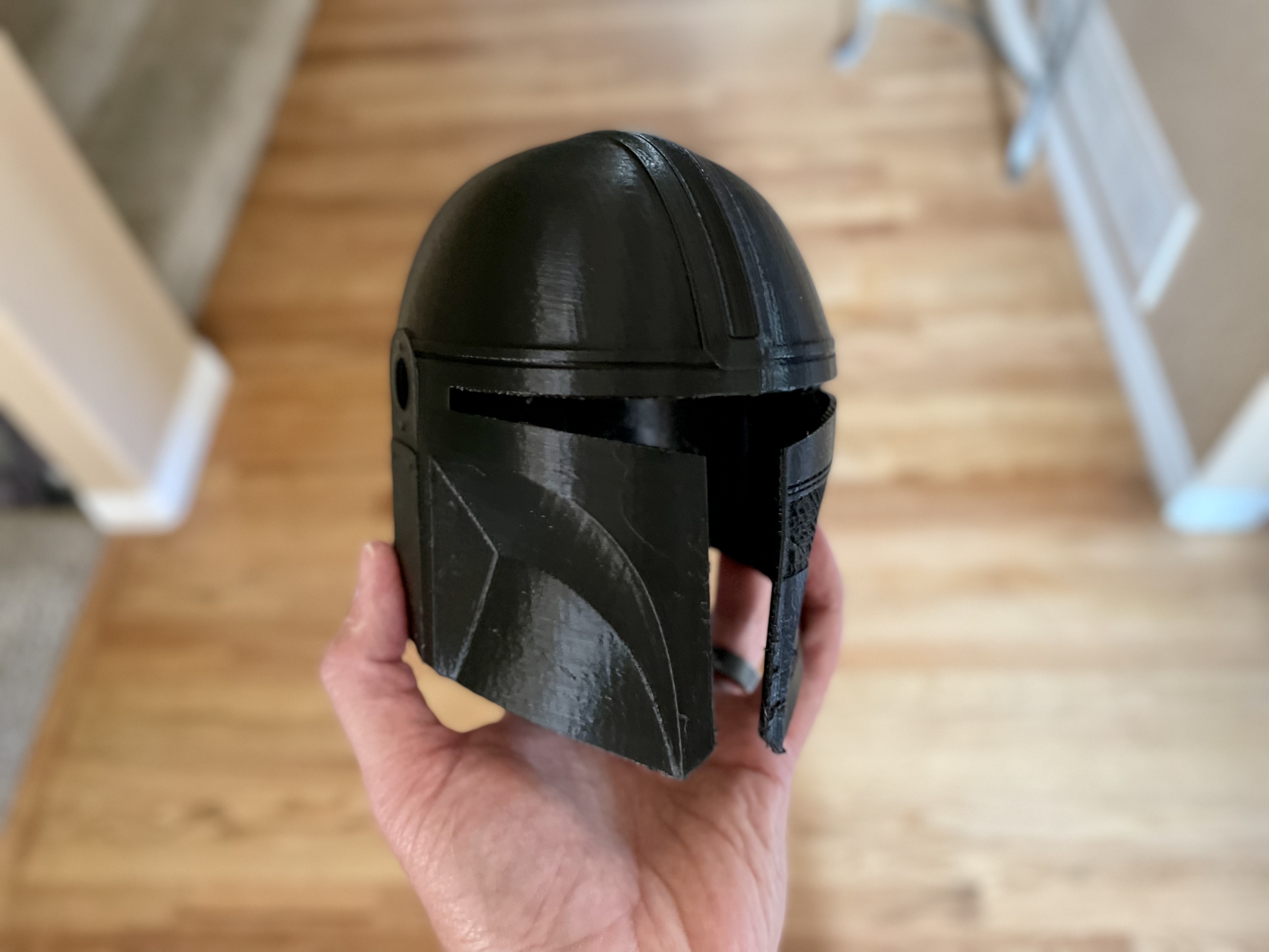

The 50% helmet did finish!

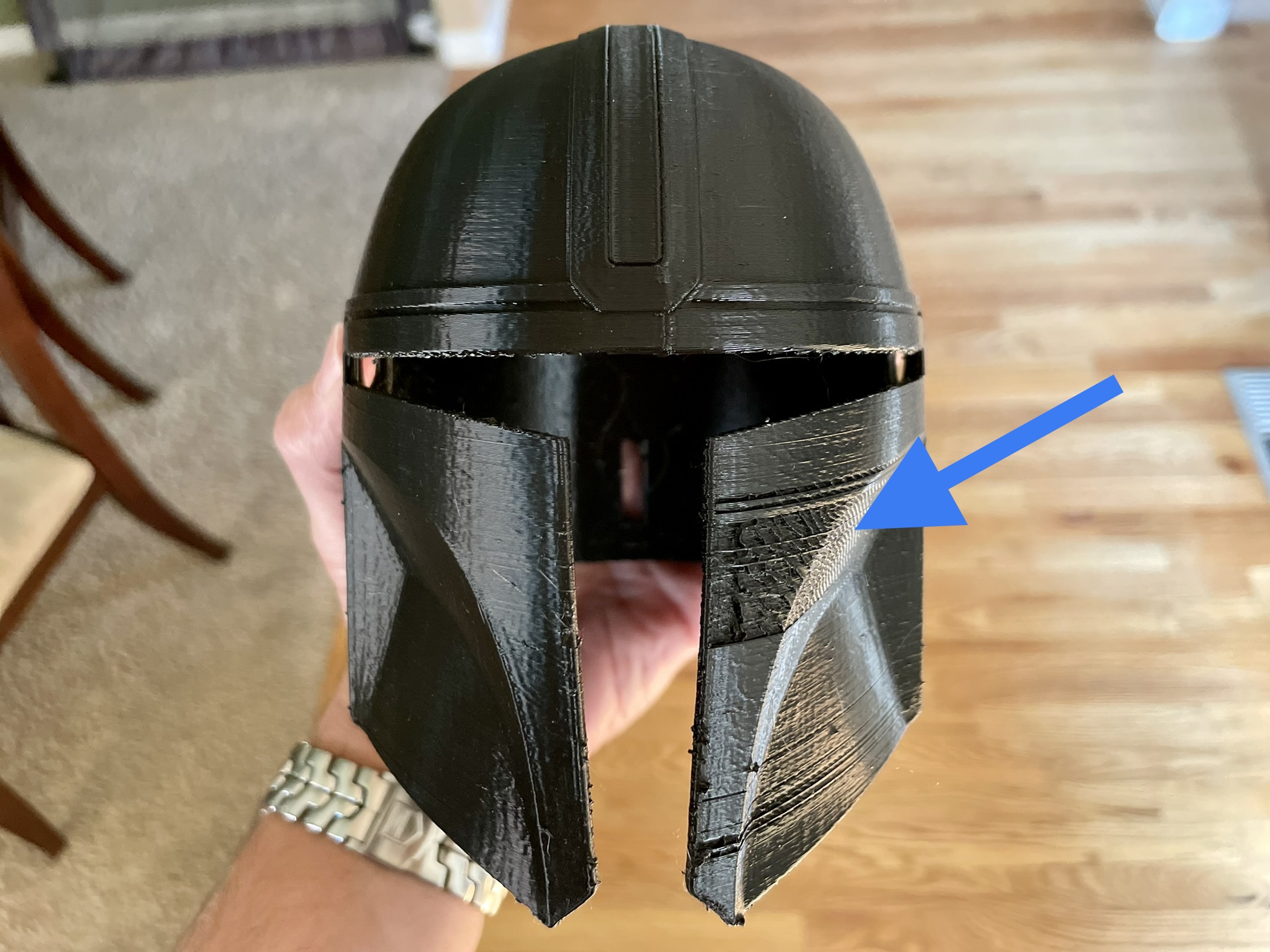

A few printing artifacts I need to investigate like this rough spot…

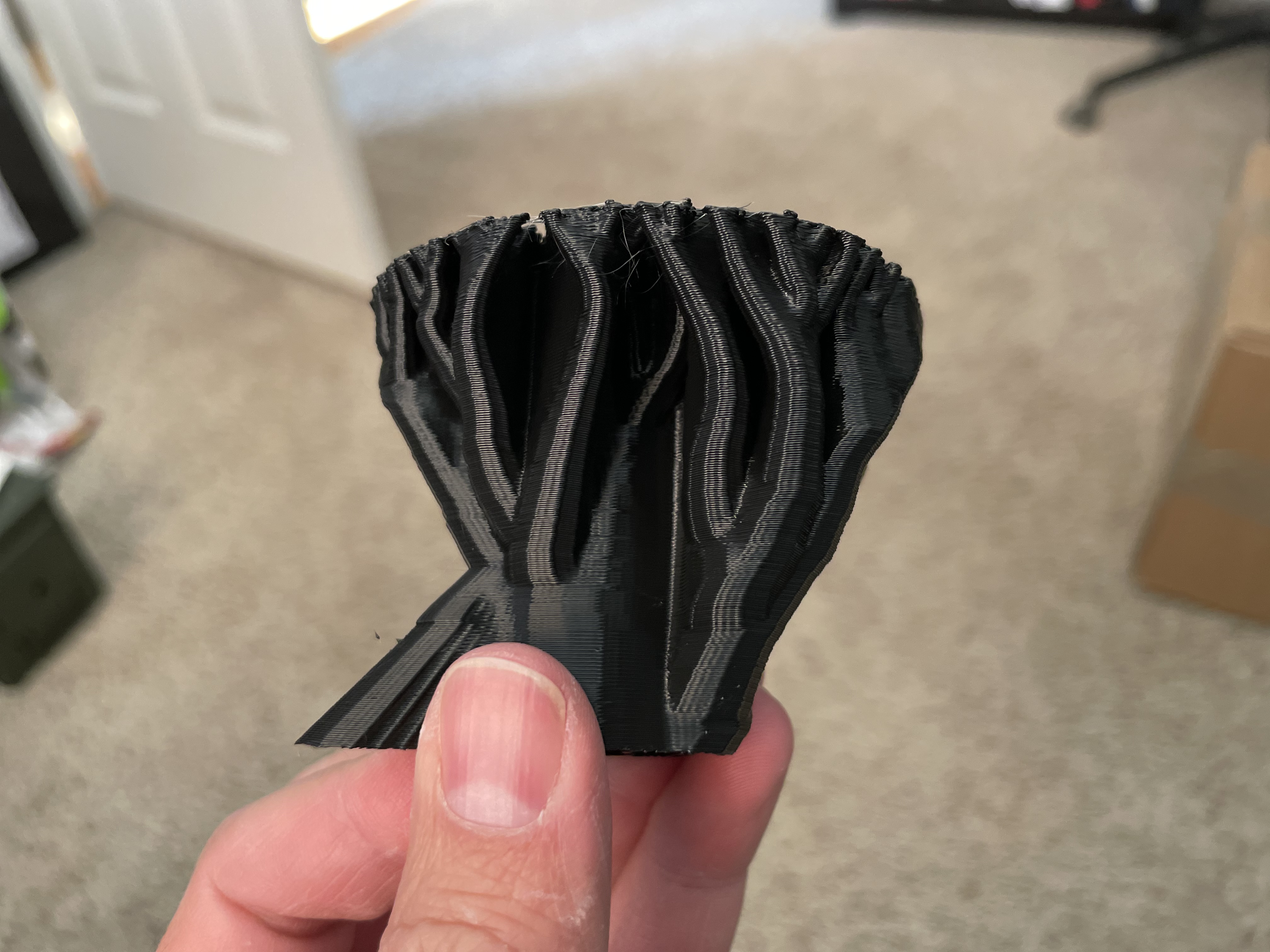

The tree supports are a work of art in themselves! This is the chunk that was supporting the dome of the helmet.

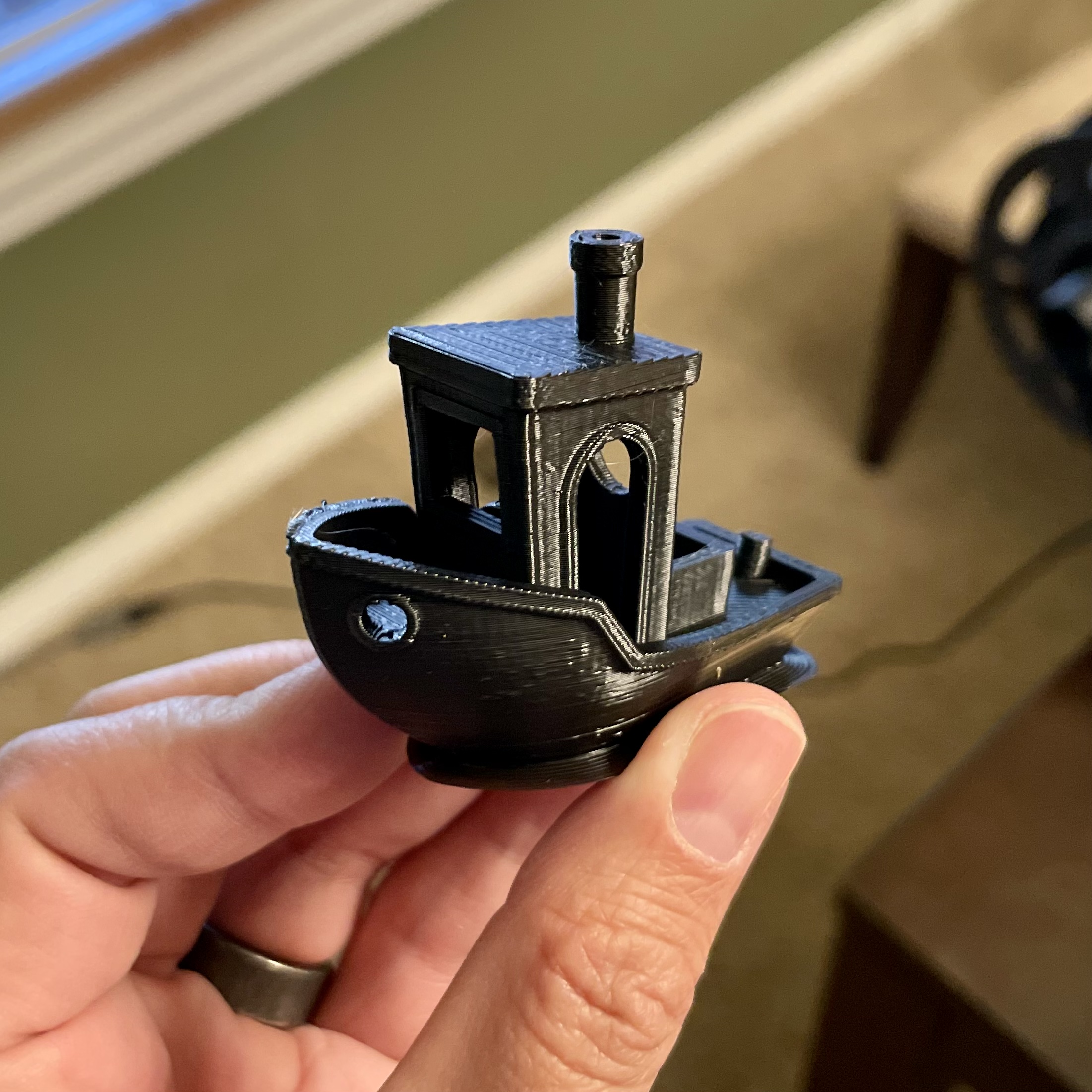

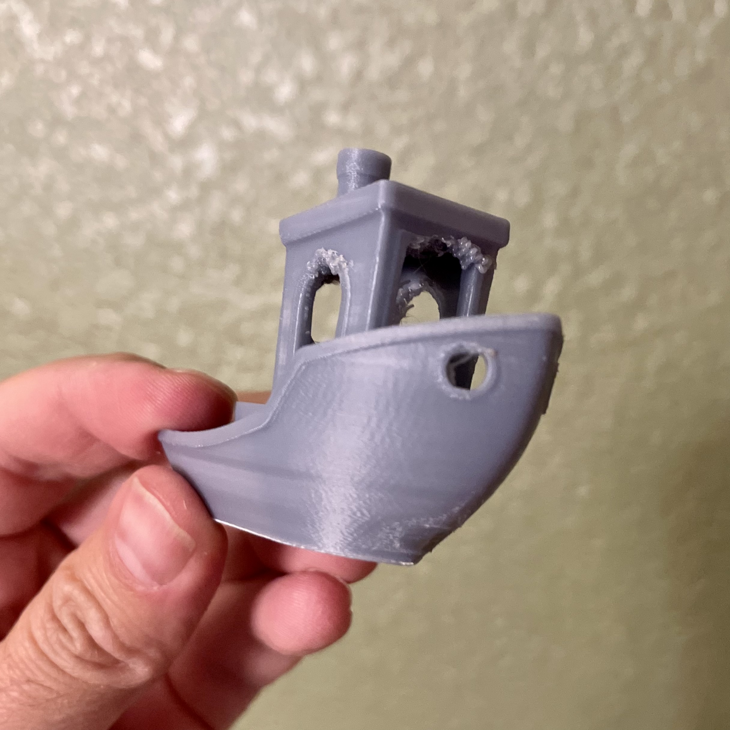

Going to try printing the Benchy boat - #3DBenchy - The jolly 3D printing torture-test by CreativeTools.se by CreativeTools

Benchies were a success! Going to use it to further dial in the printer.

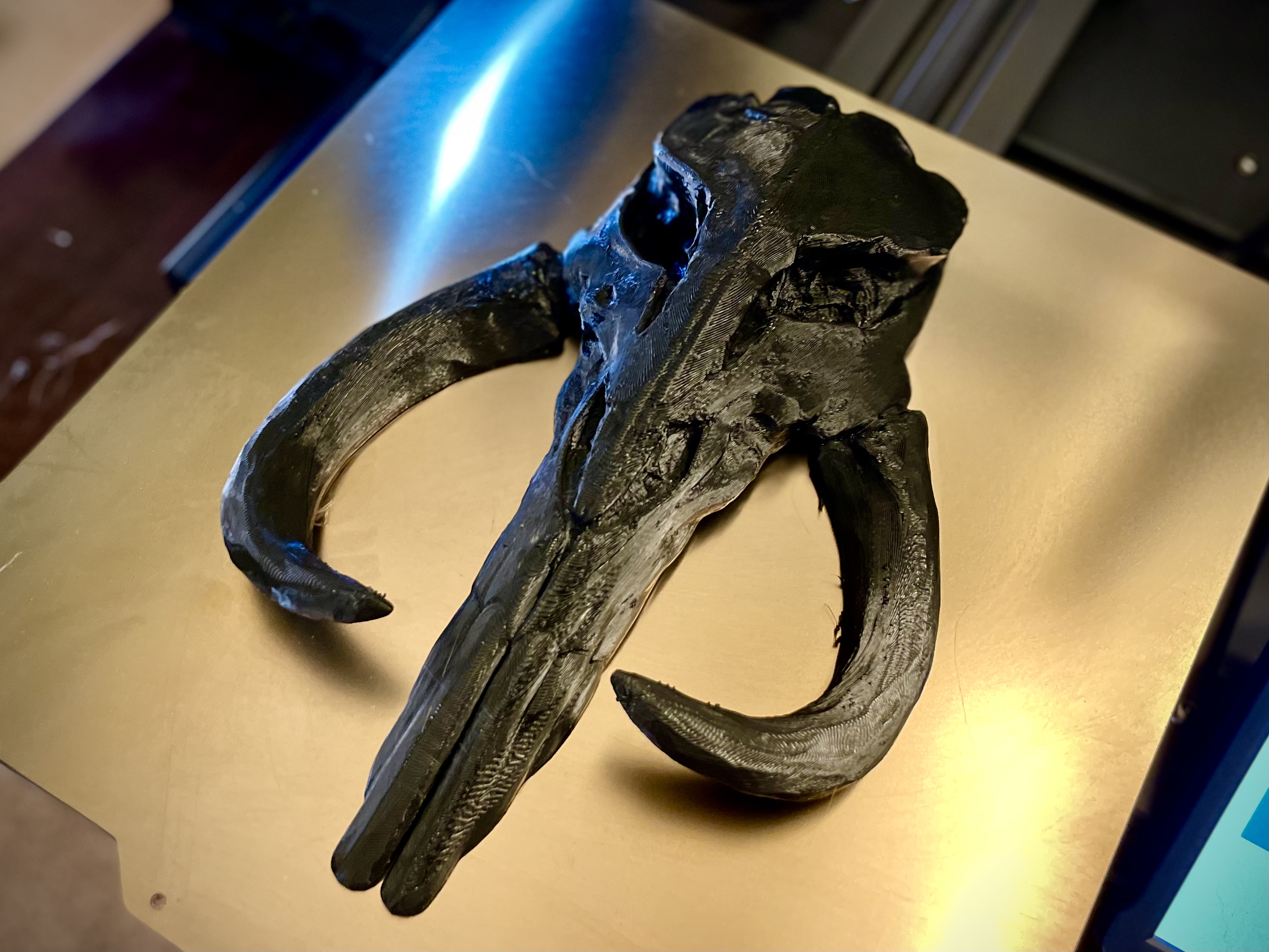

Mythosaur also finished. Really impressed with how nicely this print came out!
Hey Sean-- looking at your calibration cube and the print, I see a few areas that I think I can help you hone in on--
1. The cube has "ghosting" on it--the you can see the X is patterned through the side of the cube. That is related to belt tightness, printing speed, acceleration, and jerk.
2. Your vertical corners of the cube are bulged out and create more prominent seams. You can see this on the benchies too-- at the corners of the cabin. Tuning your flow rate should help with this-- print a flow rate cube to test wall thickness accuracy, and explore the settings related to the ending of lines-- cant remember the name of it for the life of me-- might be "enable Coasting" in cura
3. looking at the bottom of the owl prints and the bottom of your cube, along with the other post where you have a pile of prints that came unstuck, it seems your bed leveling is off-- or at least too high. I've always had great success getting the level as close as possible, then micro stepping the z-offset down through the printers tuning menu. Not sure to what extent the Aquila supports that-- I think it is running a modified Marlin firmware so it should through the printing tuning menu.
4. The rough patch on the helmet looks to be under extrusion-- you can see this in the support structure as well it looks like. Calibrate your e-steps and this should help. I know on my printer, the ender 3 v2, the extruder uses a plastic extruder arm that always has to be replaced because it cracks. If the Aquila has a plastic arm, highly recommend replacing it-- its about $5 on amazon.
5. Lots of stringing on your helmet-- tune your retraction rate with a retraction tower test and you should be able to find the sweet spot. I print at 5.5mm retraction, but every printer is different depending on the exact length of the Bowden tube.

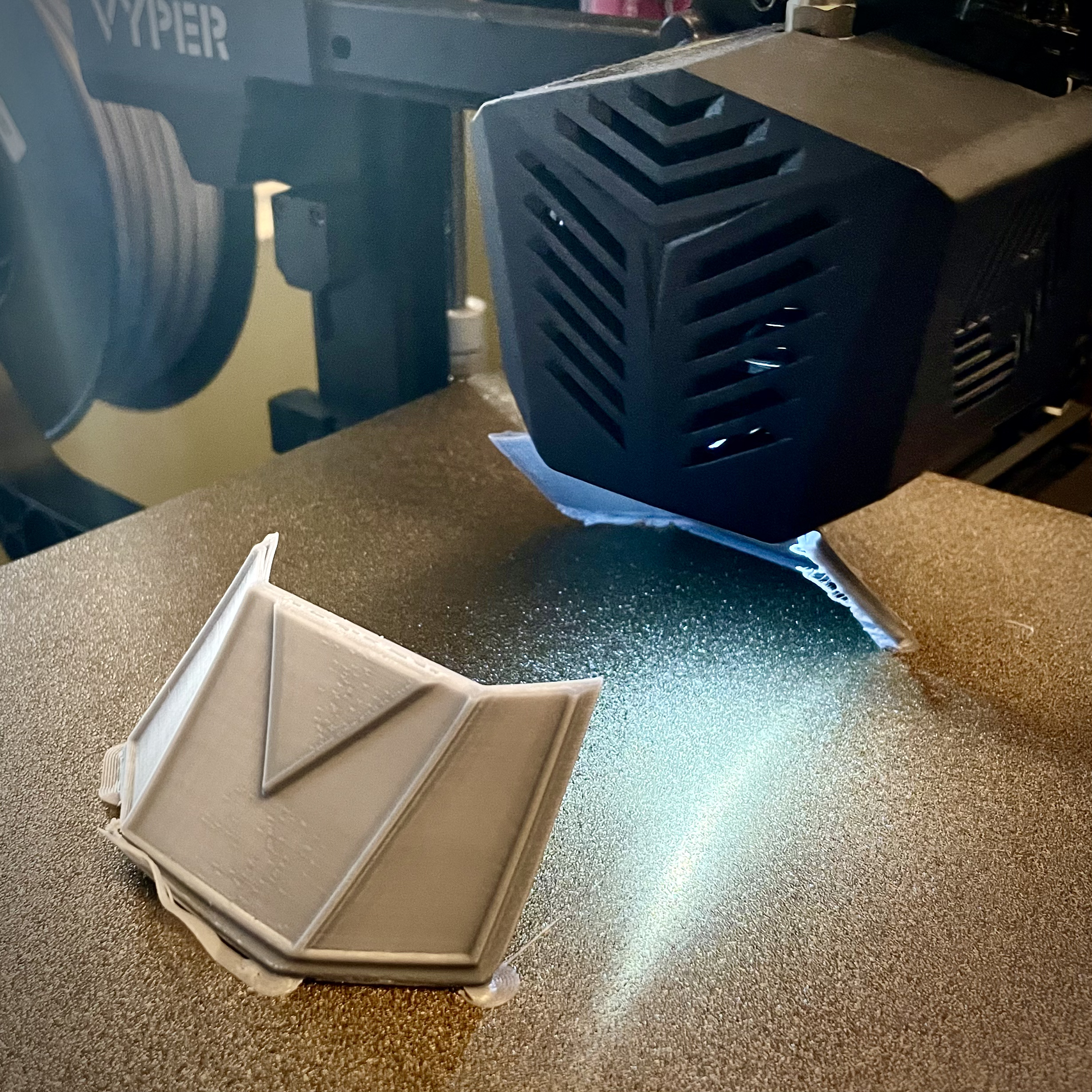

Had various struggles trying to get the Mando hand plates to print, but finally found an orientation that worked…I think.

That's all you can ask for sometimes, haha. Given the geometry of this piece, this is probably the only way that makes sense, unless you want to wast a ton of filament on supports for similar results.
They look pretty good overall, and you've gotten to my own personal "good enough" state I like to be at where any imperfections can be fixed with 120 grit paper and a knife. Looks like you've dialed in a lot of settings since you posted the benchies. You can clean up the the zits in the faces a little by switching the "z-seam" in cura to "sharpest angle" and they should be hidden better that way, but theyll always be present to some extent. The stringing on the right piece should be fixed whenever you can do your retraction testing.
I also think your z-height could stand to be tuned down a step or two, but only for your sanity more than anything-- looks like you had some trouble with bed adhesion on that brim there! Nothing more frustrating with 3d printing than not getting stuff to stick, even when everything is perfect. When in doubt, I've just started to throw a raft on there, especially with thin pieces like these. Saves so much anger.

Thanks! I am definitely in the "good enough" camp right now :) Getting semi-consistent prints has been a victory in itself, but I'm hoping to fine tune and optimize things with the Octoprint as I've seen some amazing things come off the Vyper!
