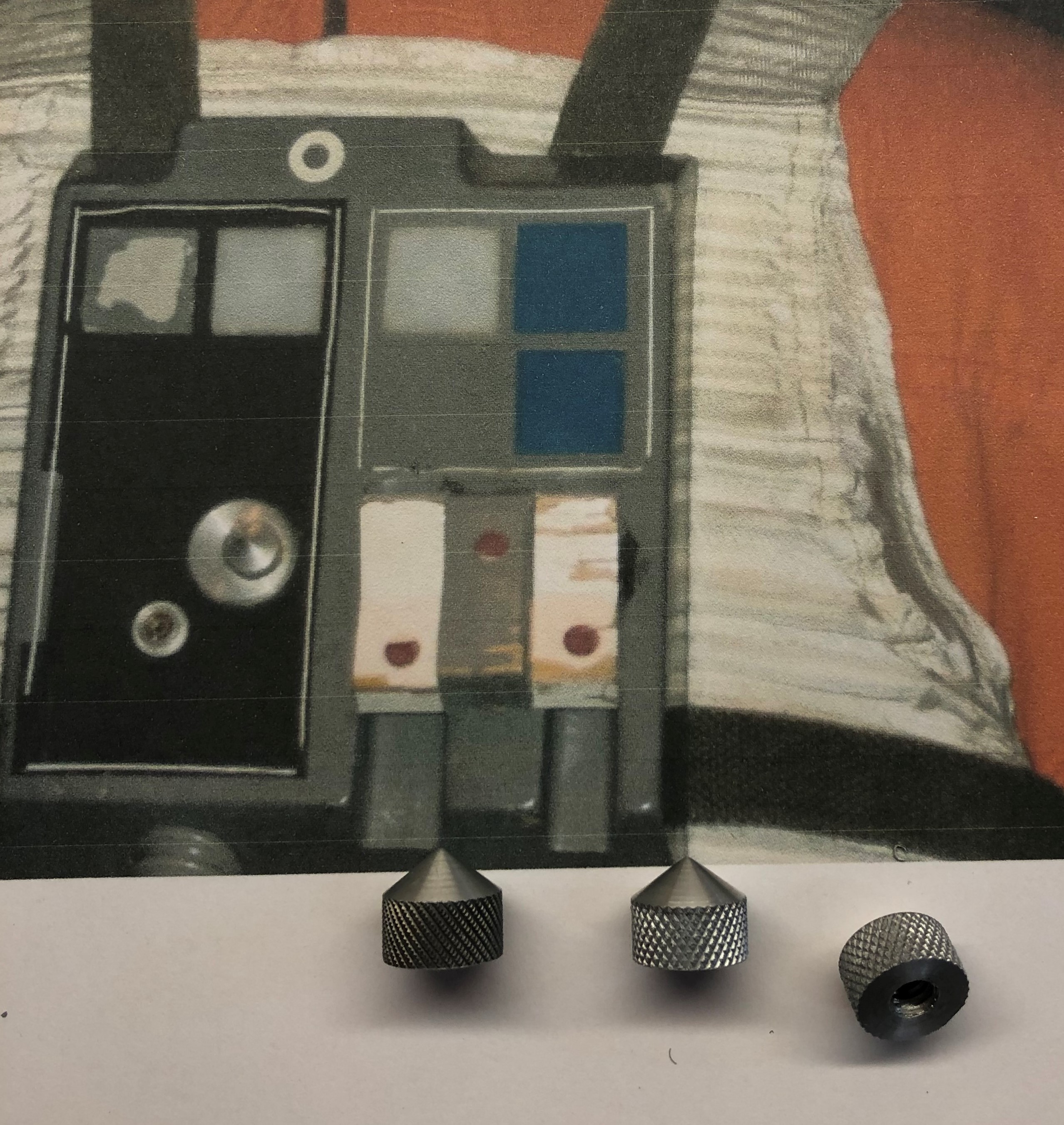

I've started machining these today. I should have a firm price on these some time next week. So far, it's still in the $10+ range.
The diamond knurling is a bit tricky, but I will post some photos of the prototypes next week in case there is a preference (Light, Medium, etc.).
I’ll await the prototype pics before weighing in. My gut says medium on the knurl, but I don’t actually have a point of reference. The others I’ve owned seemed to be too light though, the reference pics look pretty pokey!
From left to right, light and medium knurling.
Also pictured is the 1/4-20 threading, which is the same size as the Han Hero and ESB blaster mount rods.
When you guys get a chance, let me know what you think. I can possibly go a little lighter and definitely heavier on these. Thanks. ;)
I'm coming up with a total of $15 per part based machining the two prototypes, but if I'm making 25 of these,
$10 per unit should do it. $5 will cover US shipping for any number of units.
I can start taking orders on these as early as today (11/6).
I only have enough aluminum to make 25 units, so once the list fills up, that's it for this run. :)
I'm lucky enough to get a three day weekend coming up, so I expect to get this run done fairly quick. :)

The list has been updated and I will post a new photo of a version with heavy knurling this weekend.

If we do enough, and they end up being 10, ill.commit to 3! I recommend heavier knurling than your medium version.

when will you be taking payments? is there any way to not have mine drilled for 1/4-20?
I'm taking payments now.
Yes, I can avoid drilling your parts. I do have some metric taps. I will check the sizes this weekend. It looks like 5mm is just under 1/4.

If it’s not difficult I’d love mine to be 6m or blank, I’ll be sending payment tomorrow if I can’t make it tonight

You're in luck. I just happen to have a 6mm tap. It's probably left over from some R2 parts.
