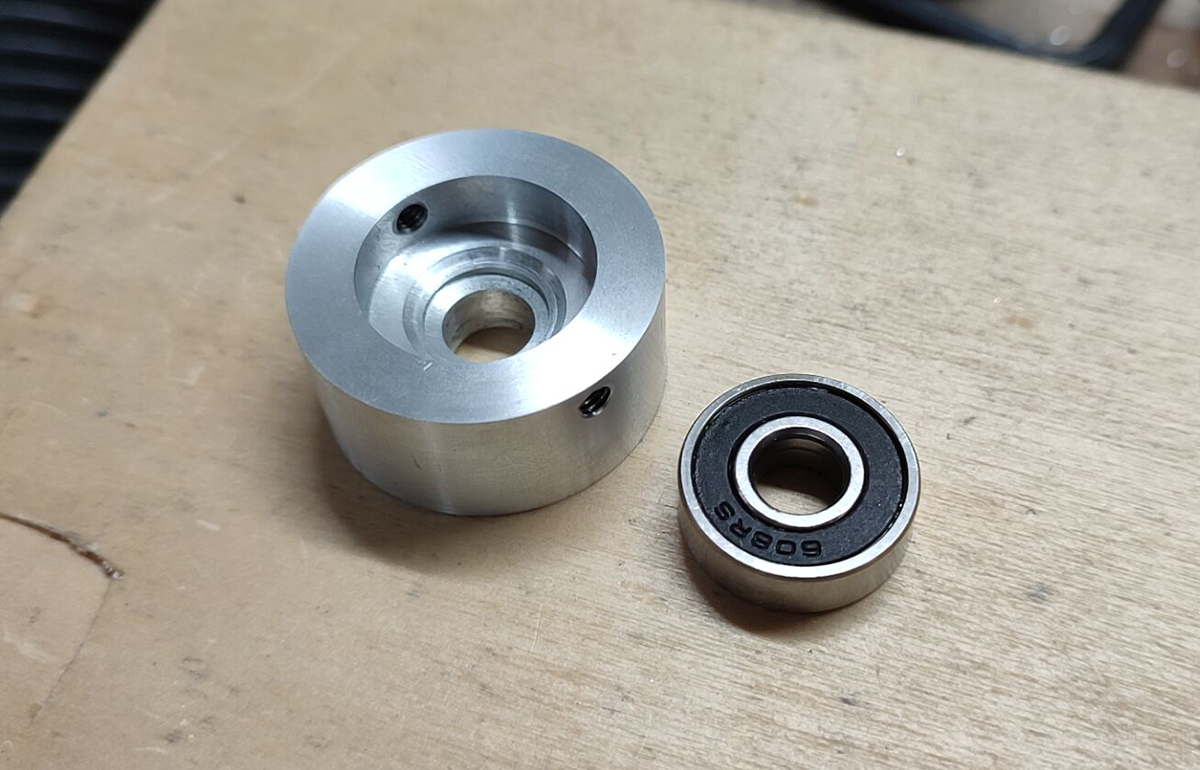

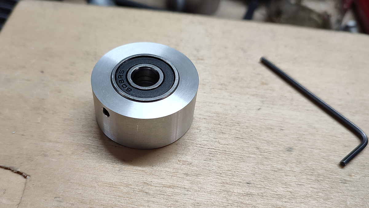

22mm diameter? That is not what I see on my model. I'll pm you to discuss and understand your info. Thank youI would use the generic 608 sealed bearing

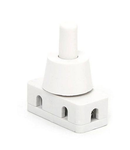

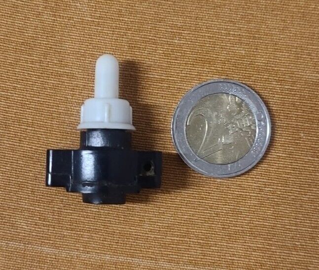

hey,Anybody got a line on that white button/switch thingy?
This is incredible! Count me in on these motorized stunts, if it tests successful!I have ordered white switches for the run, they will be included with the kits (If I receive them - aliexpress - first time I order there - completely against my principles!).
They look a bit blank but they have metal screws as connectors whereas a lot of others have plastic screws that I didn't like. And, I have seen several other people use a similar shape, and I don't know, maybe they have clearer references and know they are correct! I personally can't tell from all the refs I have.

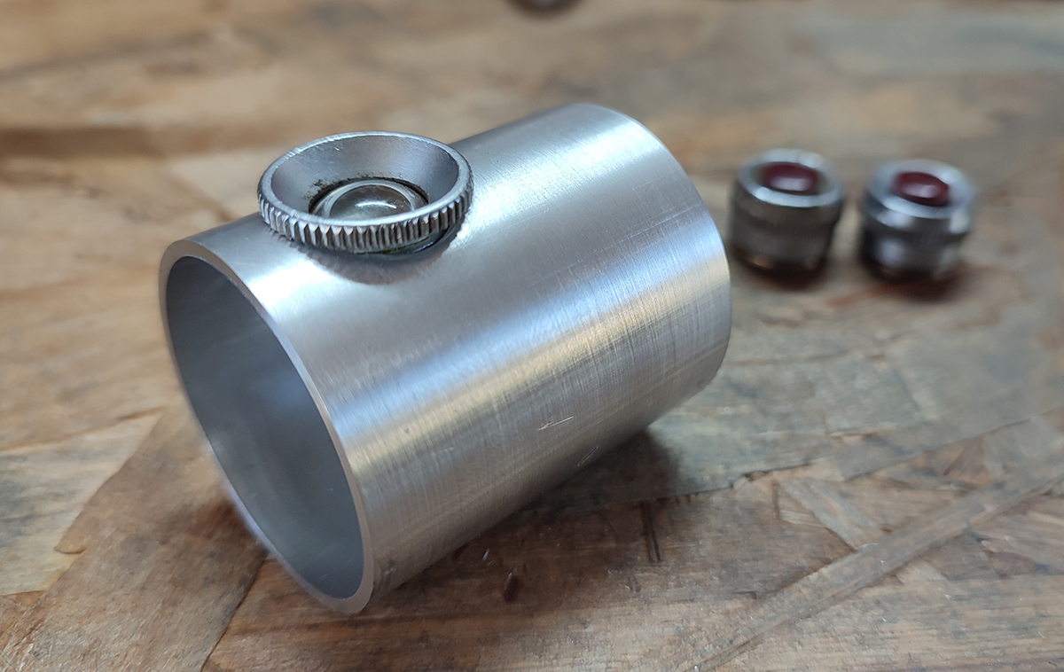

So, as a side option, I will do 8mm stainless steel rods with aluminium shaft couplers to attach to motors and attach a blade to it, And I can also provide small aluminium sleeves with set screws to act as spacer between the 35mm inside wall and the 25mm diameter motors that seem to be standard. You buy your own motor and wires and you get basically everything you need for a motorized stunt.

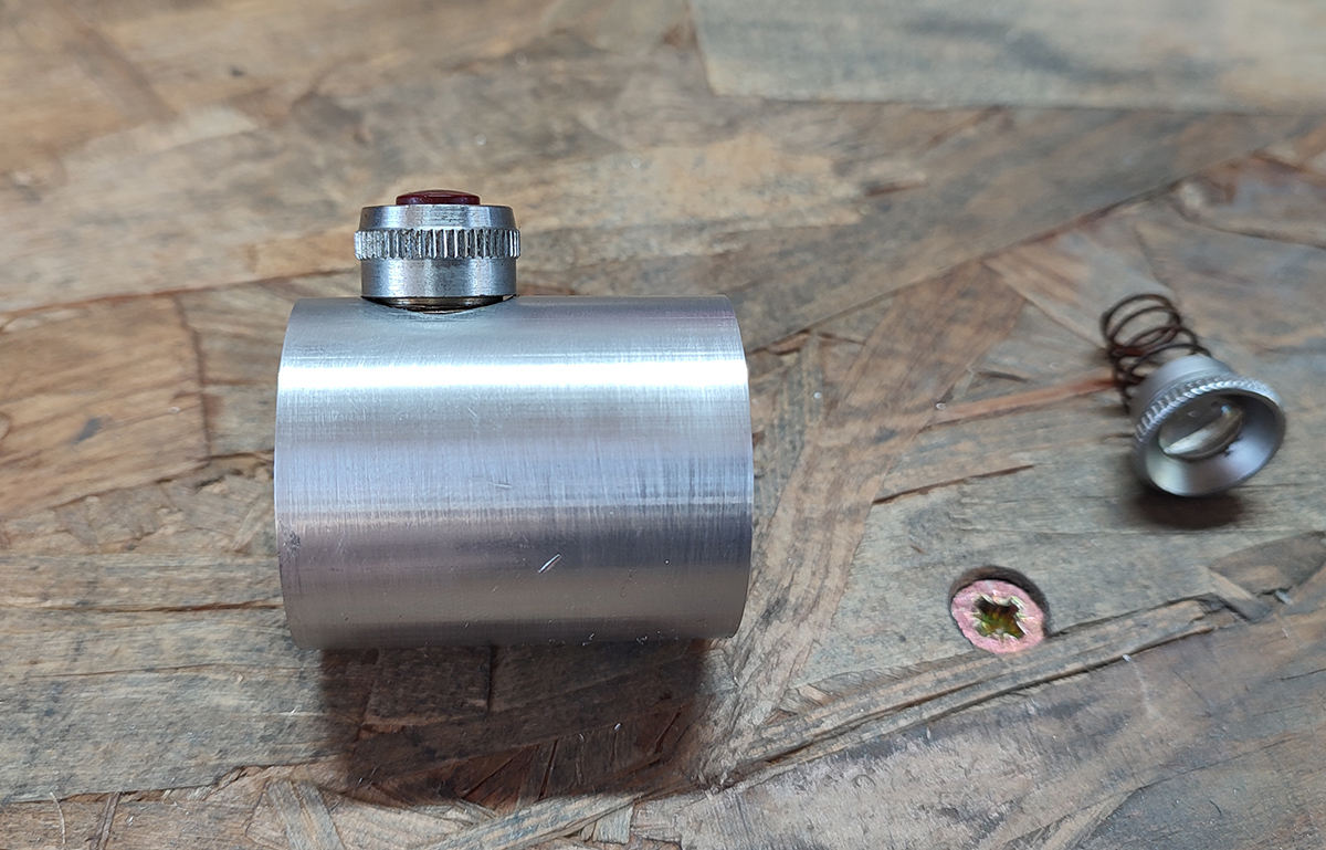

On top of that, if it all works well, i'll probably offer around 10 or so finished motorized sabers. Where you still need to source your clamp, red button, glass eye and grips, but you put batteries, you press the button and it turns
