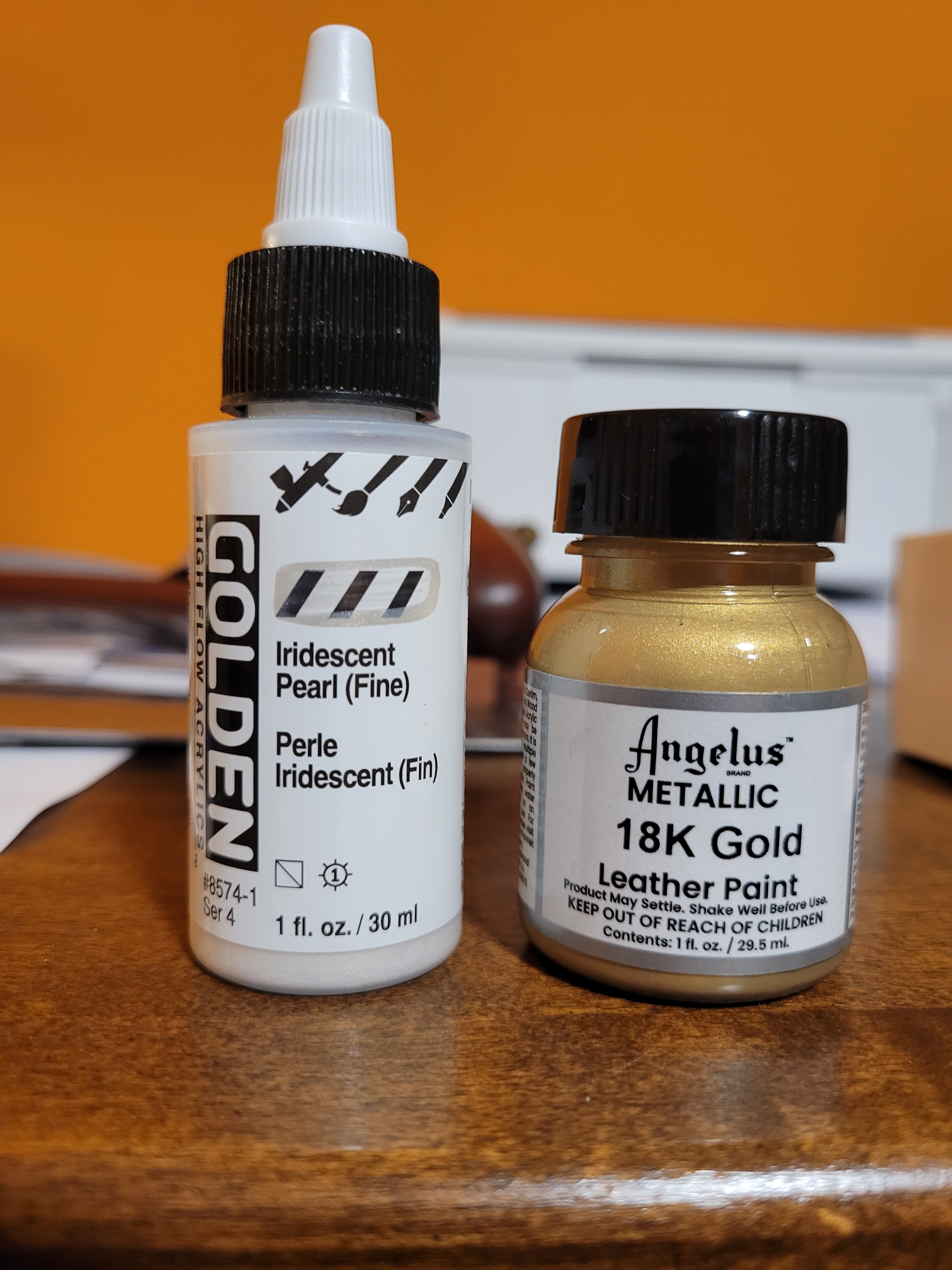

So far I have painted over the bright yellow thread with some 18K gold Angelus leather paint, with a very small brush. And airbrushed the chain mail with some iridescent pearl high flow acrylic paint from GOLDEN. These are subtle differences, but a bit closer the prop.
I do think you could get the chain mail a bit brighter by using a white primer first.
View attachment 1792452And here are the paints I used. It did take a bottle and a half to spray the mail, both inside and out.
I still need to assemble everything and will update more as I go.
