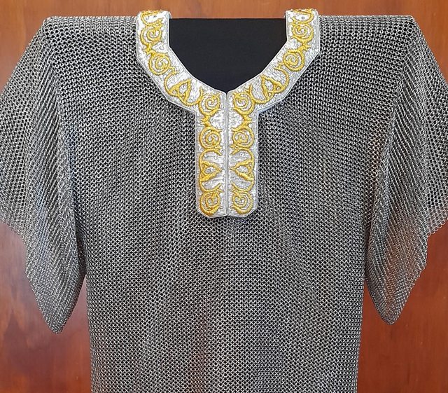

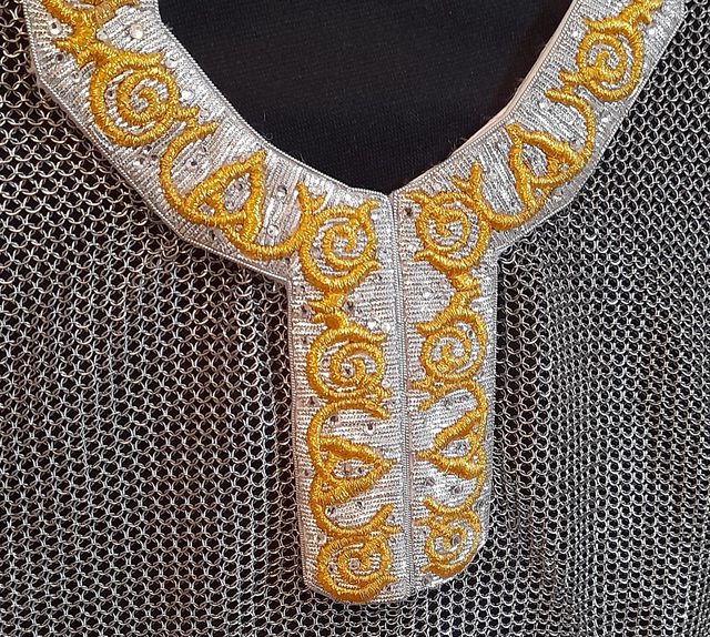

Limited Run LOTR Bilbo's Mithril Shirt

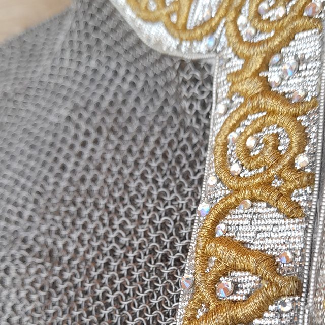

Here is a quick video of the kit as I received it. Very nice job on the embroidery and the chain mail is done very well and has a heft to it.

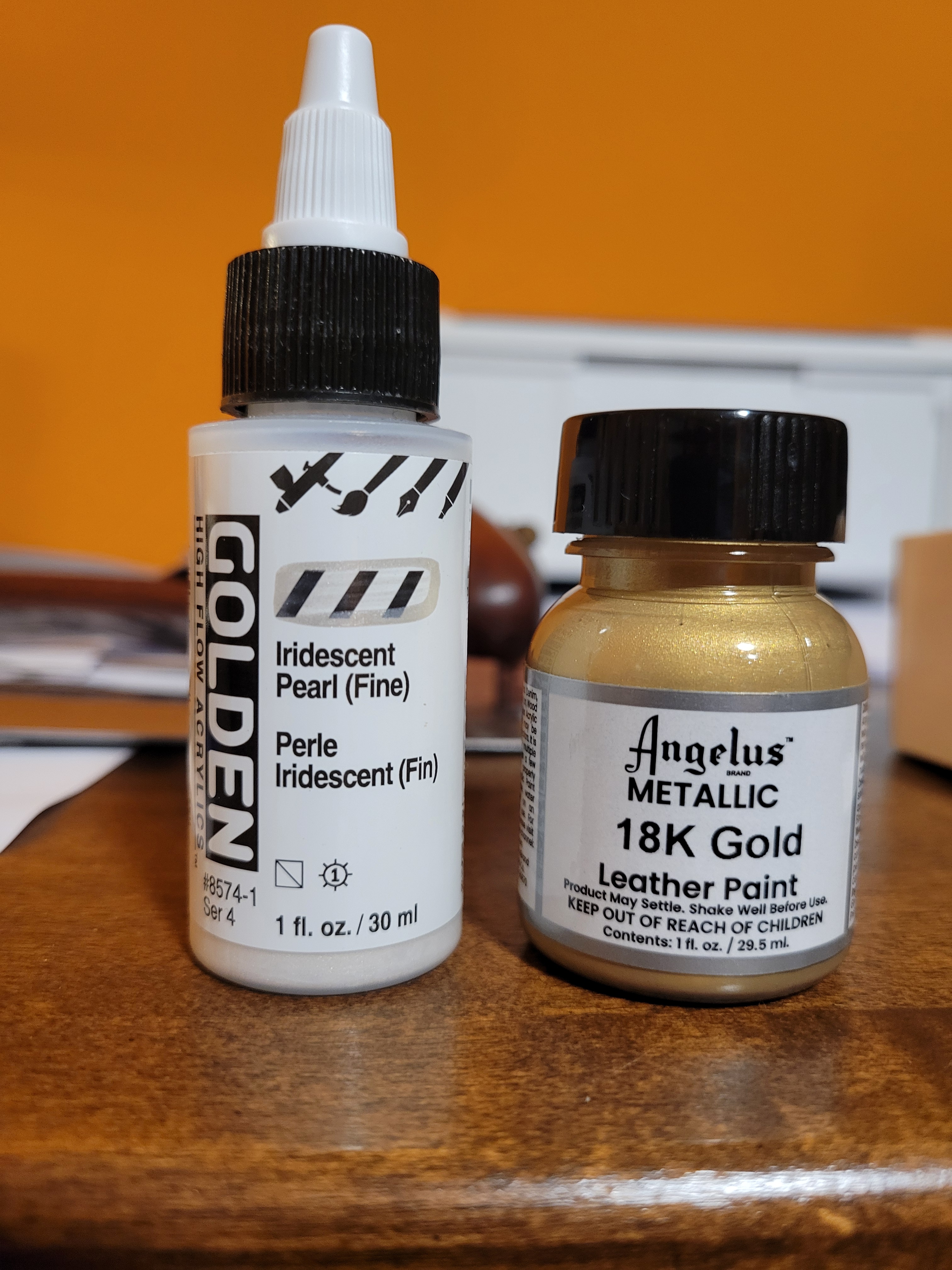

So far I have painted over the bright yellow thread with some 18K gold Angelus leather paint, with a very small brush. And airbrushed the chain mail with some iridescent pearl high flow acrylic paint from GOLDEN. These are subtle differences, but a bit closer the prop.
I do think you could get the chain mail a bit brighter by using a white primer first.
And here are the paints I used. It did take a bottle and a half to spray the mail, both inside and out.

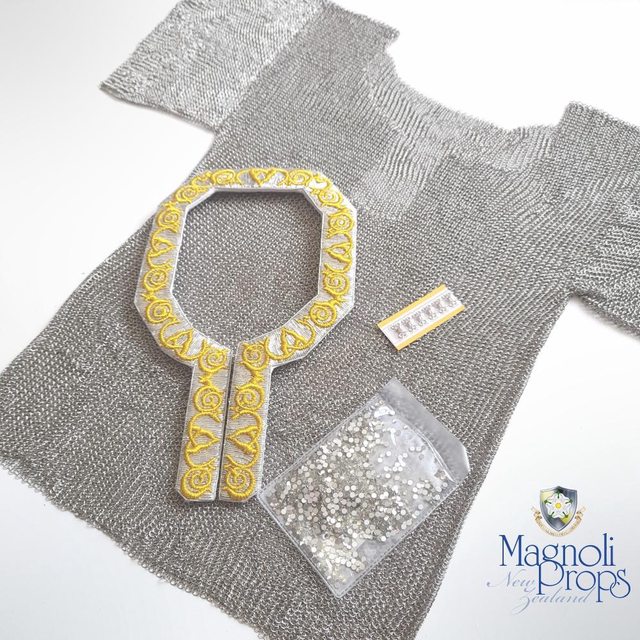

There are also 6 "J" hooks that have to be attached to the collar to keep it closed (also hand stitched on) as well as the 400 crystals that have to be glued on 1 by one.
