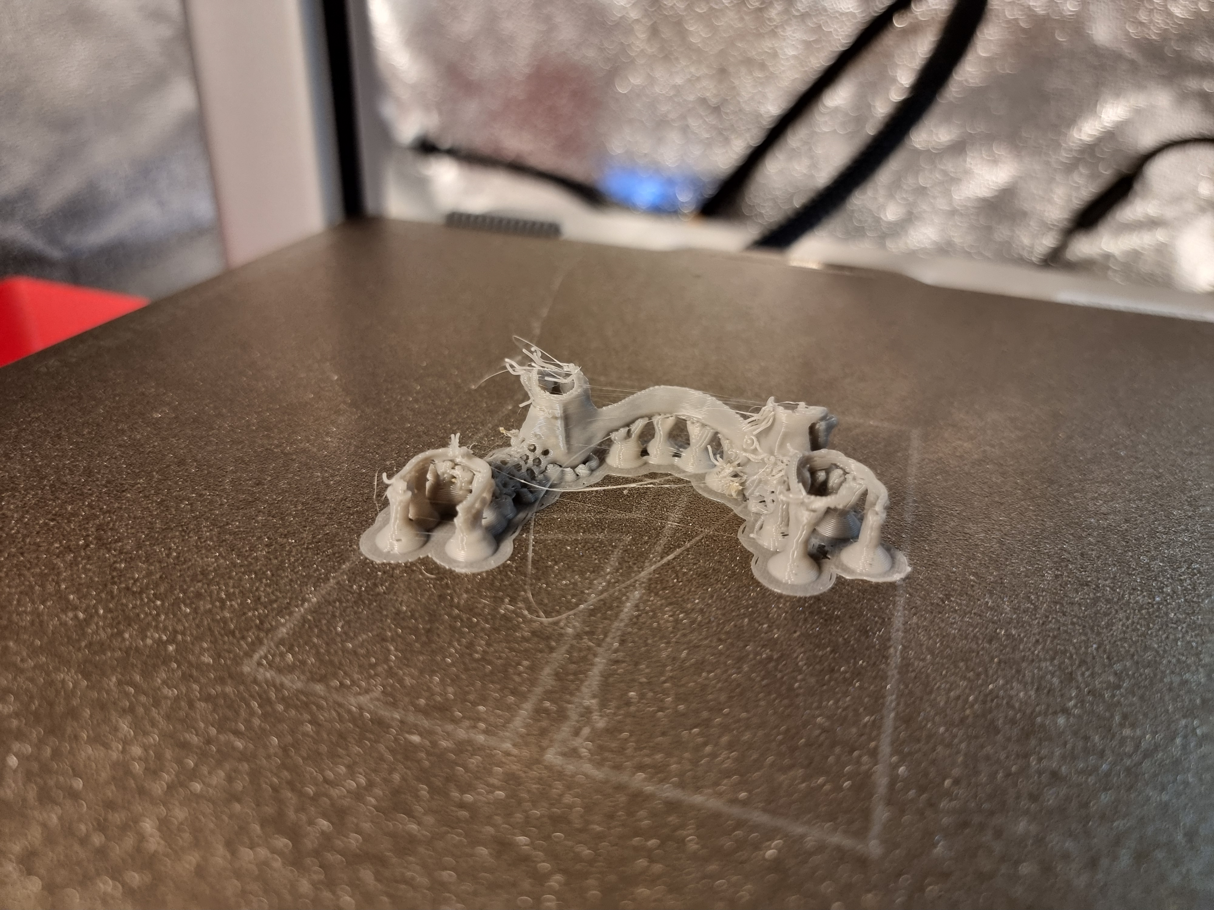

Experiment Time
So my son and myself decided to try some Dental grade STL files as he has just completed a course in 3D dental mechanics.
This was printed in Sunlu PLA grey
Slicing went well and the supports/sprus did their job well and easily removed.

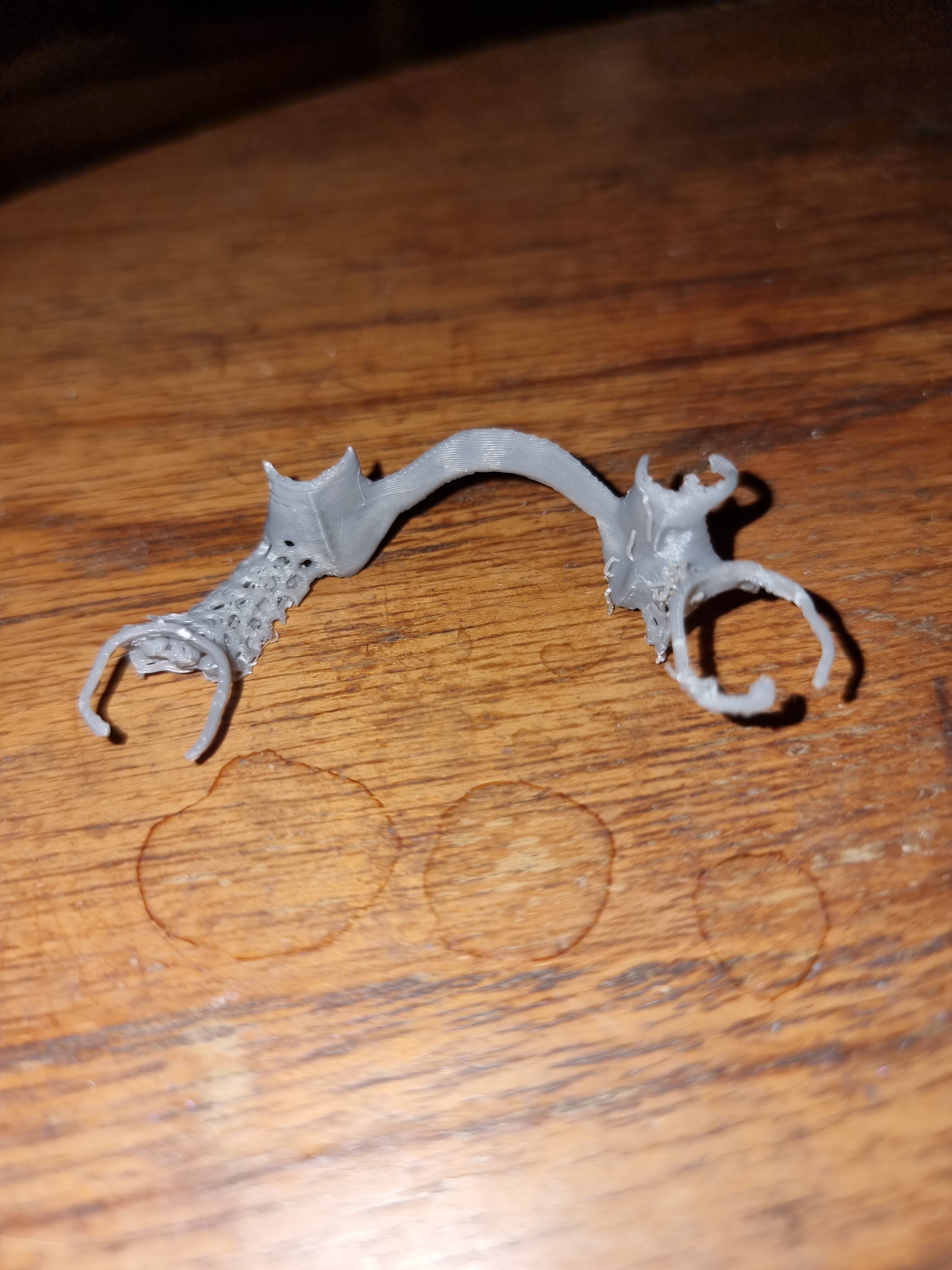

The clean up was minimal and on a par with dental casts made in centrifugal casting machines of old. There are labs that print these in cobalt chrome so obviously a lot stronger but I was very impressed with the Bambu level of detail with a 0.4 nozzle..
The saddle/perforated areas are supposed to look like that to maintain a minimal weight as in the real world the metal framework would be partially incased in acrylic resin.
