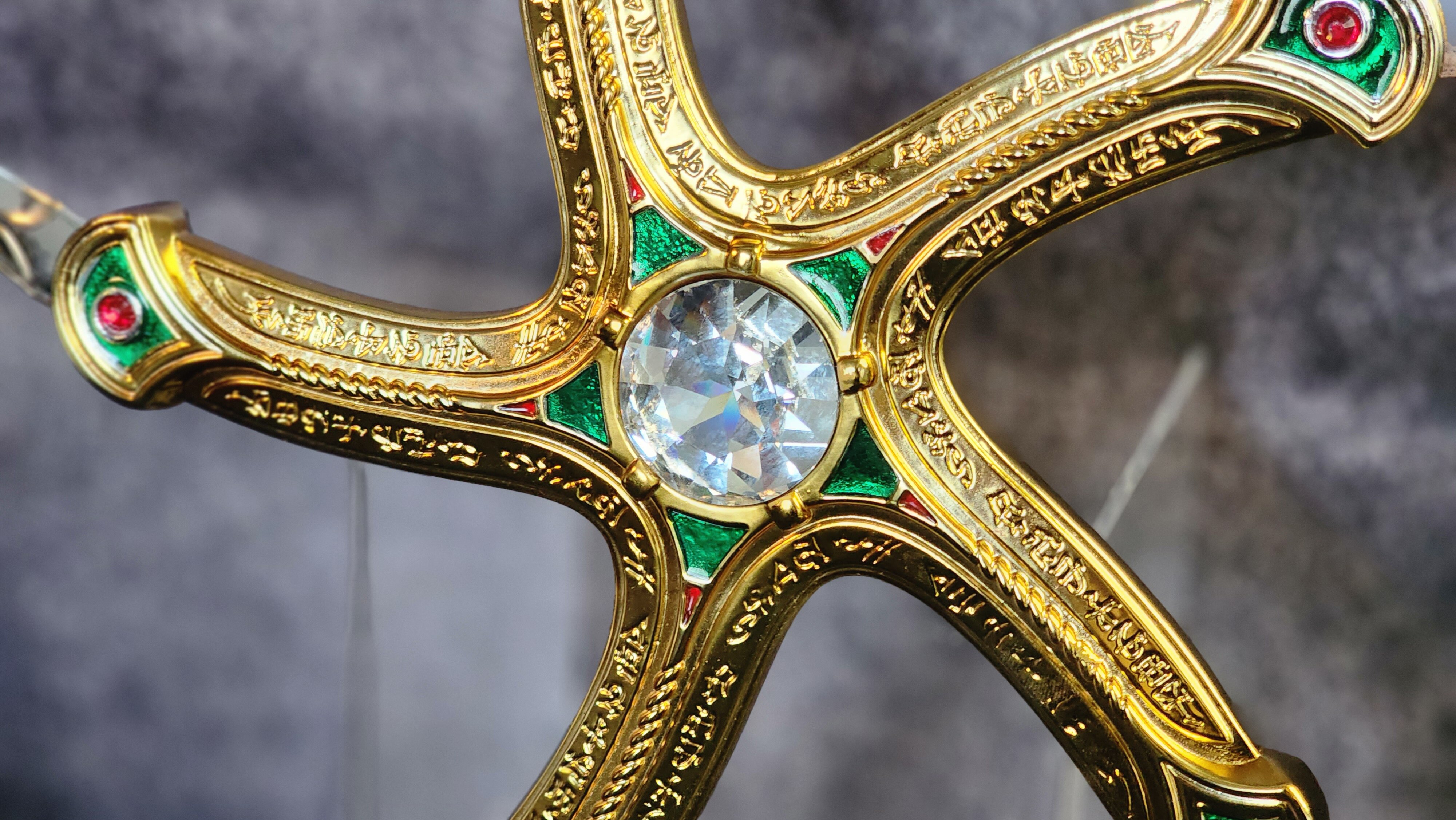

The Glaive that went up for auction didn't have chrome on it, because of it's age and it wore off... Kind of like the Indy Idol that was Green instead of Gold, since the Gold-plating wore off over time...
So, I personally would not go off the Propstore Glaive for accuracy, since it's old and most of the finish has worn off...
The Propstore Glaive was also cast in Brass, which is why it looks Gold...

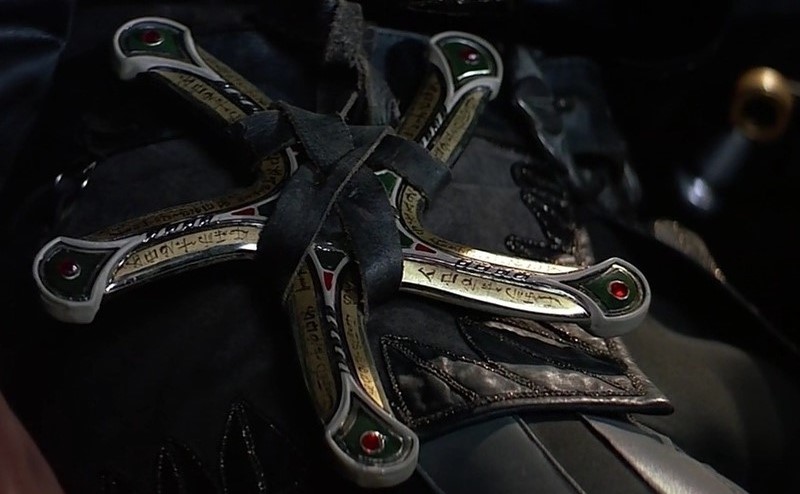

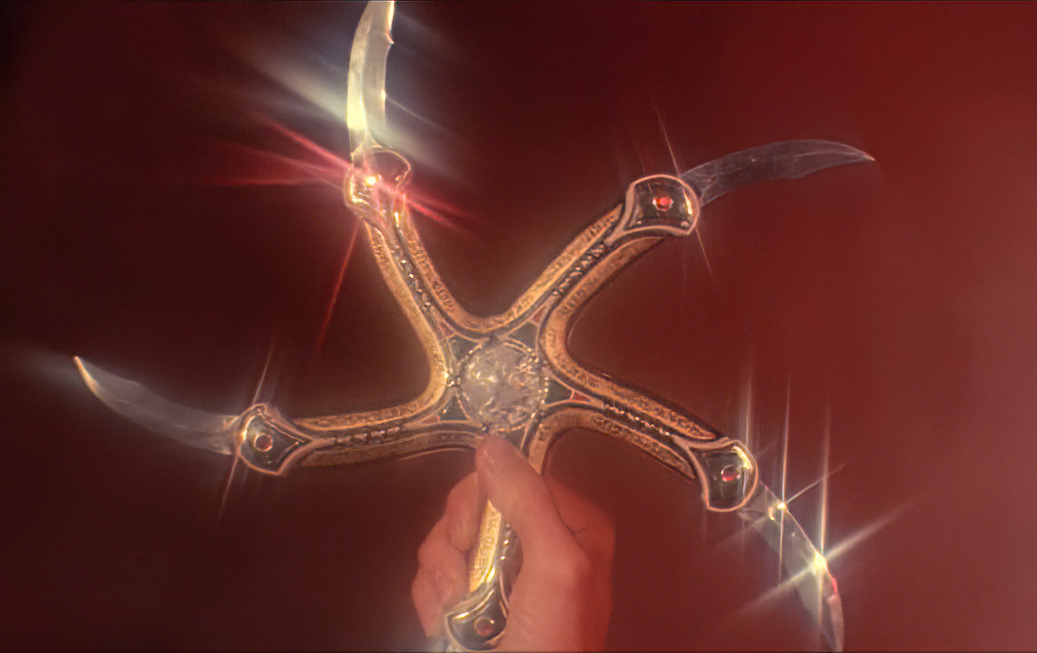

Here's another Screen Capture from the film to show you more of where the Gold is and where the Silver is located on the Glaive!
Relicmaker's is probably the best screenshot, but here's another just for reference. I ran this through a sharpening algorithm to better bring out the details. This version would be the prop store version -- the one with the functioning blades. So it's pretty clear to see just how much the finish on it has deteriorated over the years. Originally, it would have looked almost identical to the "belt hang" version in Relicmaker's screenshot above.

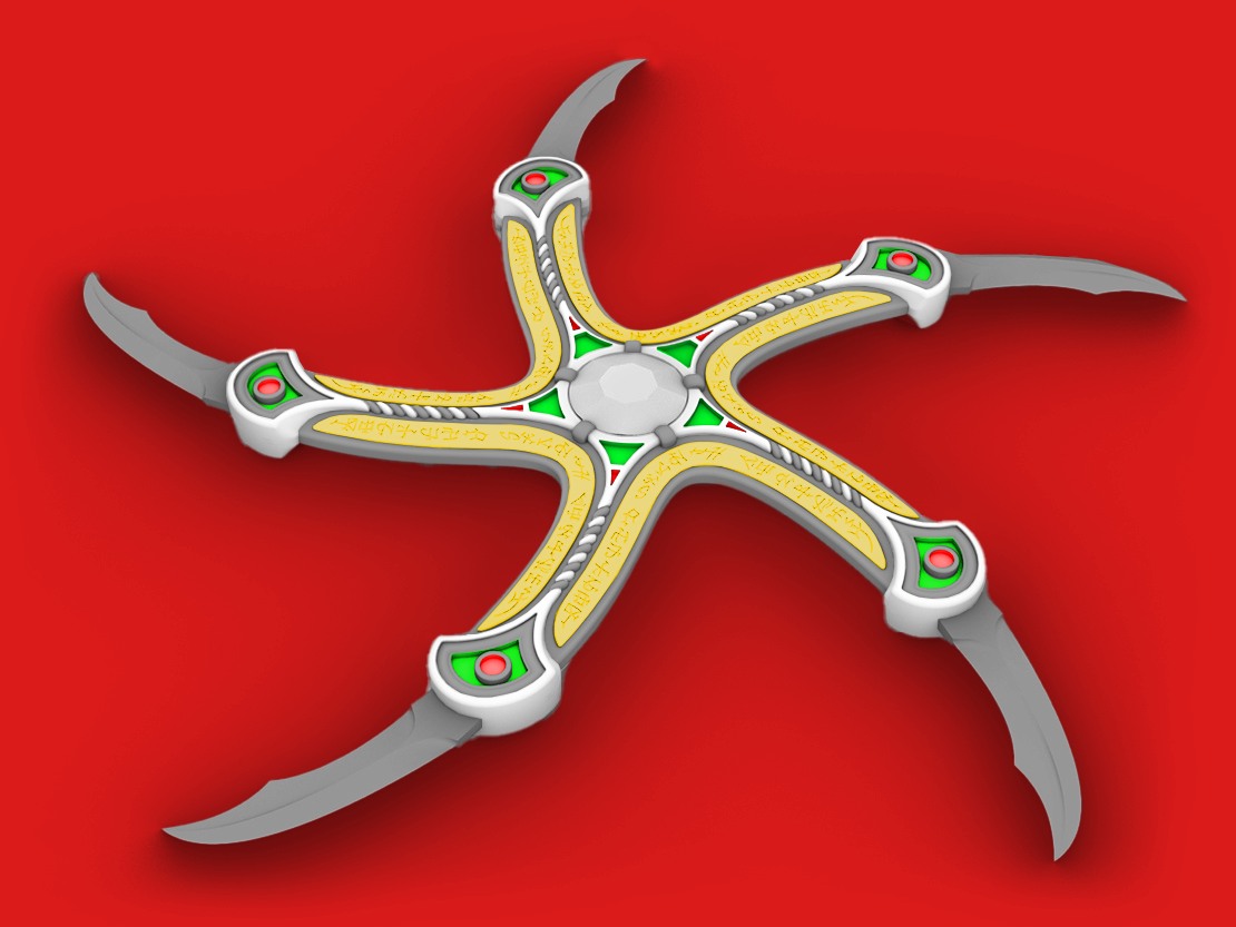

I made a quick color reference for myself from one of RelicMaker's 3D shots, taking into account your comments, and thought I'd share. Someone please tell me if I've gotten anything wrong!!
Looks great! You just saved me from having to do this step of making a pattern to work off! Thanks!
This is exactly what I'm saying! It doesn't make sense to have Gold-Leaf on top of Shiny Gold...
So, it would make more sense it being Chrome Silver with Gold-Leaf....
Especially, given the contrast between the two colors in the Screen Captures. ;)

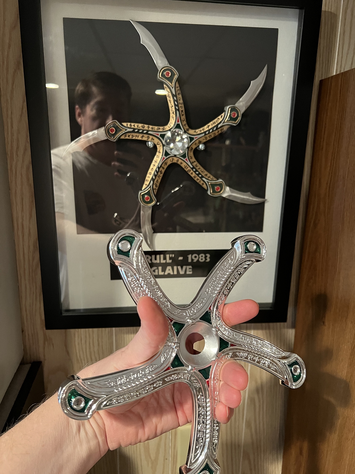

Got mine and this thing is very nice and amazingly heavy. Planning to wait a little to see how others finish it and compare techniques. I personally don't want super shiny gold.
Here's a pic of the new one from RelicaMaker compared to another Glaive I acquired a couple years ago and made a case and plaque for it.
