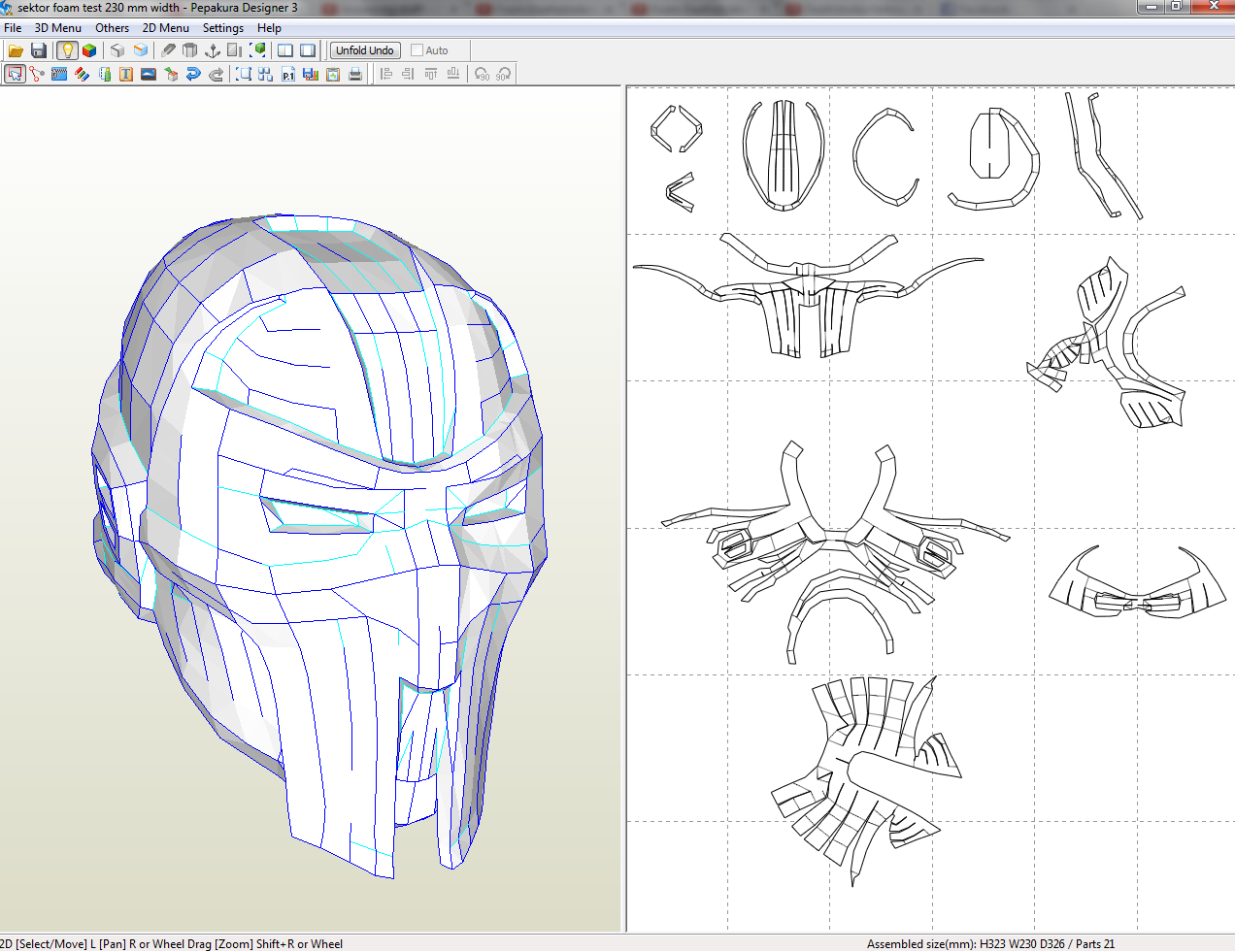

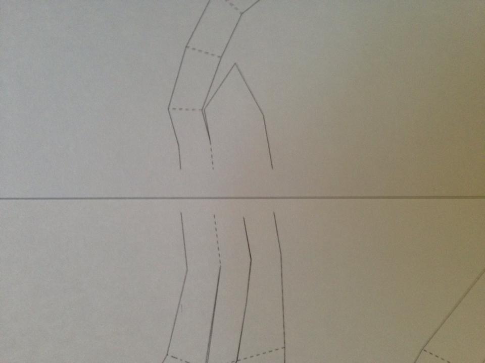

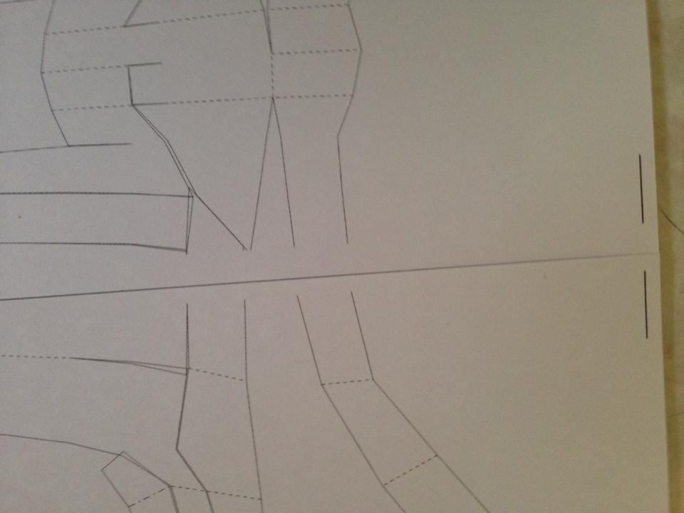

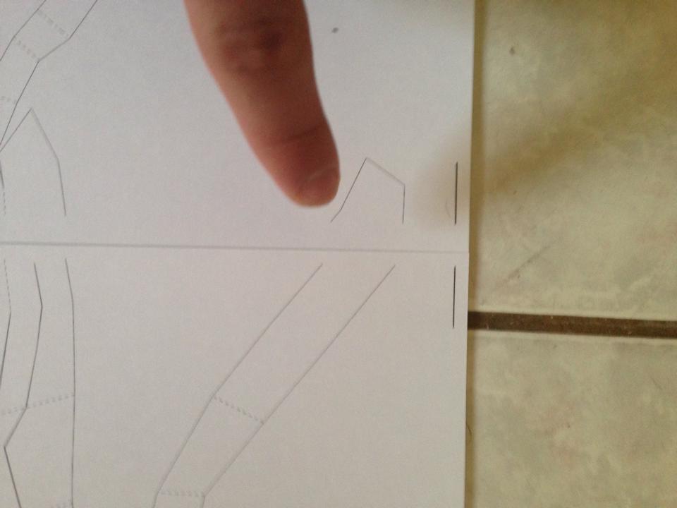

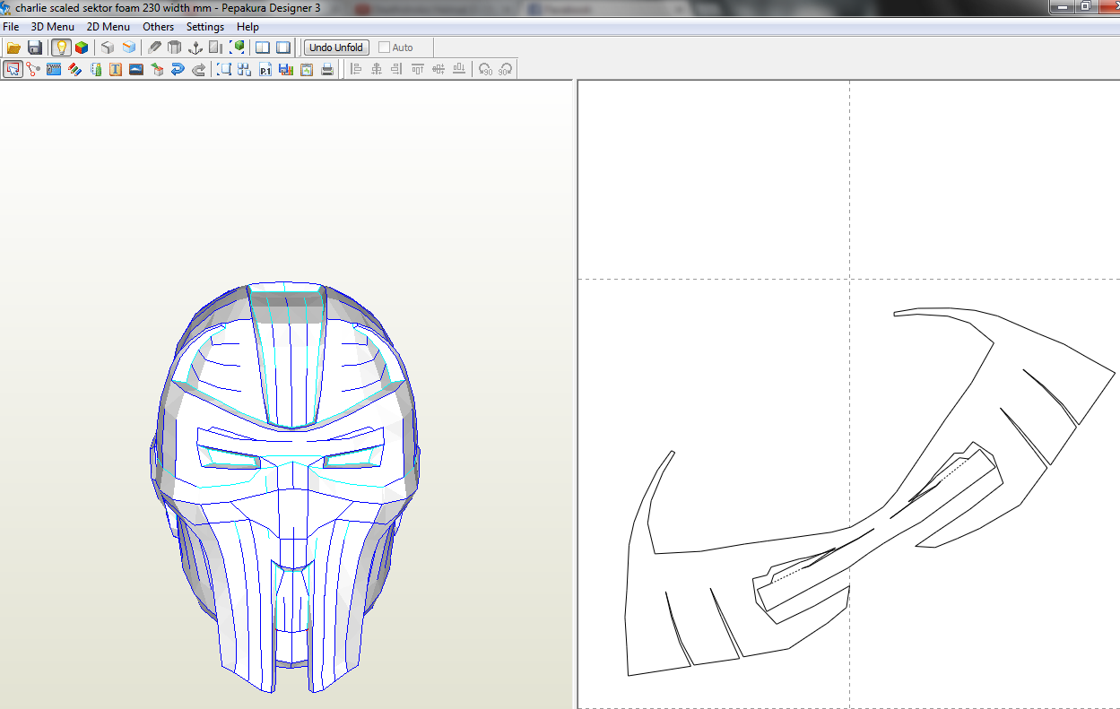

Hey guys , am having toruble here so i hope someone can help. The Ts are not appearing on the paper , just lines and the templates are not connecting properly even if i cut the left border of the lines and theres a gap between spaces too so if try to put them close so they can look like the model on pepakura, the hole template looks weird and interlapses with other pieces. It just doesnt look right, what am i doing wrong??? Also this is not one of Jfs files , its a Mortal Kombat Sektor helmet i found on Tamasoft and since its a simple pep well i decided to mod it like jf does.

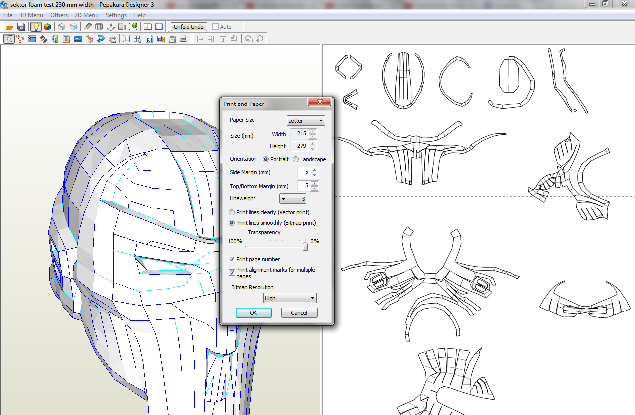

@charlie88 - it looks like you have the wrong type of paper chosen. If you're using JF's files, they default to "A4", which is the European standard for paper and doesn't match the "Letter" that the USA uses (assuming you're here in the USA). You'll need to change that under File - Print and Paper Settings - Paper Size ​to Letter.
They are in letter since i know hes from outside the us and i live in the us still even in letter or a4 since i tried it know the ts are not appearing either.

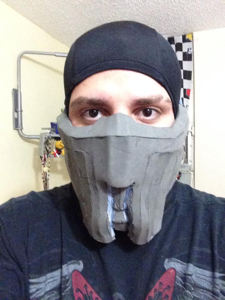

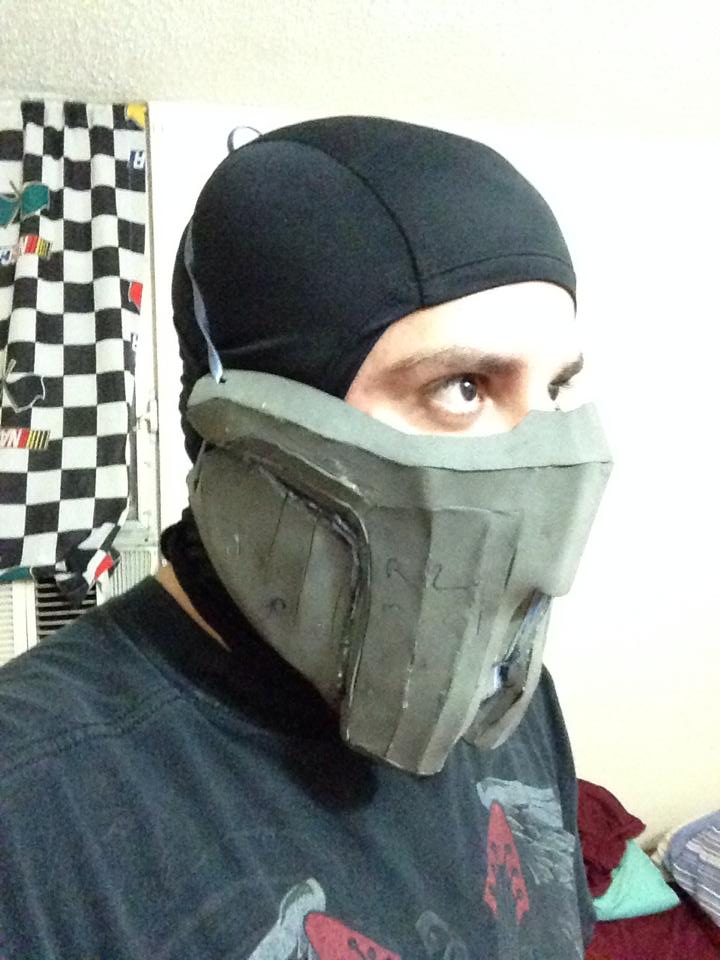

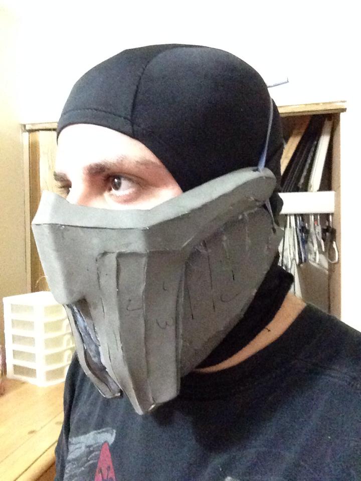

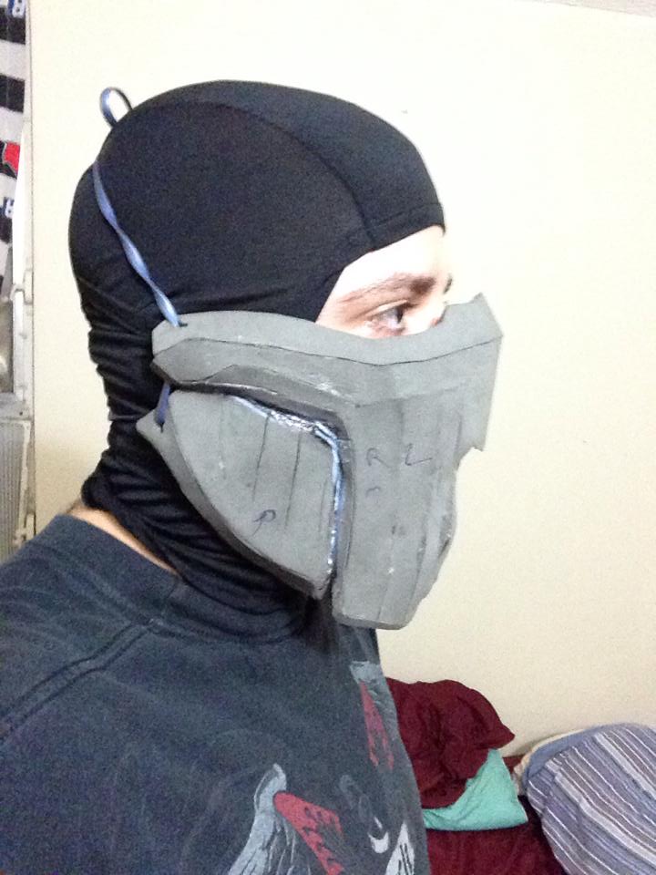

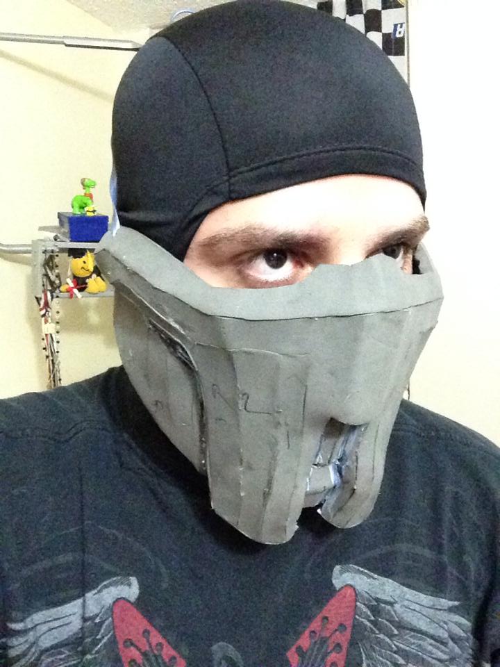

Thats how bad it looks , building it with individual pieces. Thats why i want to make it again as big pieces so it can look right and doesnt have a bazillion seams.

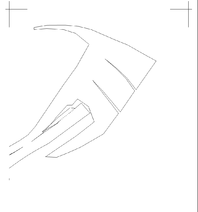

alright now we are getting somewhere. like this?
s3.png[
noq about that gap problem since they are not connecting even if i cut the corners. how do you fix that?QUOTE=Dracosfire83;3284538]Looks like your top and side margins are set at 5. You should try it with them set at 10 or 15.[/QUOTE]
