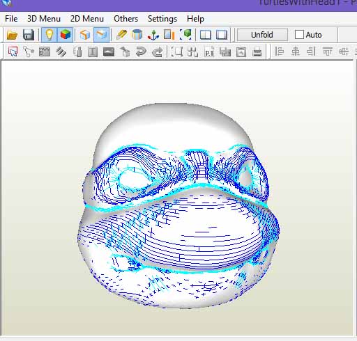

Is there a tutorial on.converting files to foam? I got some models I'm working on but I would like to make a pep.in.foam only. I don't want anyone to do them for me, I want to learn how to pep.then.for foam..hope someone can help. i know this is a bit rough but i wanted to unfold this for foam but its not working for me tmnthead.jpg

Is there a tutorial on.converting files to foam? I got some models I'm working on but I would like to make a pep.in.foam only. I don't want anyone to do them for me, I want to learn how to pep.then.for foam..hope someone can help. i know this is a bit rough but i wanted to unfold this for foam but its not working for meView attachment 312944

Looks just a little high poly there tbh. Um what program did you use to make that model or did you find it?
Sent from my SGH-T999L using Tapatalk
I.found the model on a free site I have the makers information. I have a few models I have made myself but wanted to start with this one to learn how to convert in foam.
Sent from my SPH-L710 using Tapatalk HD
Well I was wondering because if you made that model, they made the resolution a little high that looks like cg level of detail. And unfolding that (what I think you mean by converting) for foam is possible but, making it would be almost impossible because at that resolution every little piece would be like a mm wide o_O you know what I mean? :)
Well I was wondering because if you made that model, they made the resolution a little high that looks like cg level of detail. And unfolding that (what I think you mean by converting) for foam is possible making it would be almost impossible because at that resolution every little piece would be like a mm wide o_O you know what I mean? :)
Yeah I do. Darn it was hoping it would be able to convert it. I may have to model it myself then
Umm maybe if you threw it into a modeling program You could manually delete some of the edge loops (like say three lines for every one) you could make it low poly enough to make it work :)
It can be used for a foam unfold at that level of definition, if the parameters in Pepakura are set properly. If you post the .obj or .pdo somewhere, I'll take a look at it this afternoon.

Is it possible to unfold a model which has a high polygon count? I have looked at some of the files in the first post and panel that are curved are often made from one or few pieces. When I try to unfold mine, I get thousands of minuscules pieces even when some large surfaces are barely curved at all.

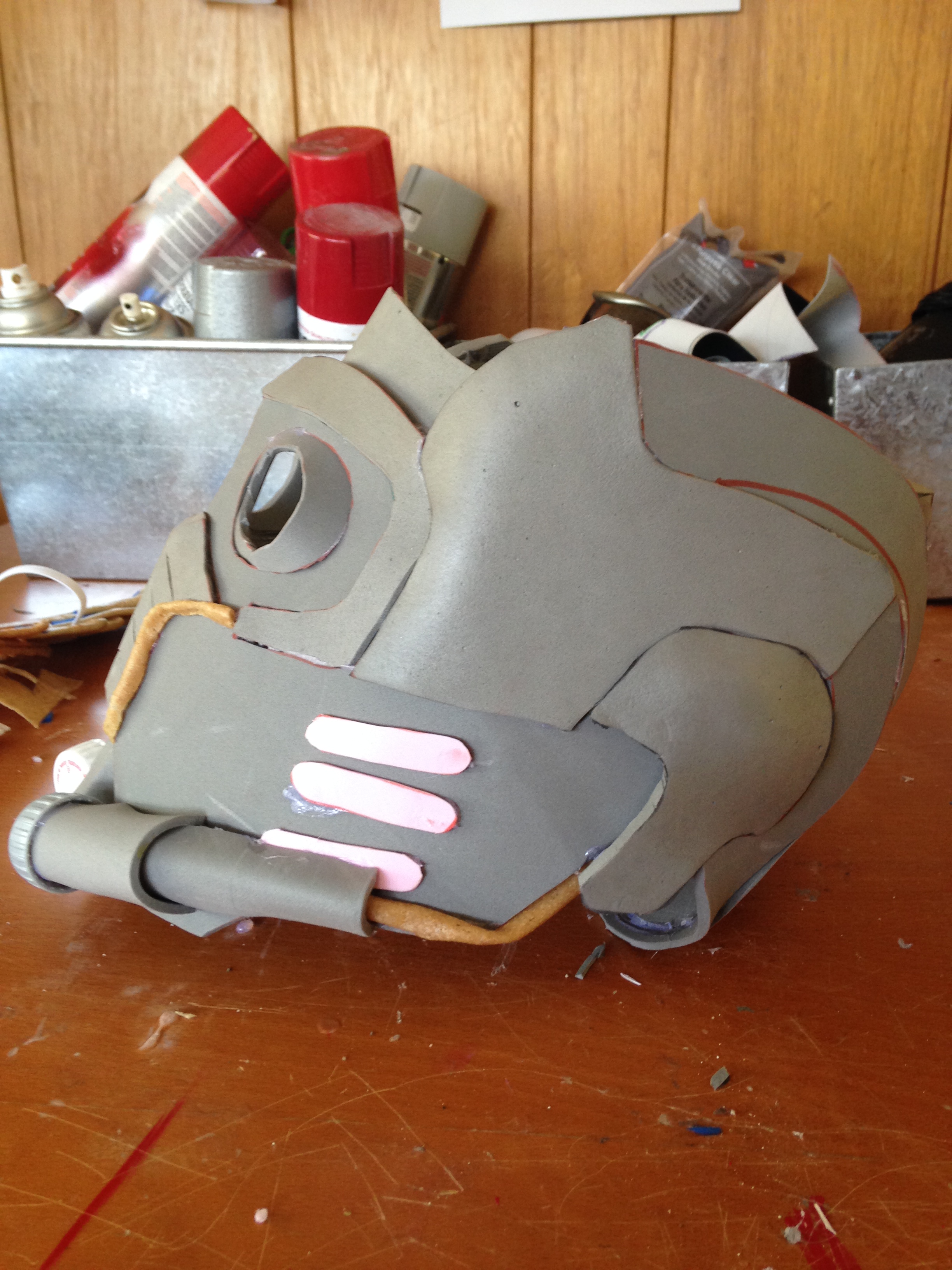

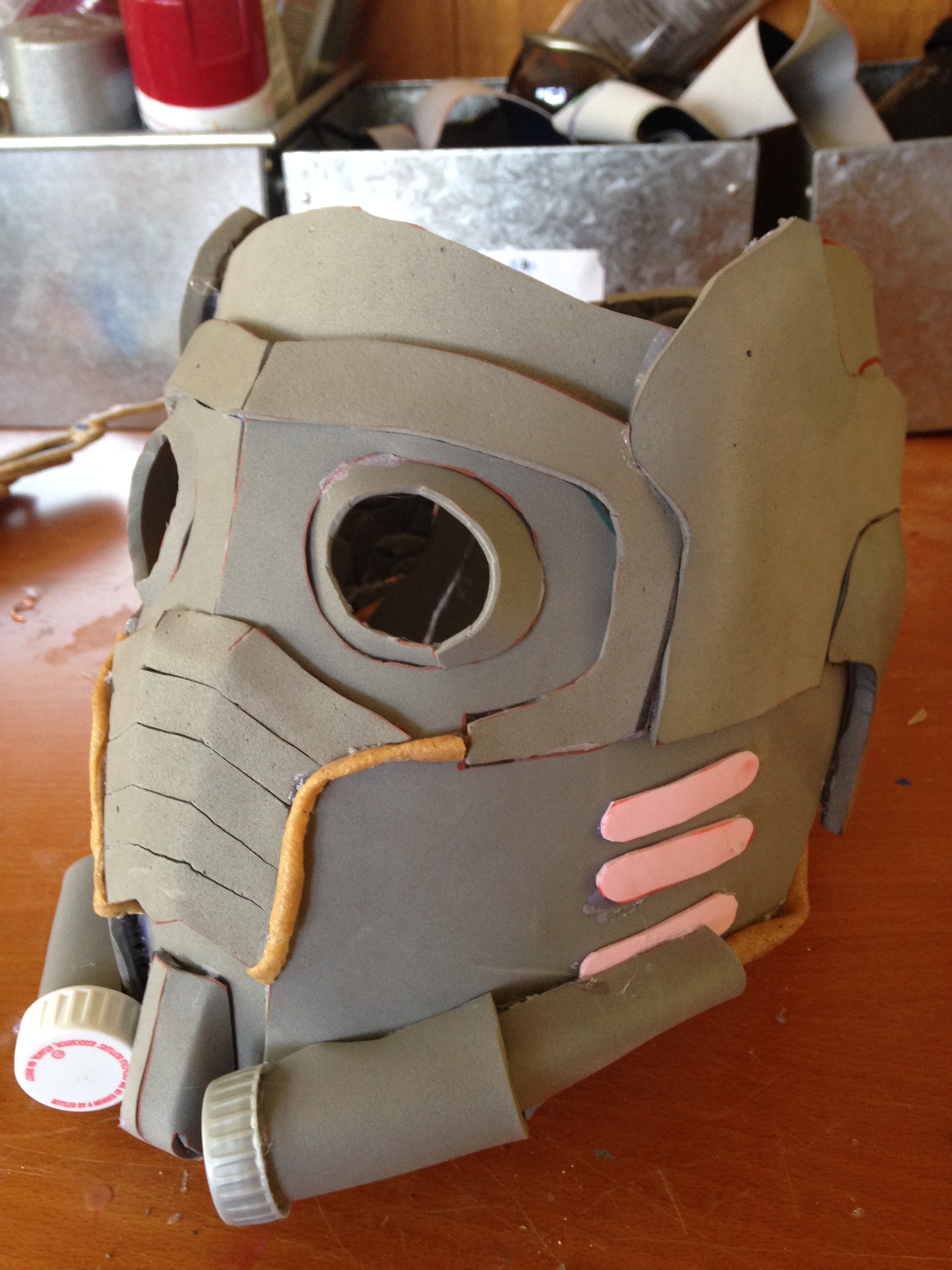

Hey JF I just have to say you're truly a god among men! Just wanted to show you what your files helped me accomplish. :p
This was from halloween this past year:
Re: Speed-building files'n'tricks : FOAM Iron Man MkVII within 4 days.

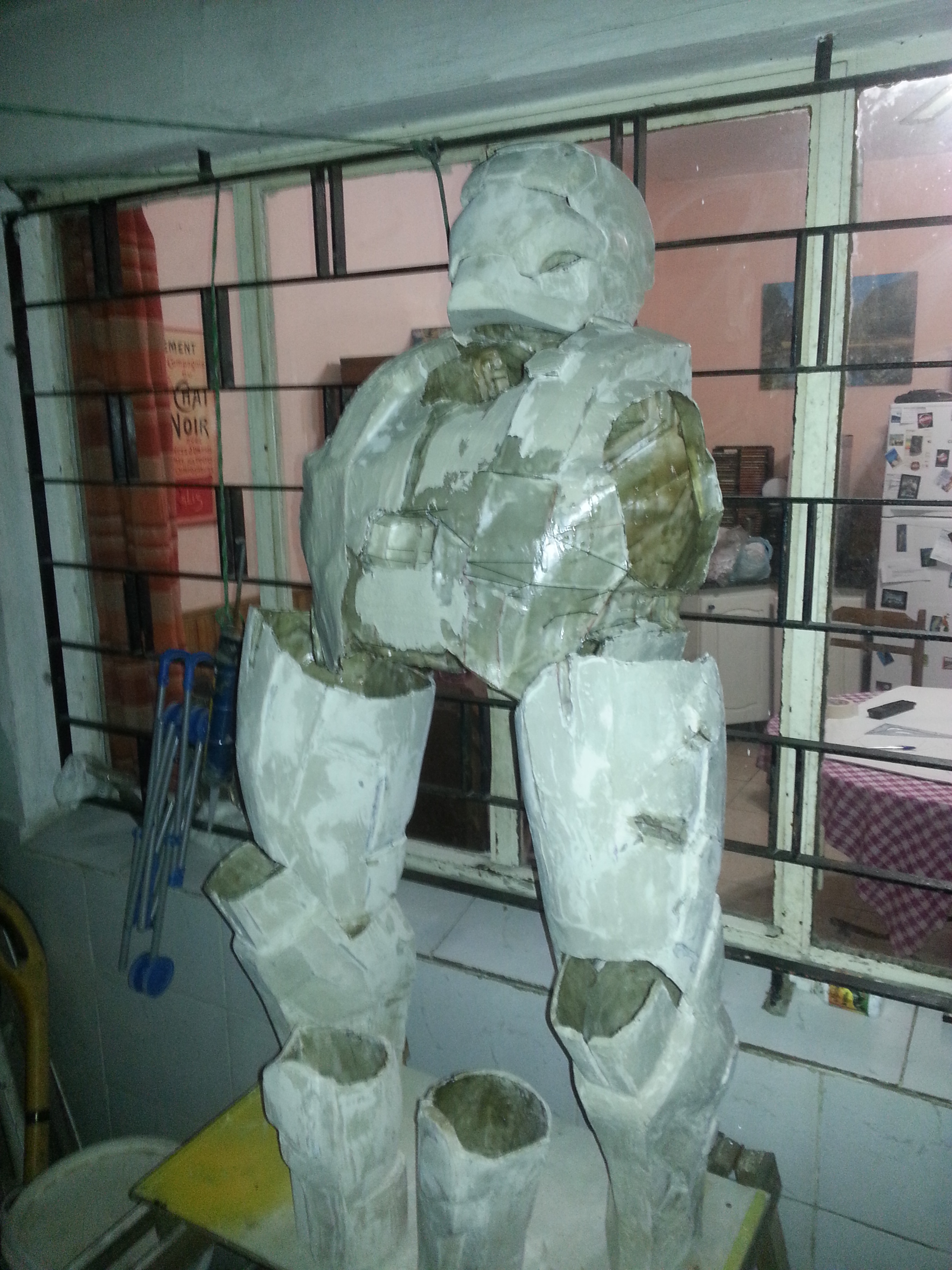

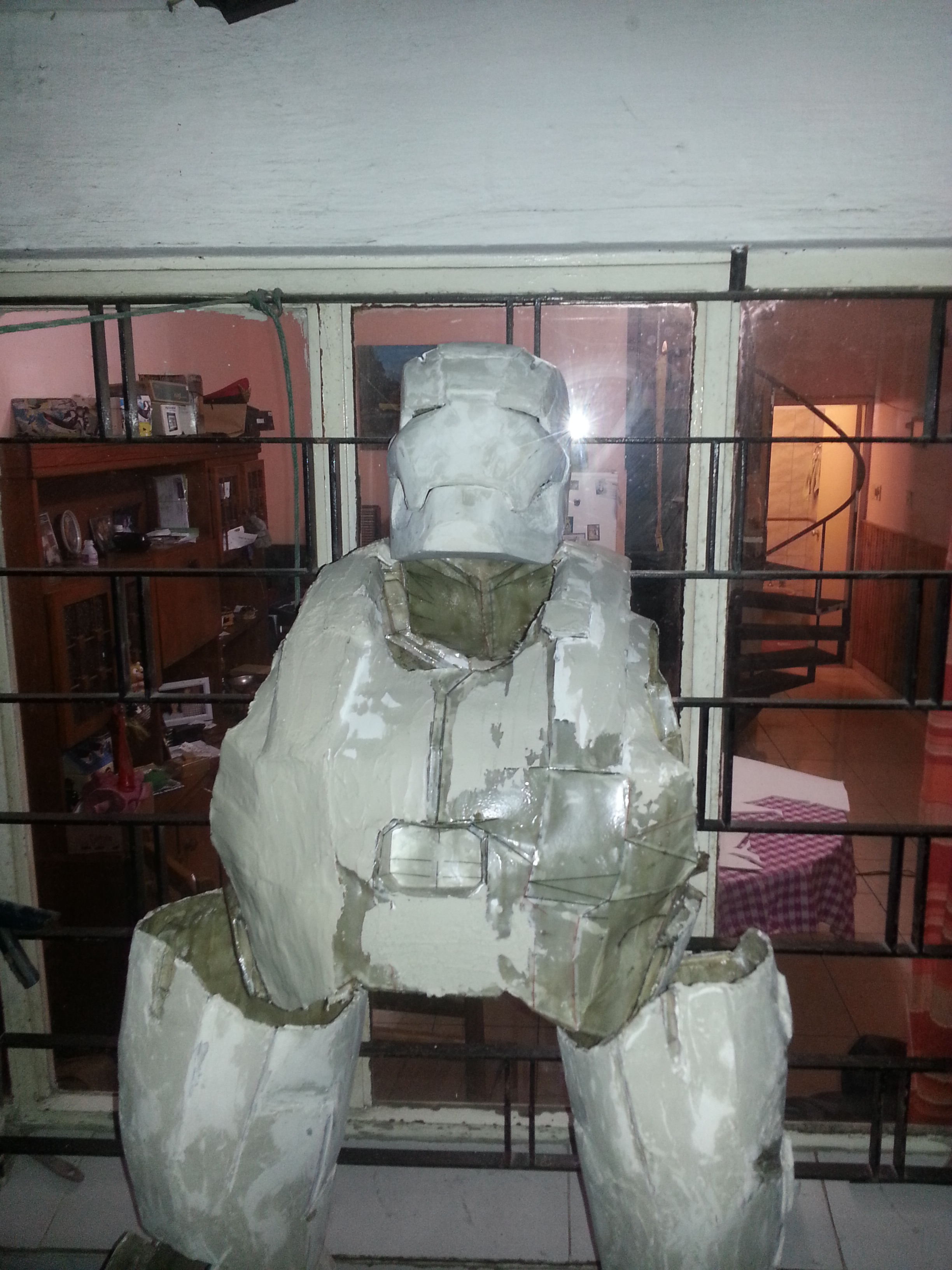

hello ... thanks for the pdo that pusistes, I have a lot of material to work on costumes, now I have my ironpatriot stopped by a theme of time, I did fiber recina glass and plastic putty (the workshop car) I am now DARKSEIDs doing with all of you put pdo since I did not find as making one ..... pictures attached, I apologize if that bothers alla uploaded photos
