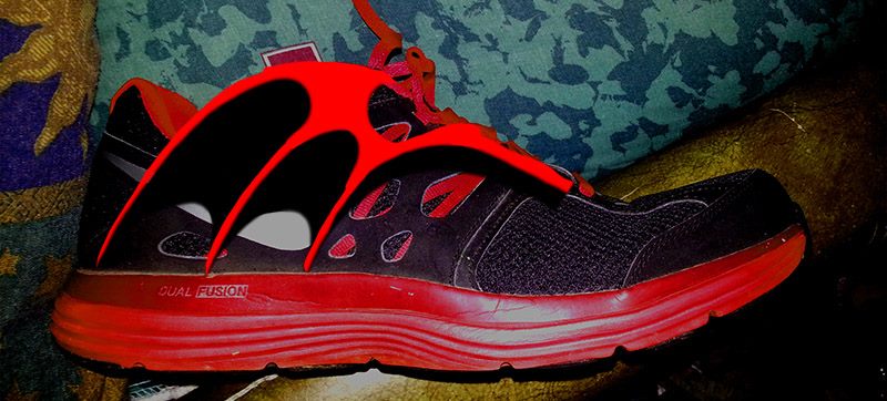

I've got spray tool dip, but think I'll end up using the pva glue and then painting as a sealant. These are add ons for my running shoes. (They make something called Shwings, which are cool, but they don't have a dragon wing/batwing option, so I'm making my own versions from 1/8" foam with a thinner foamie deco add on.
Here's my initial concept:

Just my experience, but I would really really recommend using your spray dip on the shoes instead of (or even after) PVA sealing. I've had PVA sealers on shoes craze and crack out all over because of all the flexibility, so now I just spray dip several layers and skip the PVA all together.
I'm not actually painting the shoes.. the shoes are already black and neon red. The wings are the addition, and have eyelet holes, and are attached by the laces. Apparent;y its a new fad fashion craze. I saw some during my daily jog, and they looked killer, but they didn;t have a style I was hoping for. I'l probably replicate their flame style in dayglo orange and red as an alternate look for my shoes as well.
