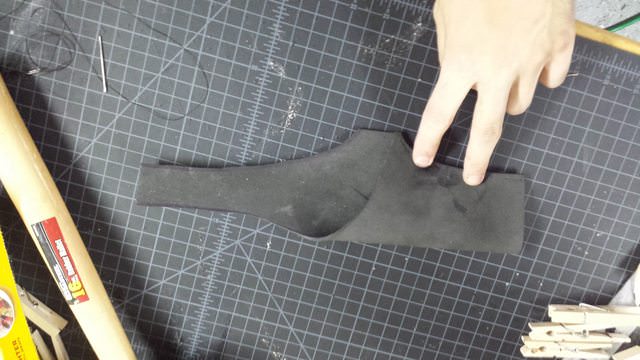

While I give that time to sit in the back of my brain, I decided to get the shin pads made up:
Cut a bunch of basic shapes, glued it together, then stitched it all to give it a bit more structure. 1" roller buckles were added onto each strap. Not the straightest lines, but nobody's going to be looking that closely, right? ... right?

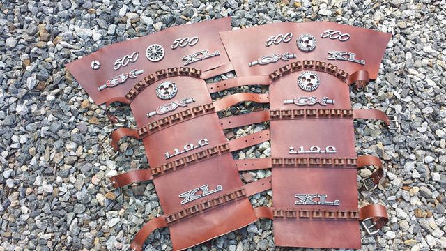

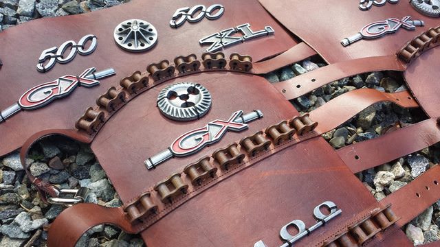

Most of today was spent getting some of the details on my shin pads done, since I like jumping around between parts of this project like crazy.
The links were primed with a rust-colored primer and then sprayed to death with a bunch of various metallic paints that I have in my workshop. I think I used a hammered copper one, and a stainless steel one primarily. I also brushed-on some iron filings in an acrylic medium so I could rust the links a bit more authentically. I have a 'rusting solution' that is basically hydrogen peroxide, vinegar, salt, and a tiny bit of degreaser in a spray bottle that I hit the links with, and they were given a good portion of the day out in the sun to rust before I matte sealed them.
These links were then glued to the front of the shinpads with E6000 glue, and then I set to the laborious and annoying job of sewing them onto the pad by punching holes and sewing with an awl. The loops were each threaded verticaly through the holes in the links and then through the pad, twice per link. After like 4 hours of sewing, I have very firmly secured the links to the pads, which is good, as I didn't trust the glue not to flex and eventually start dropping chain links off the pad.
I'll be applying a bit more weathering to both the pad and the links once tomorrow rolls around. In the mean time, I have a good-sized pile of aluminum cold cast emblems for the front of the shins.
Pardon the mess. :D These will all be polished up and painted, and since they're cold cast I'm hoping they'll look properly metallic when I'm done. They've also been shaped onto a curve with a heat gun to make sure they hold the general form of the shin pad once it's on. I'll be gluing and sewing these on tomorrow.

On a bunch of the medals, and the place where the chains are cinched onto the armor at the top, I used some heavy duty paper fasteners like what you might see here.
Mostly done with one of the shin pads, just playing around with things a bit. I weathered the emblems with some black oil paint diluted in mineral spirits, which took a while to dry but left a nice finish once I rubbed them back shiny with the steel wool.
I may have overdone it with the amount of sewing I did to hold the emblems on, but truthfully the glues I was using were not holding the emblems to the pad all that well, so I figured it'd be better to overdo the cording and not have one of these things fall off at a con.

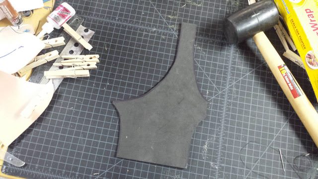

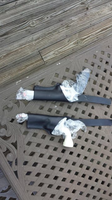

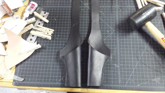

Since Joe's holsters looked like smooth leather on both the inside and outside of the holster, I took some thin leather and glued it back-to-back with the smooth sides facing out. After I let that dry for a bit, I used my foam piece as a template to cut the leather, and dyed the resulting piece black. Once the dye set, I used a bit of water to get the leather pliable again and folded it over, then glued it shut along the outside edge with more barge cement and the help of about 10 clothespins on each holster holding the edges together. Finally, the piece got punched with an awl and hand-sewn along the edges to get something secure and durable.
The guns fit pretty comfortably in the holsters, though when you have them side-by-side closely the difference in size between the guns becomes really apparent. I'm hoping having a codpiece spacing them out will reduce some of that effect. For now, though, I have wrapped each gun up in cling wrap and given each holster a last loose wet-forming to make them take the shape of the guns a bit better, so that they'll sit snugly in their holsters.
The trailing ends on the holsters are basically just going to be looped over the belt, brought back around, and hopefully riveted to the back of the holster piece once I have a chance to make the front belt. That'll probably be the next thing I do - that, or the codpiece.
