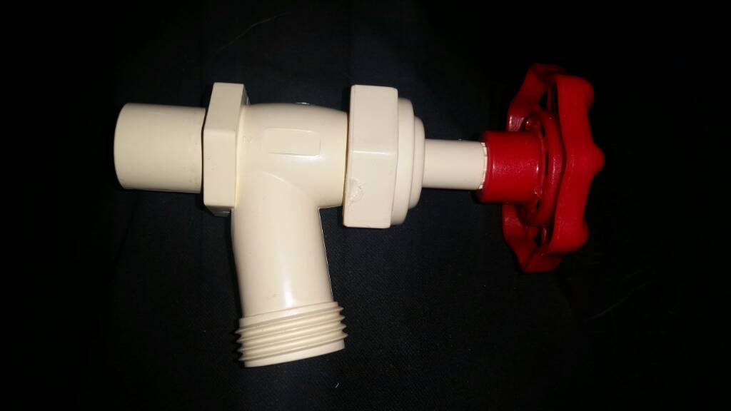

TrapperBlu I've seen those fixtures, but the thing about what I'm doing here is I'm trying to keep a clear and unimpeded path for air to flow in through the intake filters, through the hoses, and into the mask. That first picture you posted has a valve screw on it (the knob) and even if I remove that, it's going to unnecessarily choke the airflow down a really significant amount. That said, your armor looks great, and if I'm being honest, I have absolutely no idea how I'm going to tackle the matter of trying to make the airbag itself yet.

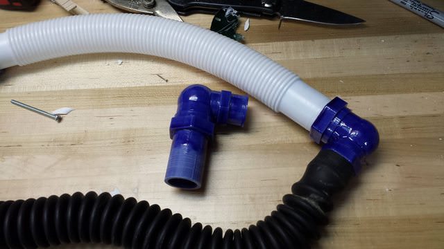

The printed right-angle pipe fitting seems to have worked out pretty well, all things considered!
I need to sand it a bit, glue the parts together, then XTC-3D the whole thing to give it a better finish, make it a little stronger, and maybe make sure it's properly airtight... but I'm quite happy with how this turned out. The flared end is just right for me to stretch the black rubber gas mask hose over, and air flows cleanly through the curve.

I got them glued together and XTC-3D'ed them and they fit quite comfortably on the piping I have:

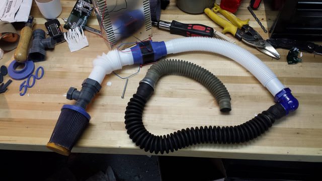

Annnnddd... here's a test rig of the entire closed system:
Not much to look at, so let me put my money where my mouth is and demonstrate that this thing is actually, somehow, working!
This is exciting - it's actually doing the job! It'll only get better once everything is properly fitted, but I really need the airbag itself done before I can cut everything down properly to stuff it in. A lot of the system as pictured has extra tubing (such as right after the line in the fan) so that I can maneuver the flow around in whichever direction will ultimately prove necessary. Quite thrilled with it, and since this is a big hurdle that's now solved, I can prioritize finishing the rest of the visual parts of the costume.
