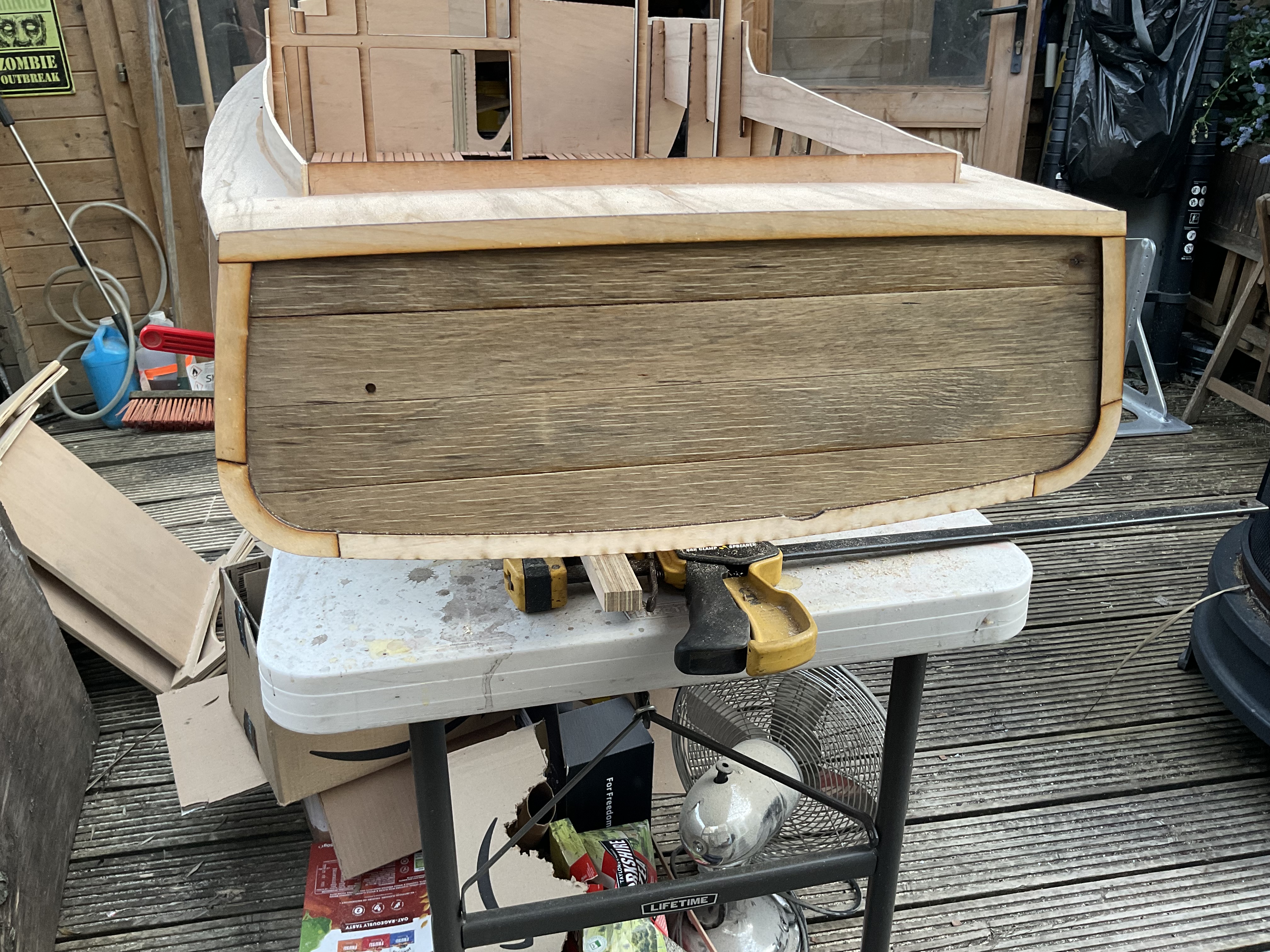

Another boat building construction technique I noticed. You extend some of your principle hull formers past the height of the deck to include the frame of the main and front cabin. This perfectly defines the location of top works. Keeps them aligned and true. Excellent approach for cabin cruisers and the fishing boats. Instantly shows the volume of the project skeleton at a very early stage. Nice.
Spoken like a true boat builder SeaRun! Like you I am riveted to the technique Flimzy is applying at this scale. Some people might look at the framework now and say huh? But, you have to have built the orca to understand her. I've seen so many areas of this build already and said, what a piece of artwork. some examples are where the front windows will mount, The back cabin wall thickness, you can see how it will be built up. The keel itself, with the layers of wood to keep it straight and true, and keep the prop shaft straight. Flimzy, That rabbit hole just keeps getting deeper lol. Loving this!
I’ve just made I time lapse of laying the decking but I’m too tired to put it in the computer, so here’s to result.
I like the look I’m getting from the aged ply wood on the transom.
One of the guys at work said he like the way my laziness mades me think out of the box, It helps to know this models sole purpose is to go in front of a camera and not sit in a museum, it lets you be a bit slap dash. And the secret to movie models is to be a bit slap dash. Perfection stands out as fake. George Miller said “ use your optic nerves ,if it looks good it is good”. I live by that.
