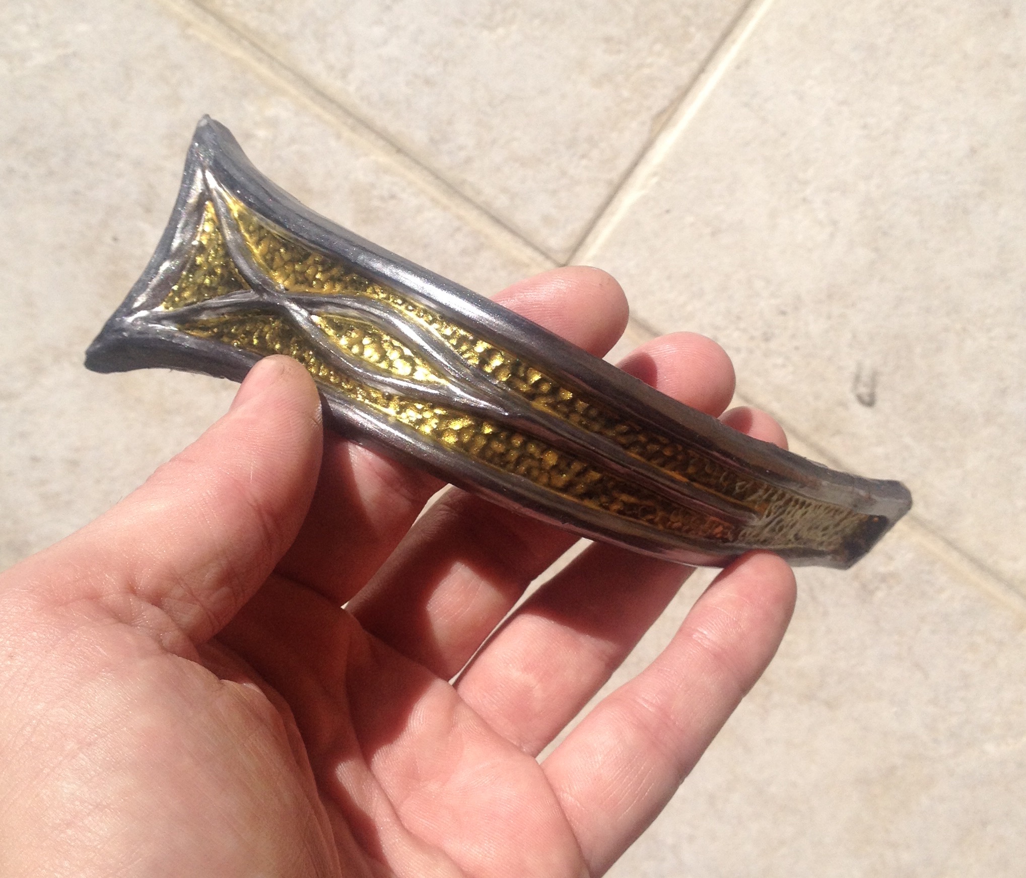

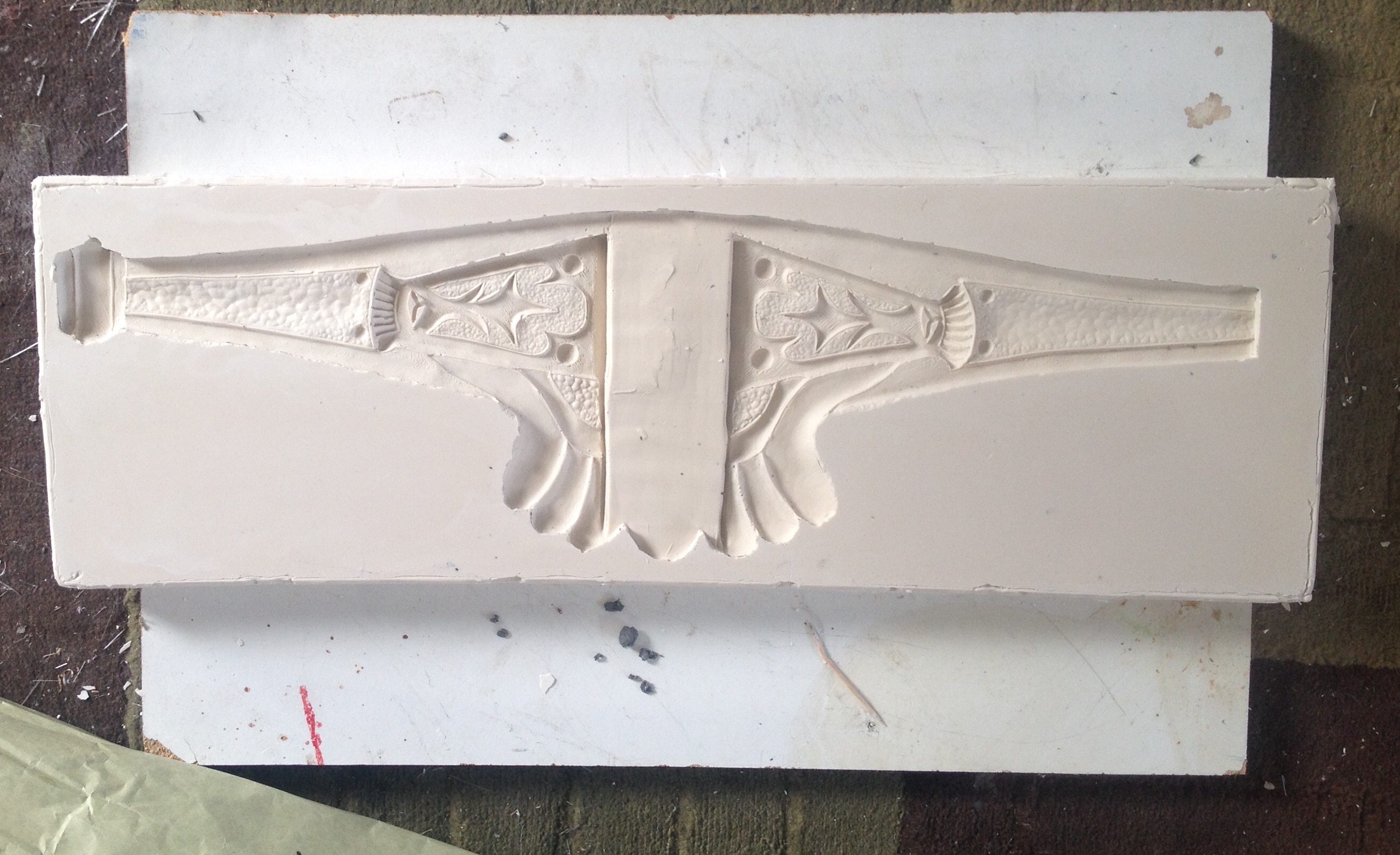

I have been thinking of a way to work up the straps for the dagger and thigh armor. I've been trying to figure out a way to hide the strap and buckle. I was playing around with making a latex cover for the strap and buckle. I cast up a sample and painted it. I was surprised the I could cast it flat and it would not wrinkle or buckle when flexed around a curve. Here is the test piece.

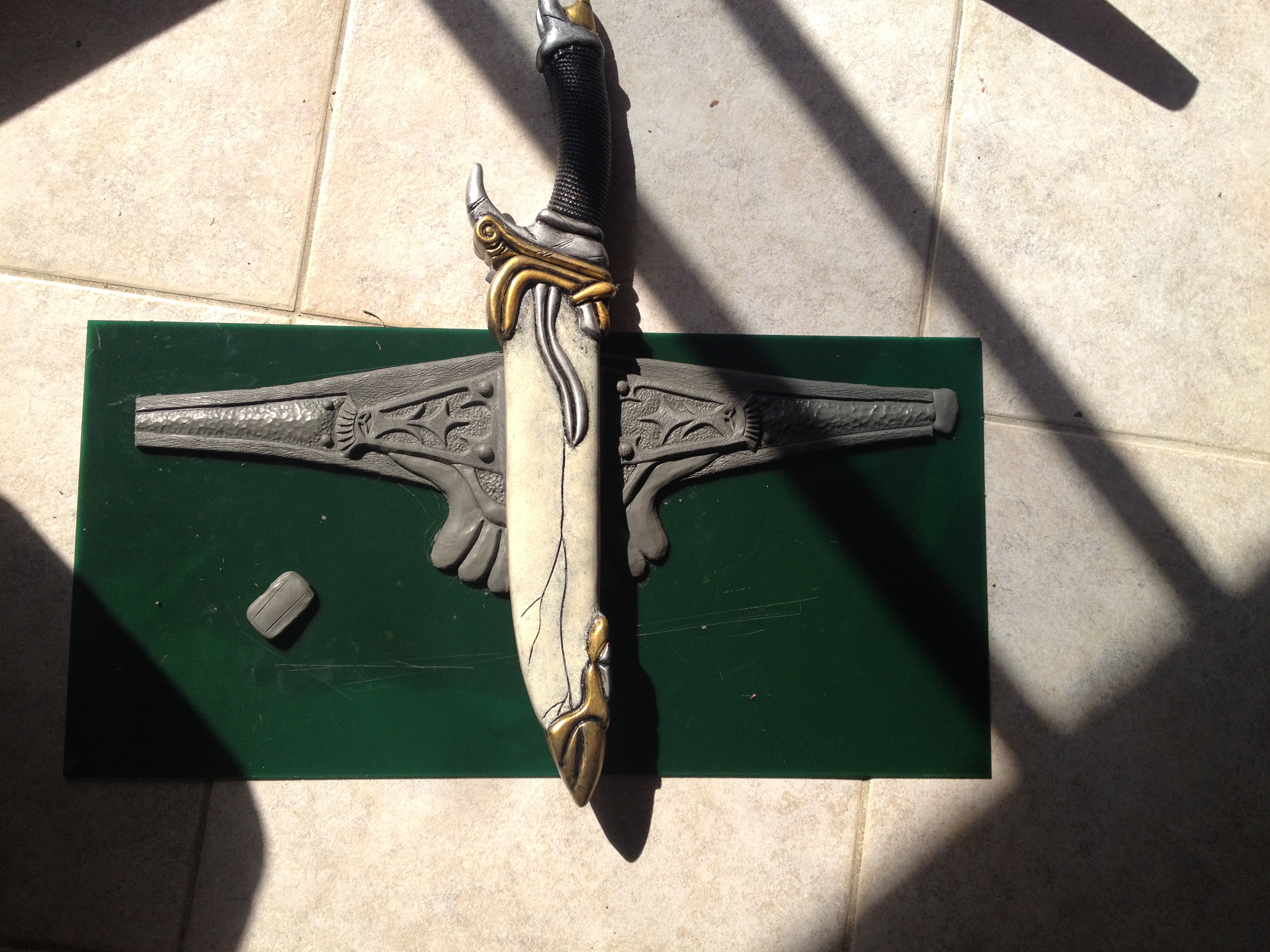

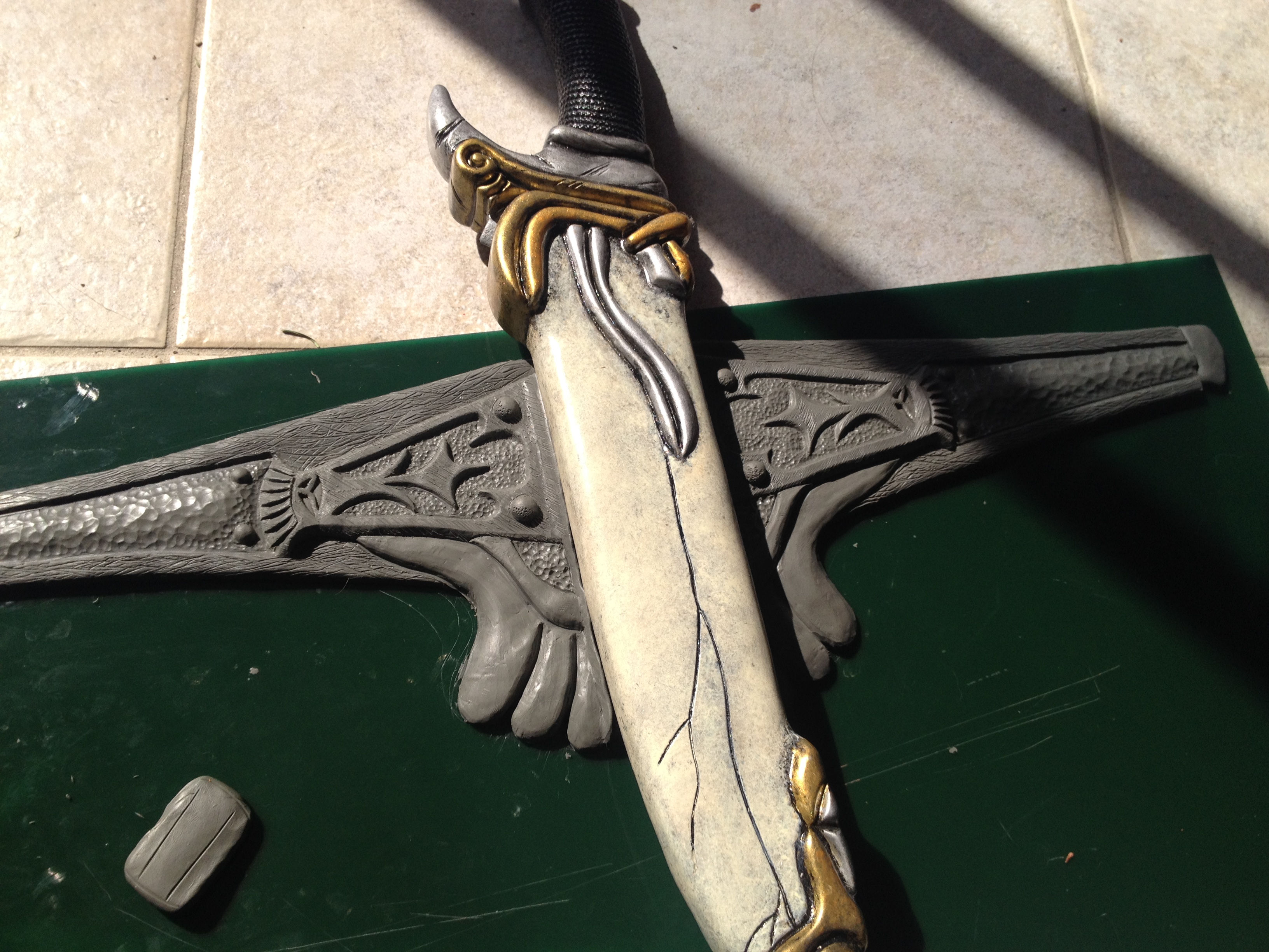

From here I had decided to cast up a complete strap for the dagger.

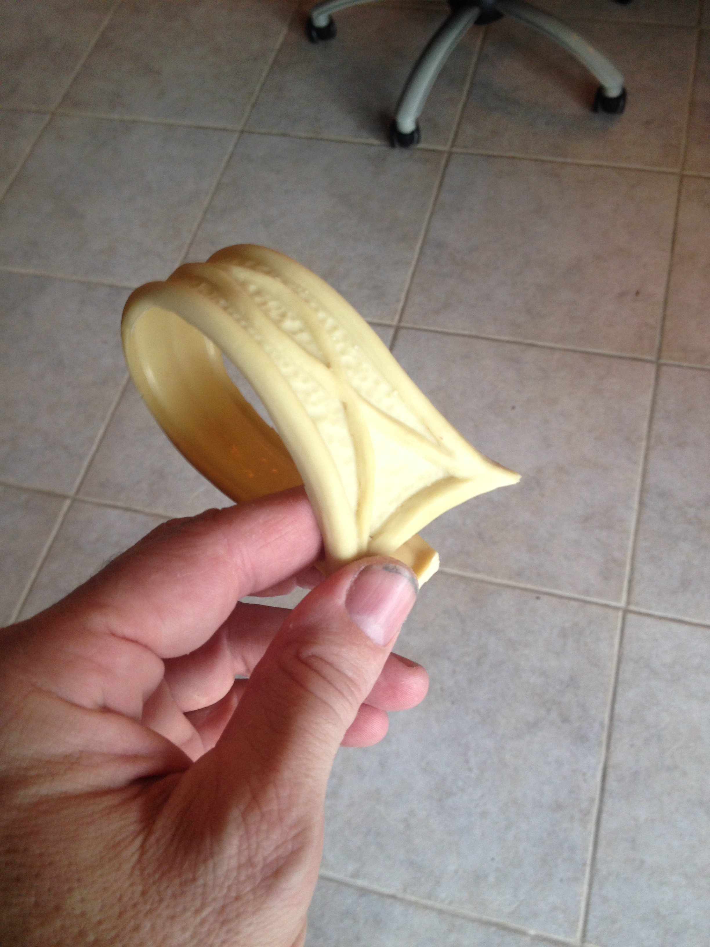

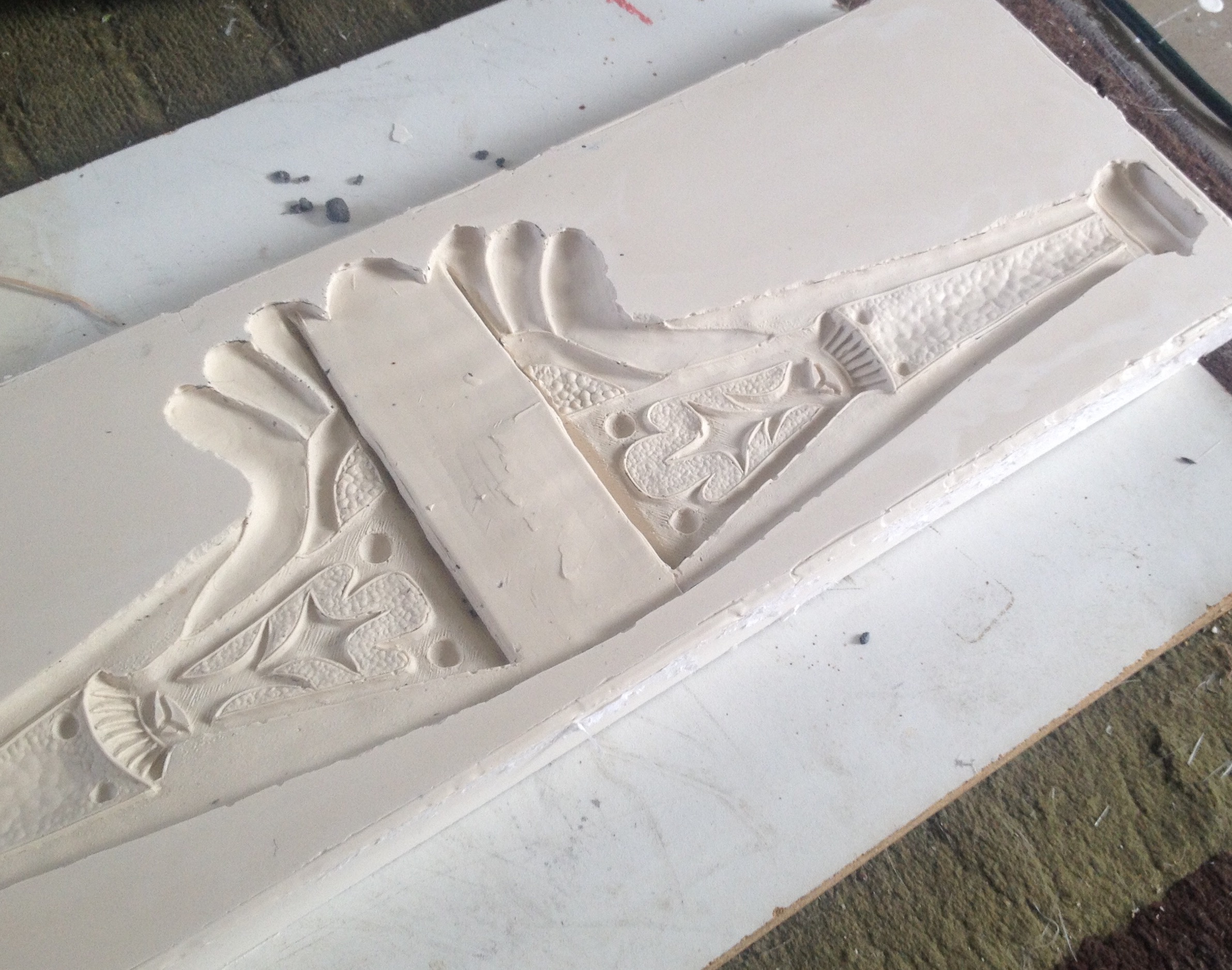

And here is the plaster mold.

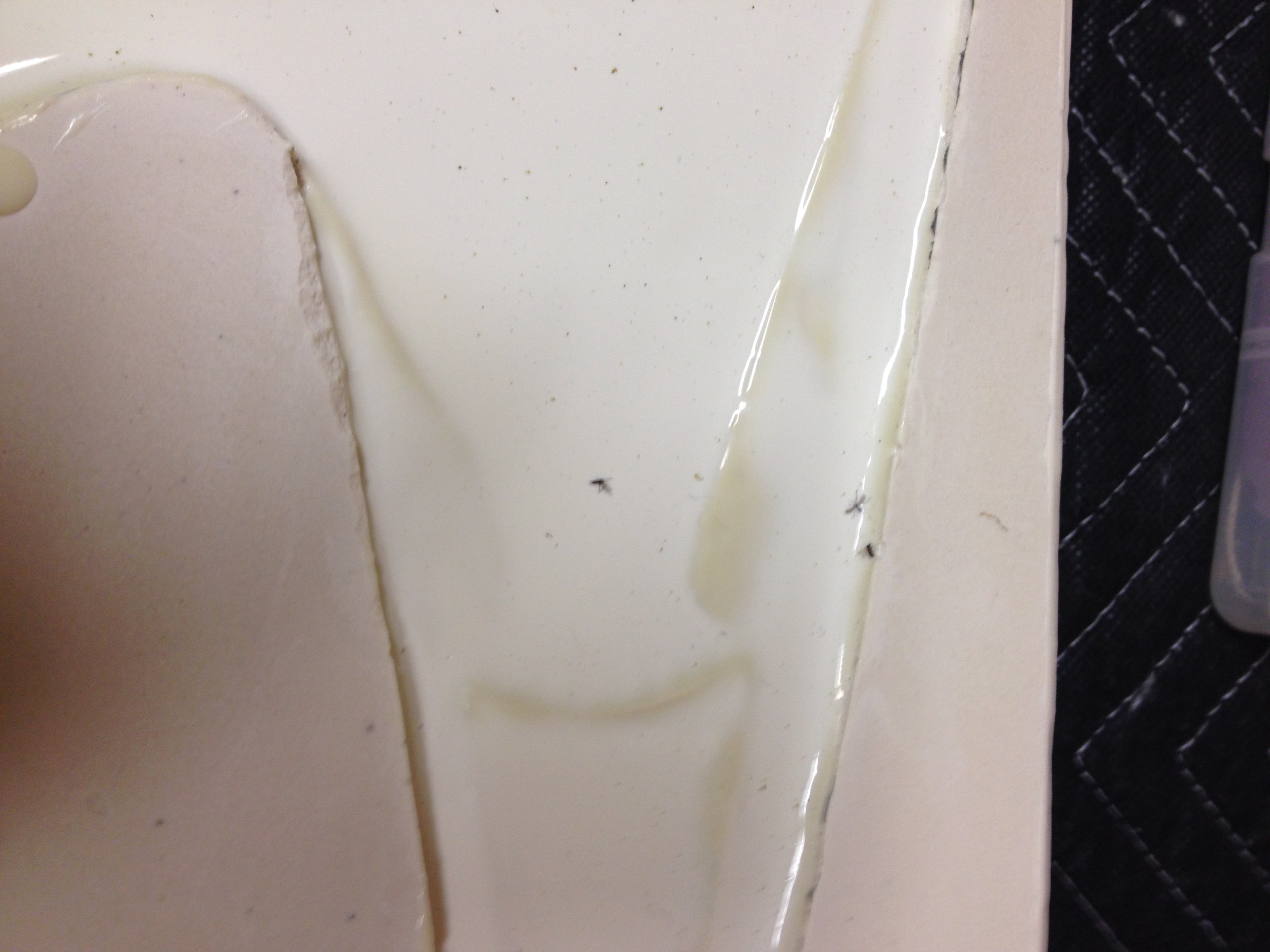

Ok here is a WHAT NOT TO DO !
DO NOT USE A FAN TO DRY YOUR LATEX WITH OUT CLEANING IT !
I had a great idea. I'll bring over my other shop fan from the floor near my desk. This will double the air flow and dry my latex faster. I DID NOT CLEAN IT and when I put it down it blew all the DEAD BUGS that were stuck to the fan into my latex. Luckily this is the 3rd coat and the back side. I just will not tell my daughter that she is wearing dead bugs.

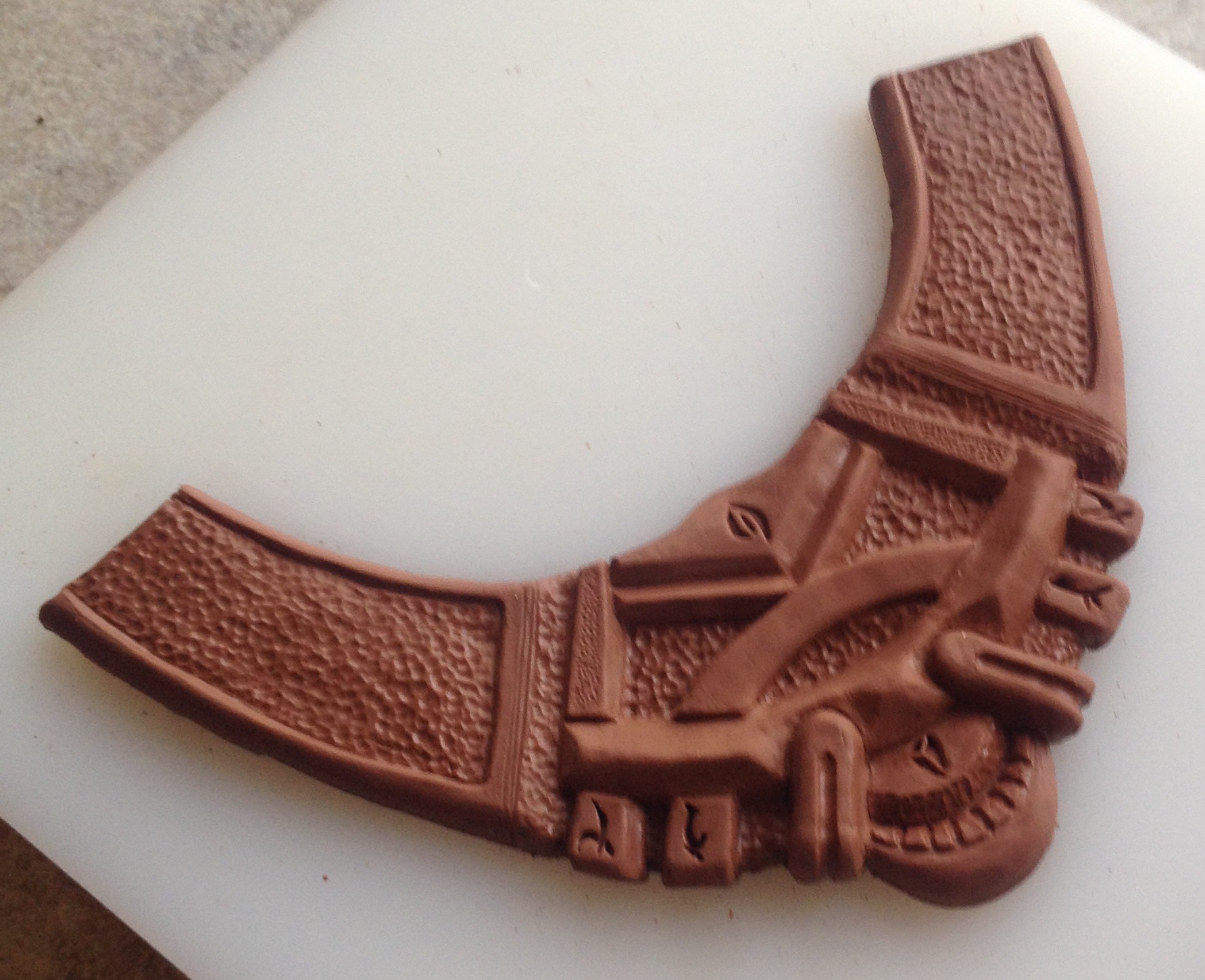

Here are the steps for the front neck armor (necklace)

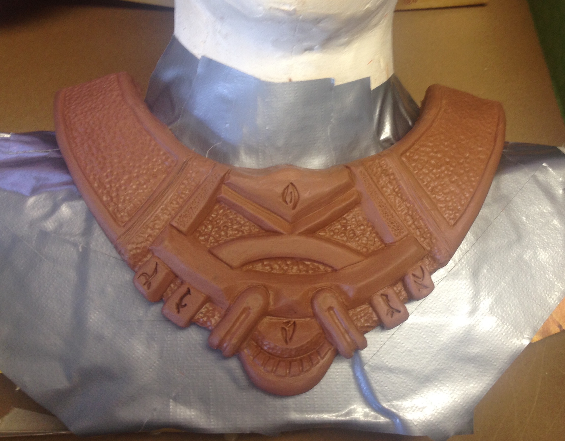

Final sculpt flat
Sculpt formed and set for mold

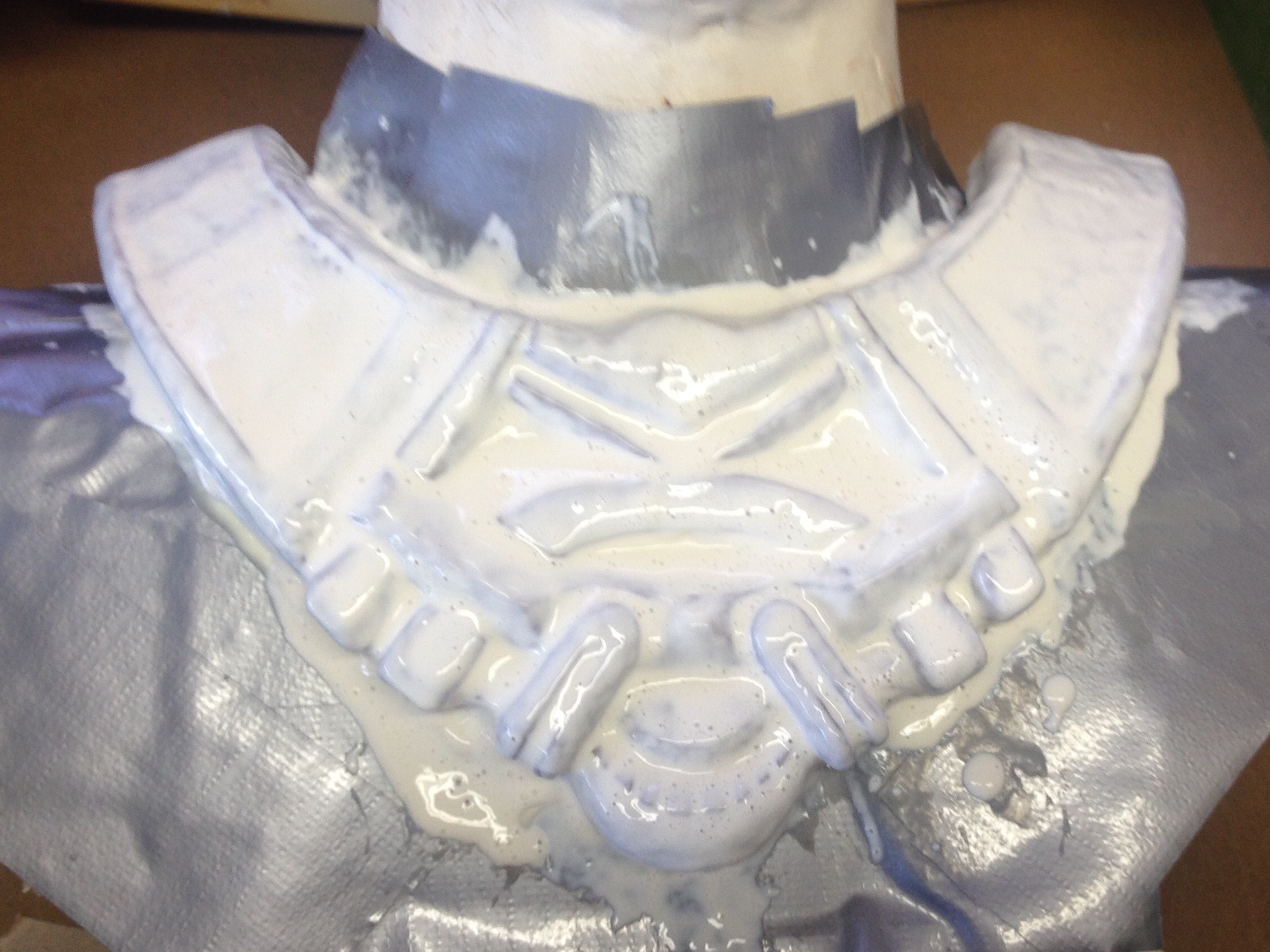

1st beauty coat of latex

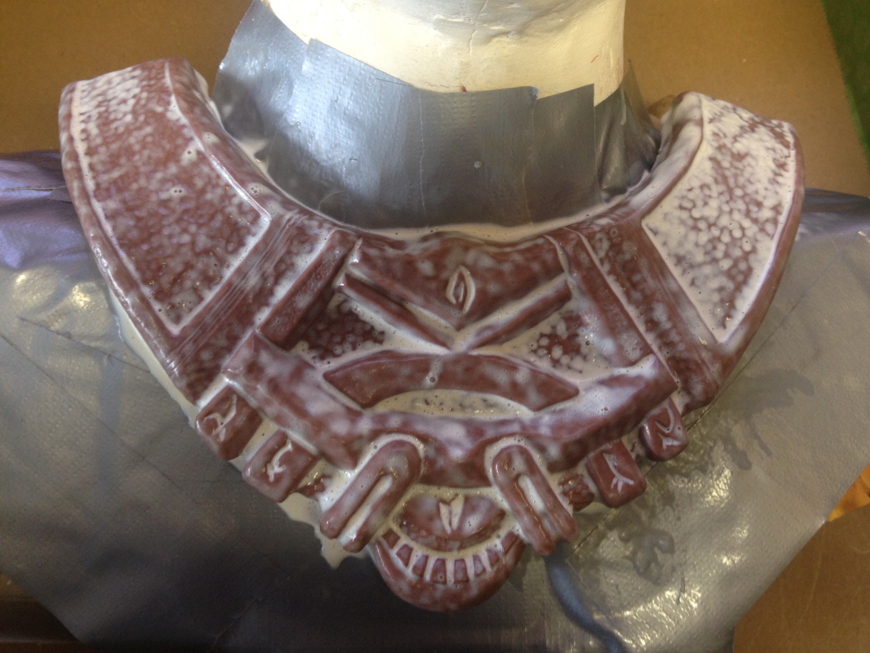

4 coats of latex. Ready for shell mold

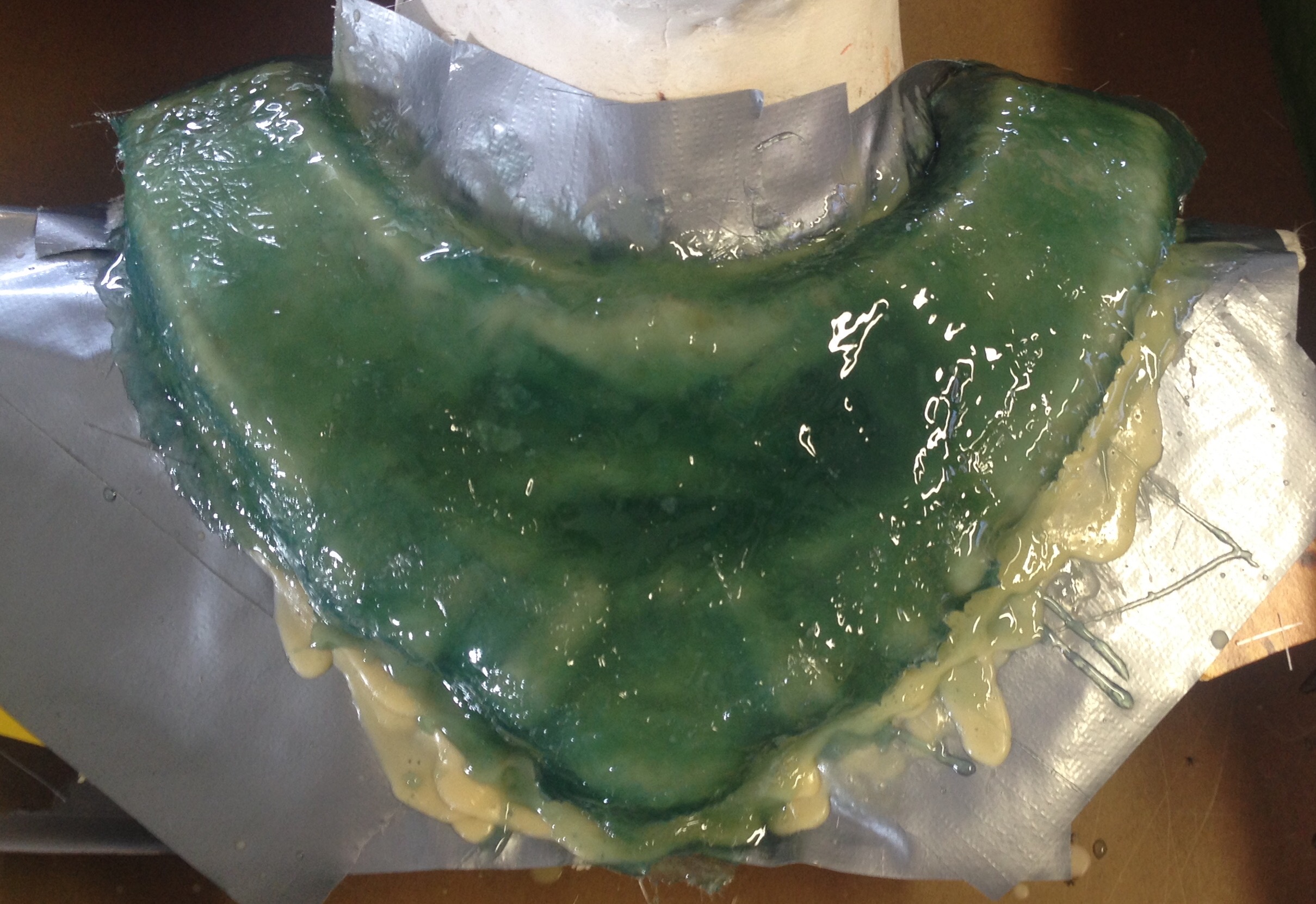

Fiberglass shell mold

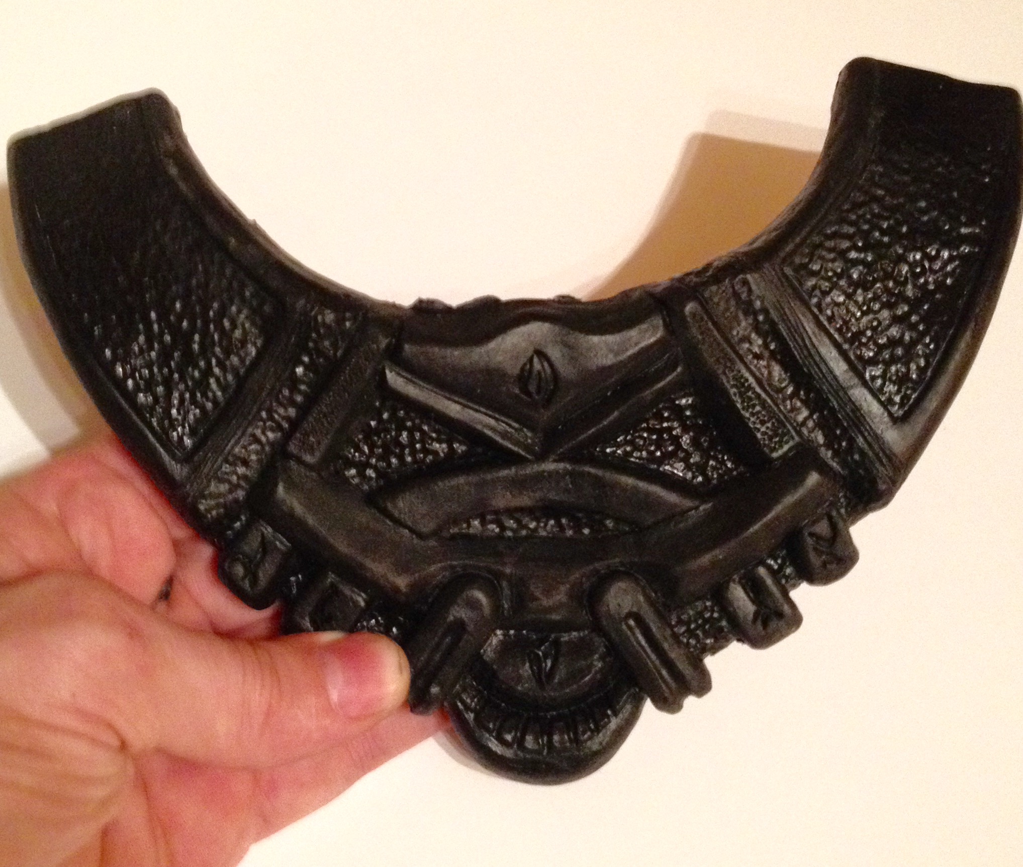

Completed final cast piece.

I'm using latex for the straps only. I will post my thoughts on the dagger strap once it's all molded up and I try it out. I still need to figure out a way to fasten the ends.

As far as latex armor. I'm working on cleaning up the dagger strap made from latex and it's not easy. I spent quite some time to make the mold as perfect as I could so I would not have to do much to the strap but it still needs some work. The resin parts are very easy to clean up an fix. I would not like to have to clean up a full latex armor piece especially on the edges. I will have the final results on the dagger strap as soon as it's all painted.
