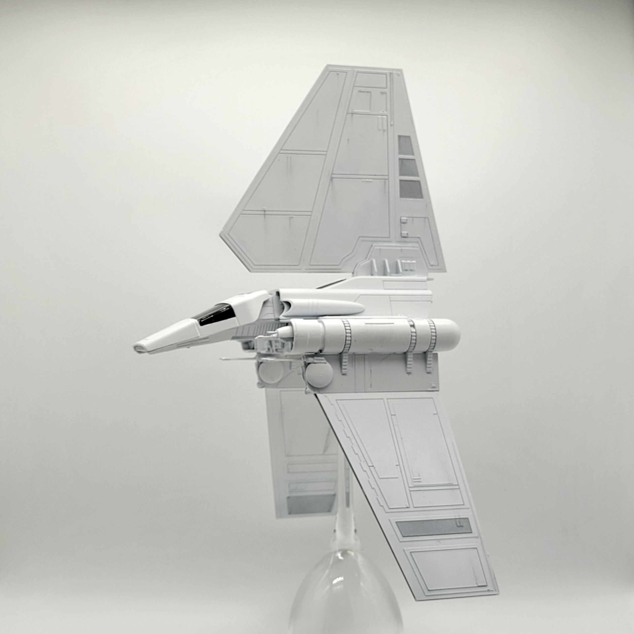

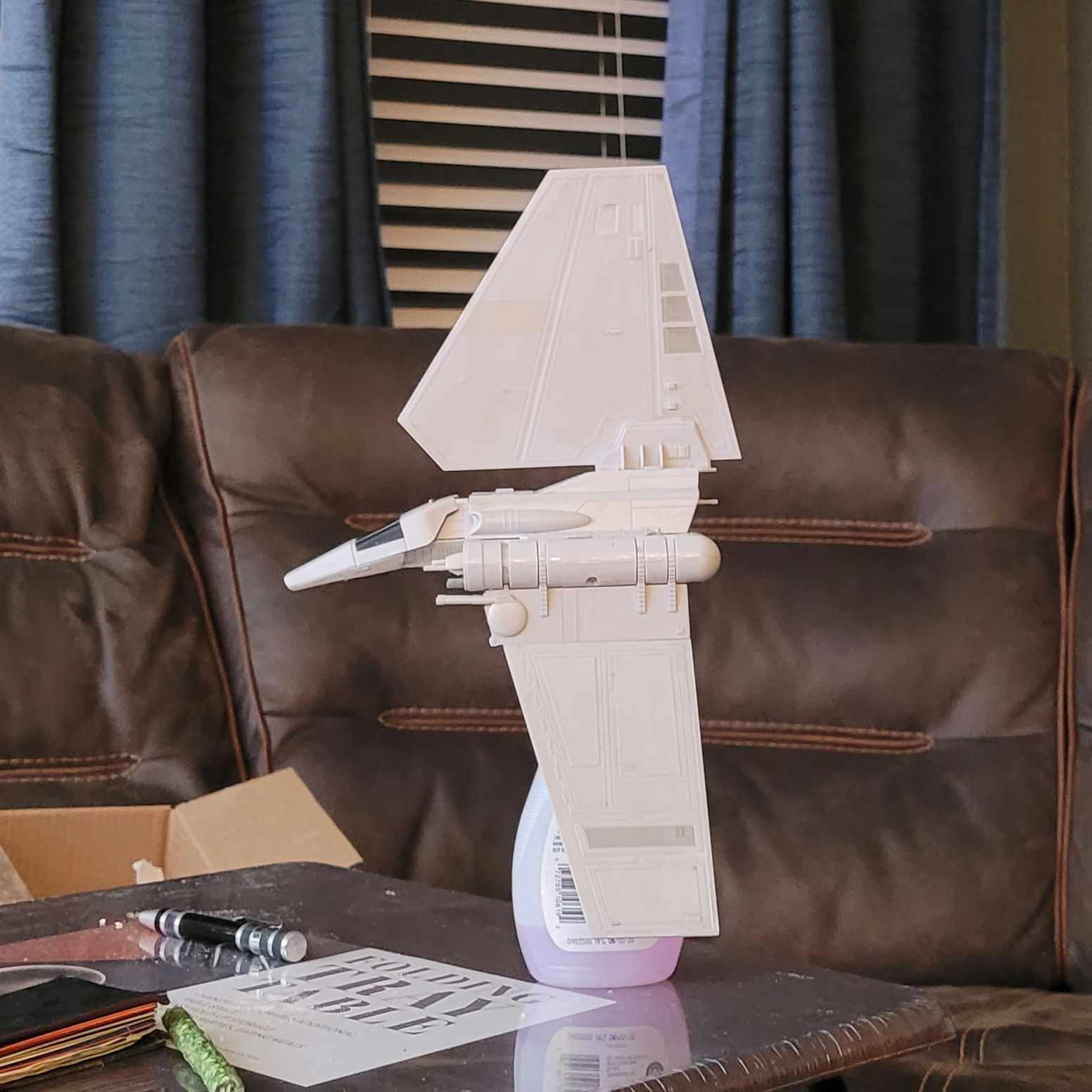

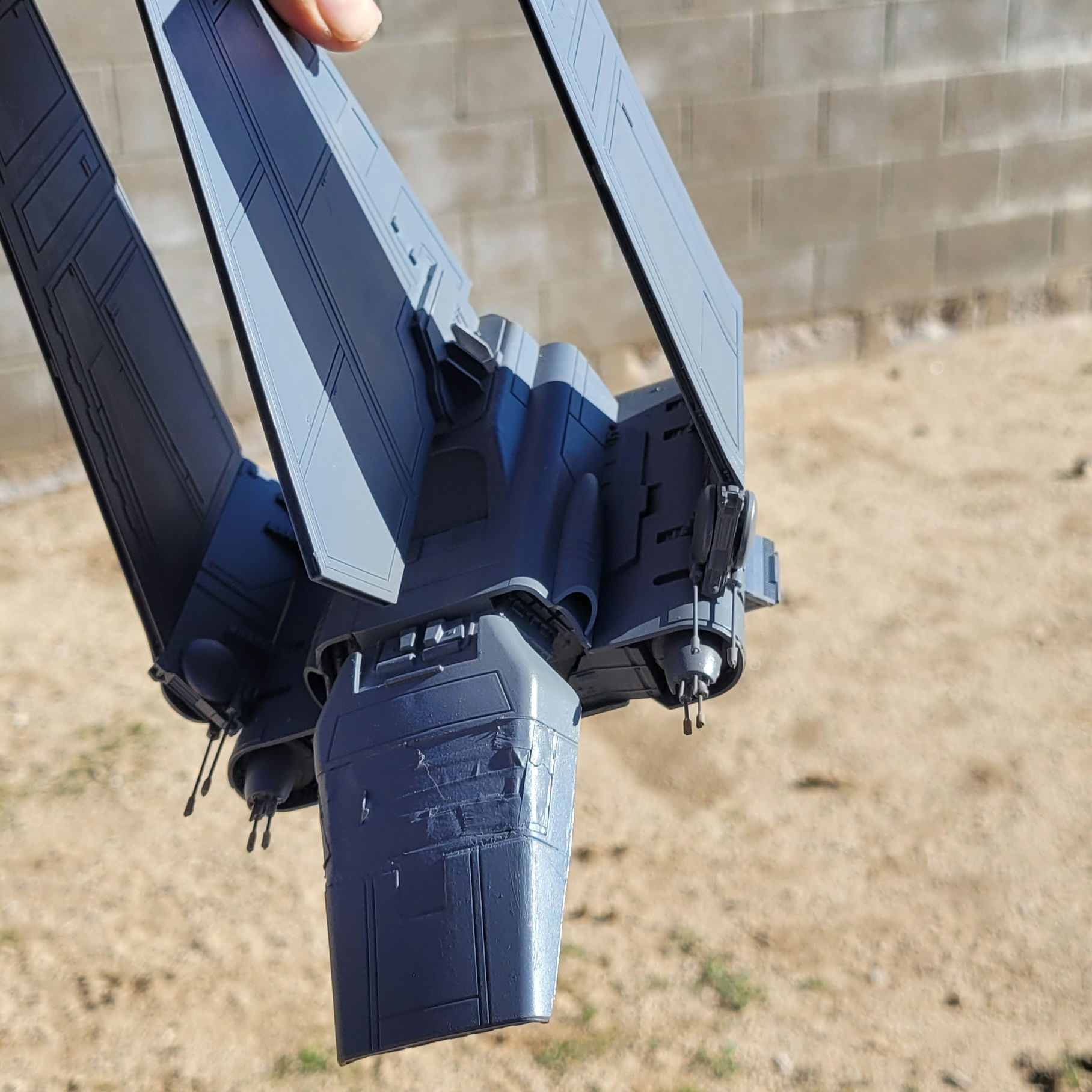

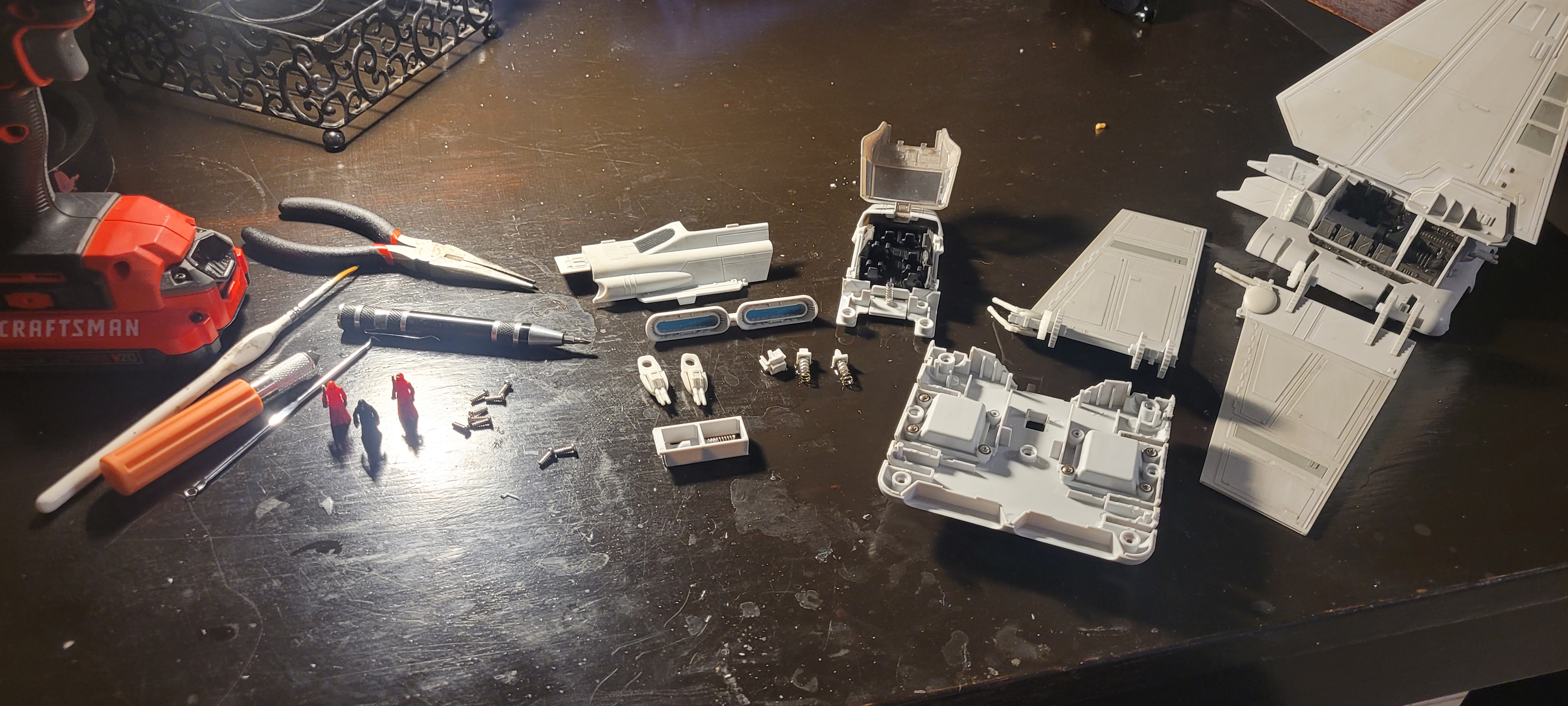

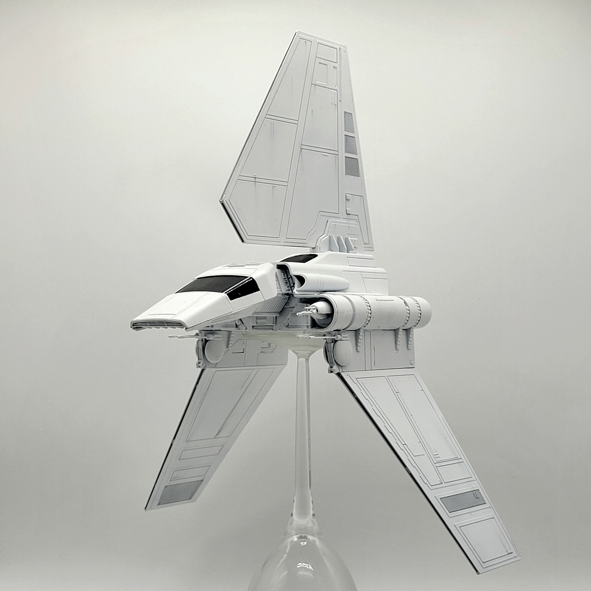

Yikes, 3 months since my last post. Well I've pretty much finished my R2 1/32 Tie, and a certain probe droid competition, so today I decided to tackle this Jazware shuttle again and began trimming up the neck. I trimmed, sanded and hacked the neck sand body until it was manageable, then had to figure out how to reverse engineer all the little springs and gears so the wings move as one internally. After some doing I figured it out and screwed in the top with the bottom. I still need add some styrene to cover hole created under the neck, but it looks much better already.
Please note I haven't worked on the guns turrets yet, yes I need to sand the sides of the main body where the wings fit to it's prettier, clean up the neck more with styrene and cover those holes, right now it's very ugly, and this will be getting repainted as well. At least I think the neck is much better and hopefully the hard part is over..

Looks wonderful! Did you taker pics when you disassembled it?

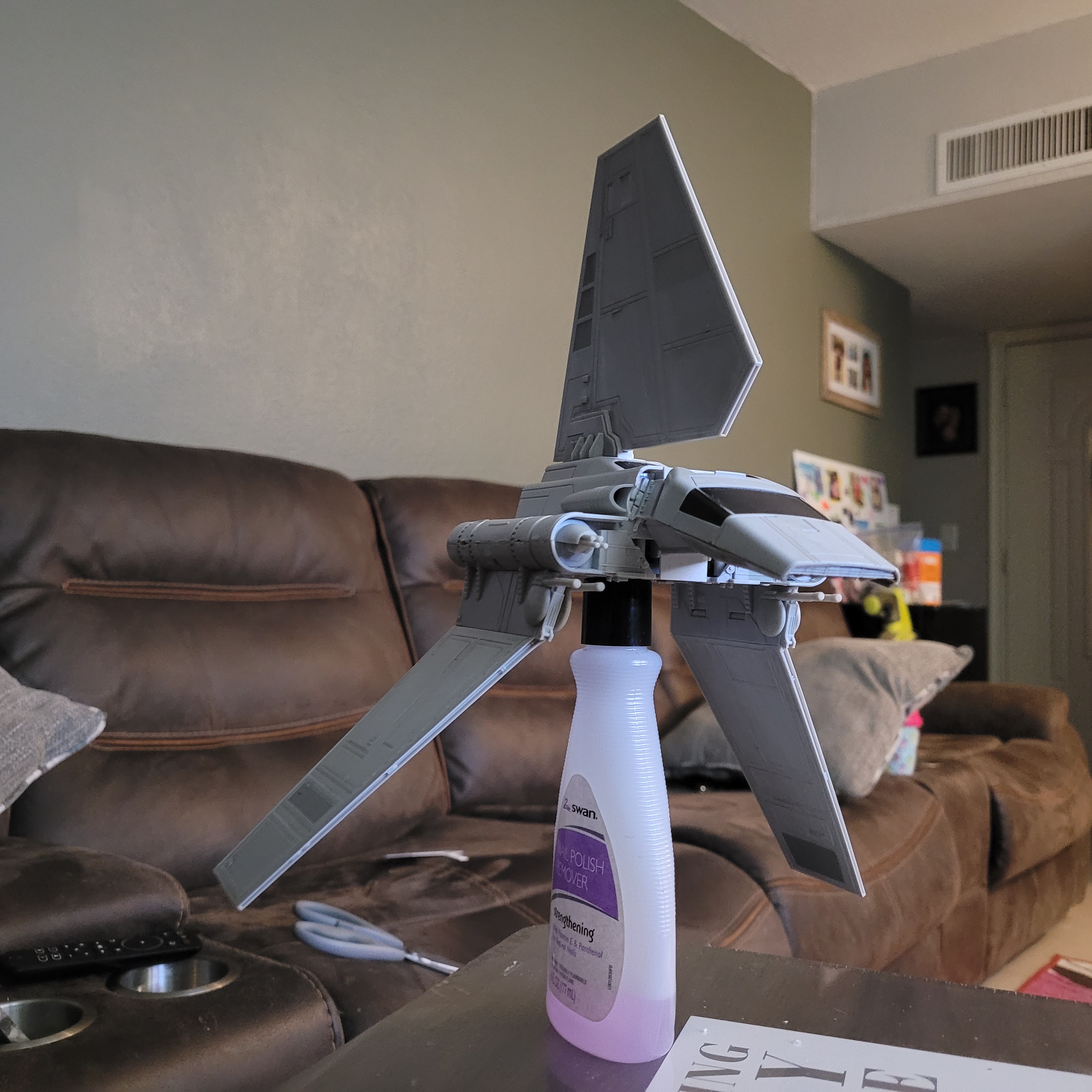

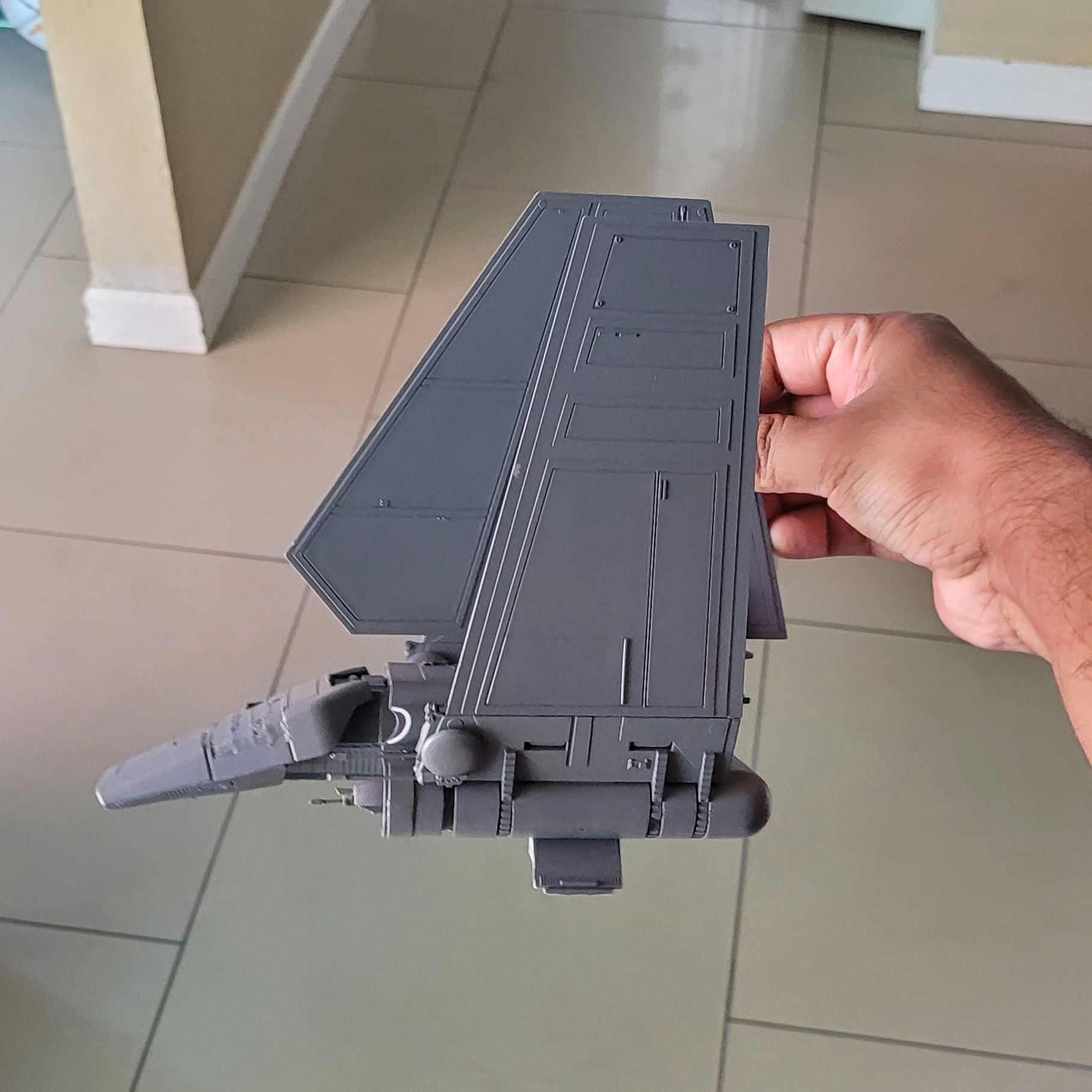

Filled in the screw holes, added brass turrets to replace the too thick plastic ones and added some gray primer. Definitely a 'poor man's' shuttle, but if you squint at it, it might look decent lol

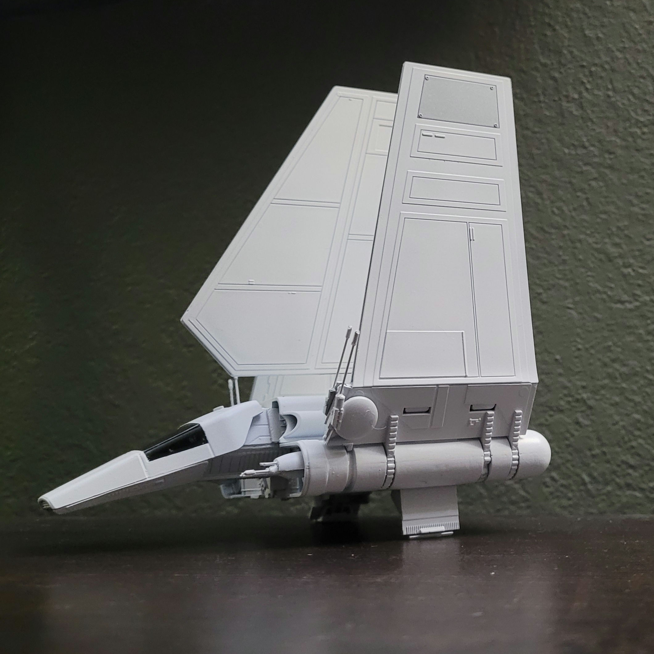

Added some primer and painted the gray markings.
Still debating how much work I want to put into this... Where the cockpit hinge was (to reveal the interior of the cockpit since this was a toy), I'm still debating on filling it in so it's more flush with the rest of cockpit but that might be a pain...

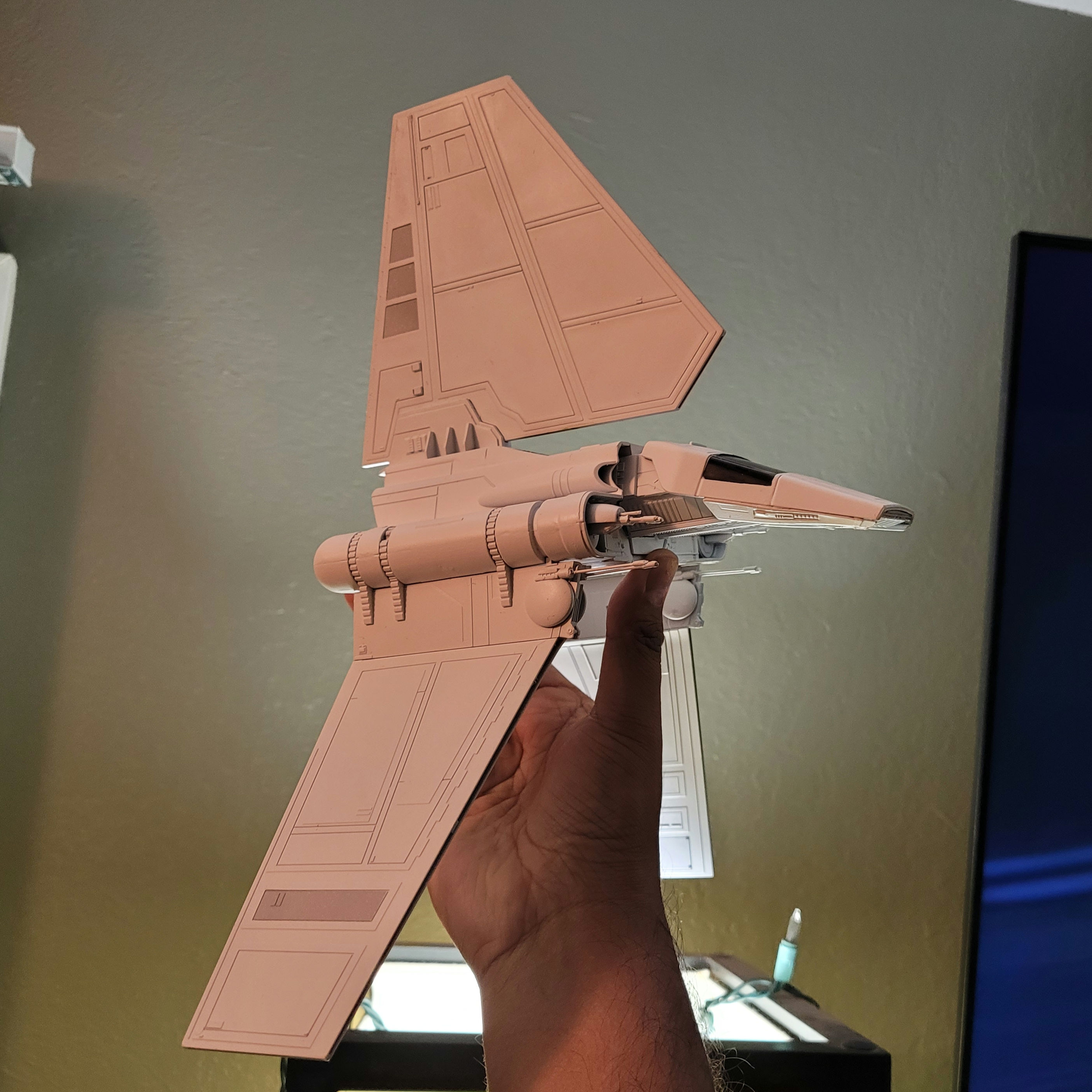

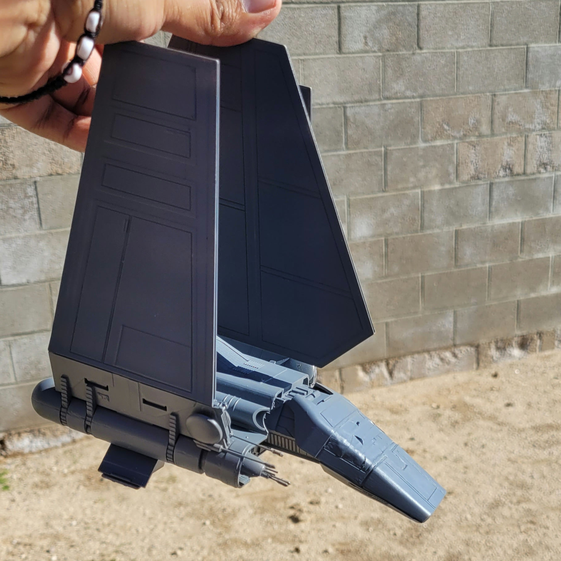

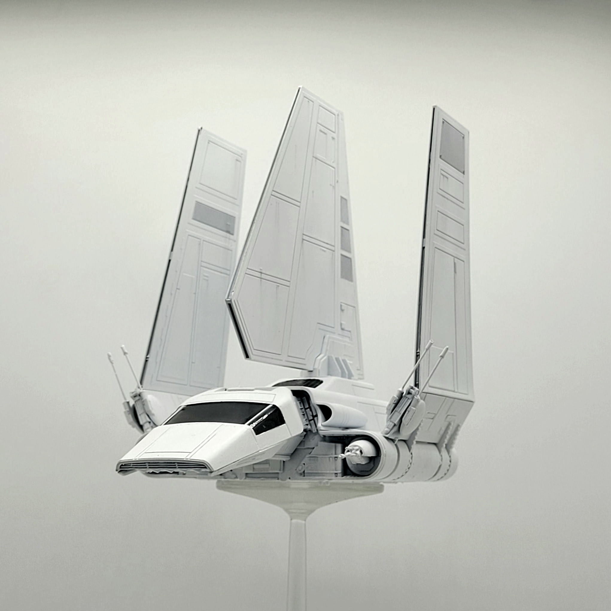

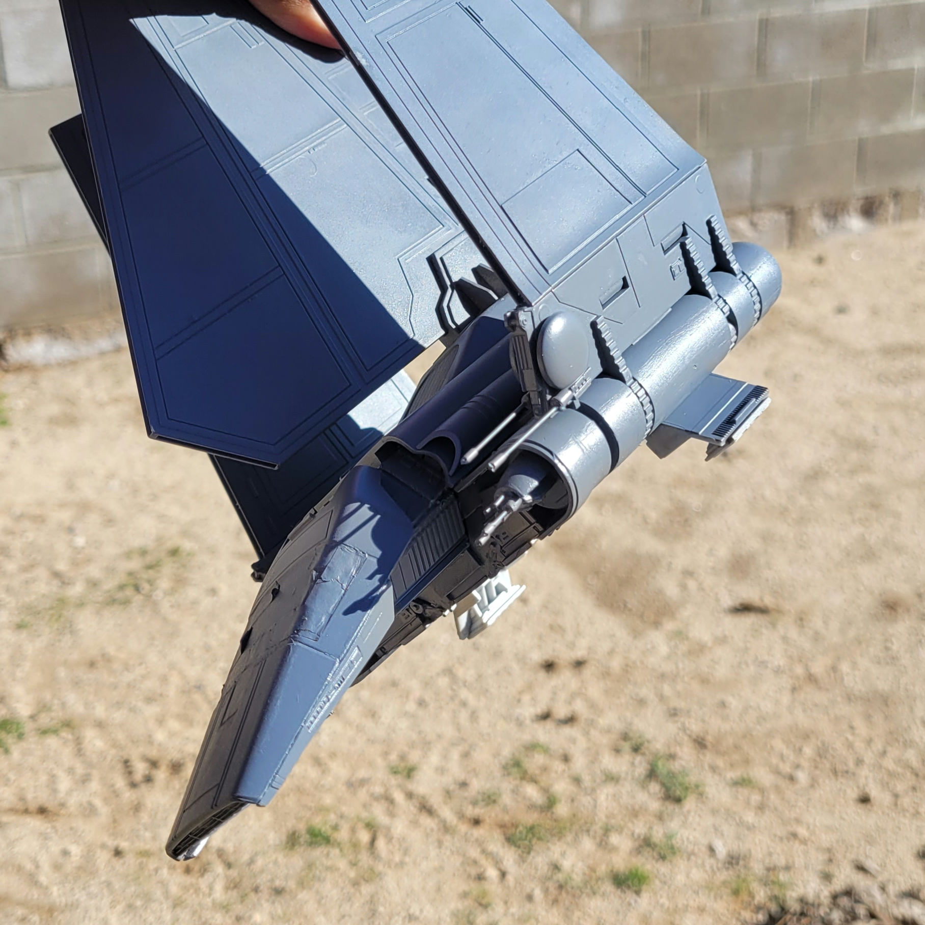

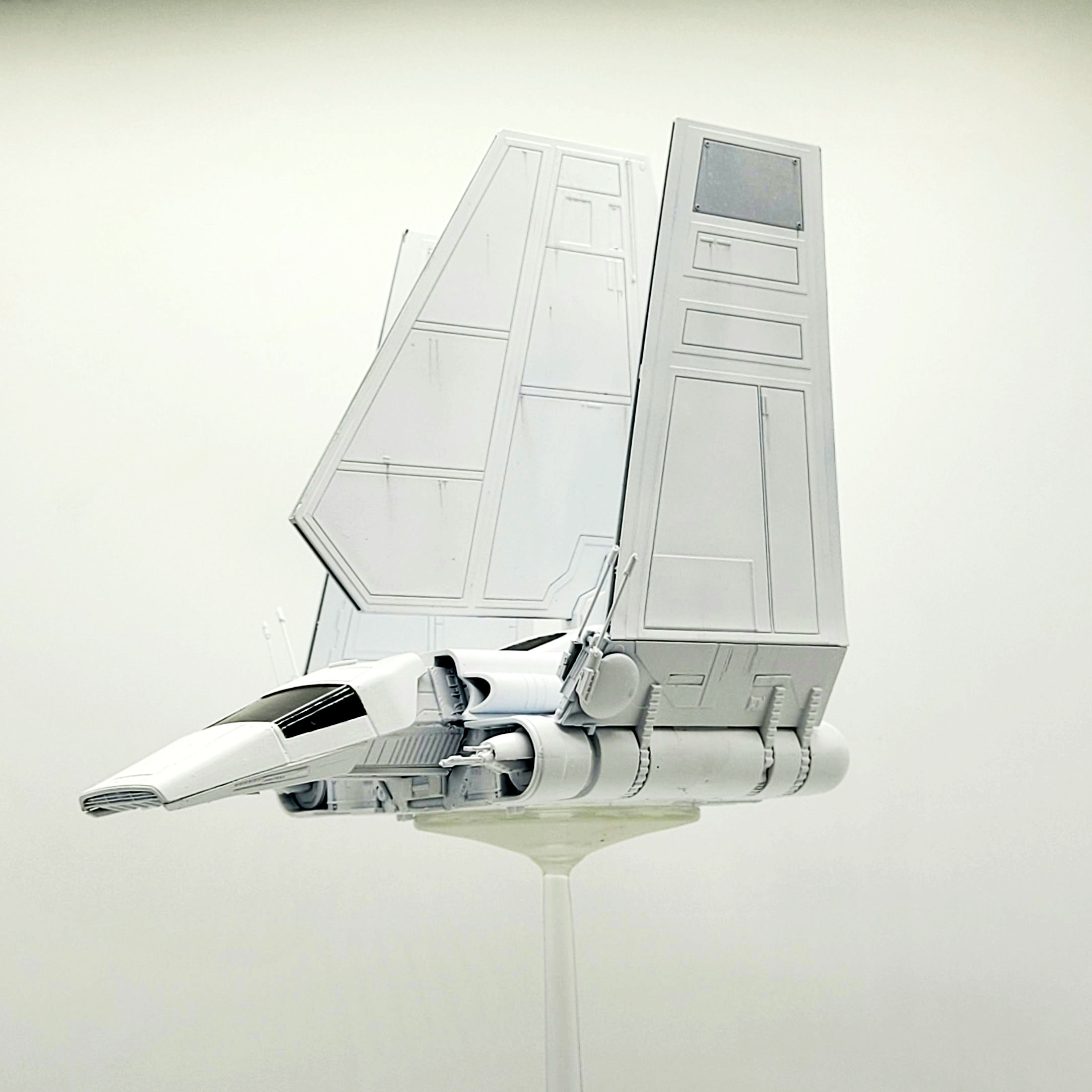

Getting closer! I need to figure out what to do with the boarding ramp. It originally snapped into place with the toy, but I had to ditch that when I trimmed the neck. I might just use it when it's landed. Another annoying aspect of the toy is the wings don't fold all the way up like the studio model, they're more vertical when up. Still debating if I can fix that or not...

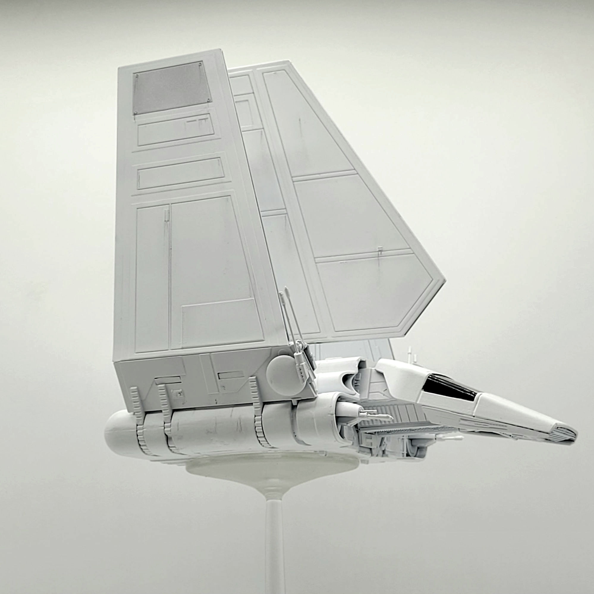

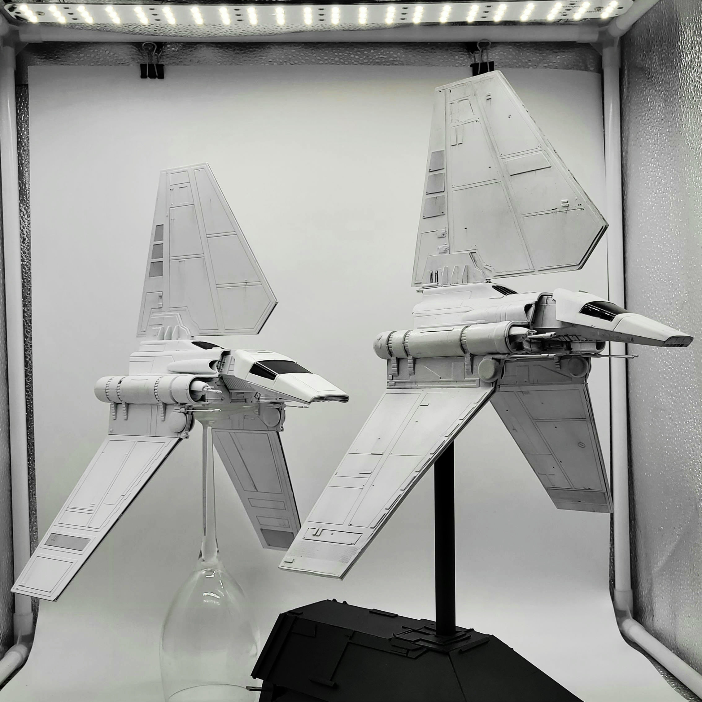

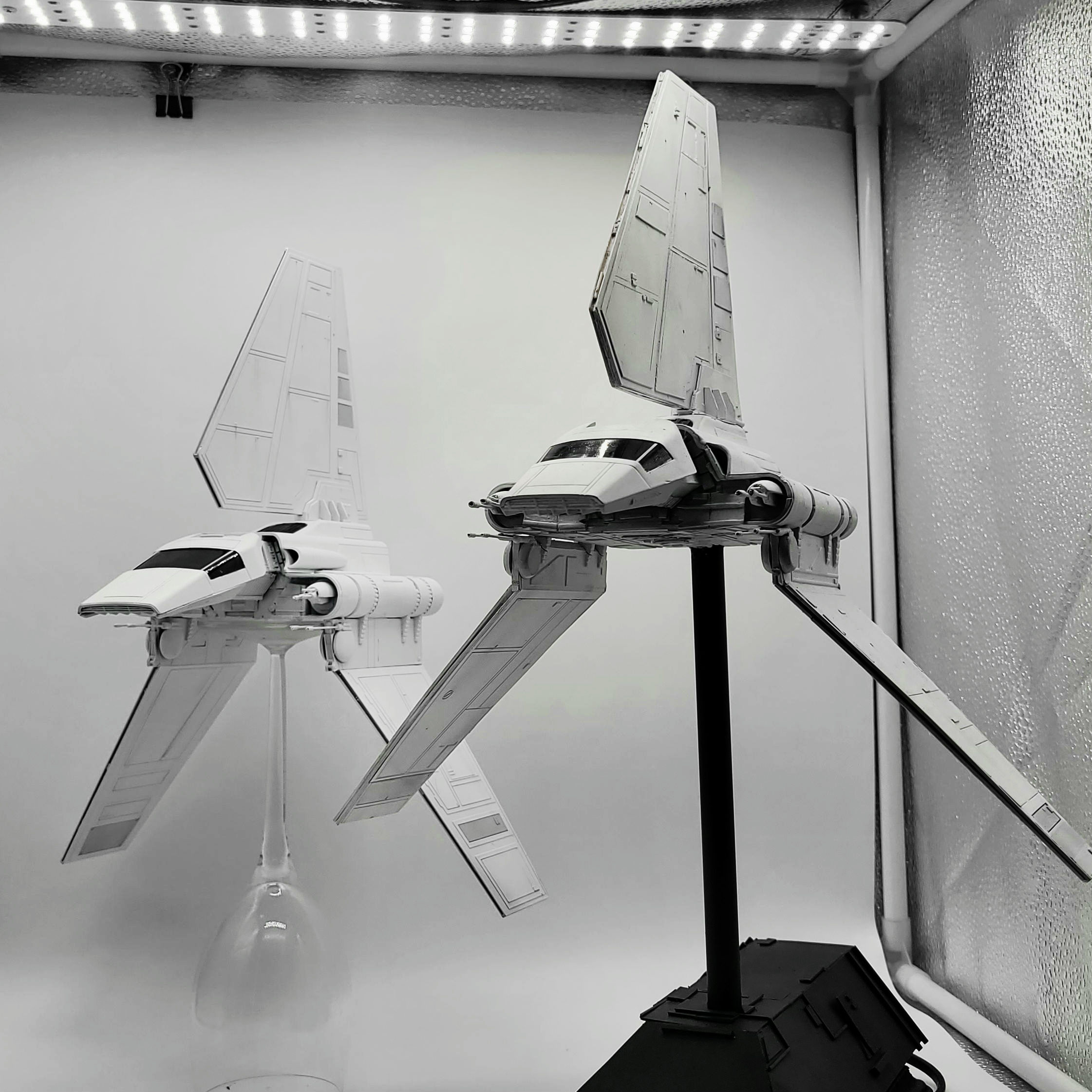

Well I'm pretty much done. The list of mods is pretty short: I did surgery to shorten the height of the neck, slightly realigned the cockpit angle and filled in the gap it produced at the base of the body. I filled in all the screw holes with putty and sanded it. I filled in the side seams as well, and a few other areas and lastly I replaced all the turrets with little brass tubes. It was completely primed and repainted as well. I decided to keep the synchronized wings which was a pain to reverse engineer. I'm also shocked at how close my Revell modified shuttle is compared to the toy size wise! Anyways, thanks for looking!

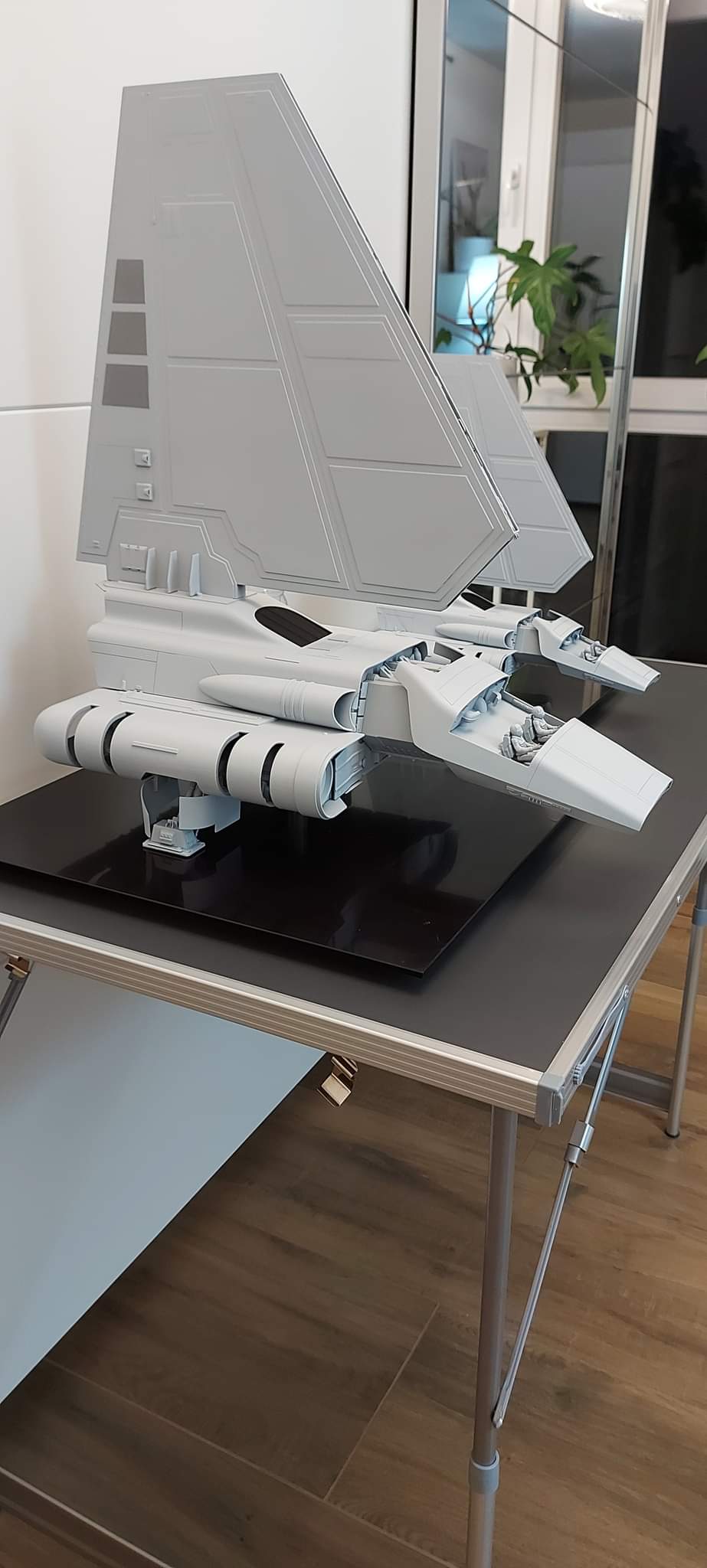

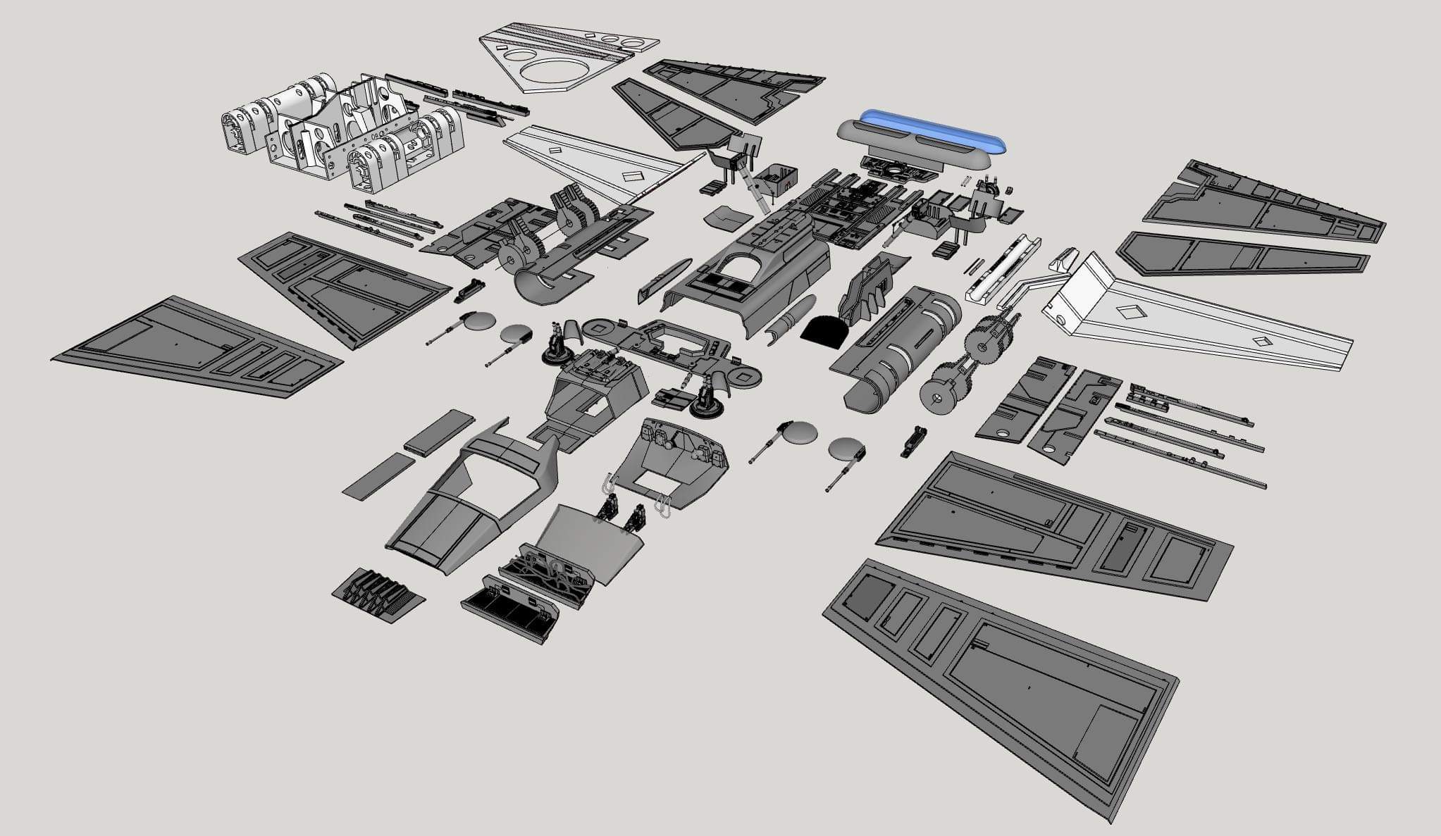

That's amazing ... well done jusdrewit ... now I don't know if you are aware yet Robert James from Robert James Models on Fb has recreated a screen-accurate 3D Shuttle Tyderium ready to be printed in 1/72 or smaller and even in Studio Scale after some adjustments ... check his work in progress out ... it's incredible :)

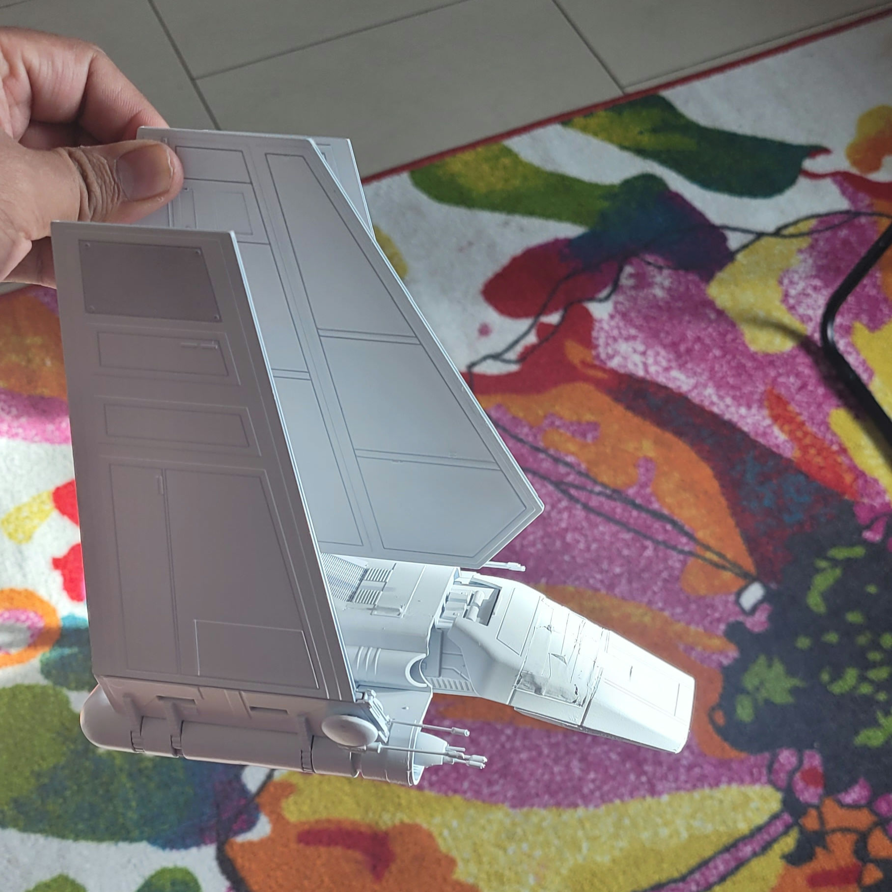

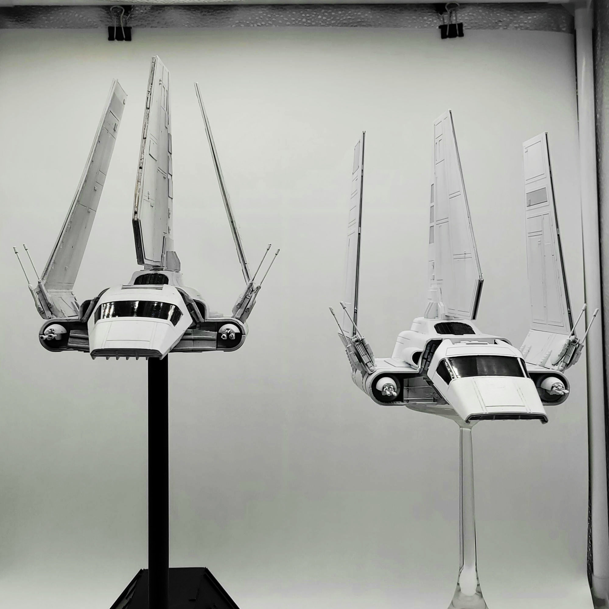

On a side note, I've a big fan of Merlin Models, but I've been disappointed with their shuttle photos:
Cockpit appears too thick imo
Space between engine placement is clearly too far apart vs studio model, unacceptable imo again.

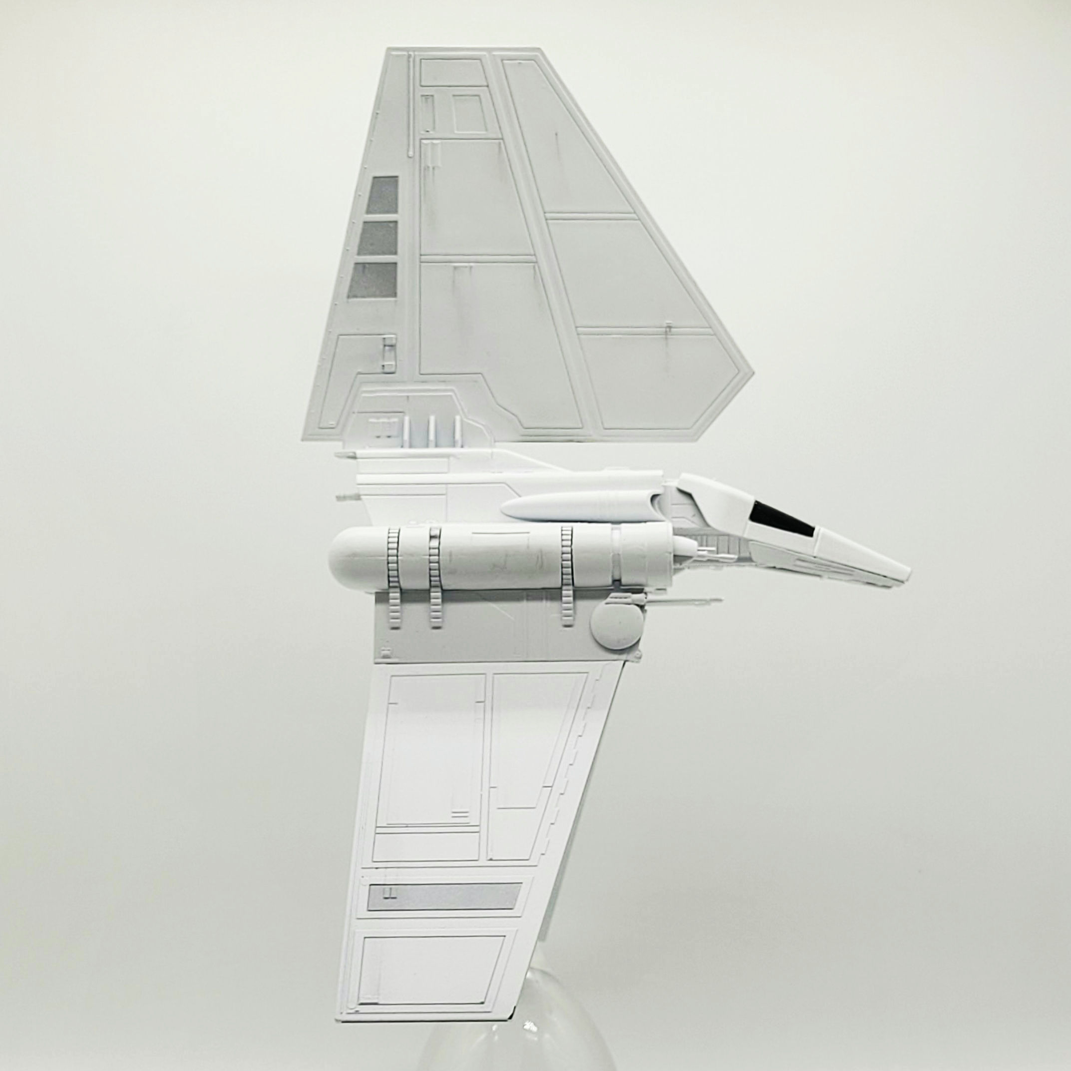

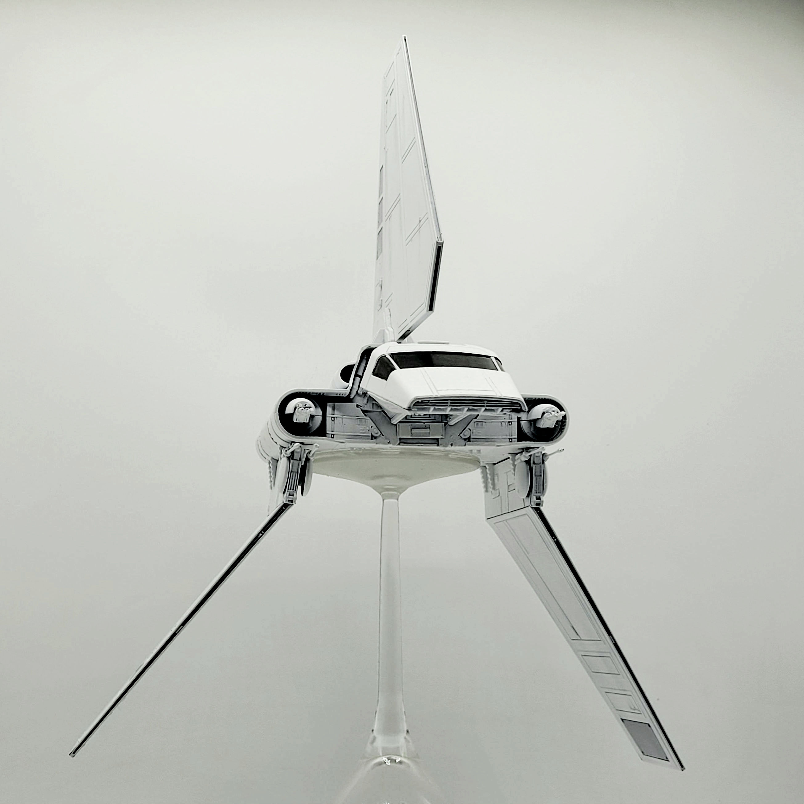

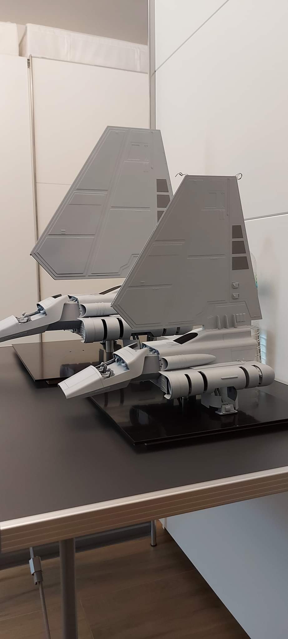

On yet another note, I've also been following Phoenix Modeling on FB and his shuttle kits look light-years better then Merlin's, and just gorgeous:

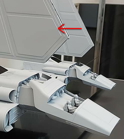

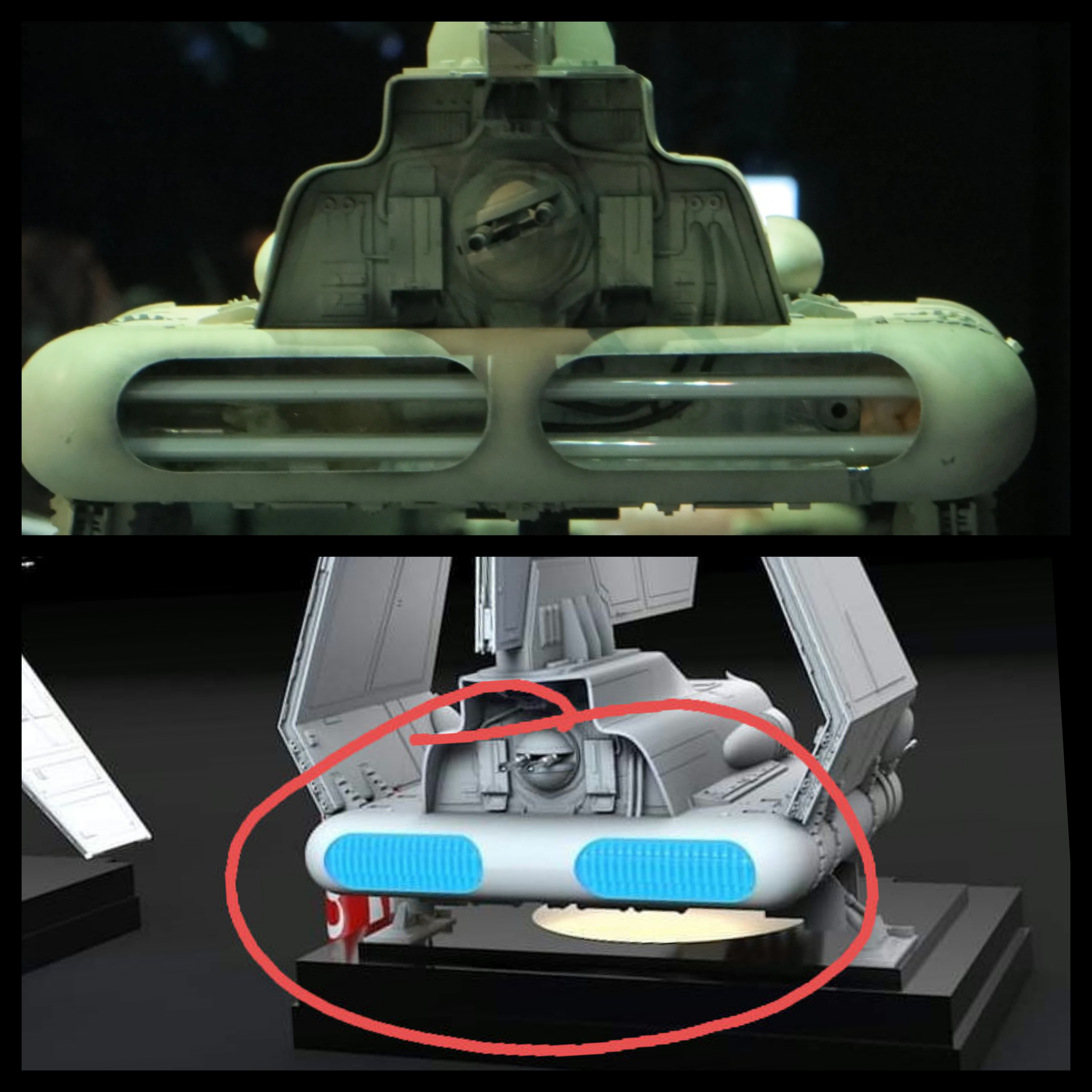

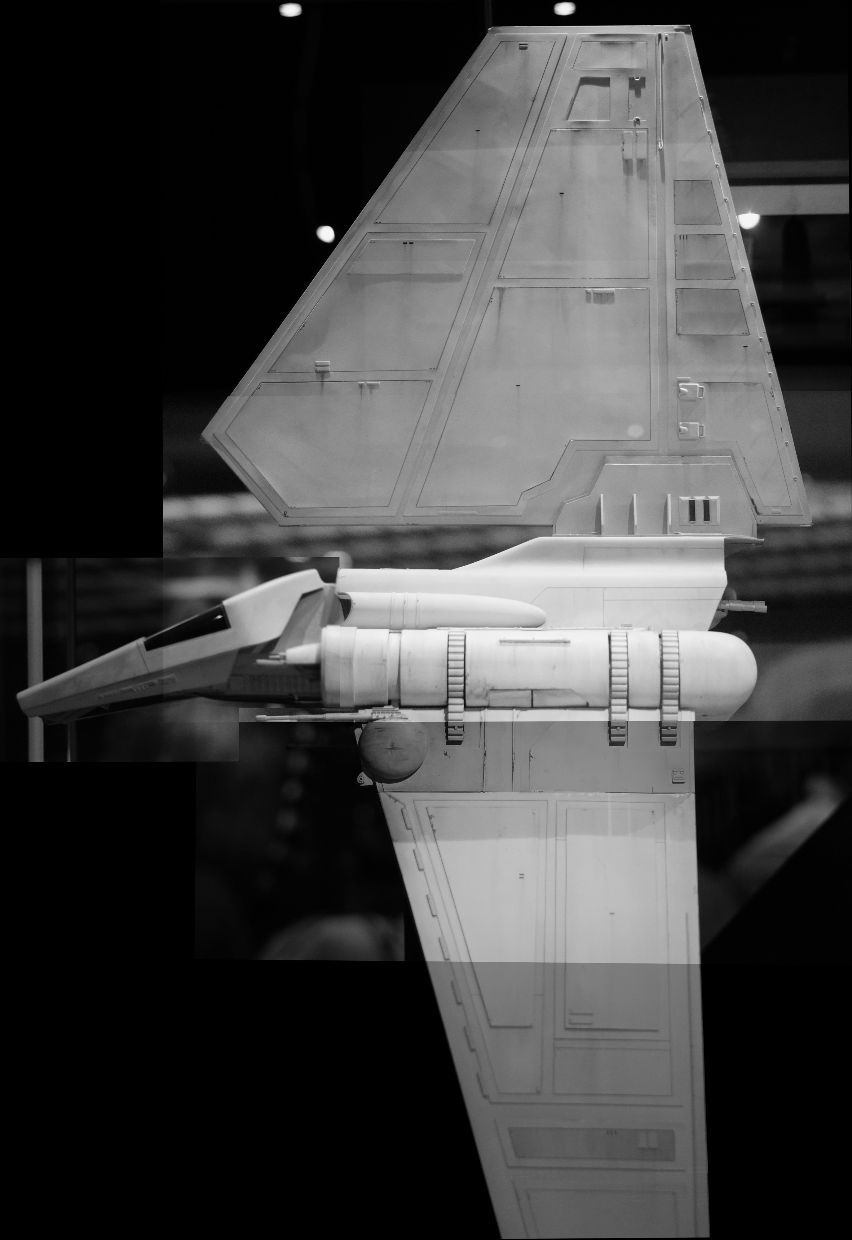

Well perhaps you can tell Phoenix Modeling that this extra layer on his dorsal fin is wrong (see red arrow)
... it should merely be a scribed line :
Perhaps Tab039 can explain how he made his dorsal fin and wings?

As a heads up to anyone who's interested in a beautiful shuttle, I believe Robert James Tydirium STLs are finally finished and available for purchase from what I'm hearing. This should be the gold standard for shuttles at this point and put my model/toy conversions to shame lol
