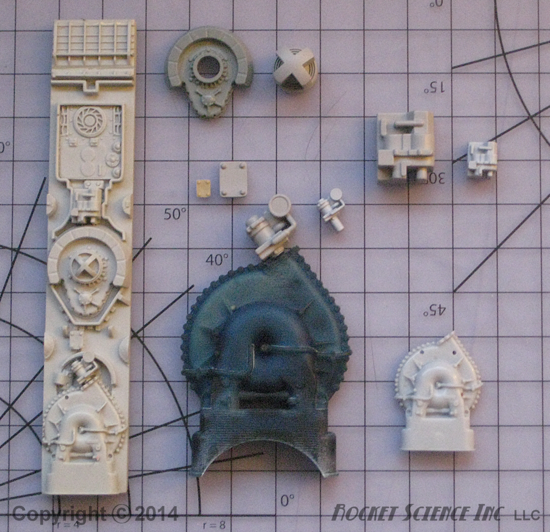

I'm finally ready to post about the 1/12 X-Wing (look for the thread soon ) also some 1/18 scale X-wing and new 1/24 Laser cut wings kit.
As soon as that project out the door, I can turn my attention to the Falcon.

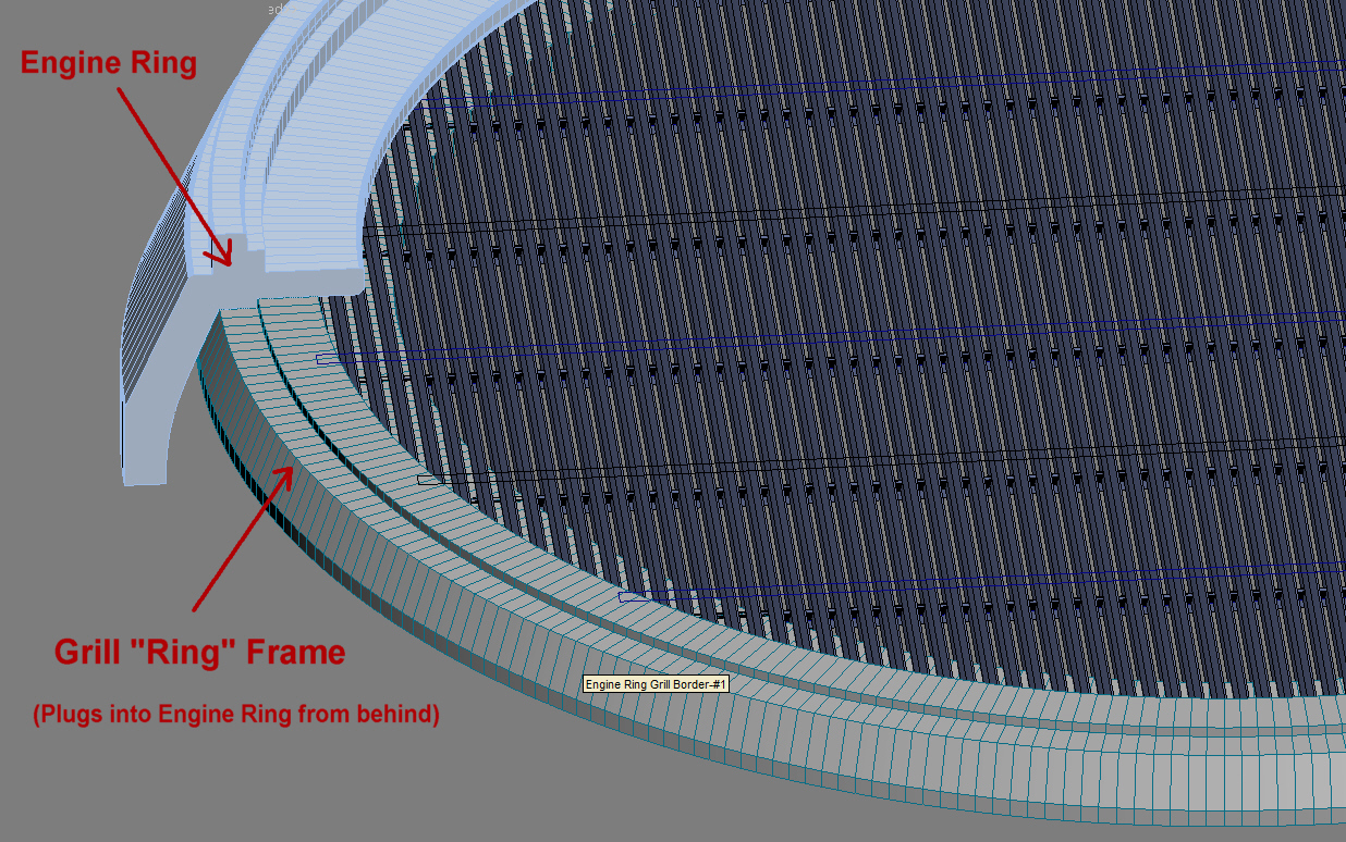

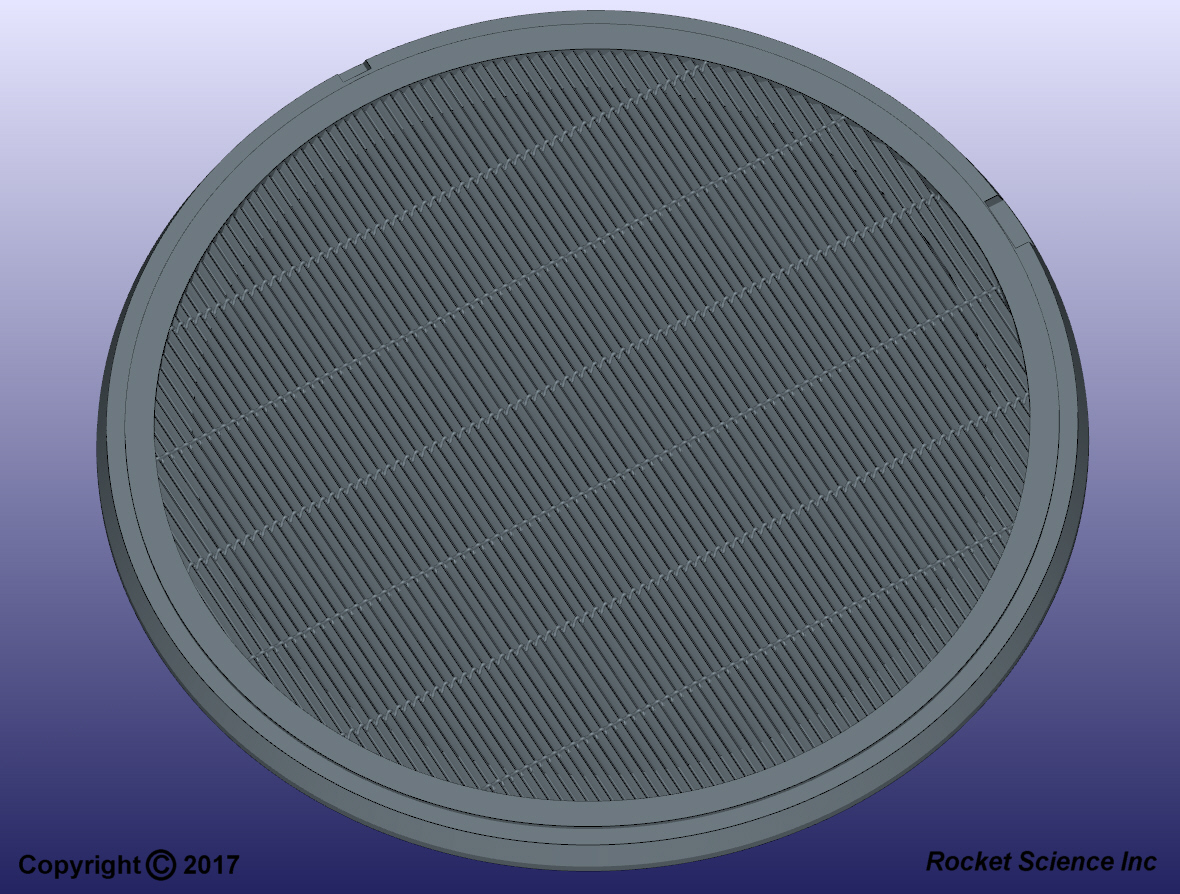

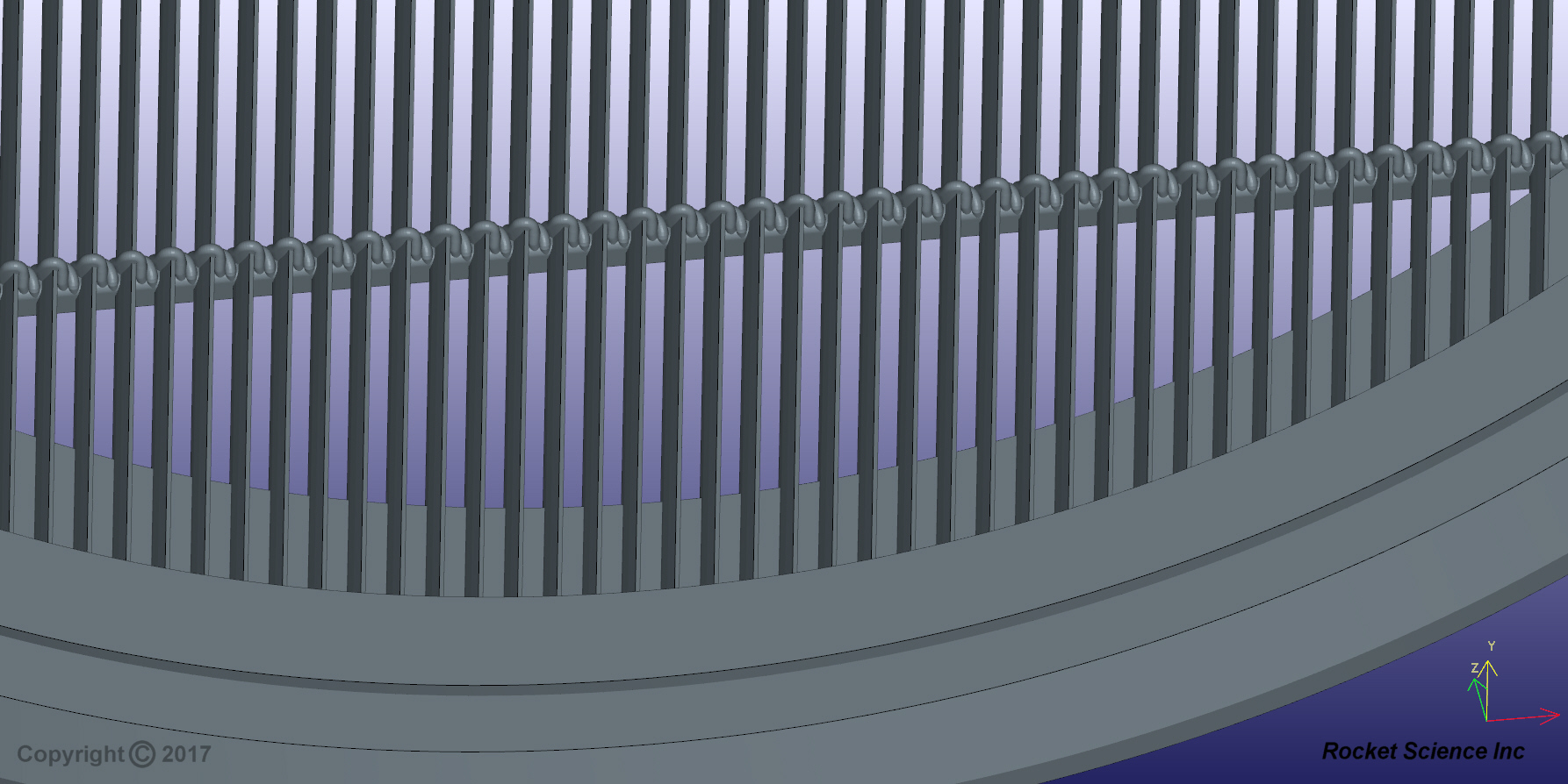

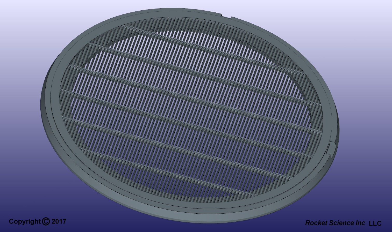

I did make these last February. The test prints worked out great ! ...more durable than I had hoped.
As these have a pass-thru grill they are not cast able but will need to be 3D printed. ..still cheaper than real Kool-Shade.
Normally the Virtual Kool shade is too "delicate" as an actual "grill" ( the 3D printed material does not have the tensile strength of real metal/brass)
..But because of the ring/frame there is added strength. I was also able to add support from the back side of the grill, which remains hidden quite nicely
These grills are of course too "perfect". -- I need to go in and bend up the louvers, which won't take too long, got to make 6 unique rings though (each is bent-up a bit different)
I will also make some VKS for the sections along the top of the docking bay ridges.
Those will have "backing" so they will be castable and much cheaper to reproduce than 3D Printing each one.

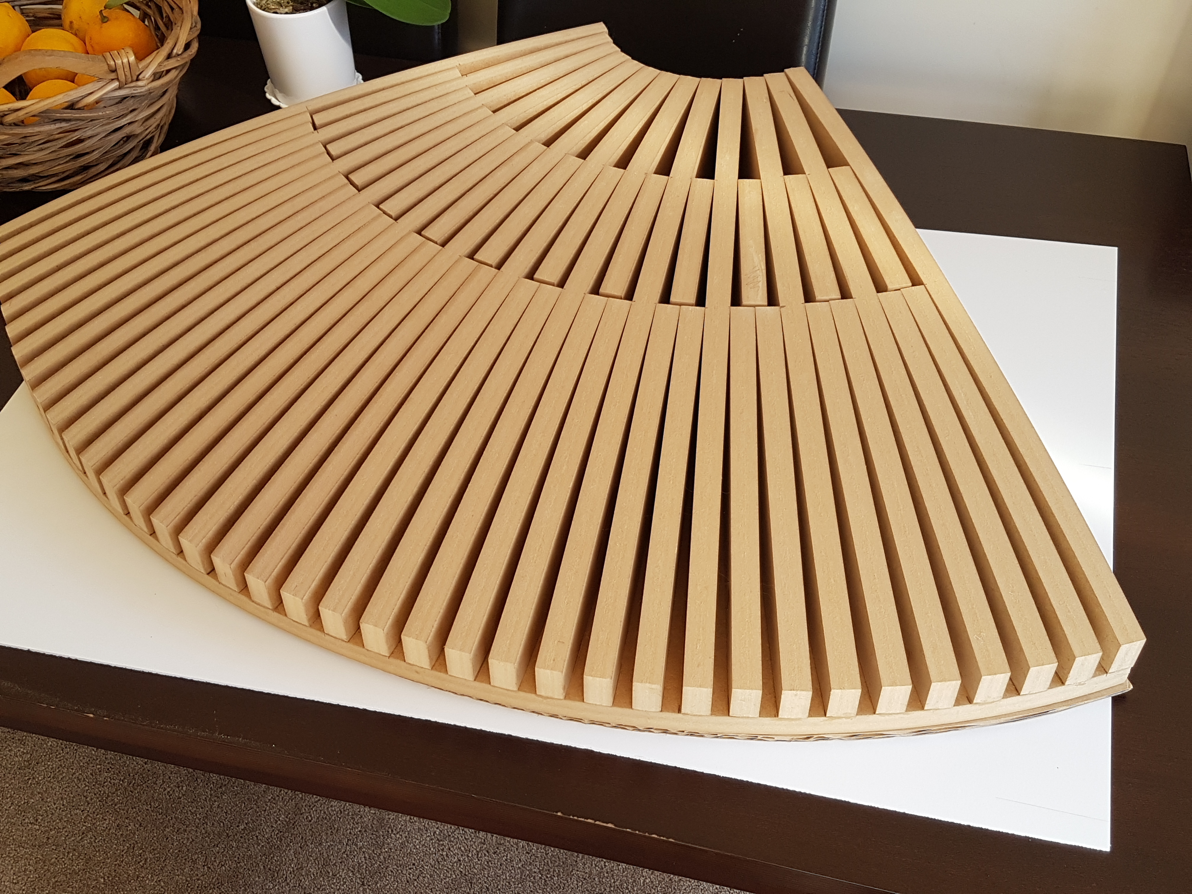

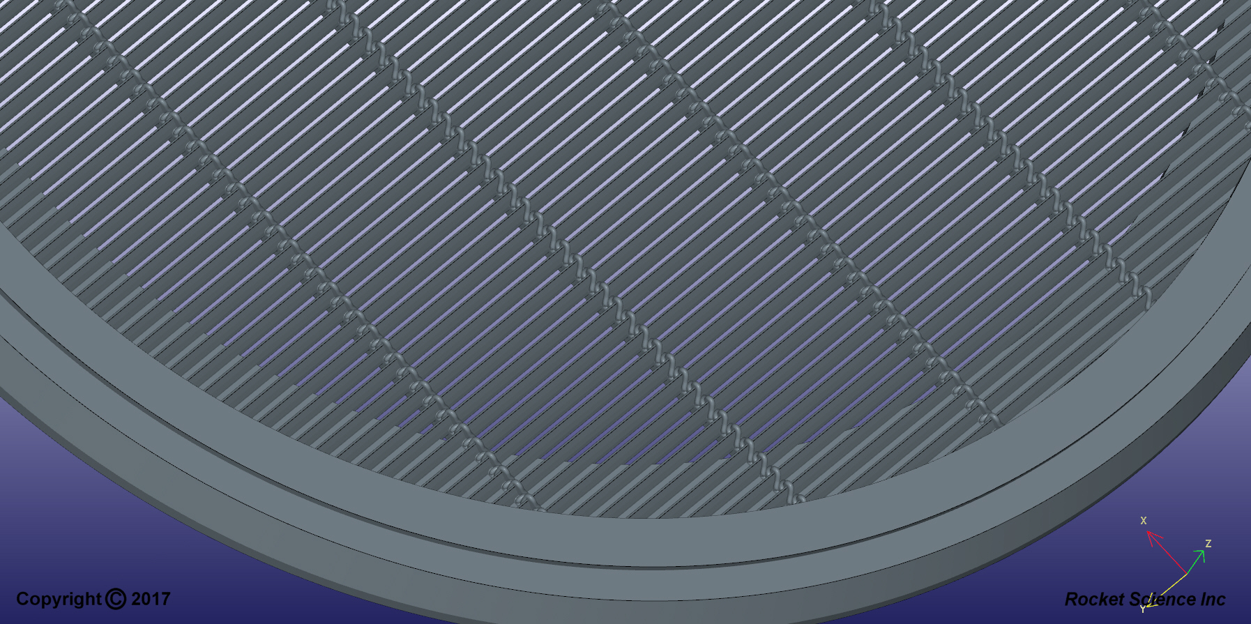

I also did some experimenting with the section of Kool Shade on the Cockpit Tunnel.
I think I can provide a convincing "castable" version of the VKS for this section which will also bring down the cost.
There is the issue of the diameter of the Cockpit Tunnel, some folks are building their's at different diameters.

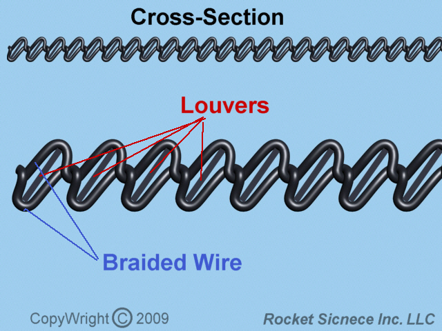

I'm not sure if there would be much interest for an affordable Kool-Shade substitute.
The modern stuff might look just fine on the Falcon (without the 21 louvers per inch next too it, to compare too)
View attachment 751238View attachment 751239View attachment 751240
View attachment 751241View attachment 751242View attachment 751243

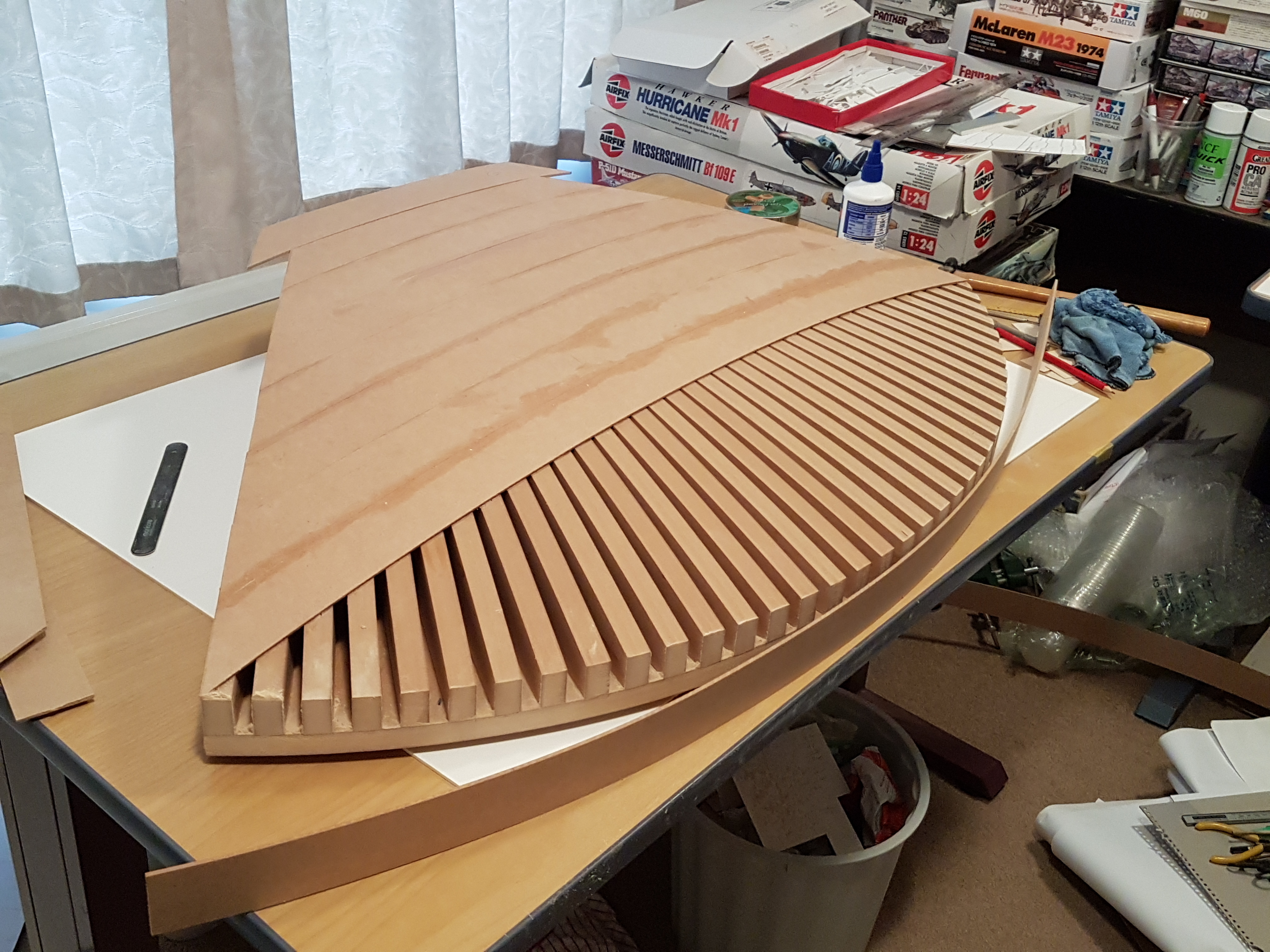

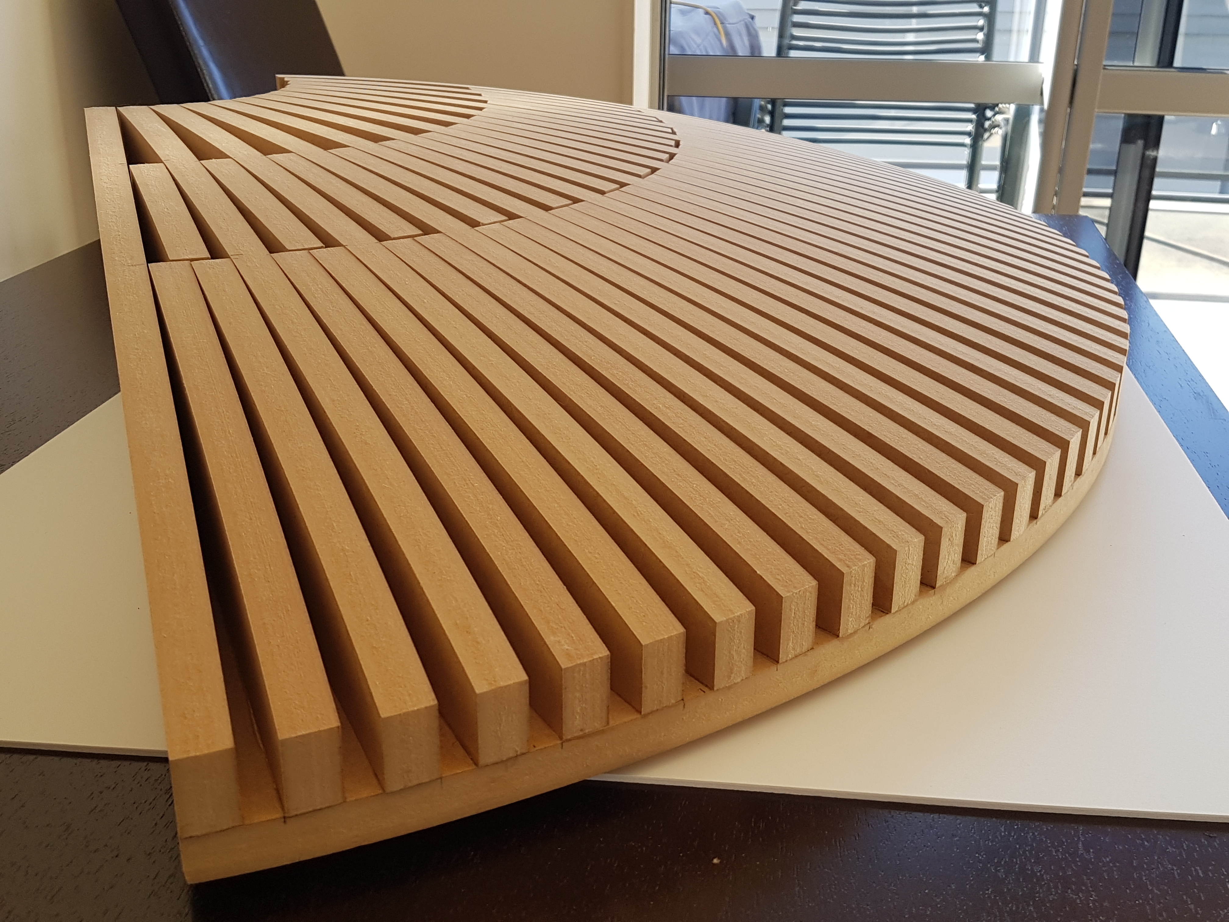

Thought I'd post some progress on my hull dome work.
I realised early on & couldn't find a place in New Zealand anyway to blow mold one piece domes, that really, there is no point to full domes, why wouldn't a half dome or even a quarter dome section work!. So that's what I have done, built an oversize quarter section form or tool, to have the domes vacformed in 4.75mm ABS. The tool is oversized to allow good pulls & trimming when placed on my core. The tool was all CNC'd MDF. Just finishing up the skinning now, which is 3mm MDF. All this will be sanded smooth & filled if needed & sanded again & sealed. Then it will be down to the plastic formers for vacforming. 10 pulls will be needed for 1 Falcon, 8 for the 2 domes,1 for the engine deck & the last for the engine petal strips & maybe another as a spare.
