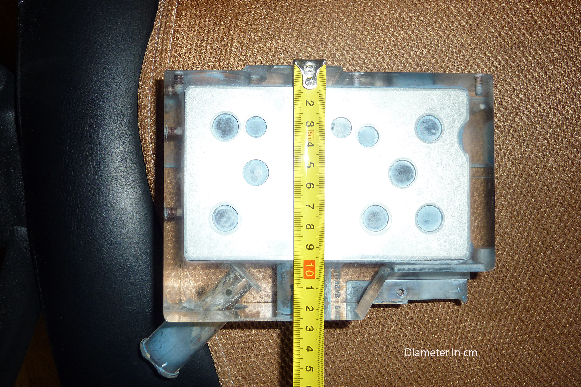

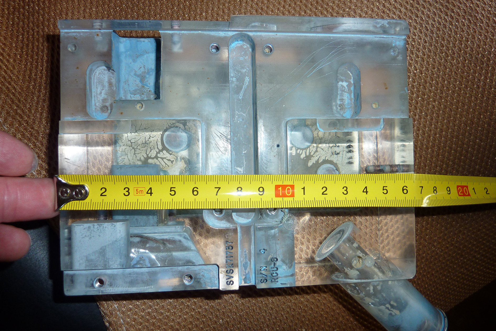

Dimensions will be supplied
The pictures show the original part from the Apollo period
According to this model the functioning RCU were manufactured
Spaceman2304 THANK You. Here at the RPF we all strive for the most accurate information and your contributions are much appreciated. Every once in a while we get a person with Niche information. That information is gold for us.
As a collective we can give back as much as we get. In other words the more you give, the more the group here can fill in things you might not have.
Thank you again.
View attachment 733089View attachment 733090 P1100158.jpgP1100160.jpg Dimentions in MM CM

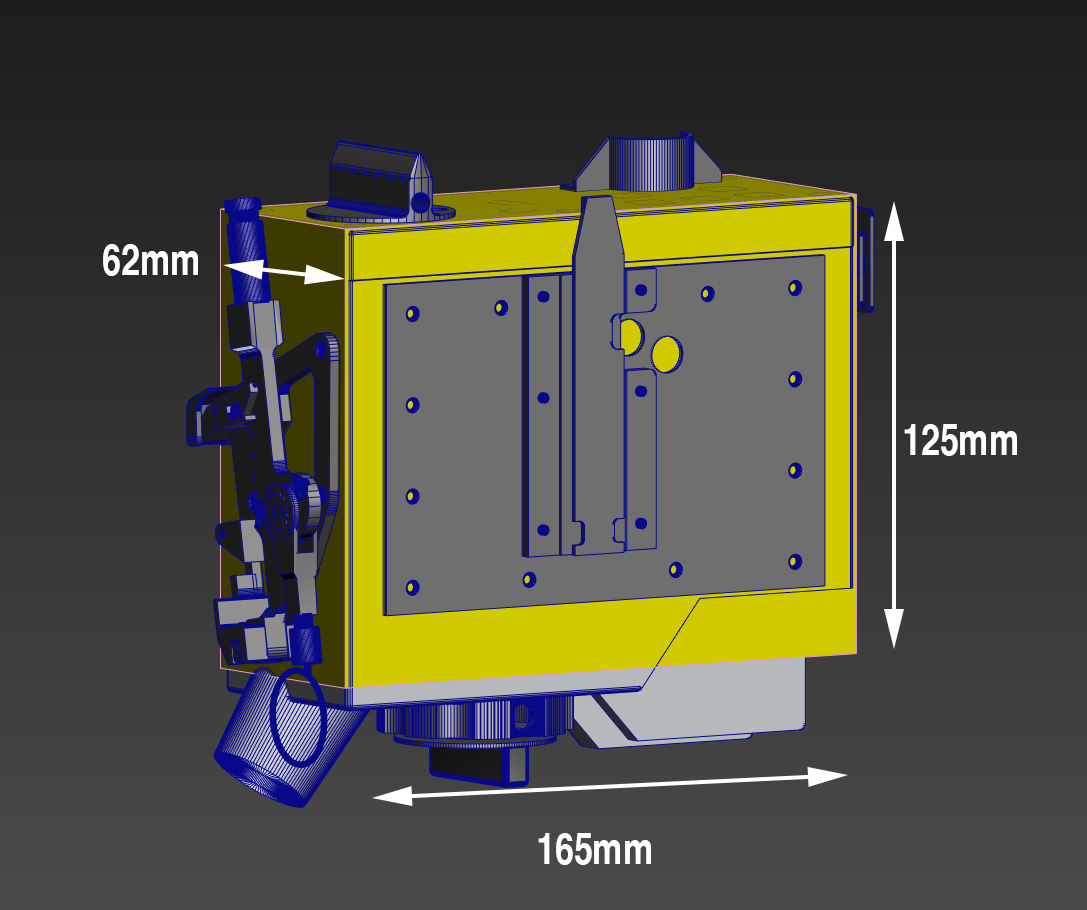

So I got around to comparing the measurements taken from Spaceman2304's RCU prototype. The yellow box is the prototype. Looks pretty close except for the height on mine is about 6mm too tall... easy fix.
Thanks again Spaceman2304!
now the rigt dimensions for the fixing mechanic rcu apollo
