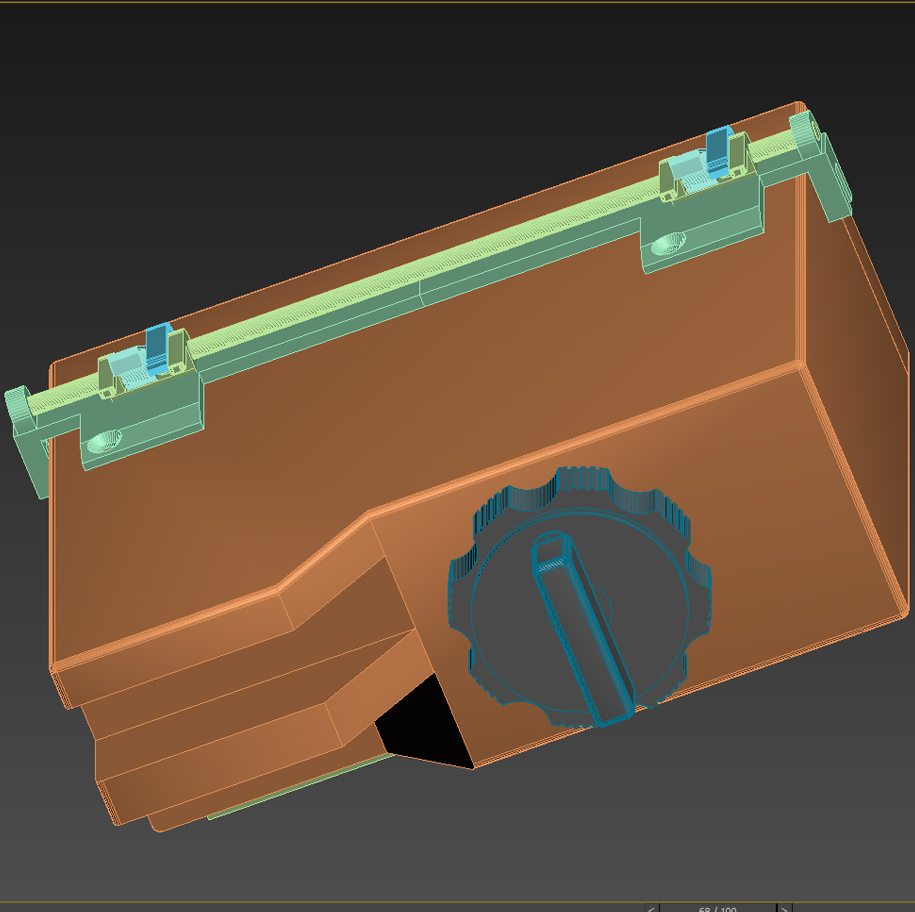

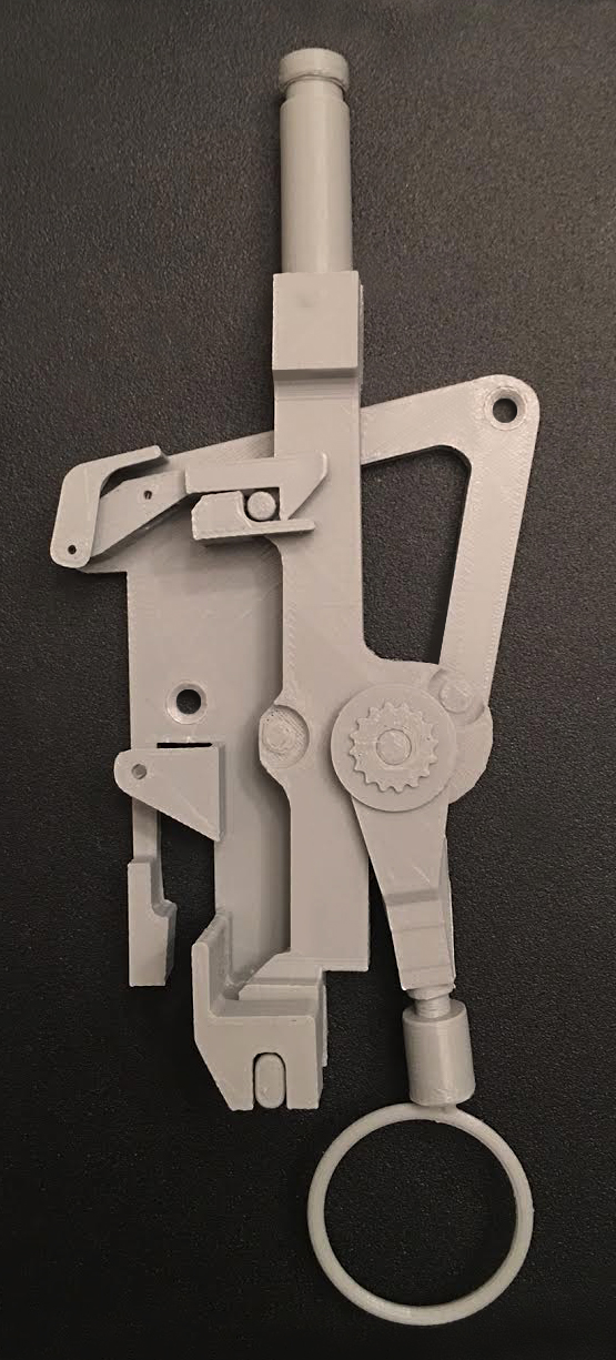

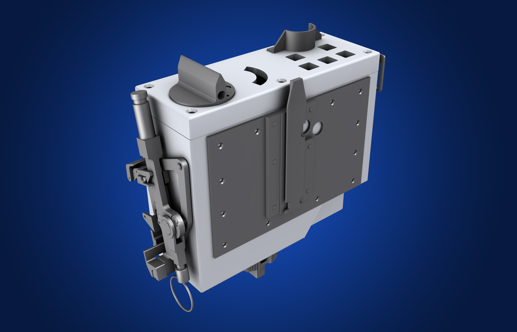

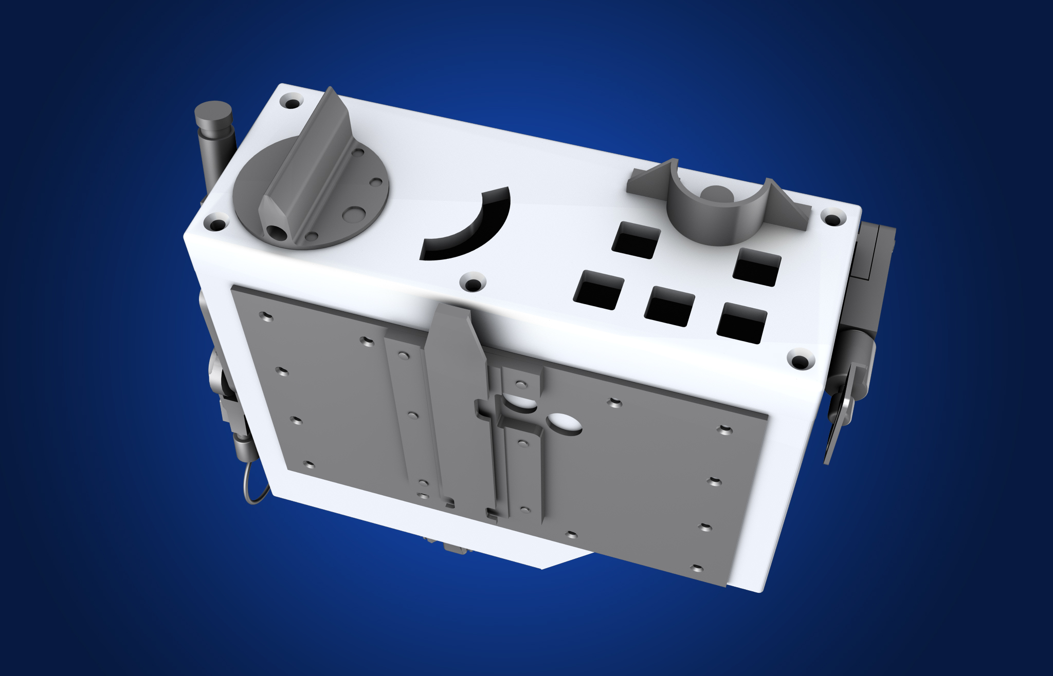

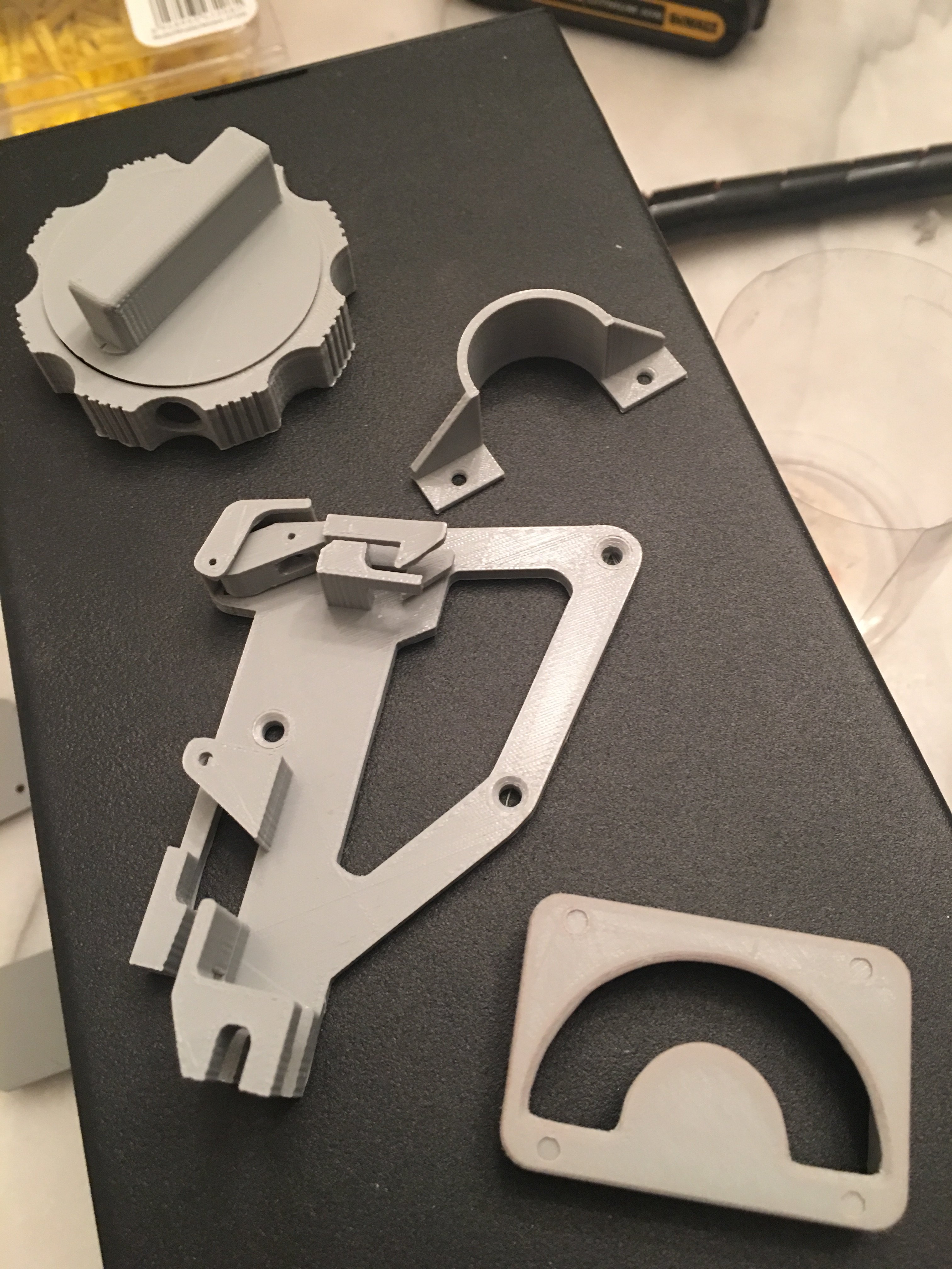

Next up, the RCU. Still a wip, but it's getting there.

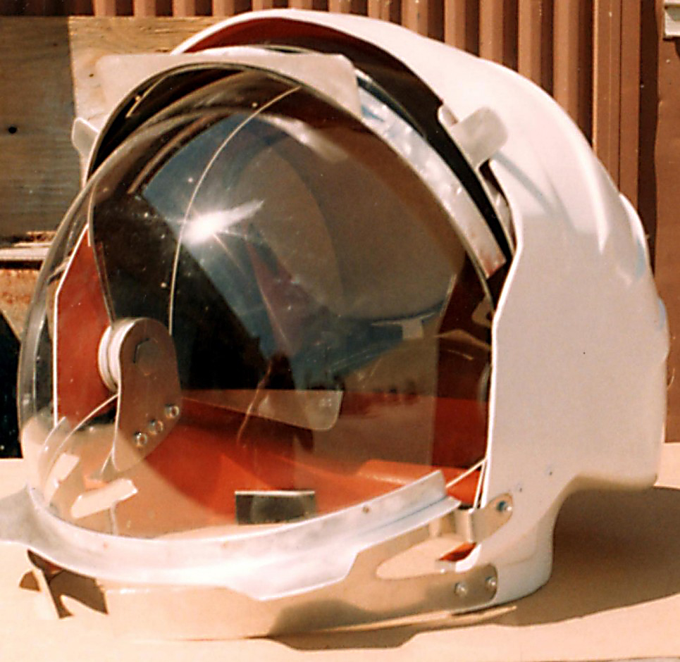

This is the only shot I can find so far without covering. Does it look like the real deal to you?

It looks like a very nice copy, but I have my doubts that it's the real deal because of the hardware sticking out on the hinge assy inside. Flight helmets that I have come in contact with usually use spherical/low profile nuts inside for the wearer's protection. As this sets it's going to scratch the daylights out of the bubble worn underneath... that or there's some type of inner cover missing in this shot. I also find it strange that it's apparently photographed outside.

That's a Global Effects LEVA.
I think your right. What threw me was the hex bolts at the bottom of the visor mount tab. I think these should be Philips head and the rubber pads are missing. This may have been a rest, or an early one.
Edit: Looking at it again, yes this is and early piece we made for HBO's "From The Earth to the Moon". The lift tabs and side sun shades are formed aluminum and as yet unpainted.
BTW: that's pretty close to the real ones. We were given an original A7Lb center sunshade to repair and were told we could mold it. Well I realized that since the sunshade covers 2/3 of the helmet arc and we only have .300" clearance, if our LEVVA* was not the same size, the sunshade would crash into the sun visor. It fit perfect!

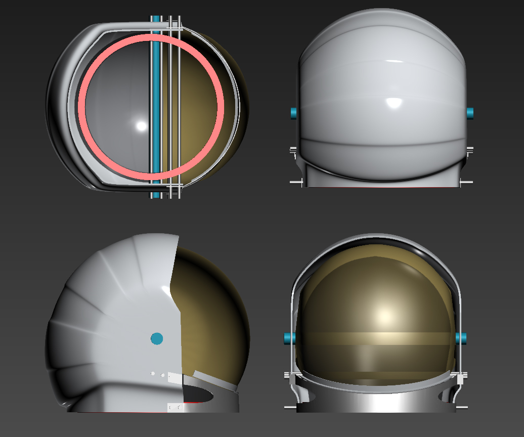

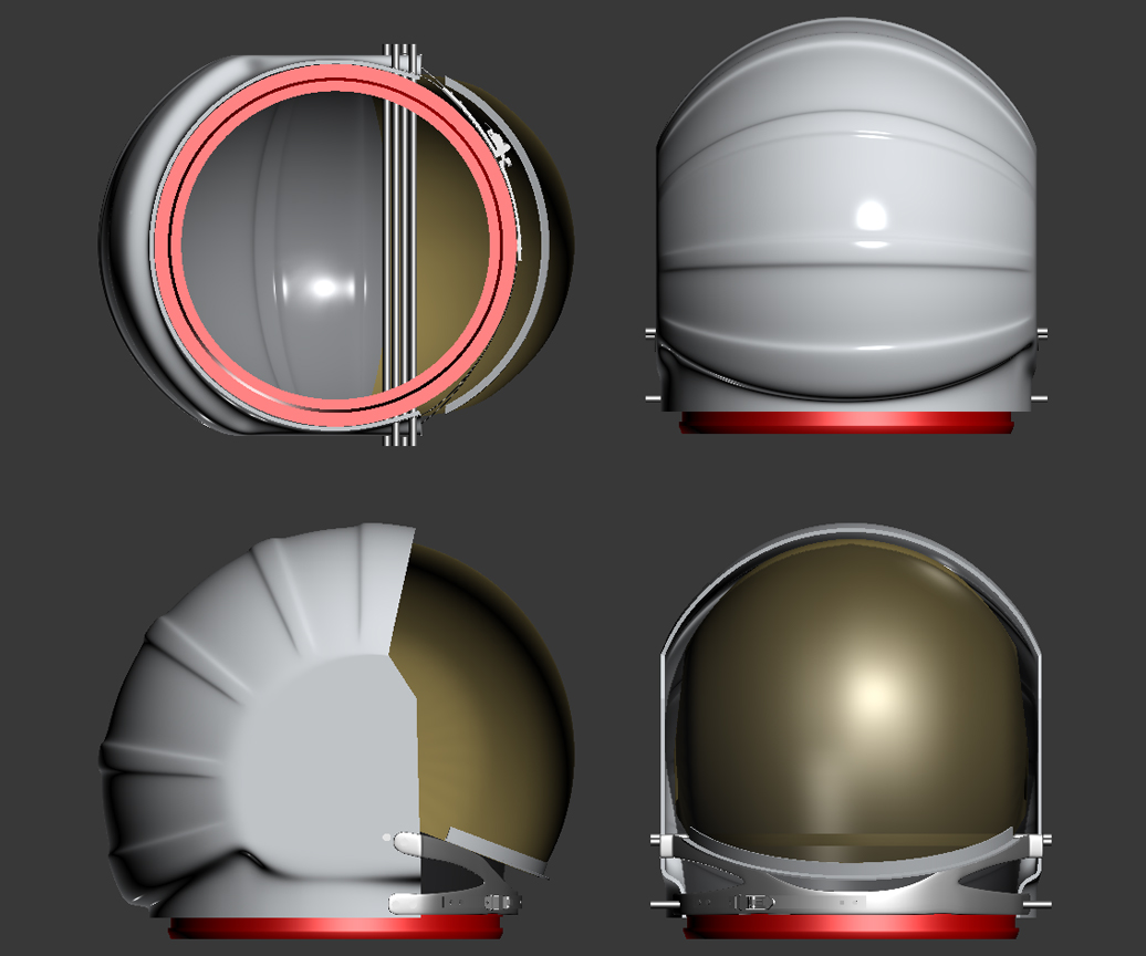

kenlandrum,
If I understand your drawing correctly, you have the bottom edge illustrated as a square profile with one radius'd side. The bottom flange on the LEVVA shell is circular, with a radius about 0.100" larger than the pressure bubble.
The LEVVA shell clamps over the pressure dome. There is clearance for rubber pads at the back to "grip" the dome. The stainless band in the front is also padded. That is why the .100" larger radius.
I knew it because I recognize the picture from a guy's website who used to work for you. It was in his portfolio and I found it on the internet a while back.
*Lunar Extra Vehicular Visor Assembly

Thanks for the feedback!
I made several other changes to the shell as well....
The step from the pressure helmet interface and the visor rest looks too small. The radius is only slightly larger than the bubble. It look like you have made it larger than the helmet side of the disconnect.
Here are some dimensions:
Suit side disconnect- ID 9.900"
Bubble helmet OD at disconnect- 9.415"
Helmet side disconnect ID- 10.350 (flange) / OD- 10.350"
