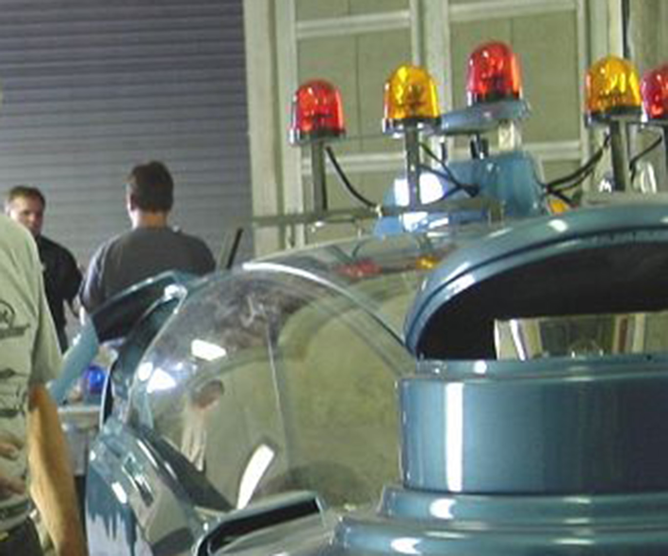

I'm actually just looking forward to working out the lighting. I made a revolving light for a 6-th scale loader years ago but the servo was hidden in the body. I'm not sure I can do them on all the top lights maybe just the middle on. I have to say i'm enjoying this project.
May be able to help out - I've been experimenting with LEDs to simulate rotating beacons- just published some results here http://www.antsnest.net/blog/?p=516

Fantastic work by the way![/QUOTE] this looks great . what would realy sell this effect is putting it in a hollow resin yellow ( vac form ) cover, so you see the light reflecting . That would make the rotation read better. lovely job .

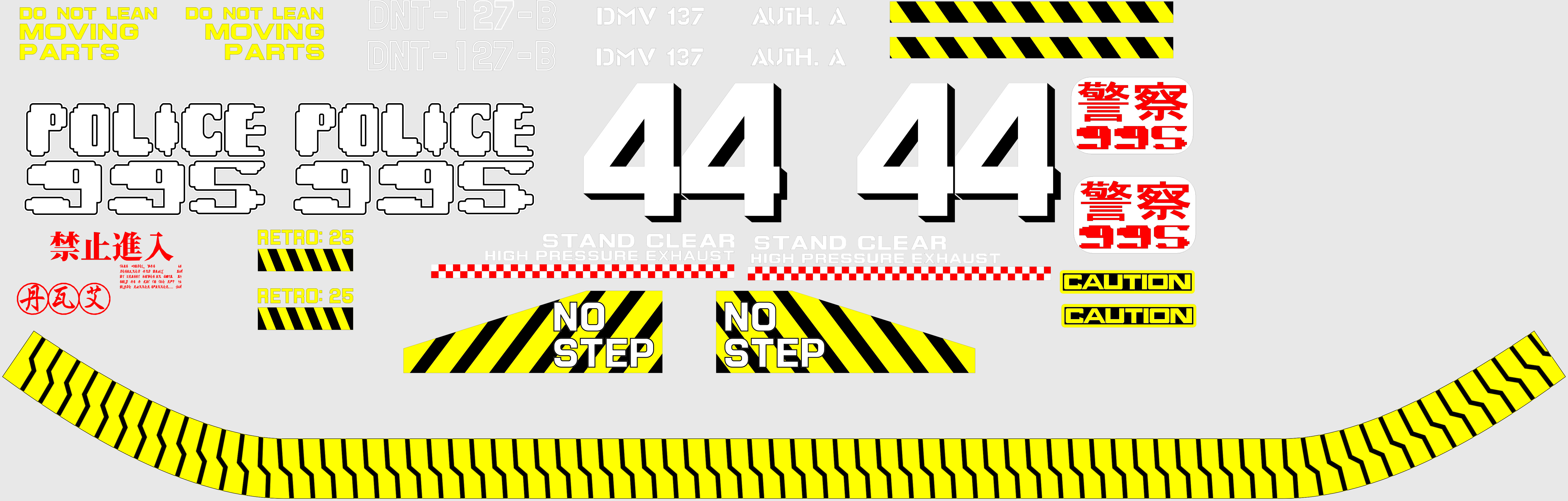

BRS- stickers 3.jpg I couldn't just blow up the stickers from the 1/24 kit because they just wouldn't hold up. So I decided to draw them from scratch in illustrator, only problem was I could not find any of the fonts, So i took a deep breath and hand drew them all. I have had to use a bit of creative license on the window sticker as the only reference I have is blurry.BRS sticker.jpg
Looking good (I like the effort of doing it all by hand:)) Mike is right, Microgramma Bold Extended is the right font.

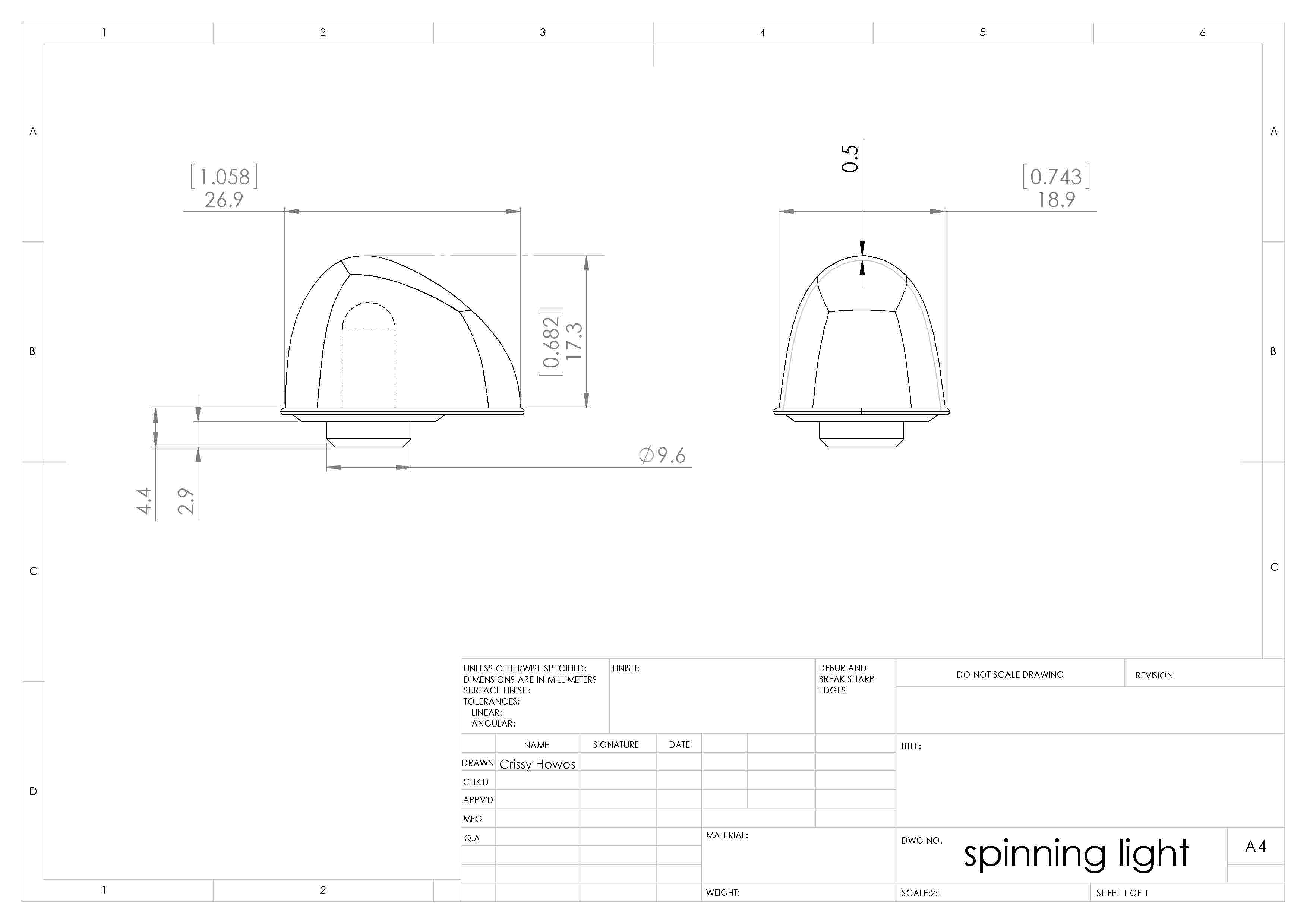

spinning light.JPG I sudenly thought I should give you the dimensions of the lights just incase this thing ever gets of the ground. you never know. :) . Your video is fantastic at half the speed this would really work.
Is the dotted dome in the side profile the hole in the lamp or is the whole thing hollow? If it's the hole, what's the diameter?
Been working on a couple of methods for getting 6 LEDsinto the unit which will give an even smoother effect...

the dotted line is just to represent where the bulb would be the actual thing is going to be a .5mm vac form so theres quite a bit of room. The main problem will be how many wire will be needed . luckily all the wires on the set car are visible so wouldn't need to hide them.

OK That's not so bad then. There would need to be 5 wires for a 4-LED setup or 7 wires for 6. I'm using single core wire-wrap wire in my prototype which is very thin, you could twist all 5 into a single strand that's about 2mm dia.
