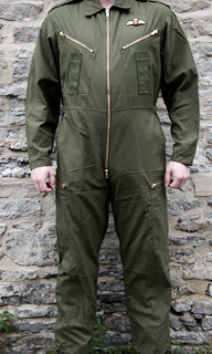

Hey everybody, long time lurker on this thread, but first time member/poster on therpf. I've been thinking about working on an Ash-style flight suit, which I don't think I've seen anyone else do before?
I found some information here, which shows the differences between Ash's flight suit and Ripley's:
http://www.propbay.com/original/ash-ian-holm-jumpsuit-costume-alien-1979-wardrobe-4612.html
The most evident difference are the sleeve laces. I've seen a ton of sleeve laces done for the MK3 Nostromo jacket, is anyone selling lace sets or are most people just making their own from twill tape?
Sub question -- it looks like Ash's mini-WY wings are green. Were Ripley's flight suit wings green as well?
Procuring a G4 flight suit is prohibitively expensive, so I was hoping that with some minor mods I could use a Canadian flight suit. The pockets and collar seemed to be a better match than the current US flight suit.
Finally, just eyeballing the photos of Ash's coveralls -- those look like 10" zippers/loops on the rear part of the flight suit? Can anyone who actually has a G4 confirm how long the lacing and zippers are? It's not going to be exact no matter what, but I'd like to get into the right ballpark.

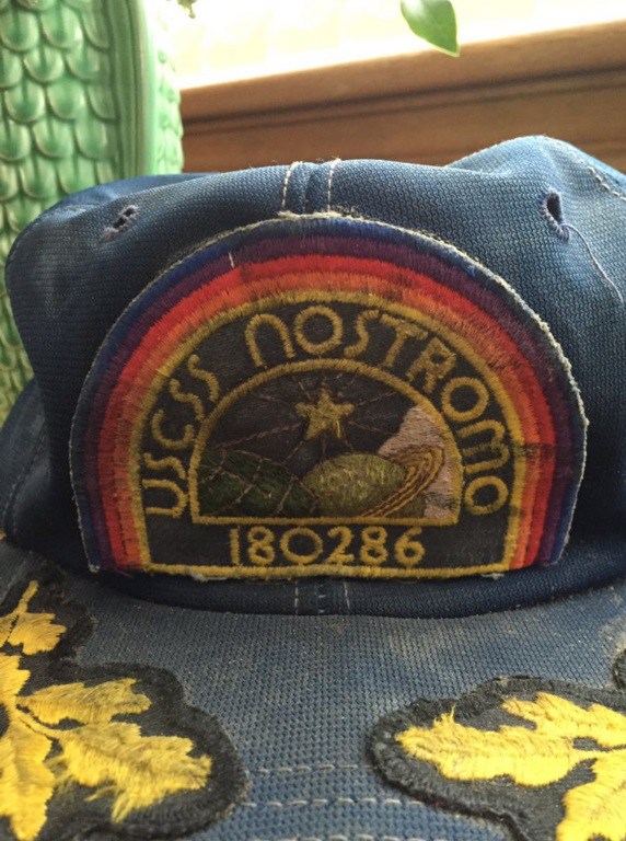

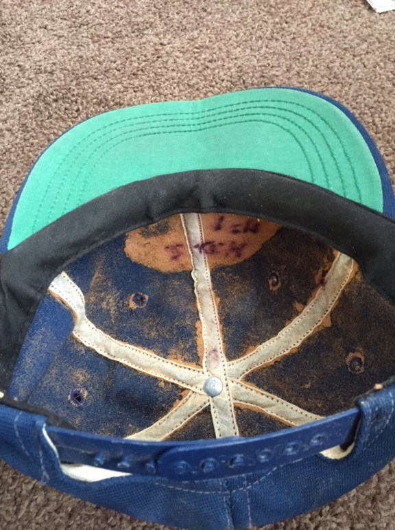

Don't know if you guys noticed this but a man from Dundee is trying to get the cap he bought authenticated as the (of many??) screen worn Brett cap. The photos have shown me more of the details that i was lacking when trying to pin down a good base cap for a replica.
So, appears to be:
Navy blue six panel, White stitching, Green under skip/peak, snap-back closure, Gold oak leaf on black.
Naturally the patch and oak leaf are easy enough but i am finding it hard to find a similar cap! Anybody got any leads on one?
EDIT: Well, who knew, it appears that the oak leaf/scrambled eggs are not just slightly varied but are in fact different for the depiction of which service your in and/or rank. SO, anyone know which actual type of Oak leaf is on Brett's cap?

If you can tell me an approximate time in the film where we get a good look at Brett's cap, I can get screencaps.
Until then, I have these stills. The white stitching makes me suspicious.
We get one clean frame of the special effects insert head's cap, which has a patch that looks like a color photocopy?
The 'scrambled eggs' appear to be the fancy kind; I think 'bullion' is the term for them, like the silver & gold 'wings' patches.
It is known that they used paper for the badge in that scene because the mechanics of the Alien jaw could not punch through a woven patch.

Draco: scrambled eggs on the cap are from an officer rank.

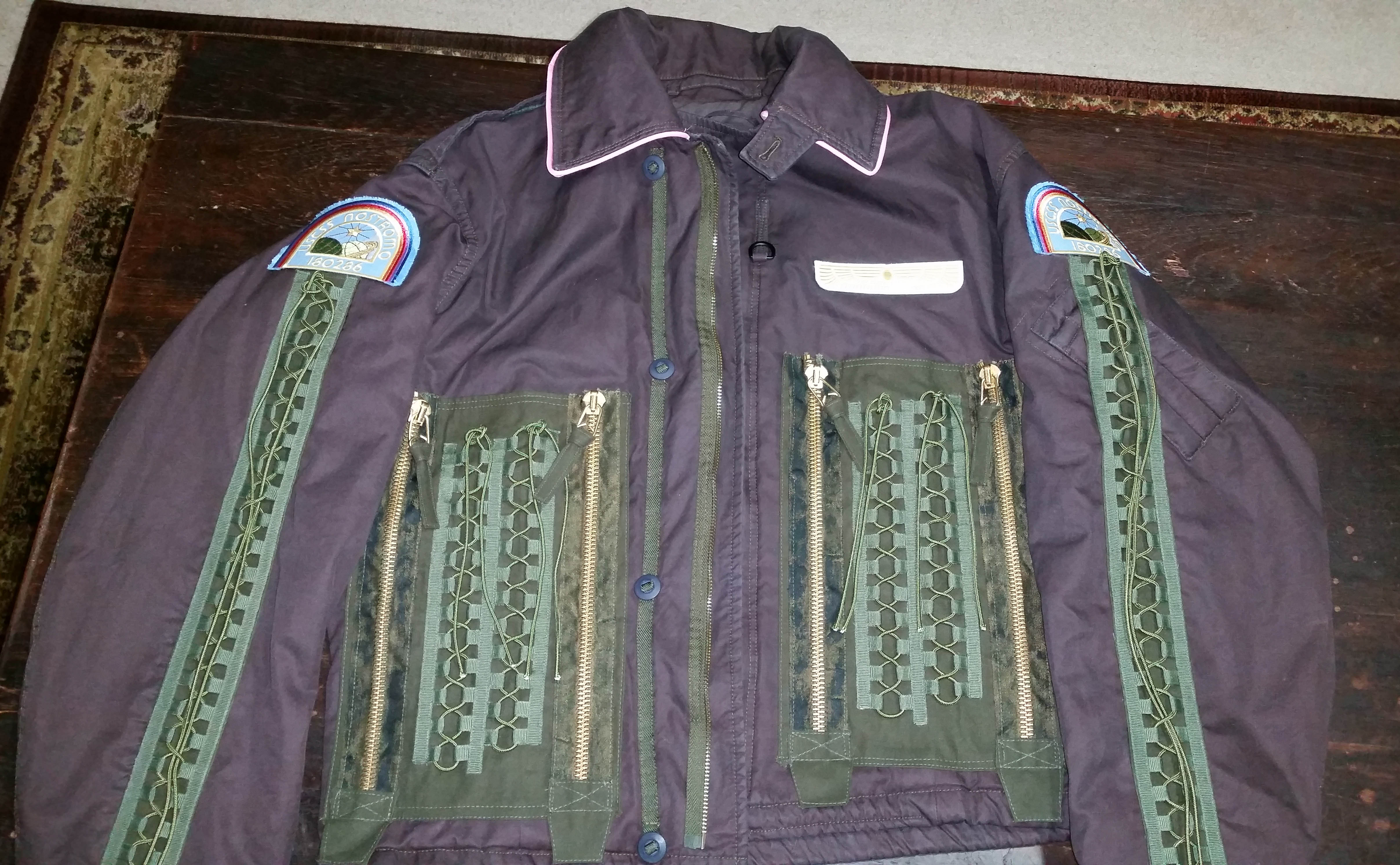

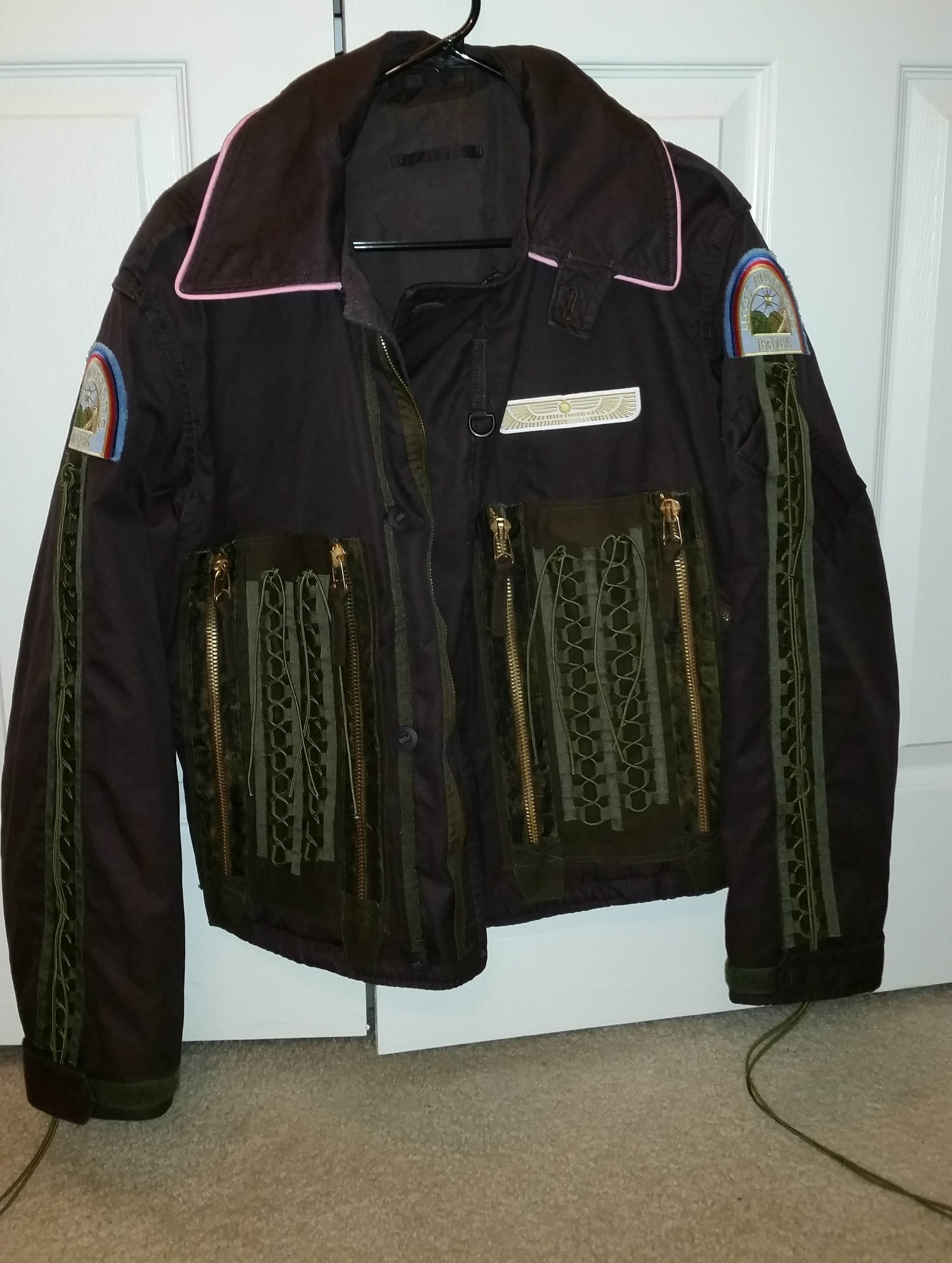

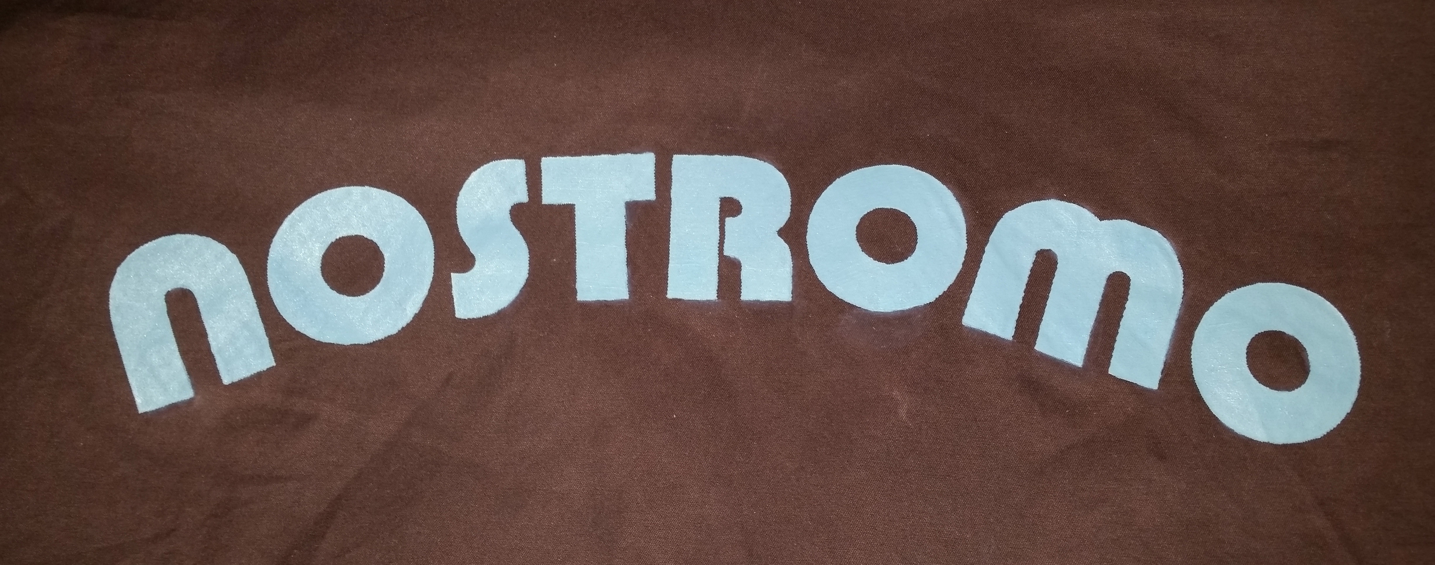

Here are some pics of my finished jacket. It was a little more challenging than I expected, but I'm satisfied with the results.
Special thanks to Banzai88 for the stencil. I used acrylic paint, and ended up with a lot of bleed out (due to lack of experience, I'm sure), but I was able to clean it up nicely.
View attachment 478085View attachment 478086View attachment 478087View attachment 478088View attachment 478089View attachment 478090

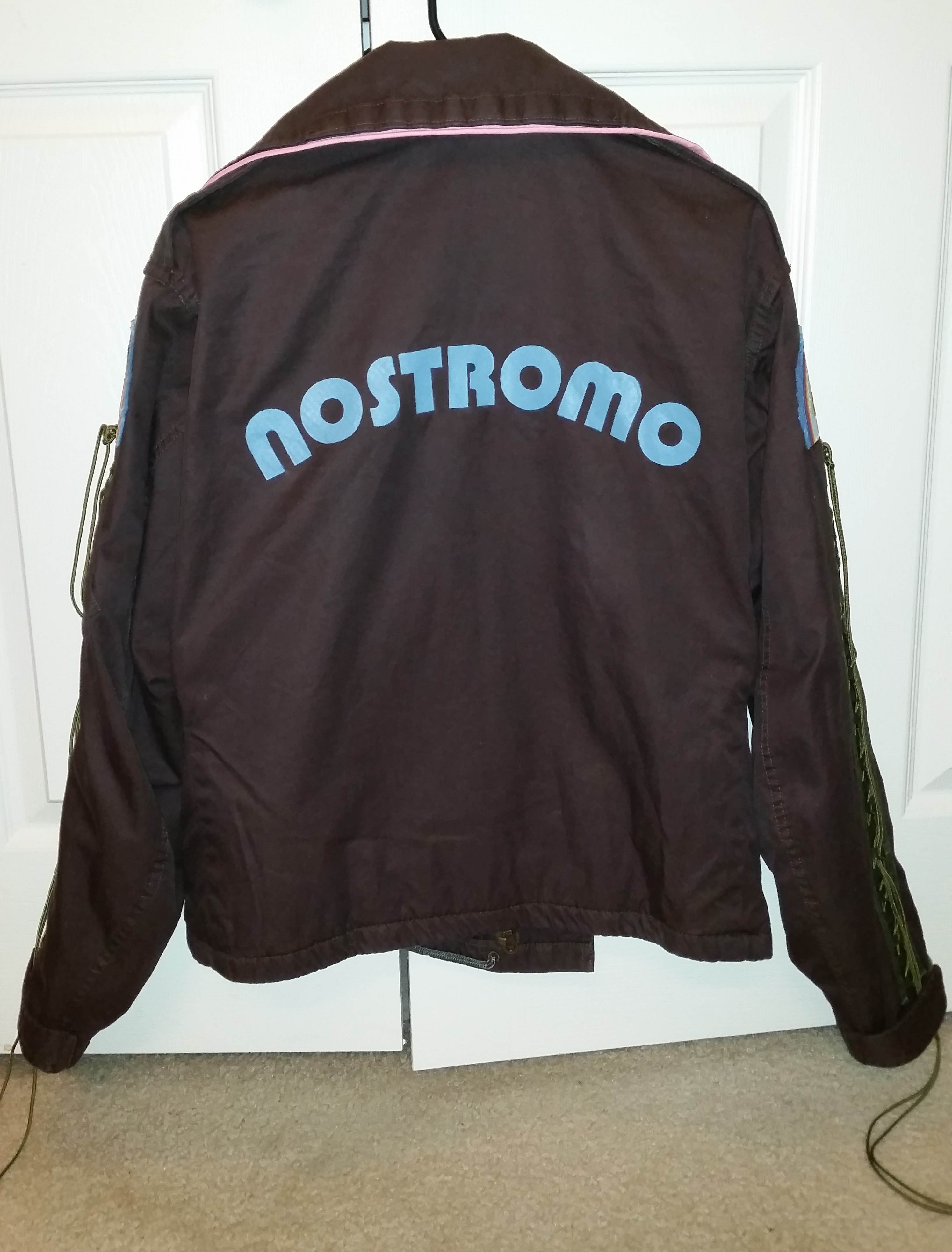

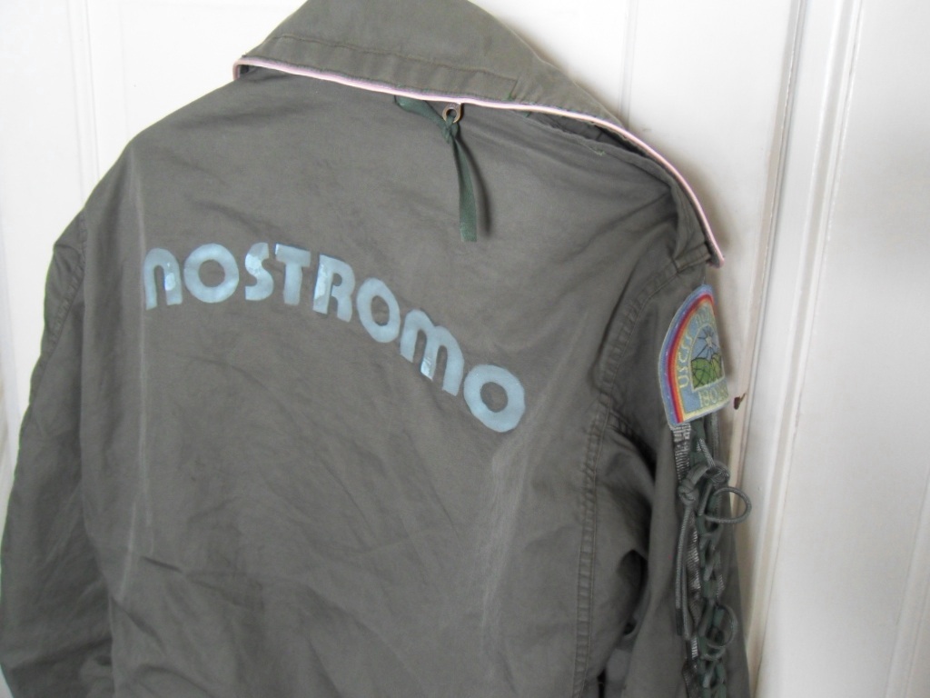

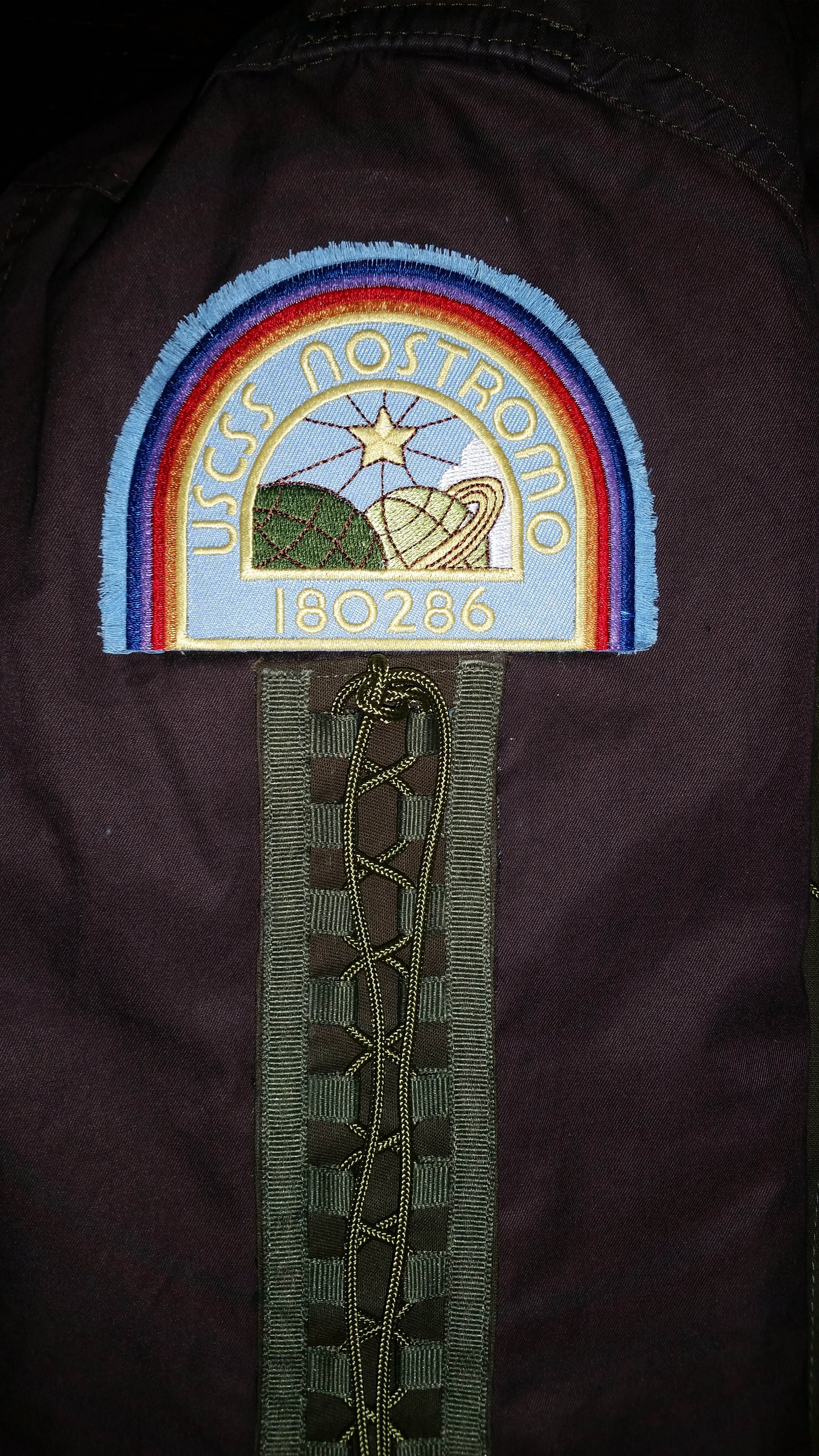

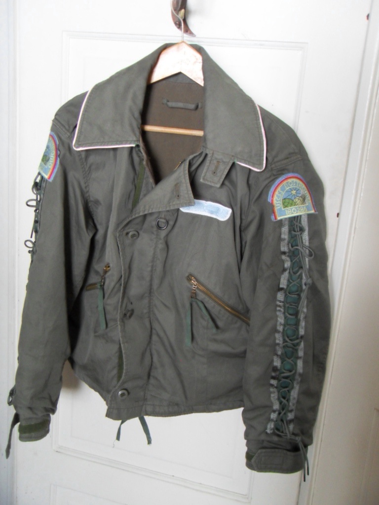

Hey all-
I recently finished my Nostromo jacket, Kane's version. I found the info on these pages to be a great help, so I thought I'd share photos of the finished item.
I started with the grey/green jacket. I made a few changes on the lacing panels as I didn't think the screen accurate panels were very convincing in person. Pilots wings are lithe blue from an Argentinian Ebay seller.
I had some trouble with my stencil, but since I was going for the "Battered Surplus" look I think its ok. I may work on that more at a later date.
I'm in the process of making a crew uniform shirt, but as for now I just wanted to share my results and thank the forum members for their help.
Nice job on this. The lettering looks fine; what do you feel went wrong with it?
I made my own stencil. I should have used hairspray or something to seal the fabric before applying paint. So it ran a little after spraying the paint. I used some model paint (Model Master RAF Dark Green was a perfect match, go figure) to cover where it had ran. Then I added a few blobs of the blue just to give it a distressed look. I had wanted it to be very light, faded looking. It's not bad, bt I think I can improve it.
But next is a crew shirt.

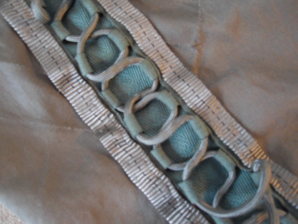

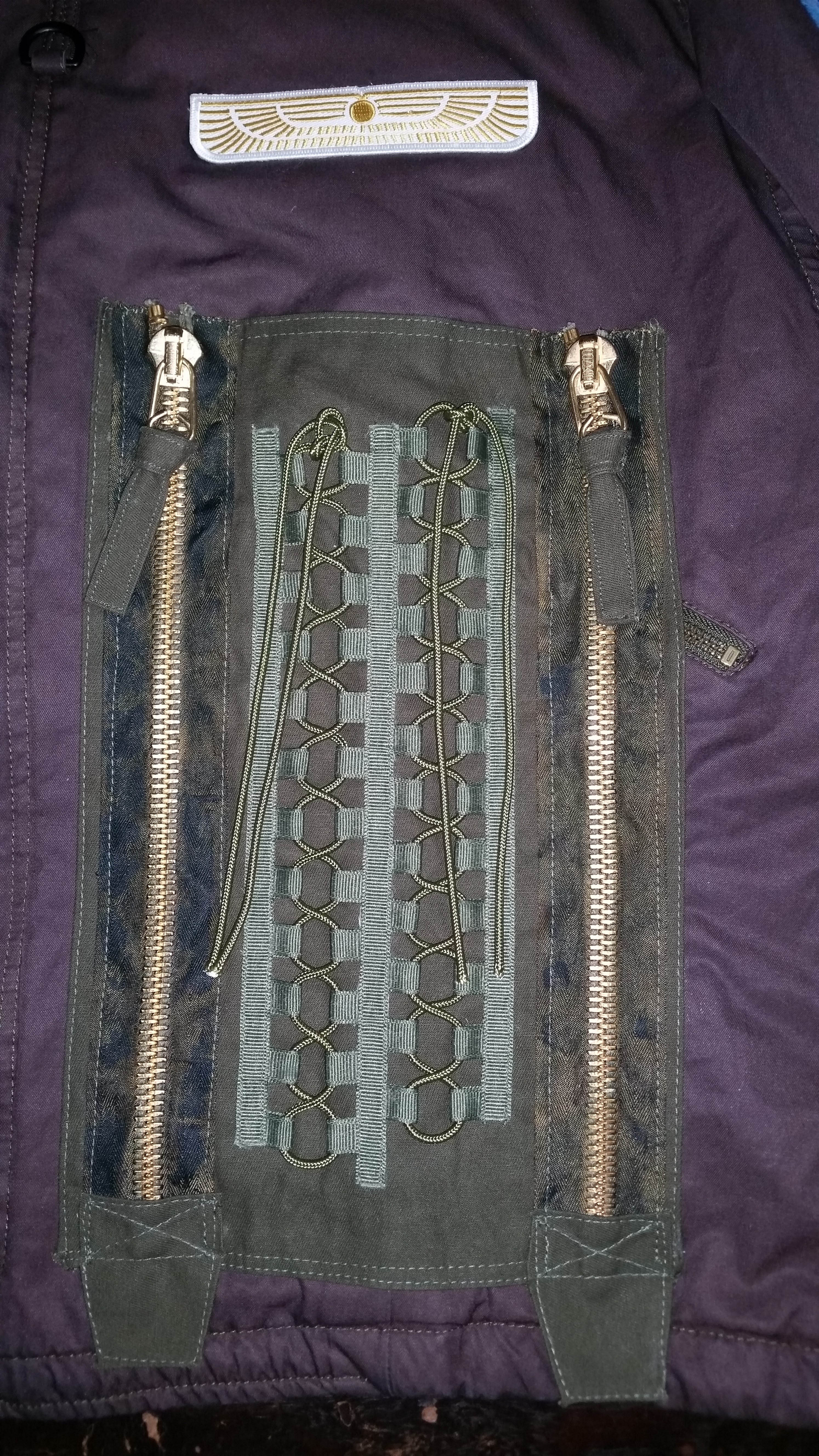

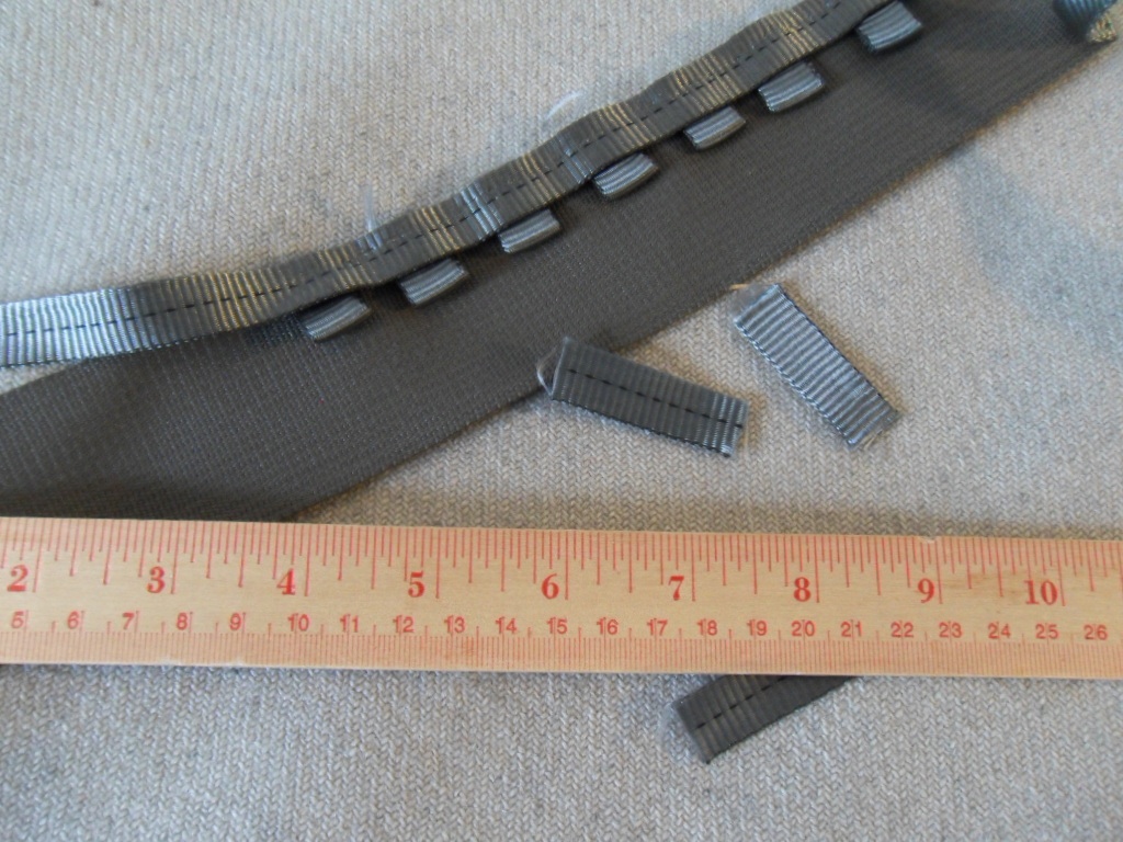

I'm sure it's covered on previous pages, but a quick photo instruction on the lace panels for the jackets. Fabric stores sell "cotton tape" in various widths and colors. It doesn't have an adhesive on it despite the name. I used 2" Sage Green cotton tape for the backing, and 1/2" cotton tape for the loops and edging. It looked a little drap, so I put an additional edge of 1/2" military nylon style webbing on top.The nylon is very slippery and tough to work with. Here's a close up photo:
Here's a photo of construction. This was a different set that I decided not to use, but it should show how it all goes together. I hand sewed all this, it took forever.
