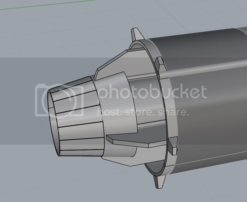

Just an FYI, if you used Stephan's files for the fins they are too long. The whole assembly only goes in so far before it rests on the cores. I needed to make new shorter ones so the nozzles didn't stick too far out of the back.
View attachment 680751View attachment 680755
If someone can give me some measurement from an original Y-wing, I'd be pleased to modify the file as soon as I'm back Home by the end of the month.
I did this one by eye between all the photos I have of the Red Jammer and the one from Mr Ladd.
The only measurements I can give is the distance the nozzles are supposed to stick out of the back. This is based off the old fashion way of enlarging the engine can to the correct diameter (which we know) in photoshop and using that measurement. If the measurement I came up with of 3/8 of an inch is correct that means the fins need to be 2 3/16 inches long in order for the assembly to rest on Dave's acrylic core and have the nozzle stick out the back the correct distance. If this makes any sense LOL. I think having the size of the actual studio model engine nozzle assemblies would be nice, but for the purposes of the Green Leader project and using the engine cores we have is probably the better call in this case because we don't want the nozzles to stick out too far or not enough. Just my opinion.
Something to take into consideration also is if the acrylic cores and the 3D printed ones that some used are the same size.
I just posted a STEP 3d model file of the entire Starboard Nacelle that can be used as reference for determining the length and shape of the nozzle fins... or at least my photo interpretation of them. Like Kokkari I based my dimensions on reverse engineering from photos. I used the Alan Ladd model as my primary photo reference. my dimensions are close to Kokkari's, certainly within the "margin of error". Keep in mind that there were variations between each model, including the trim length of the Saturn shell castings.
The file is in the Engine Nacelle folder in the Repository.

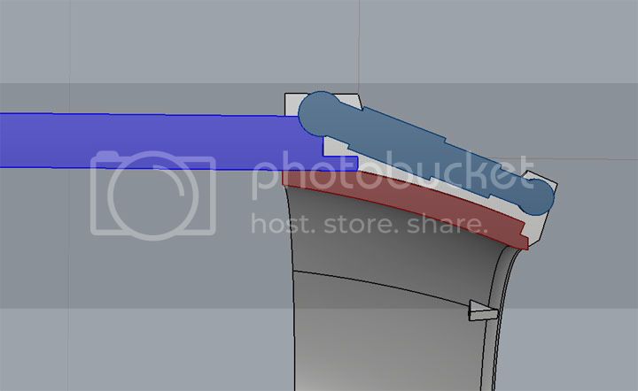

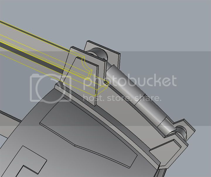

Here are some screen shots of how I intended the Tee struts and shroud to interface. I designed a flat 1/4" pad where the strut seats to give a little extra glueing surface. This will require notching the end of the strut back about 1/8" and cutting a curved notch into which the piston parts will seat. I too plan to cut the Tees to 13 1/2" long.
