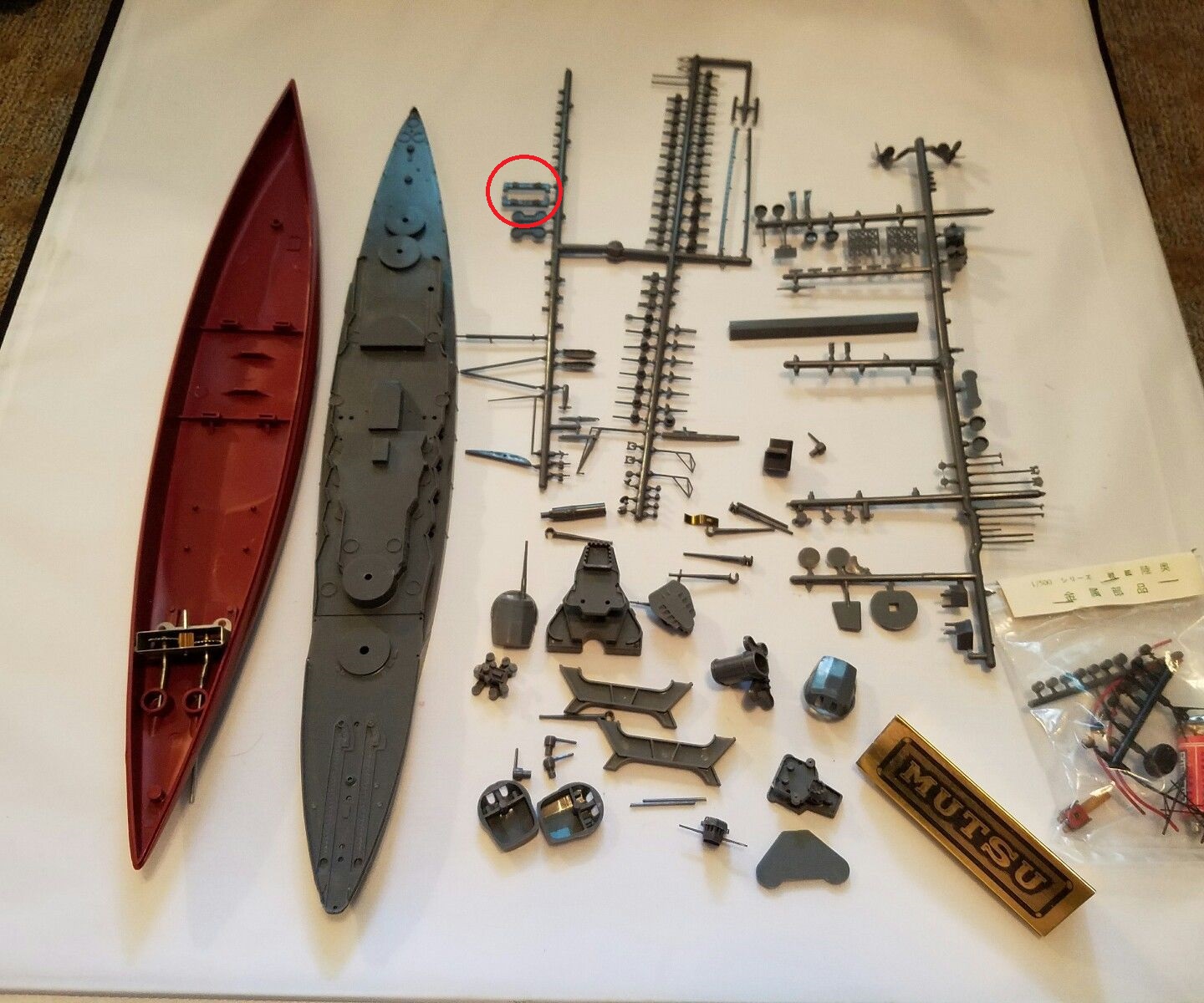

I'm searching for some parts that are unique to the Ladd right side wing/fuselage area. If we can ID these parts, then guys building this version will be able to complete it pretty well.
I have ID'd one of the parts so far. Any help would be appreciated. If anyone has castings available, I'd like to buy them. Thanks in advance.
Could this be the possible yellow part?
Not so sure about this one. I think it might be easy to scratch this one if it doesn't show up though.

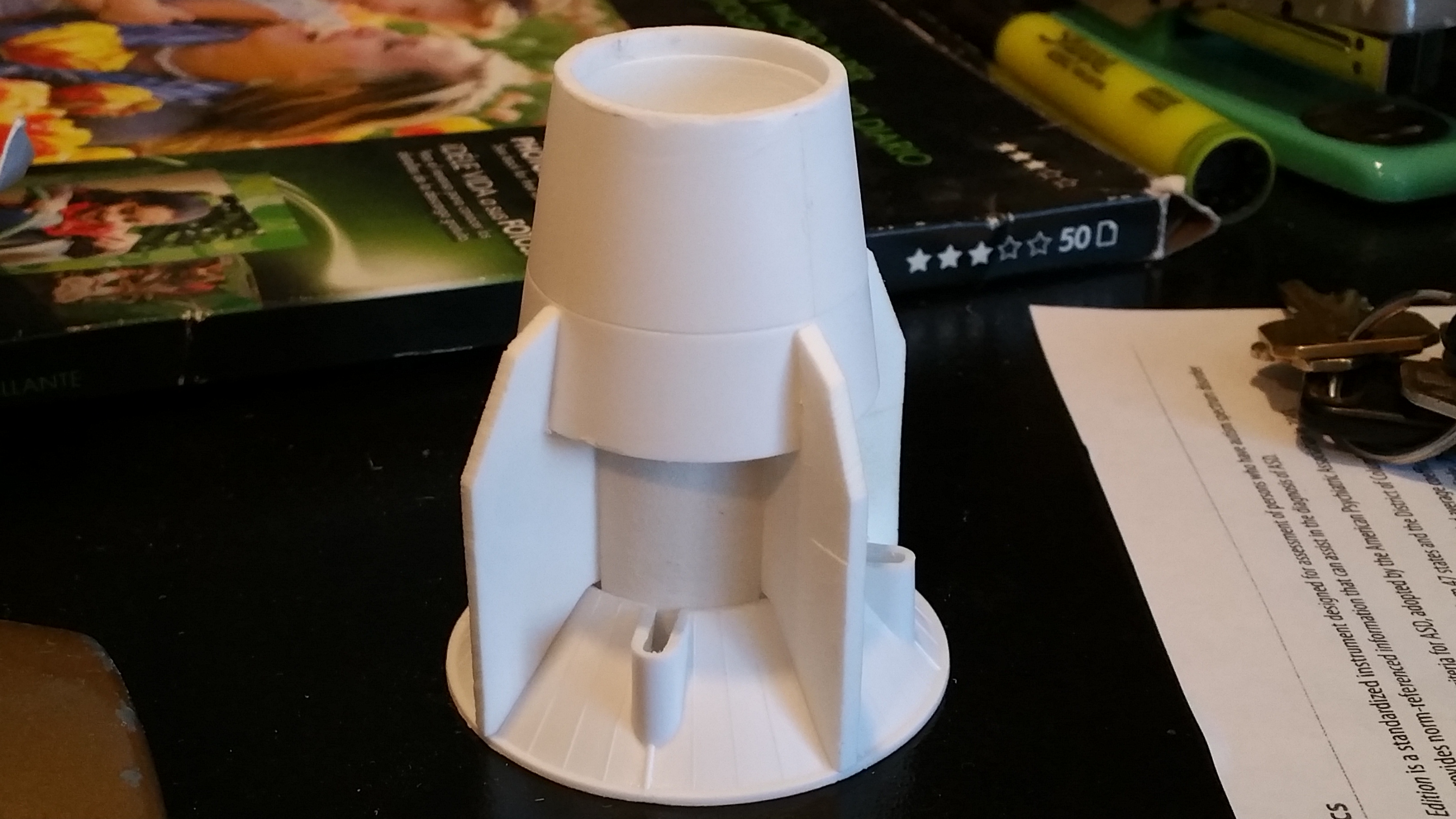

I have some questions about the parts shown in the attached jpg. For anyone who's reached this point on their projects.
First: I think I've seen that the correct height for the part on the left is to cut it to 11mm.
Second: The cone on the right doesn't seem to fit over the core cylinder, and seems to need cutting down. I don't know how far. Has anyone gotten past this point? And I don't see a line that's on the Y on the cone piece. It should go around the circumference of the part.
Thanks in advance for any help!
Your LEM shroud needs the ring that it sits on, then trim it from there. I don't know the measurement, I just eyeballed it so I can't give you a correct answer.
Found it. Thanks! I was just coming to the conclusion that it needed a third part.

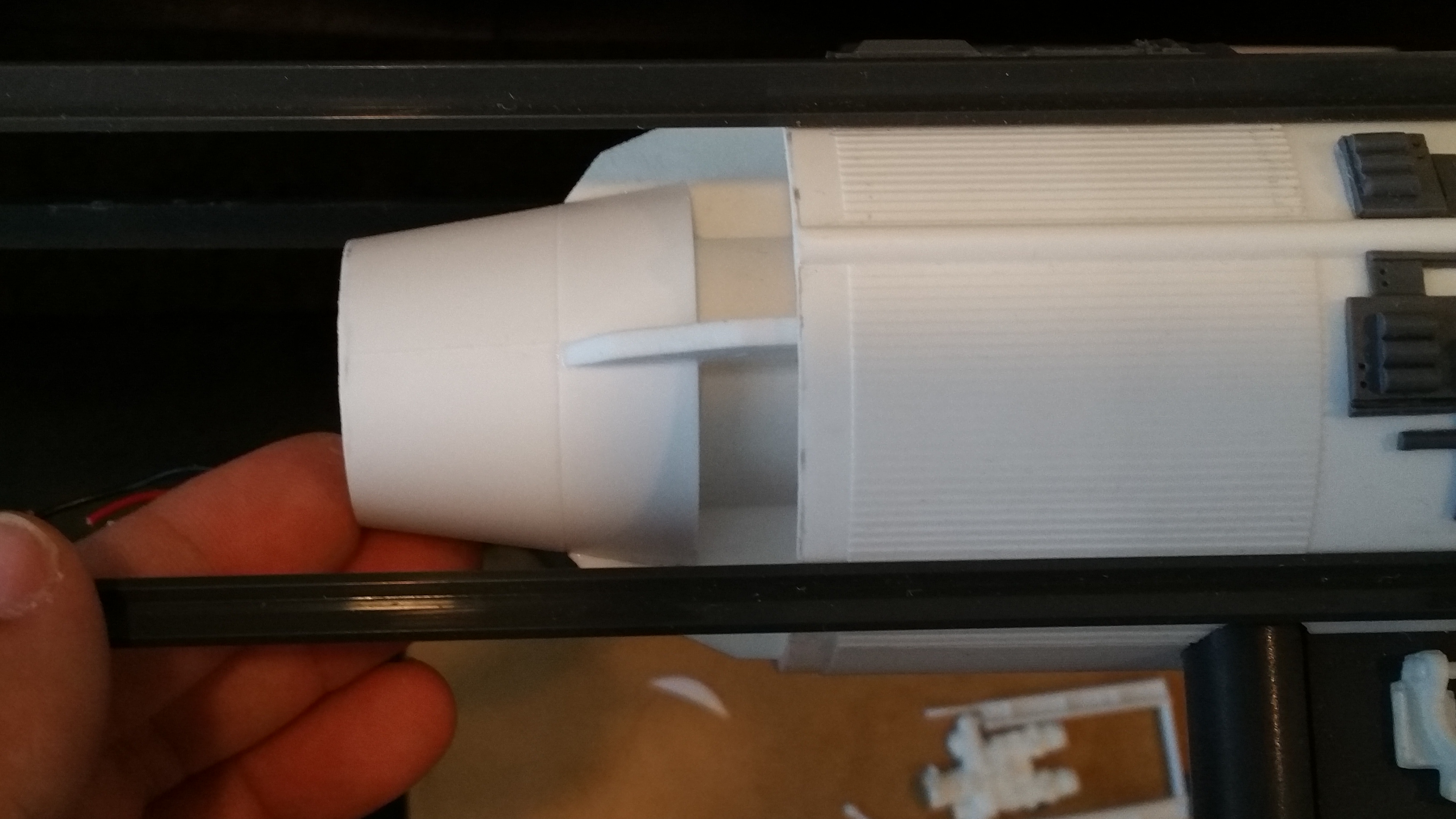

Just an FYI, if you used Stephan's files for the fins they are too long. The whole assembly only goes in so far before it rests on the cores. I needed to make new shorter ones so the nozzles didn't stick too far out of the back.
