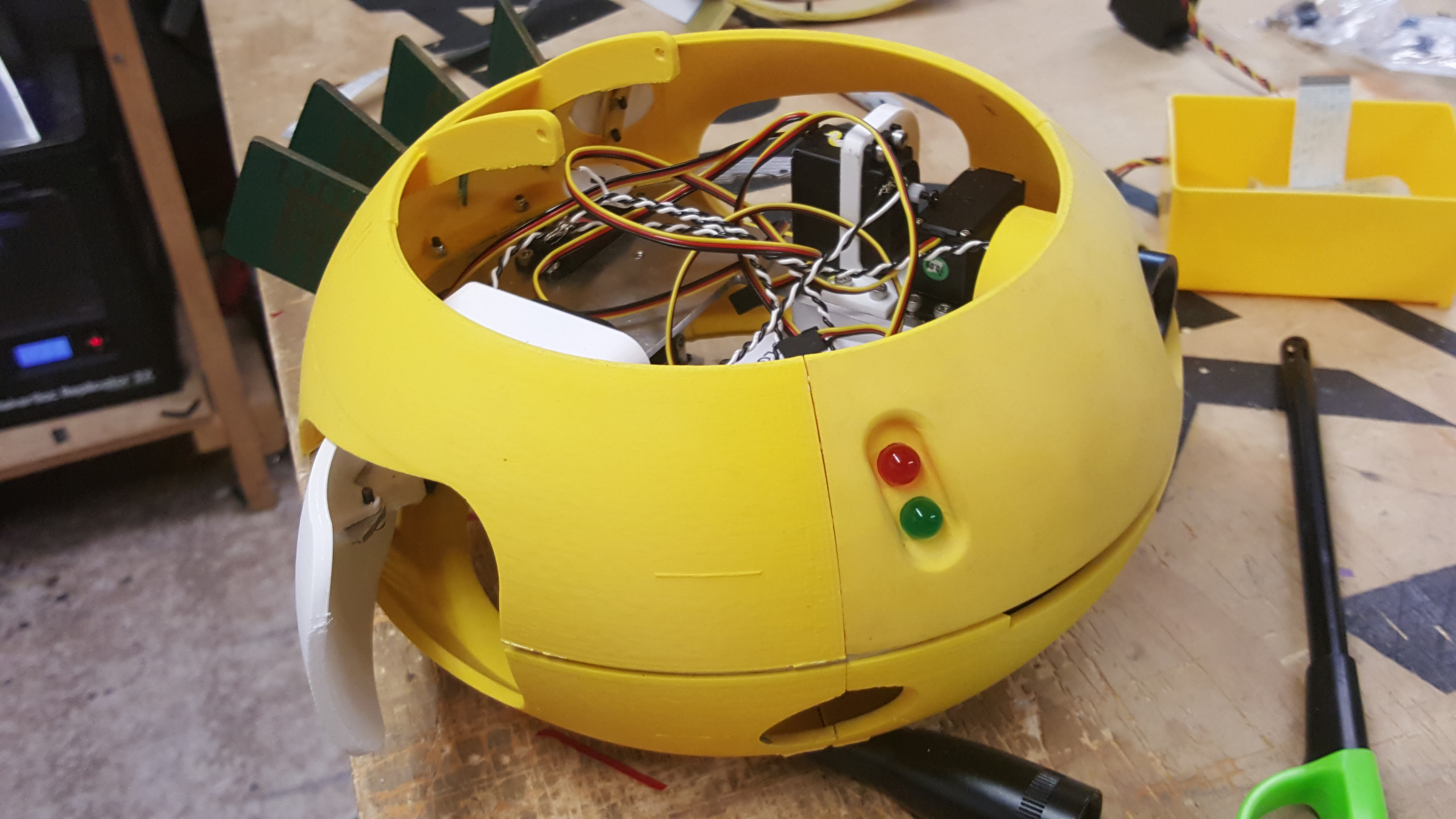

Here is some more updates. Getting servos installed before I start sanding and painting her up. Hope to have linkages installed tommorow/Thursday and have some video of parts moving.

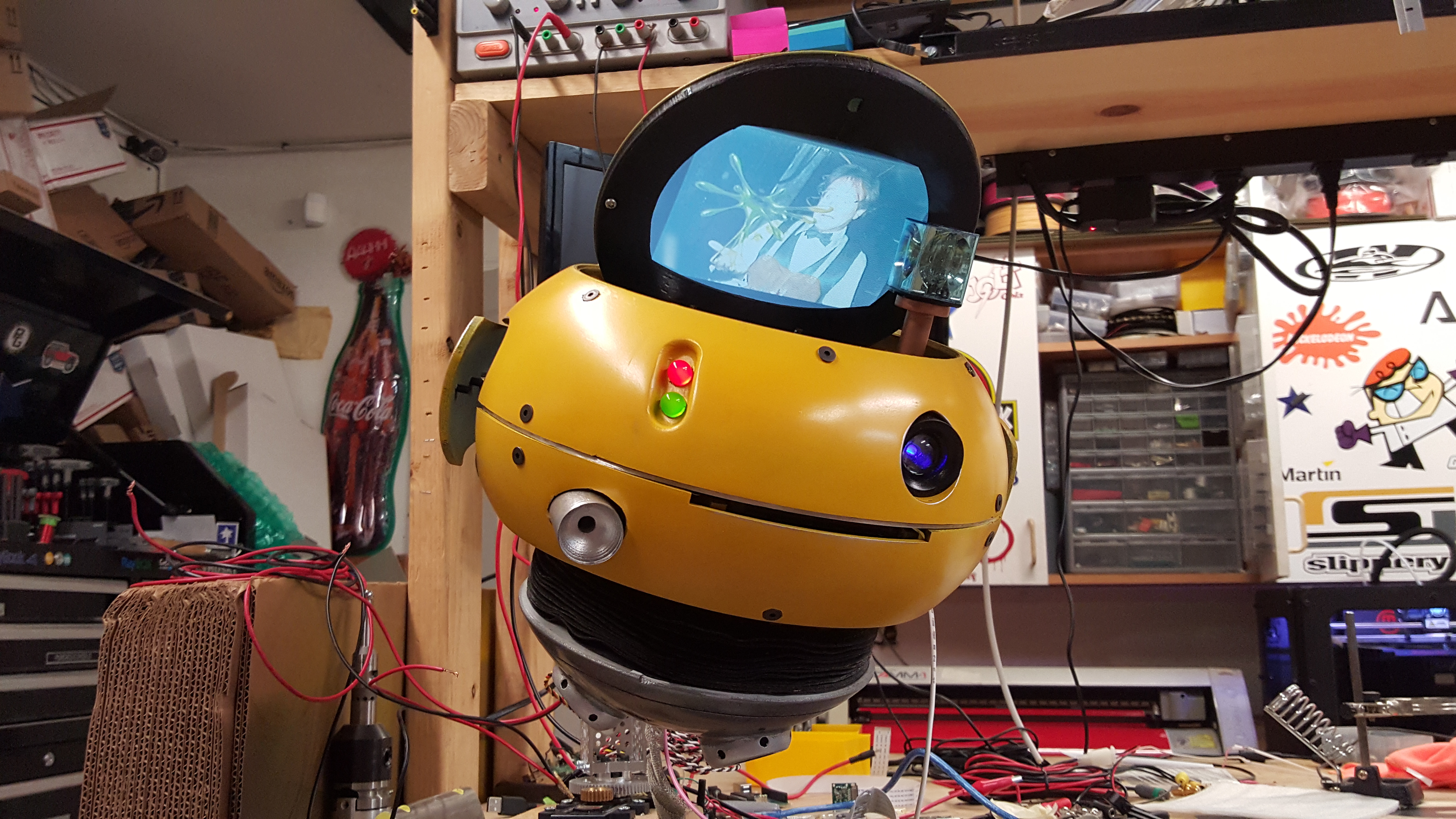

Well Weebo is Moving, Flying and Talking now! This is just a preliminary movement/audio test. Will need tuning to make her look more natural. But you can see how she moves, she moves right, leans into the turn, and her engines also move with the turn. She also tilts up and down to give the illusion as well. Also screen will be added in the next week or so..
this is coming out insanely good edsjunk!

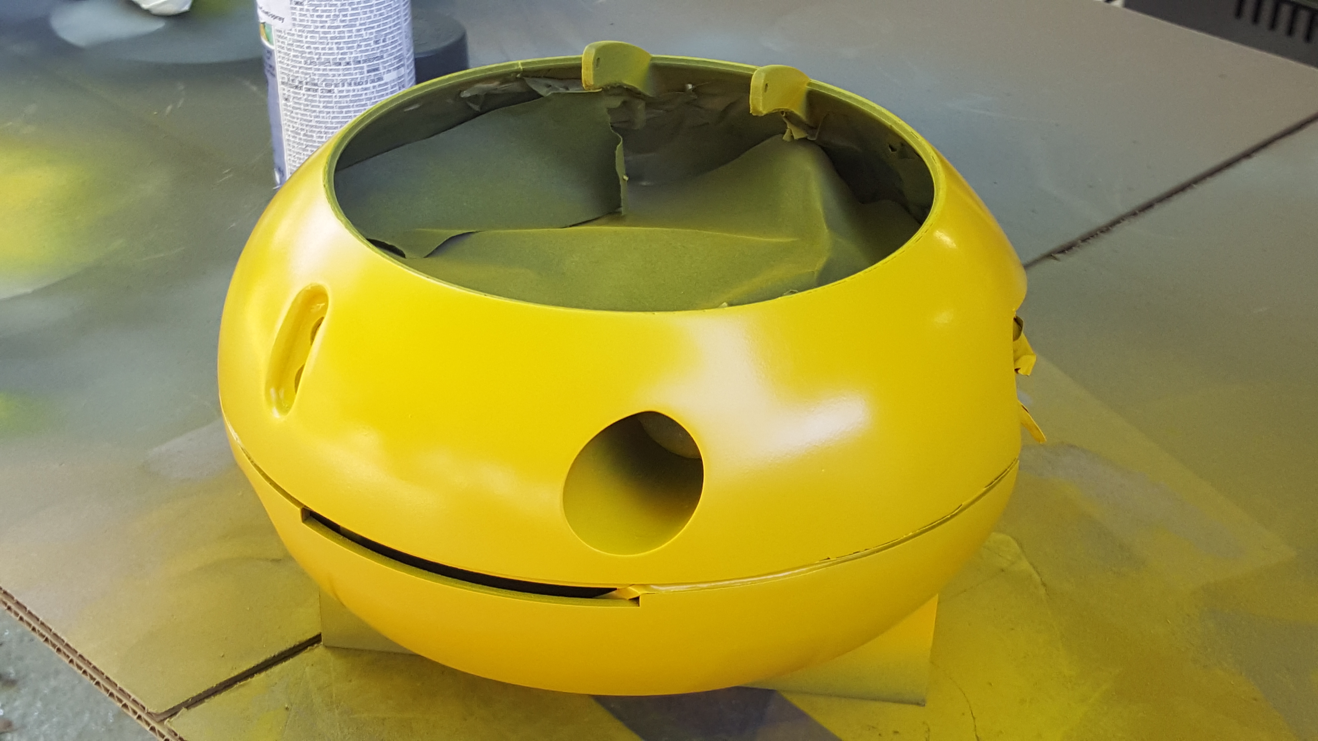

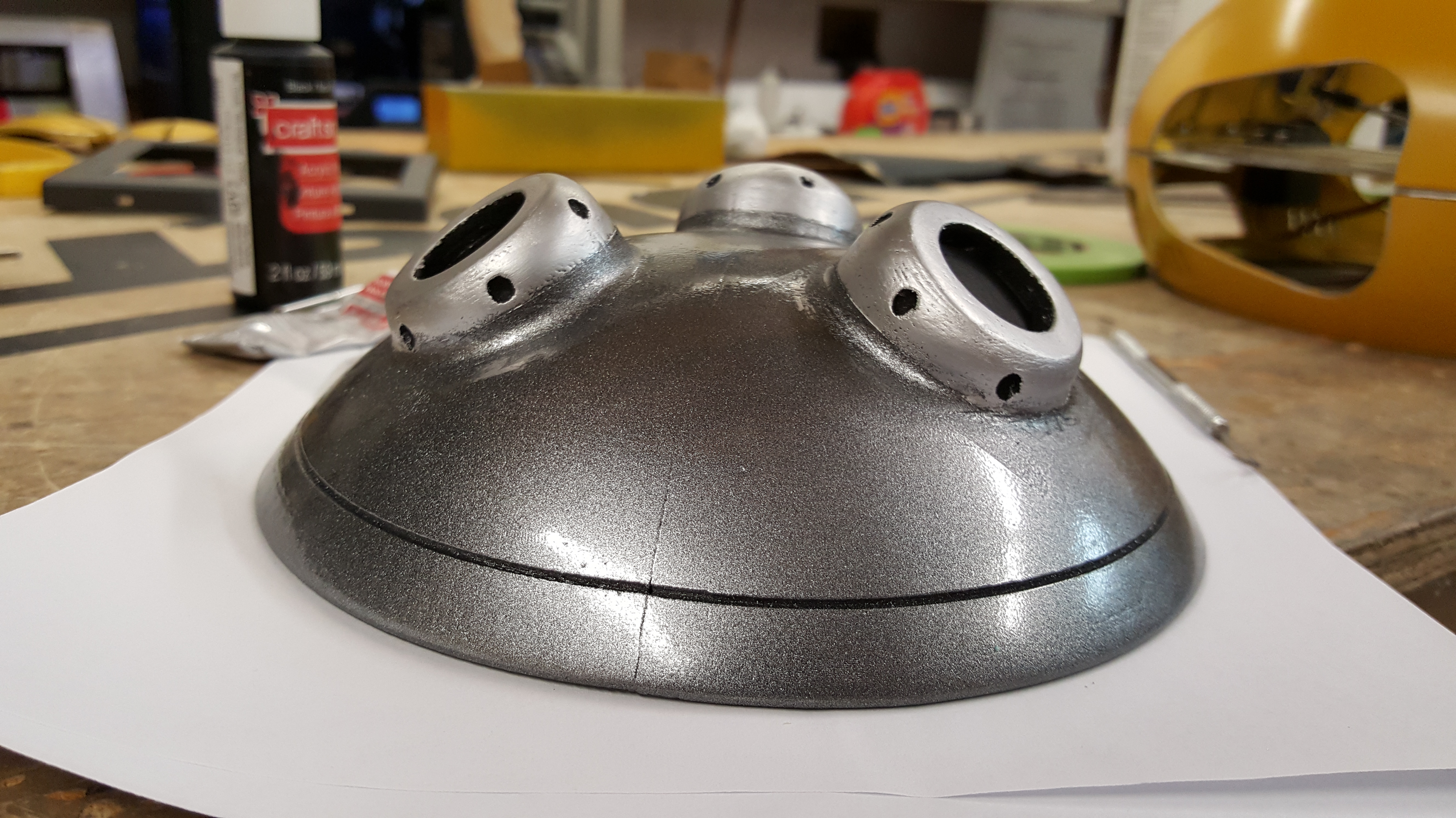

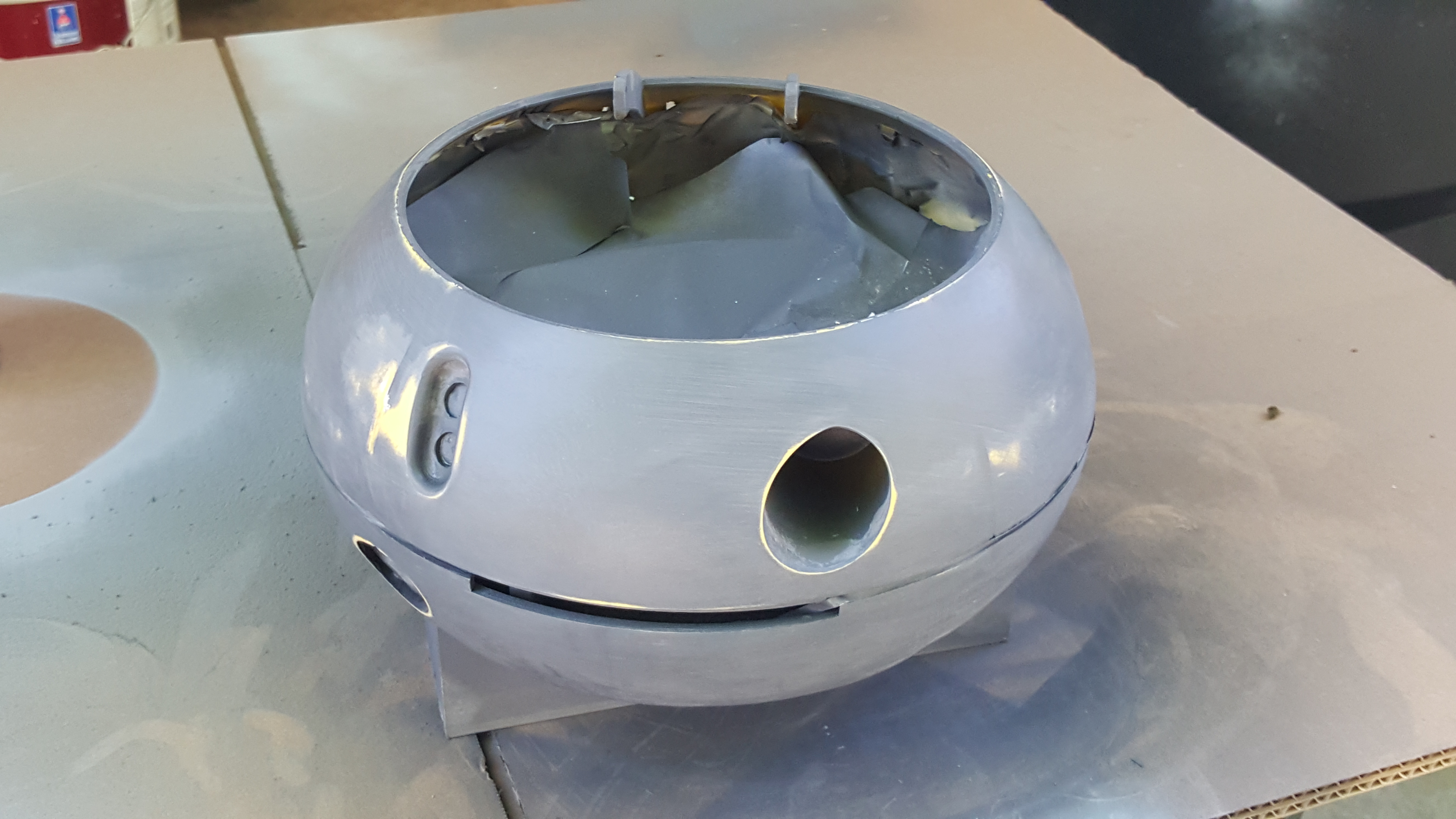

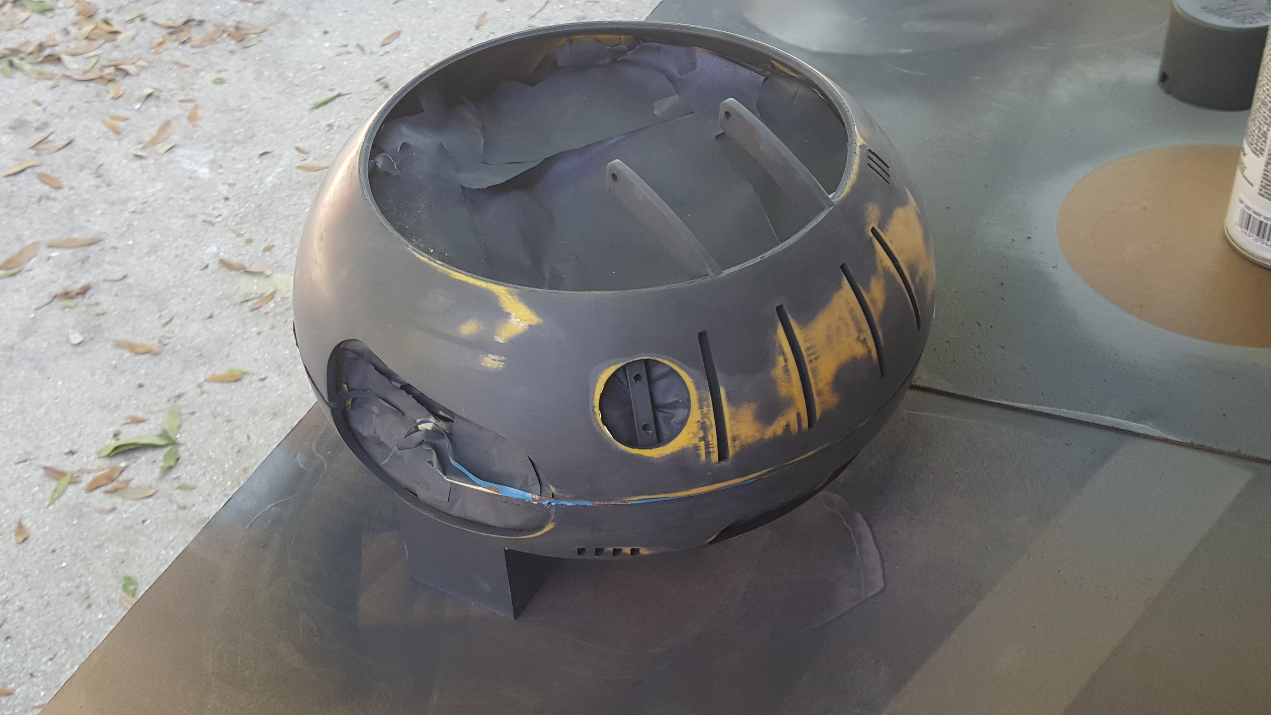

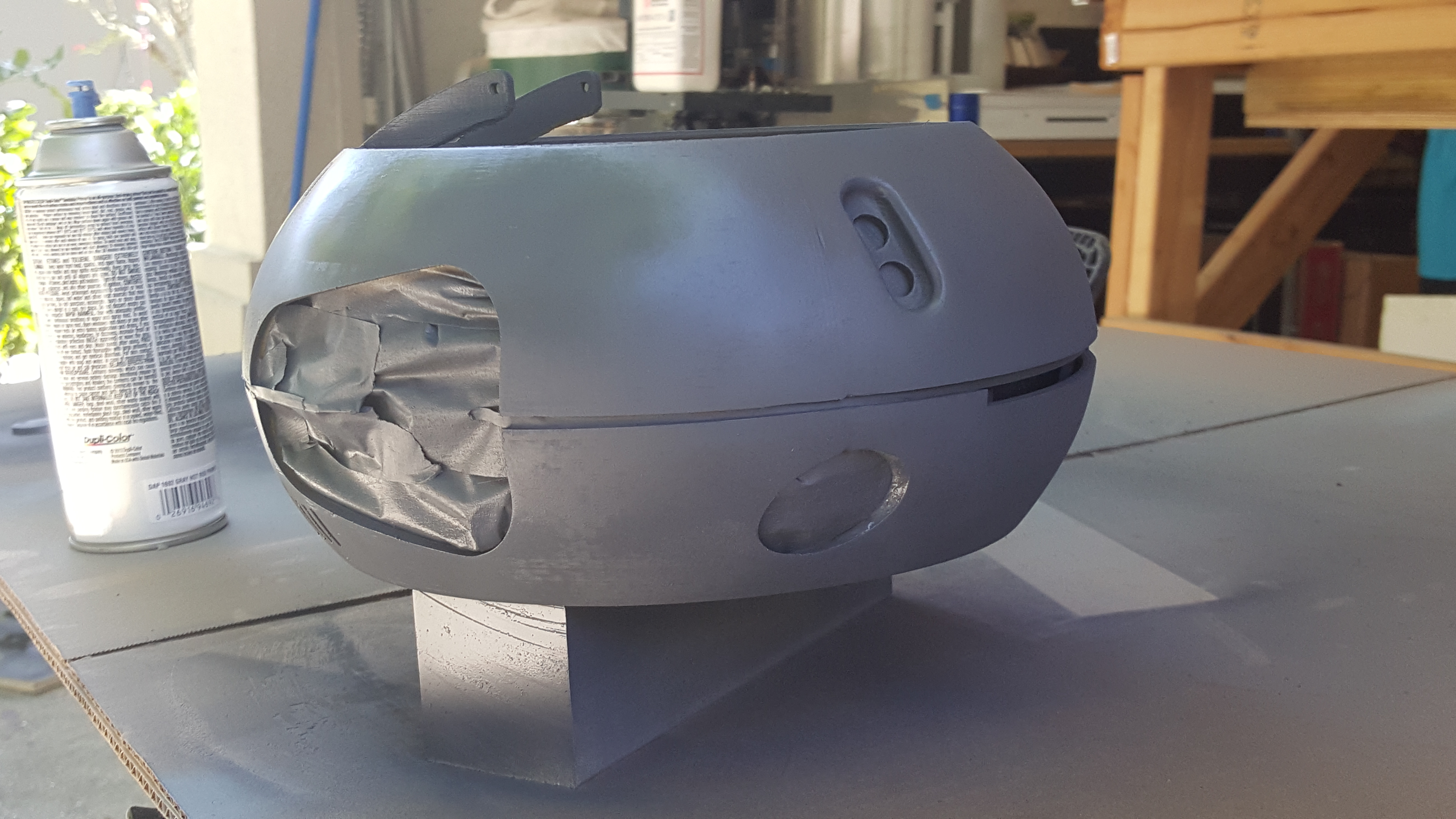

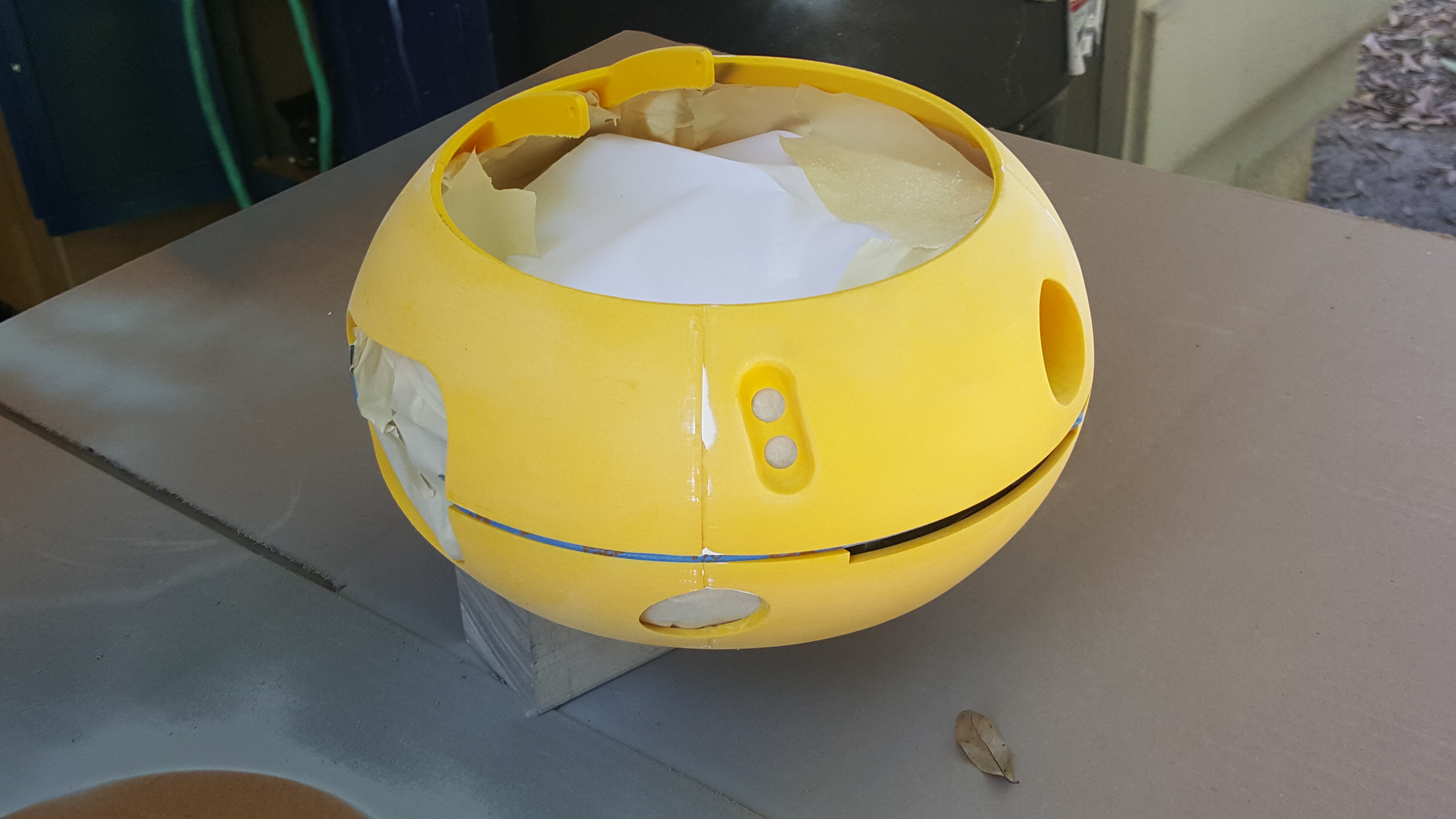

Here are a few photos of the painting process. I started by assembling the 3D print files to the base, then using CA Glue to hold them together along with screws. I then used a filler to fill all of the seams and sanded to a smooth finish. Then I applied primer and wet sanded to 1000 grit. Then I used Yellow automotive paint that was then covered by a Satin clear coat. Once dried, I weathered using silver rub-n-buff to give the illusion the yellow paint was wearing on the edges and the metal was showing through. Also used some black here and there for weathering.
2016-03-31 15.39.58.jpg2016-03-31 17.08.46.jpg2016-03-31 17.08.34.jpg2016-03-31 17.28.25.jpg
