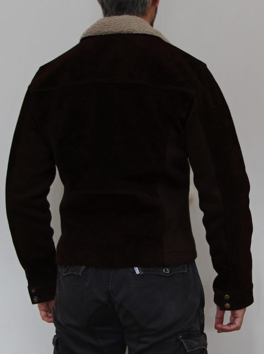

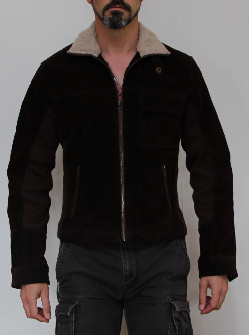

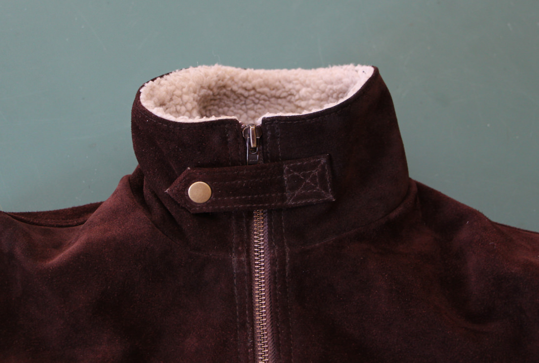

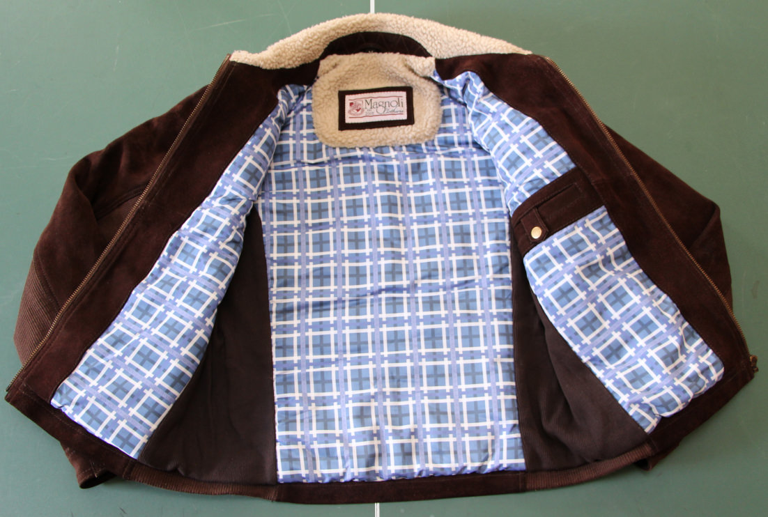

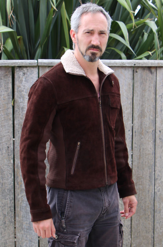

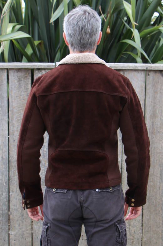

Ok guys... here's Prototype #1. I'm sure you'll have a few tweaks to suggest but, right off the bat it looks like the custom lining was made more blue than purple. All the following photos are straight out of the camera with no color or brightness correction. I thought it best to just leave them all "as is".
Indoors with a bounce-flash off the ceiling:
Indoors, bounce flash... quite low light (background is actually white, so that'll give you an idea of how dark the photo is):
Outdoors with quite a bit of light:

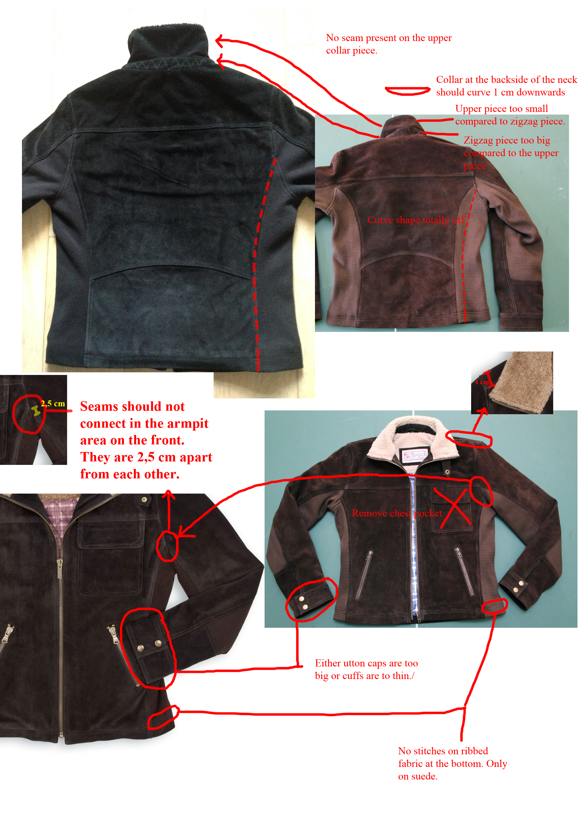

Ok, here it comes. I'm tired (no sleep, long day at work) so I hope everything I say is coherent enough.
I can't tell much about the overall model and shape at all as the measurements are apparently completely custom. What does seem to be the case is that the jacket is too short on you.
Remove chest pocket.
Seams sleeves should NOT join the chest seam. Way off.
Either button caps are too big or the cuff is too thin.
Button knobs/studs are too big. Something that's always bothering me with replica jackets.
Zipper size seems to be 5 instead of 8.

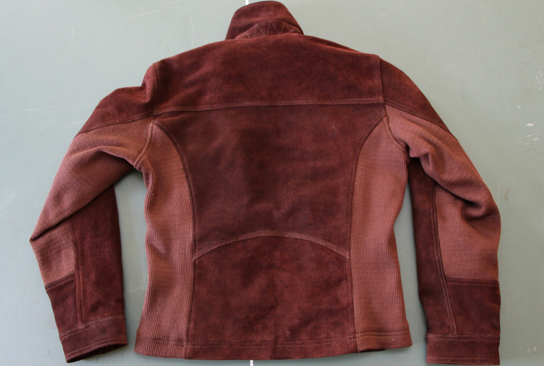

The ribs of the ribbed fabric are too big. Need finer knit. Ribbed fabric of the lining looks good. Ribbed fabric of the outer shell and the inner lining should be exactly the same.
Curves flaring outwards on the back are way too curvy. The shape is totally off.

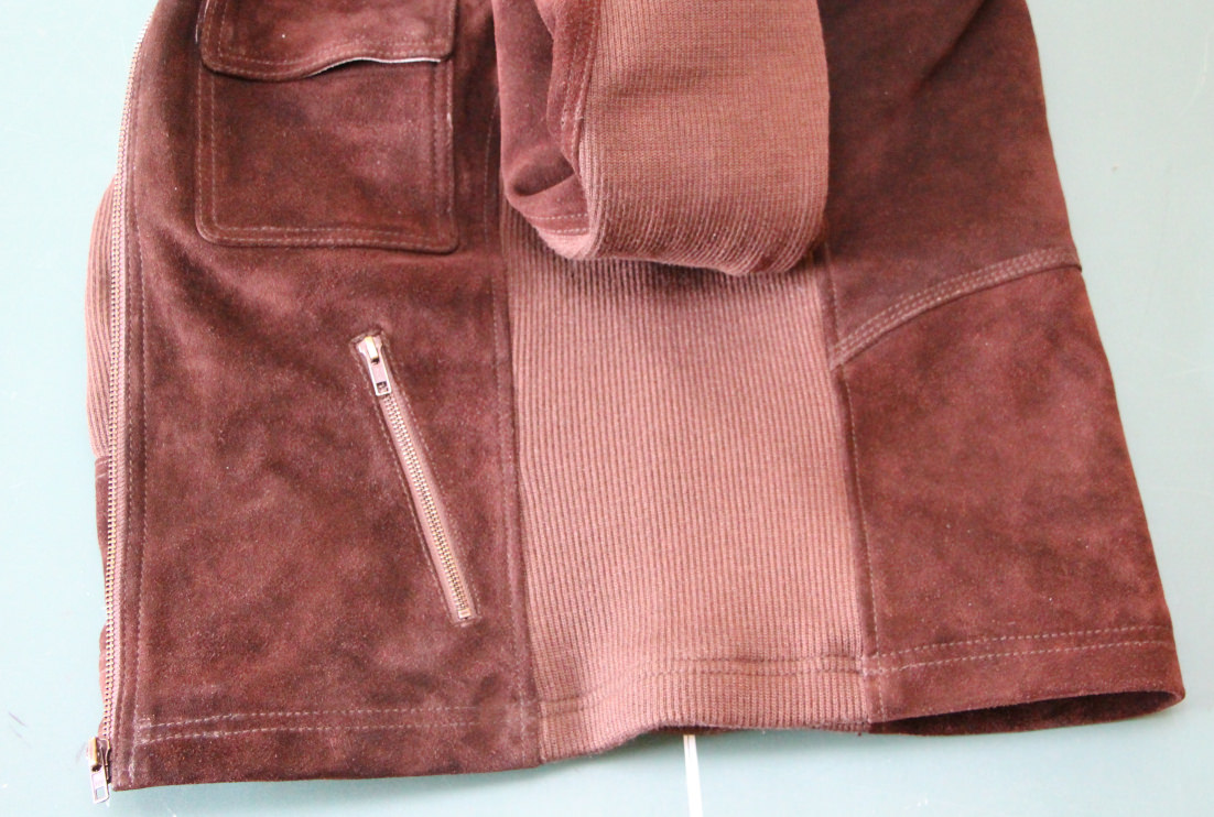

No stitches on the ribbed fabric at the bottom. Only on the suede.
It appears that the shoulder seam running from neck to shoulder/arm opening should be lower. (4 cm from fold line when laying flat).
Here are a few pics to back up my comments.
To be fair I don't know what to say or what to feel. I mean, literally everything has been documented and noted down, multiple original jackets have been photographed and measured to death and there is hardly anything left to document and still there are some very obvious mistakes that in my opinion are totally unnecessary. There are also some nice-looking bits but seeing as the original jacket is well-documented I kind of take that for granted. I know that it's 'merely' a prototype, but I hope you do get what I'm saying. I don't mean to be too harsh or blunt.
I can't say much about the colors. In the pictures the jacket looks quite a bit reddish brown. I would be happy to help out with the colors were it not for the fact that I'm still waiting like forever for something to arrive or even be sent to me...
View attachment 792739View attachment 792740

Yes, I'm aware of the fact that Indy applied changes in the middle of construction (different ribbed fabrics), but it was something that had to be noted nonetheless to be complete.
But I meant to be talking about the overall shape, the seams of the sleeves in the armpit section that connect to the torso in a completely different spot, the measurements and ratio of certain measurements compared to one another, the cuffs that look too thin/too short/button caps too close to each other etc. etc.
I think the whole problem of this is that it's using custom measurements to begin with, making it hard for us to judge whether the shape and measurements of the jacket are correct or not. I would say nail down the standard sizing first, use that as the basic model and from there apply the custom measurements that people may want when they order. Now it's a mash up of somewhat random measurements and shapes that we have to judge on its authentic look while it's using measurements that can actually change the whole model and shape of the jacket to begin with and thus interfere with the authentic look it tries to achieve.
Also, what I was trying to say is that everything is documented down to the very bone and every comment of what could be wrong with the jacket would basically just be copy-pasting what's already documented in the documents. I feel like repeating myself over and over again.
However I do have to say that it does look like it's quality stuff and well-constructed. And the things I didn't comment on should be regarded as perfectly fine. The lining does look nice, although it does look quite blue.

Totally agreed. So basically it comes down to what you mentioned above with the back curve along with increasing the area of the back suede, as well as the collar stitching, armpit seam and everything else you listed
Good eye on the tape color of the zipper, I could tell it was slightly different but wasn't sure if it was the shape or color. Also noted the pocket zippers seemed to be identical to the main zipper when they should be the M86A65 I think that's what we agreed was the most accurate one here's the link http://www.idealfastener.com/zippers/search/653/size:@08
I'm excited to see the next iteration hopefully with these changes implemented it should look spot on!
Working on v2 right now... thanks for all the input. Stay tuned! ;)
