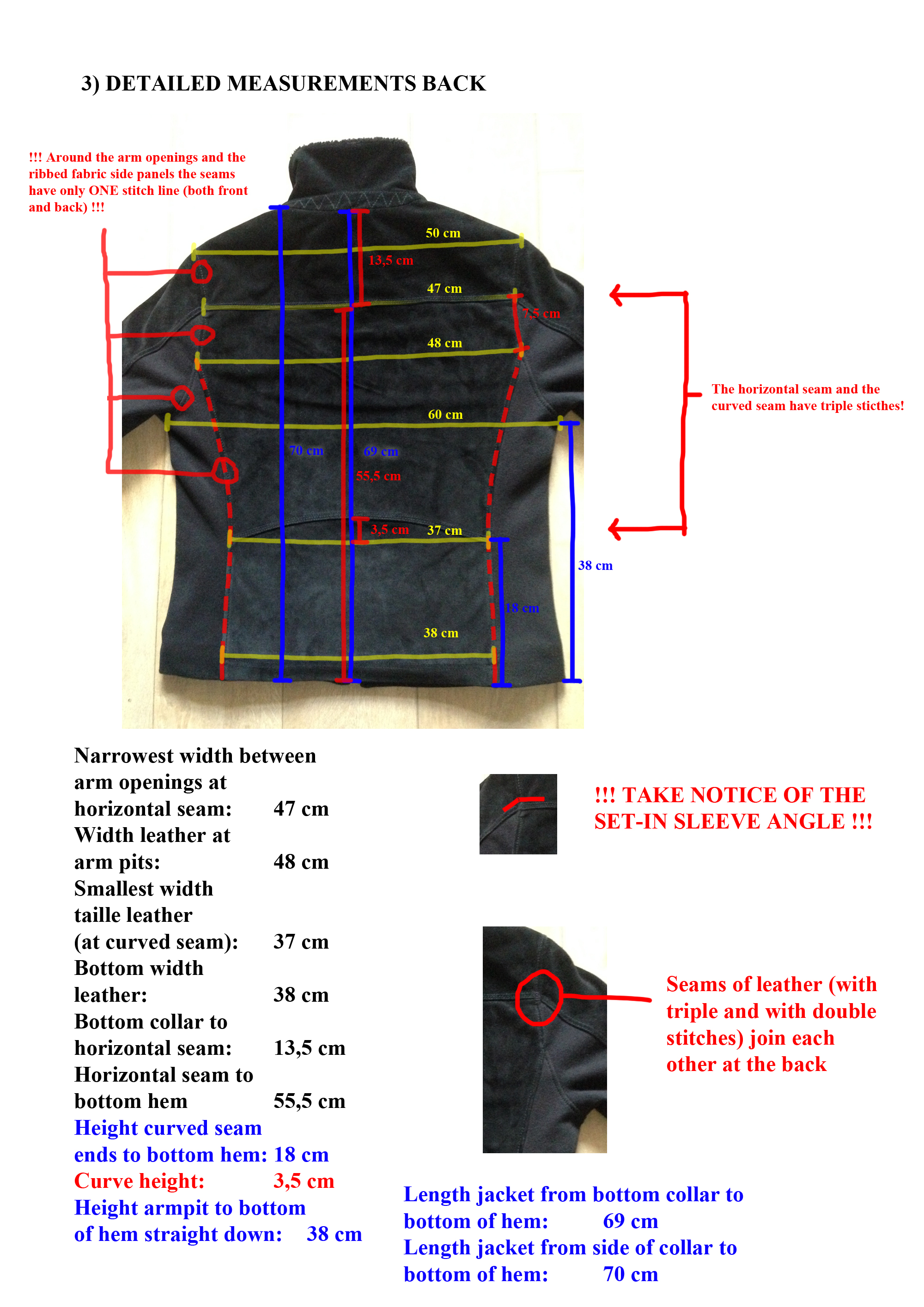

Not too bad. I know it's a bit premature to evaluate because we only have one picture to look at, but what I noticed so far on the teaser:
1) the curves are very curvy and the back suede leather part seems very slim towards the middle and the bottom and it flares out excessively when it reaches the armholes

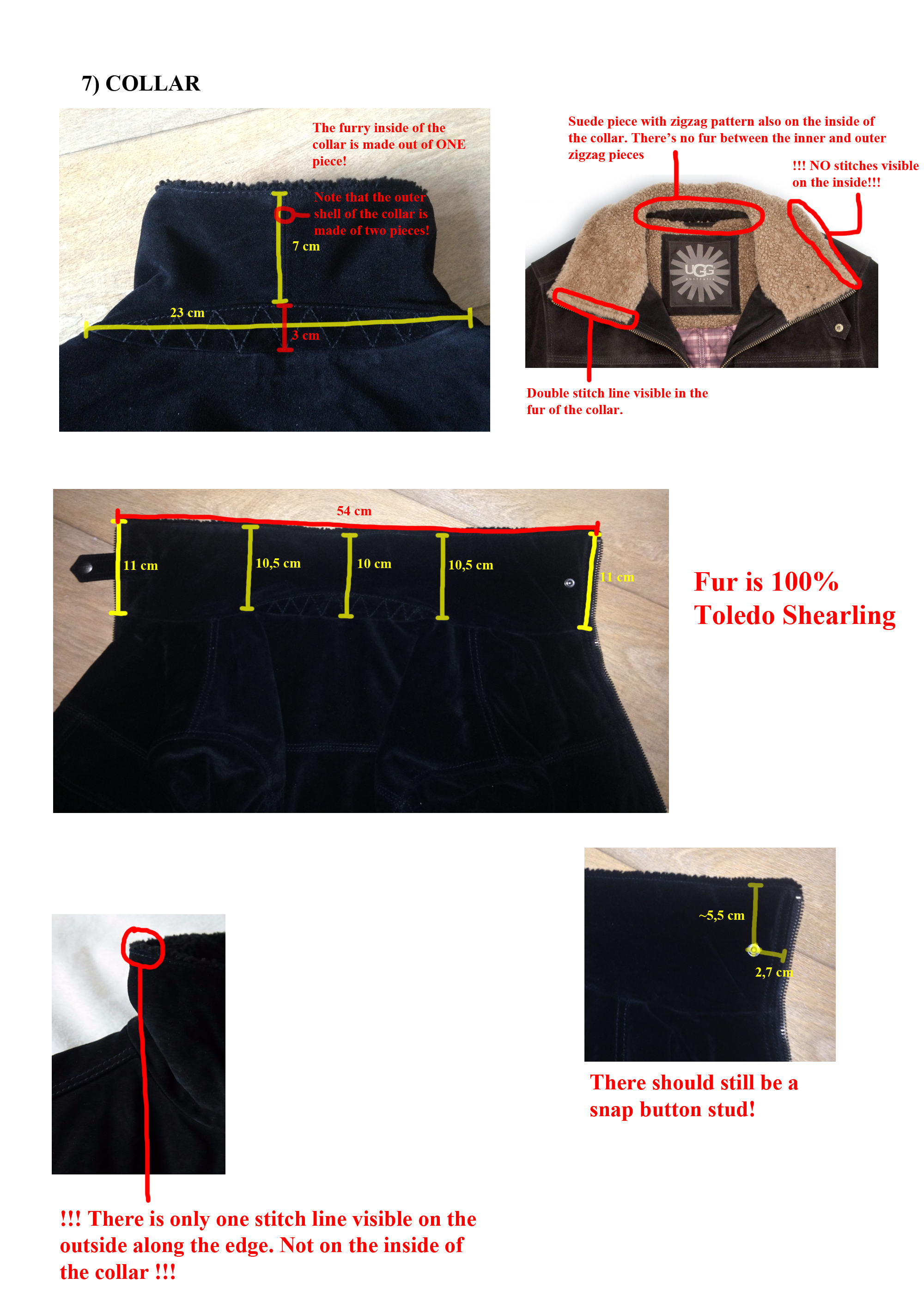

2) the outer part of the collar on the back (above the zigzag pattern) doesn't have a seam. The original has a seam running in the middle without stitches.
3) I'm also not sure about the length of the collar. If you look at the zigzag piece and the rest of the collar and compare their sizes relative to each other, then either the zigzag piece is too big, or the upper piece of the collar is too short.
4) what accidental said, the stitches at the bottom don't run on the ribbed fabric, but only on the suede.
Here are reference pics for the back and the collar with measurements based on size L:
View attachment 765480View attachment 765481
I agree with everything said by Razor and accidental.
Definitely very narrow on the back with big curves outward at the top. Needs to be no stitching across the lycra at the bottom.

Just my 2 cents about the prototype shown in the picture that hasn't been mentioned yet it looks like that cross stich or zigzag area has been placed on the collar and looking at the measurements picture plus my own ugg jacket it's actually more under the collar on the top of the back panel
You mean that the bottom of the collar isn't straight but runs in a curve that cuts into the back of the jacket? If so, then you're right, the collar curves 1 cm into the jacket at the back.
