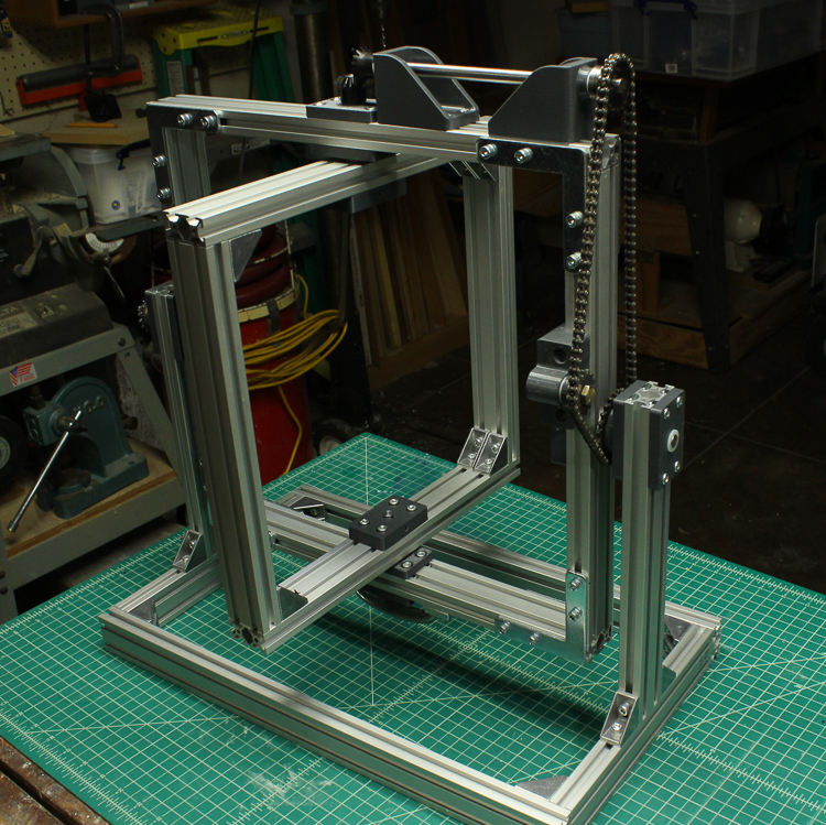

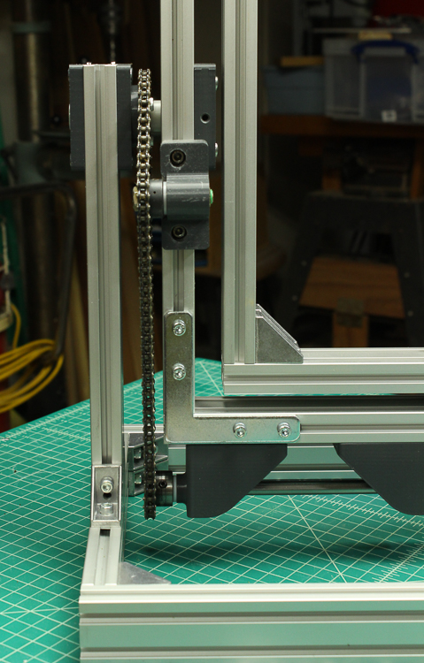

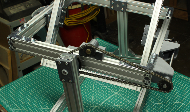

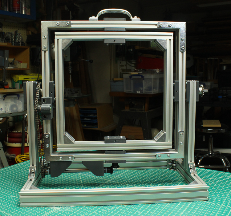

In preparation for the casting I've put together a bench top roto-caster.
Yes! I designed and built it. Still needs a motor. It's for casting the L'Eggs engine noses. It looks like I'll be needing more than 30 pair. That's too many to sit there and hand rotate!
Looks great!!
Tons of motors over at Apex Electronics in the San Fernando Valley...one of my favorite surplus stores.

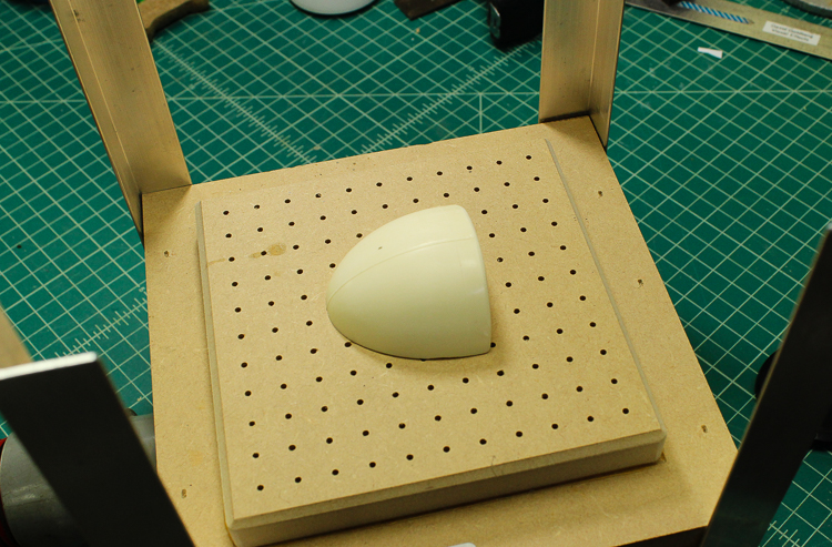

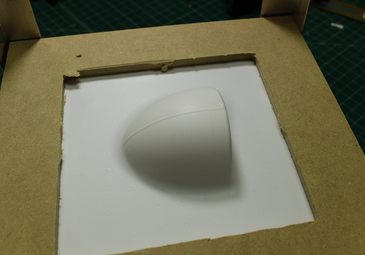

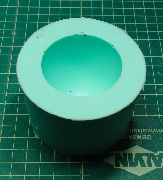

Adding the styrene plating to the L'Eggs engine nose cone. First step was to make a silicone mold of a L'Eggs egg. This is a mold of a full L"Egg, not the turned down nose cone. That way if I ever need another egg, I don't have to go back to EBay!
I poured a section in resin to use a a vacuum forming buck.

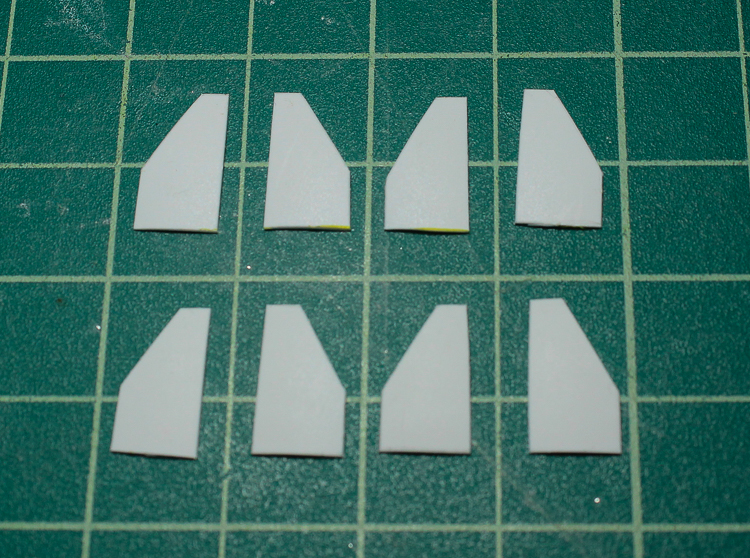

.015" styrene was vacuum formed over the buck, then cut the plating pieces out of the formed plastic.

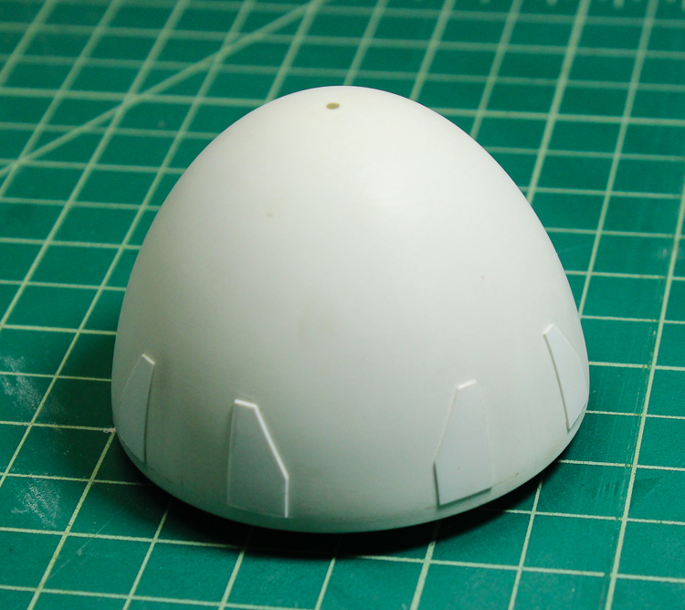

The plating aplied to the egg. Ready for molding.
