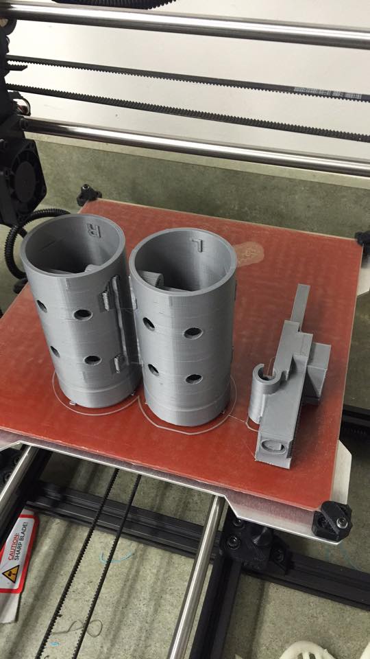

Ok. Got a little problem: I had shapeways working on two of nacelle core v2. Since it was one file, I assumed that it was either left or right and it didn't matter. Now I see there are a starboard and port nacelle in the folder too. Can anyone tell me why there's a v2 file? Should I have the others printed instead?
If I'm fast, I might be able to stop them from printing the wrong ones.
You're fine. The V2 nacelle core works for both sides. no need for a right and a left.

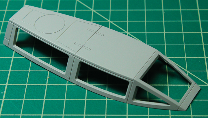

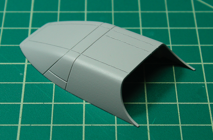

Okay, I will reiterate what I said a while back... I am not producing a complete kit. Completing the model will require scratch building. I am sharing the files I use to create 3D printed parts that people can print themselves or have printed at someplace like Shapeways, and will be selling a limited number of other components. As of right now I will be offering castings of the forward fuselage with canopy and the L'eggs engine parts. That's it. If I end up molding or laser cutting some parts that would be difficult for others to make on their own I may offer those as well, but as of now that is an unknown. There has been mention of others offering sets of kit part castings to detail out the Y but I have no involvement in that what so ever. I do not have the time to do that. I hope such sets are offered, it's obvious there's a big demand (and I want a set too!).
I went Open Source with this project for a couple of reasons, the first being that it seemed a shame to put so much work into something for only a single version to exist. The second was to help others that wanted a Y to get over the hurtle of creating the basic fuselage and to encourage a resurgence of scratch building. The overwhelming interest in this project is allowing for the 3D printing of patterns for the forward fuselage ($$$) and offering castings. Something that would not have been feasible had only 10 or 12 people been on board.

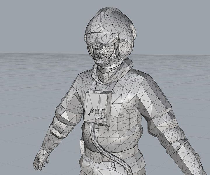

Does it has to be Solid Modeling or OBJ can work?
As is typical for SketchUp models they are usually crap when it comes to 3D printing. Often they have been extracted from video game engines and have low polygon counts and are nowhere near watertight. Here's what that Rebel Pilot model actually looks like:
It might make a fair starting point for a digital sculpt but is going to take a lot of work.
As to solid model vs. obj., either will work for 3D printing as long as it's water tight and of a high enough polygon count (in the case of an OBJ). Something organic like the pilot would be easiest to model as an OBJ. Hard surfaces like the cockpit, I'm partial to surface models.
