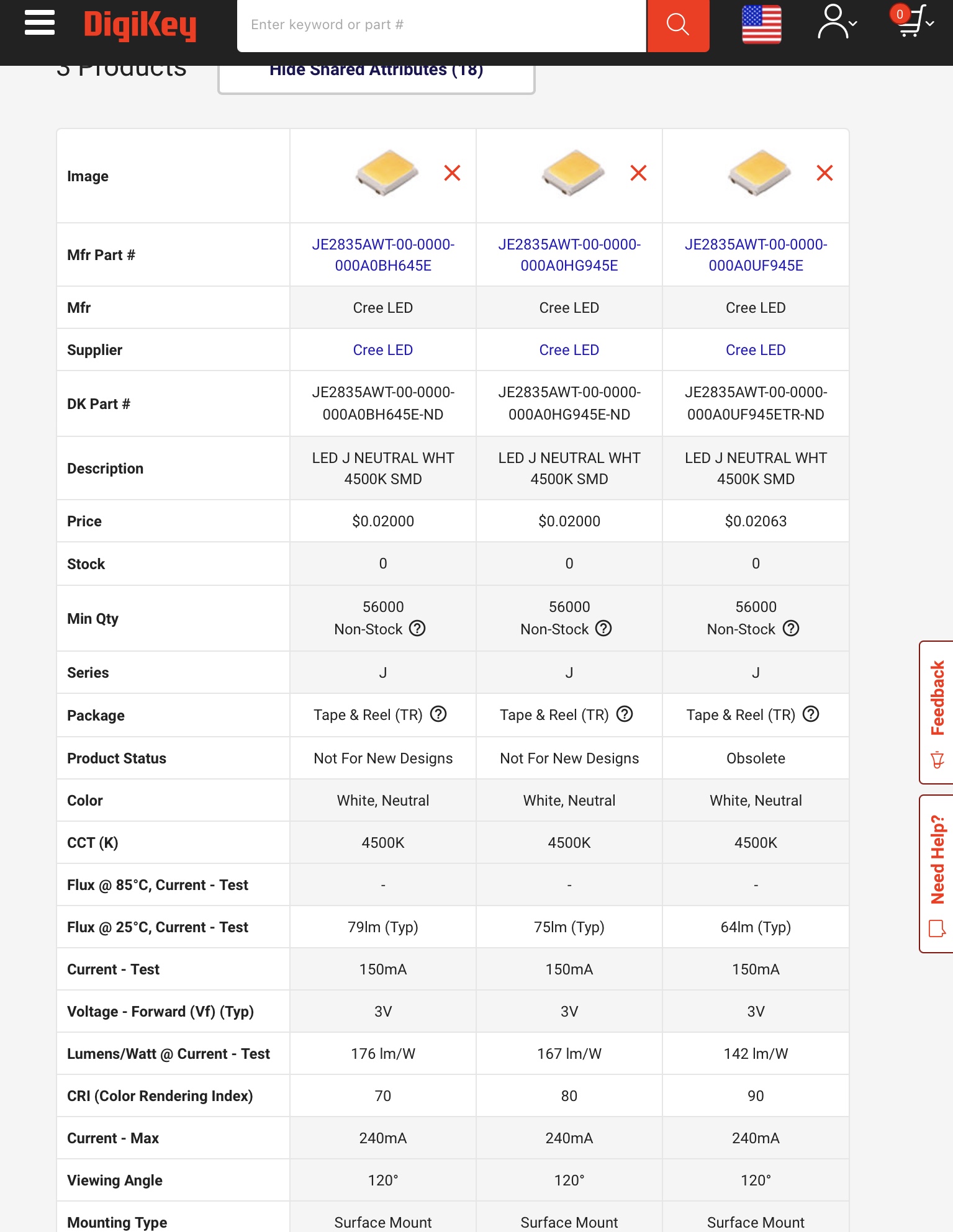

You can find most colour temperatures. These are the 4500k ones on digikey. You can filter by temperature on there.
Most read the same under the part numbers…..what’s different are the part numbers….which means characteristics differ in some way in the specs.
What’s the voltage of the lithium battery……most small SMD package parts used in Surface Mount circuits run at 3V plus there should be voltage regulators on the PCB’s.
The top 3 from your link seem to be the contenders if the lithium battery is at a minimum of 3V….
Below comparison all 3 choices…..as mentioned small qty needs to be found…..one below is obsolete but it doesn’t mean that it’s not at alternative secondary sources “old new stock”….

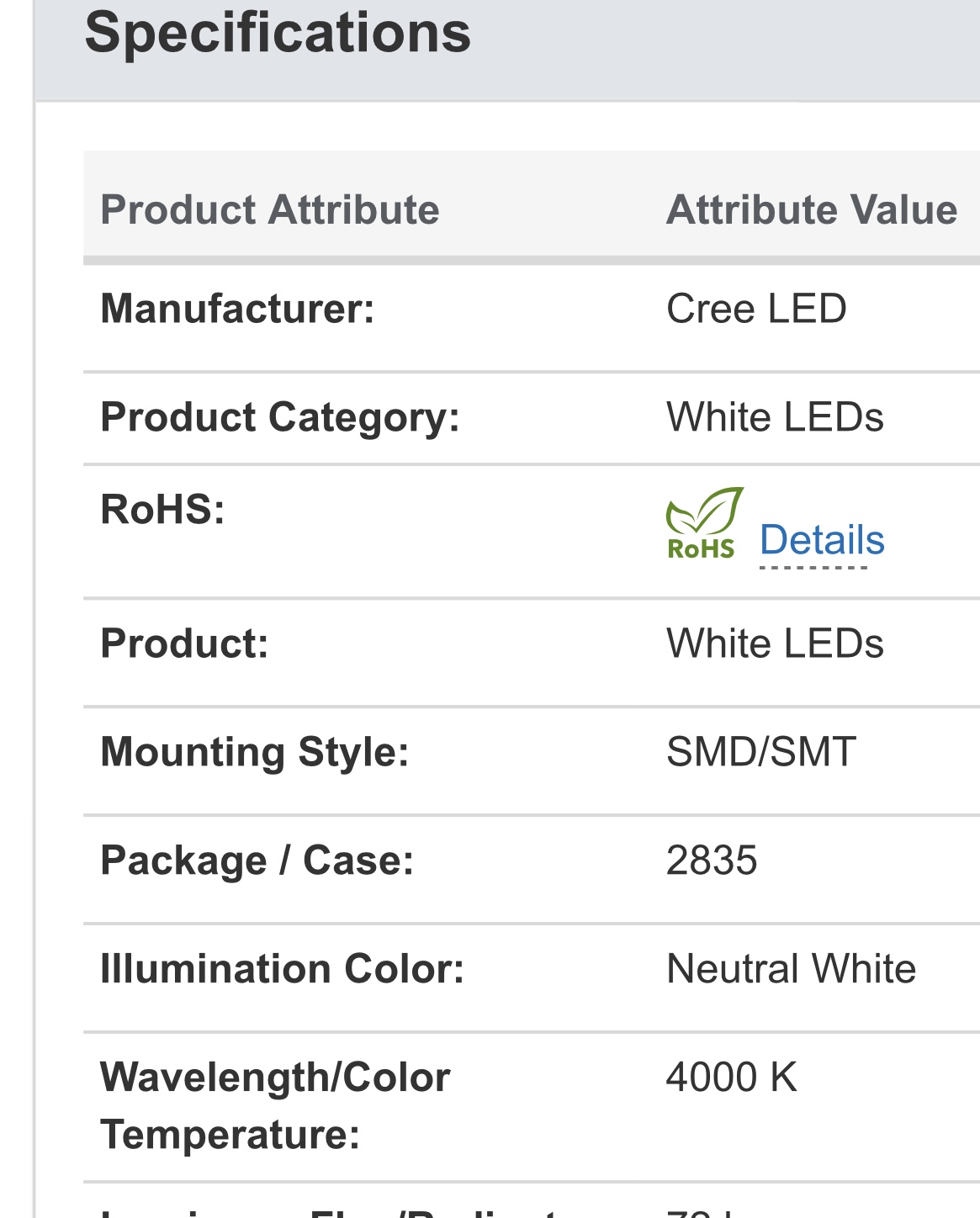

Just been browsing and it seems that the 4500k ones are no longer made though you can still get some of them. Searching for neutral comes up with the 4000k ones. That would probably work along with the tint of the plastic piece in the moire. I wouldn't go over 5000k.
The battery is 4.2V max down to 3.6V. There are probably regulators bringing it down to the correct voltage. Wouldn't need much.
