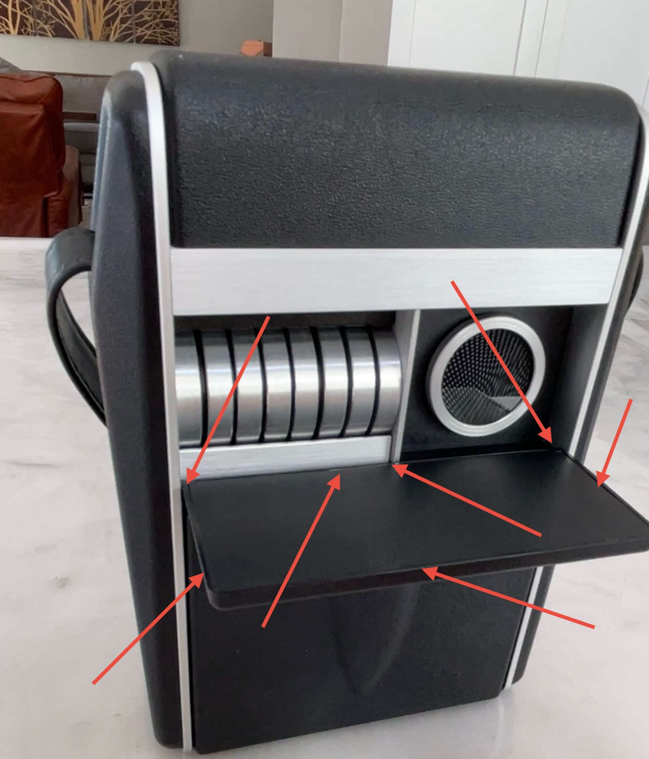

Notice what the door might have looked like, had extra effort been given to design it so that the rod isn’t seen and covered to prevent bowing, also giving it what would probably be the correct pivotation without klugey pieces, so that the door opens to perfect 90deg and easily closes back….
Such a cleaner look………..
Why Wand….Why? WAHhhhhhhhhhhhh……. :)View attachment 1954117
Is that yours or a computer image of what it should have been?

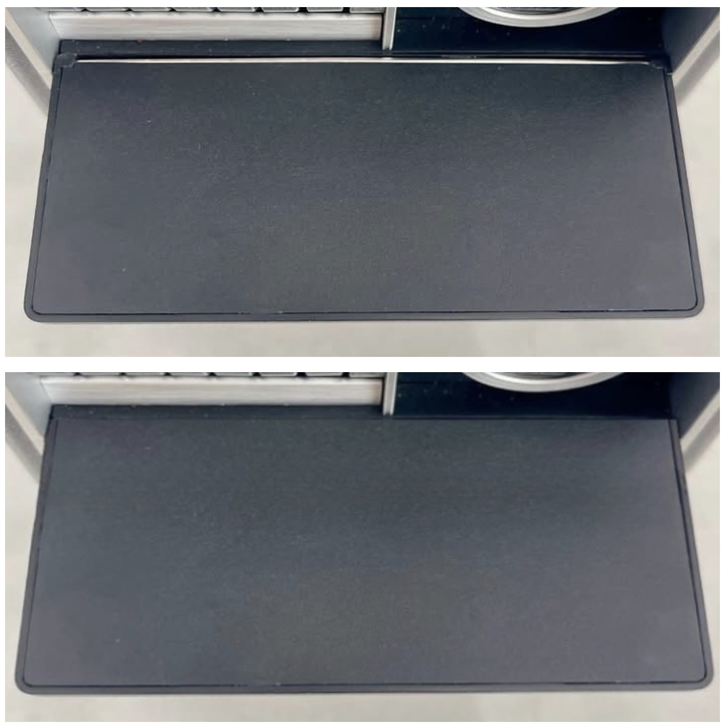

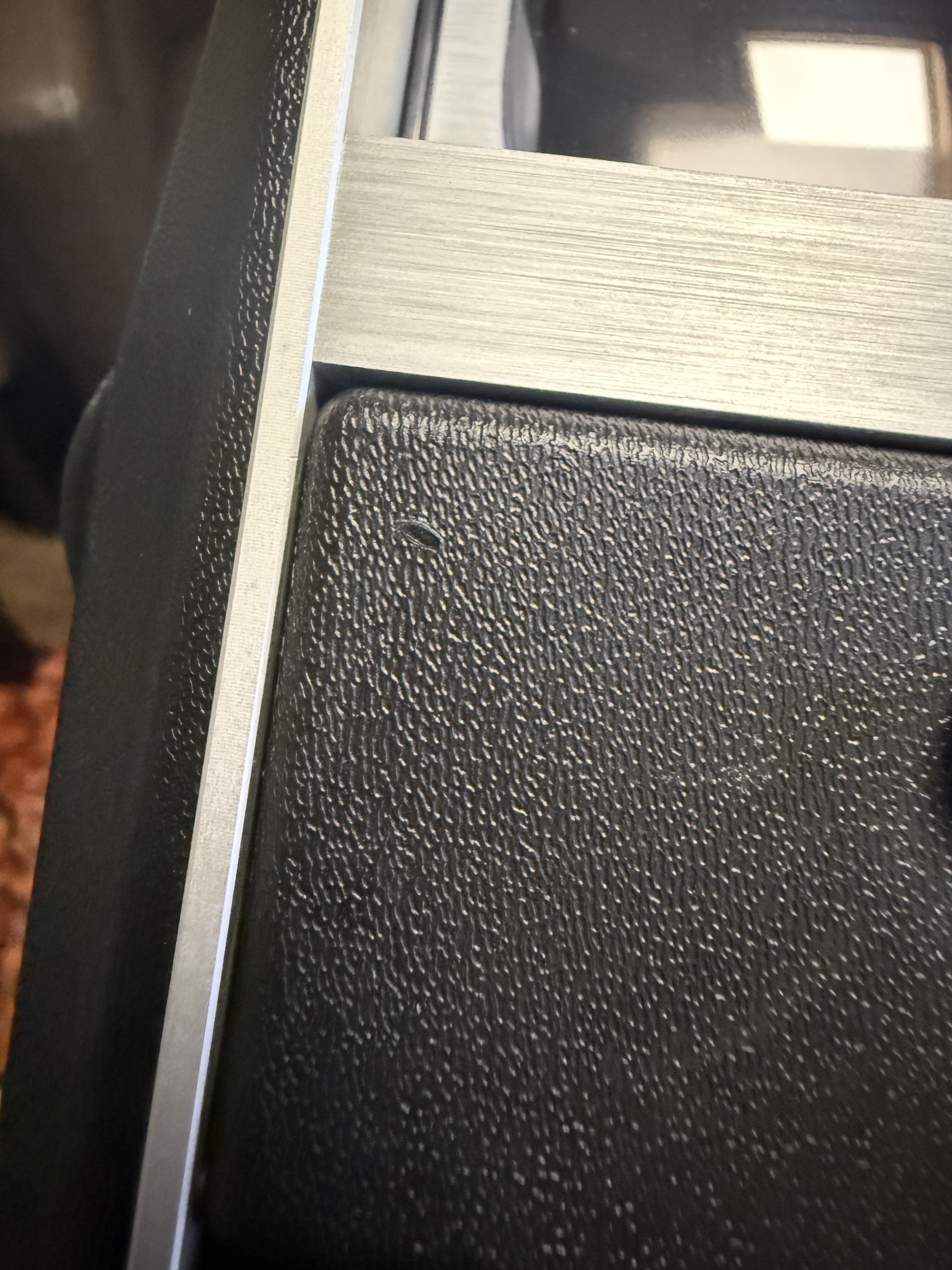

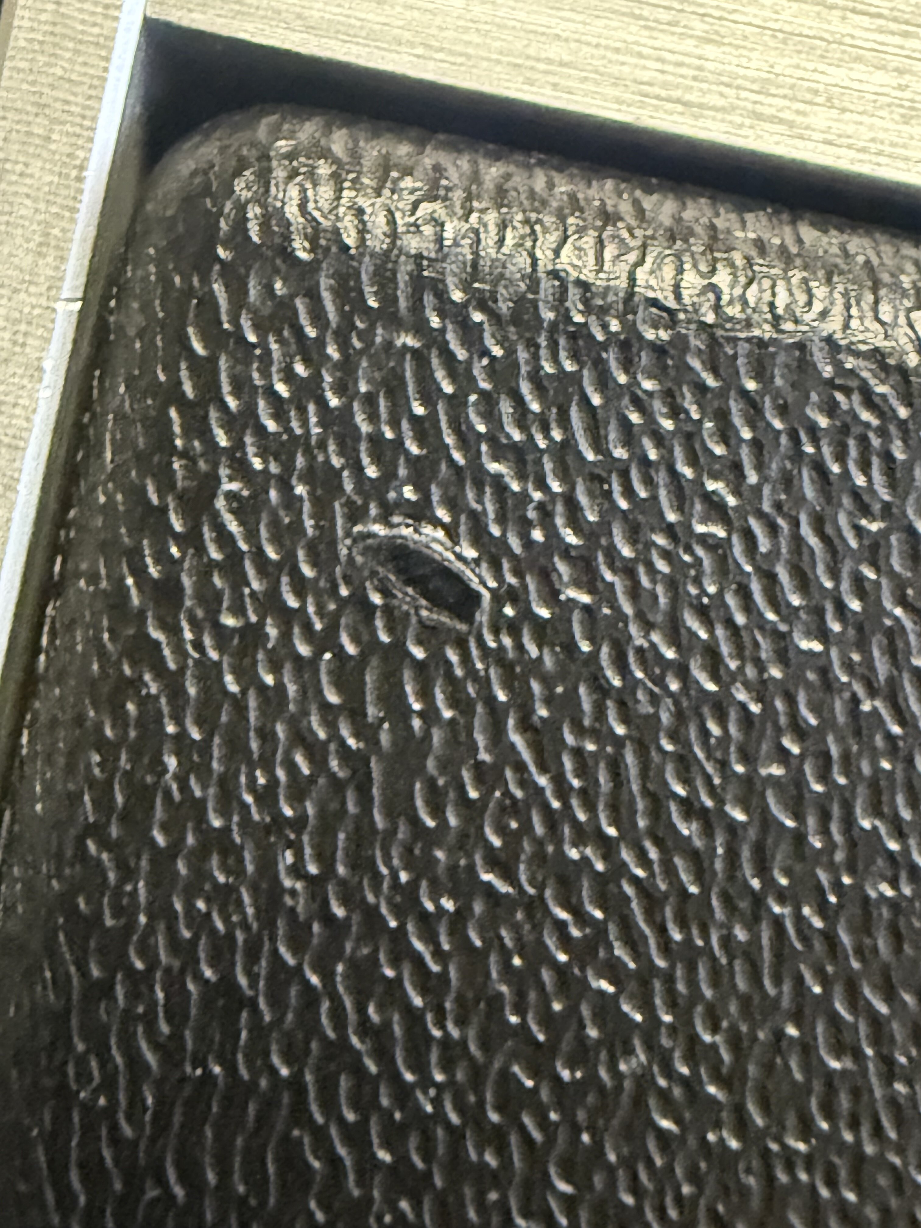

THIS DOOR LOOKS LIKE FRAKING HELL! I’m going to go over this piece of junk millimeter by millimeter and IF I FIND ONE MORE FLAW…
I’m chucking it in the trash!
Trash? But you’ve waited 5 years for a flawed free perfect product….welp suit yourself.

By the way …. Is that a Borg Magnifier?
Your absolutely right! The door has been beaten to death..R.I.P……what’s next I wonder :unsure:

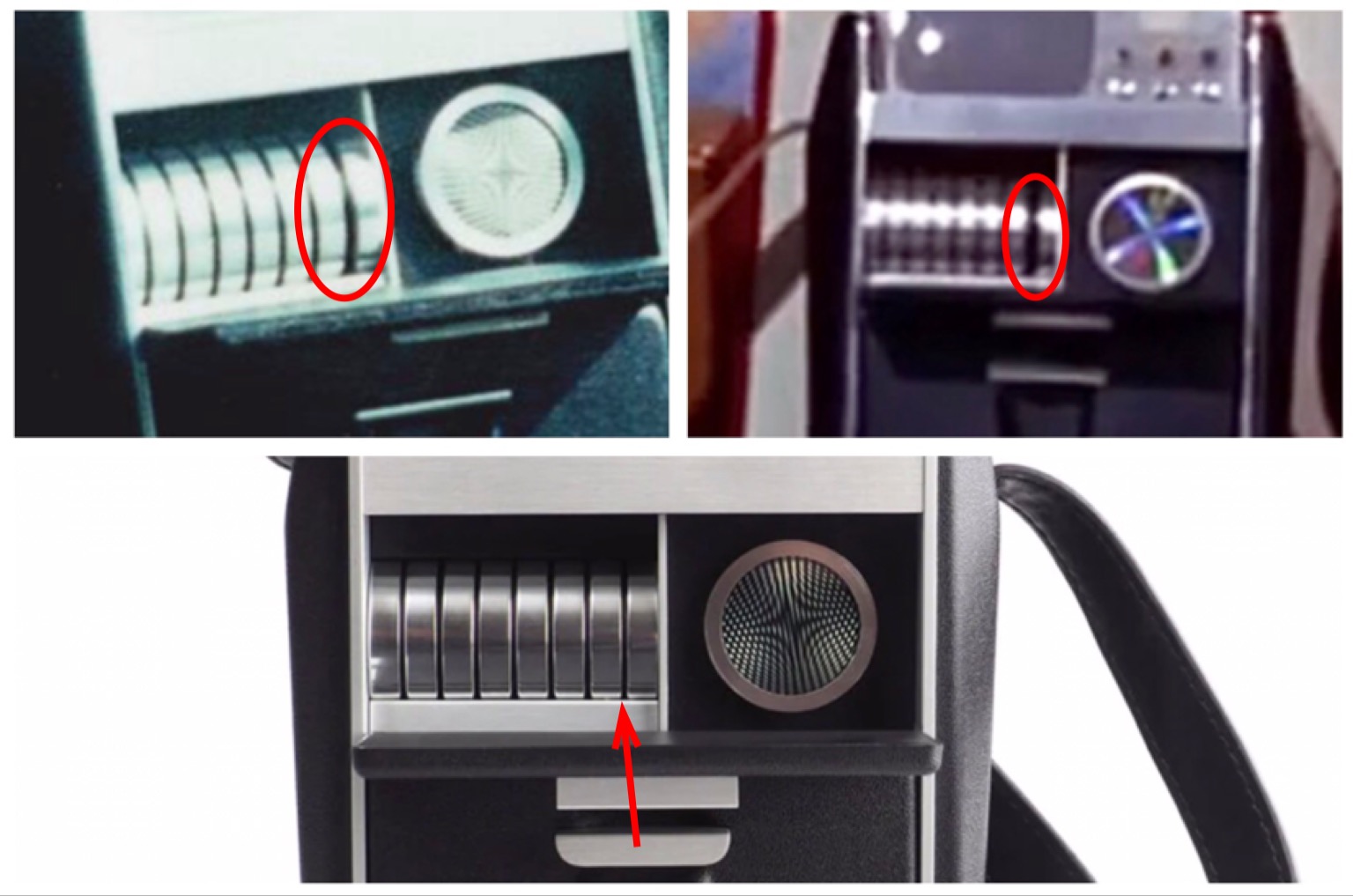

Ruh Roh …I want my gap…where’s my gap….Wand the gap?
It added character on the Heros….i believe it defined conceptually where the discs would only go to be read …the gap distinguishes the far right disc position for reading discs ..imo.
With Wand…it’s Eeny, meeny, miny, moe…...until you read the instructions.
