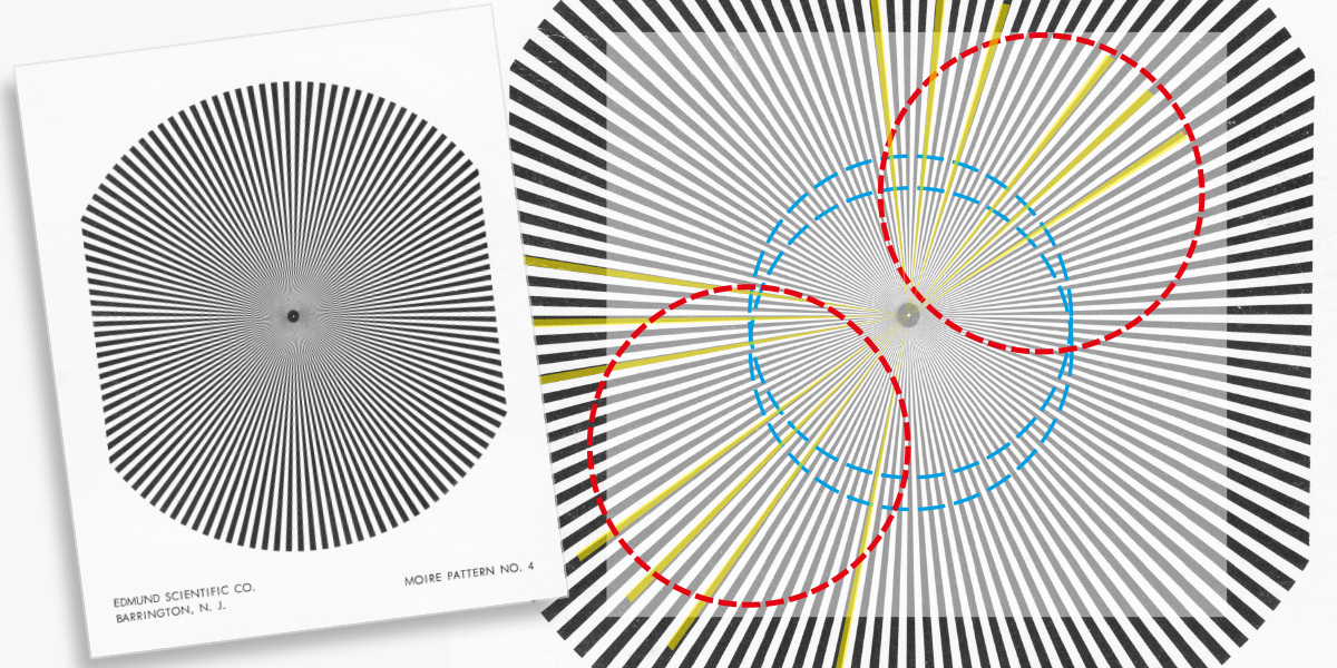

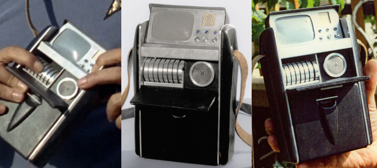

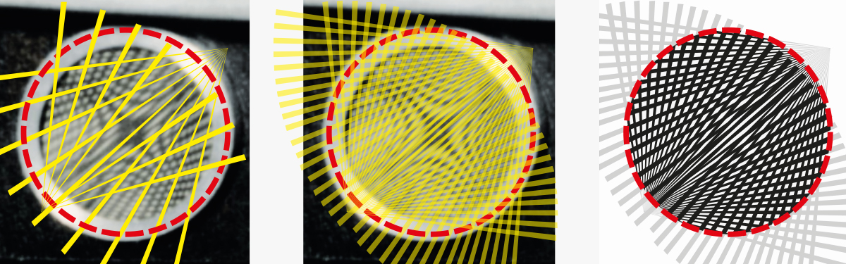

When putting our communicator moiré together we had the incredible help of HeroComm, who kindly loaned us an original 1965 “Educator’s and Designer’s Moiré Series (A)-Deluxe Kit”. The amazing resources on the HeroComm website helped us cut the moiré from exactly the right position from Pattern #4, but when it came to the tricorder, we had to work things out for ourselves. In order to replicate the moiré pattern as seen in all the known photos of the hero prop, a close-up of the studio photo from “The Making of Star Trek”book, corrected for perspective, was overdrawn with lines to pinpoint the centre of the pattern.
First square up a crop of the screencap moiré, then draw lines over it to find the pattern centre.
We knew that the moiré pattern was created from two discs cut from the same Edmund Scientific moiré sheet as the comm had been, but had been cut from a different part of the pattern. By overlaying our line drawings on Pattern #4, we were quickly able to see where to take the tricorder’s moiré discs from.
The original moiré was made by superimposing a transparent film of the pattern over a version of the pattern printed on white card. The blue circles show where the communicator’s moiré discs were cut from – the red circles show the position of the tricorder’s discs.
While the tricorder has a moiré disc similar to the communicator, given the lack of space for a communicator-style pocket-watch drive mechanism behind the tricorder prop’s front panel, it is clear that the tricorder’s moiré never actually rotated. Nevertheless, as the static pattern we see in the photographs is clearly made from two discs sitting on top of each other, it was never in question that our tricorder’s moiré should rotate to bring that pattern alive. With the two patterns overlaid and moving, the evolving fringes turn out to be very exciting and do have the look of strange magnetic flux lines, perhaps displaying some otherwise-unseen aspect of a subspace signal.

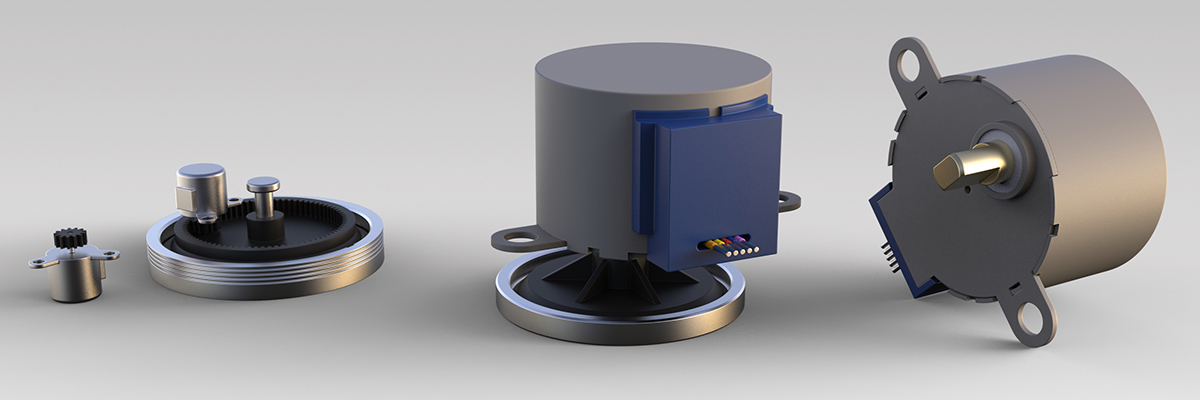

The stepper motor we chose to drive the tricorder’s moiré is much larger than the one we used for the communicator. Space inside the communicator is very limited: the moiré driving motor has to sit just under the moiré disc, on top of the speaker. Only the smallest stepper motor would fit. In the tricorder there is much more space behind the moiré panel which meant we could select a much bigger motor. The larger motor is actually less expensive and more robust, so it’s possible to connect directly to the moiré base disc, making it mechanically simpler and assembly easier.
The communicator’s stepper motor (on the left) is tiny compared with the monster that drives the tricorder’s moiré disc.
A stepper motor is needed because small DC motors function at high speed and as a result have to be heavily geared to achieve the low rotational speeds required to replicate the pocket-watch driven moiré motion seen in the communicator. The meshing of many tiny gears is a noisy business. The stepper motor is quieter and has the added benefit of accurate digital control of not just the speed, but also individual rotational steps. This provides another benefit for the tricorder’s function as a cabinet display piece.
