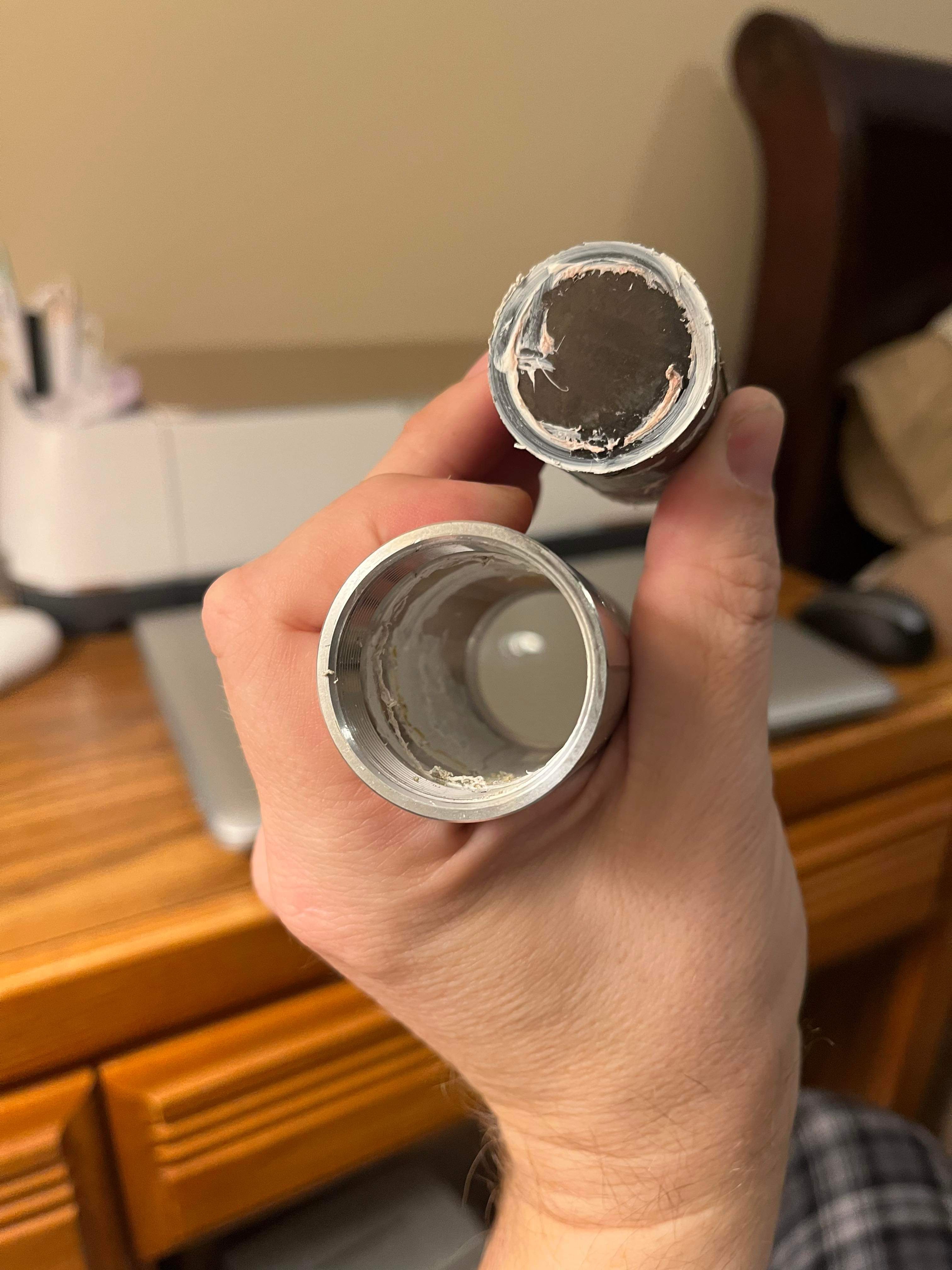

Halliwax and I were talking after Anakin Starkiller visited him. I took my eFX apart also. I removed the control box in case those screws were holding the steel plug in place (they were not on mine). I cleared away some of the caulk on the surface. I used a wooden dowel to give the steel plug a few taps. There were a few drops of superglue and the caulk holding it in place. Note that it should only come out through the grip end.
I cleaned up the caulk some more, but this is what it looks like when first removed. Now it sits a bit loose in the saber, but you can easily secure it again with glue and caulk, or I simply rolled up some bubble wrap in the pommel end as a temporary fix and it doesn’t slide now. I haven’t decided what, if anything, I was going to do with this, but it looks as if it is able to be converted to an FX with a few modifications.
Teecrooz whacked that stinka with a dowel and popped right out! Alittle machine work of the emitter and you could fx this sucker

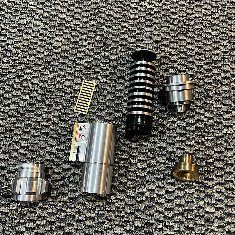

I was able to finish up my Rescuer hilt today. So I decided to use a very tiny bit of Tamiya weathering powder on the neck section mostly in the corners to give it that aged/dirty/dusty look. I then added a small touch to the control box rails to match the color. I also went over the entire hilt on my lathe with 00 steel wool and then 0000 steel wool and I love the finish it gave. Finally, I cut an aluminum rod to fit inside and add weight…it really gives it at authentic feel.
Overall I’m very happy with how this turned out.

Thanks! I used Tamiya Weathering Master kit B, and really only used the “soot” color. I was using the stunt top to experiment and took several tries to get correct. I eventually used a makeup brush that my wife suggested. I used the tiny diagonal end. The reason is because the brush that comes with the weathering kit really is too fluffy and big to get directly in the corners where I actually want the powder.
