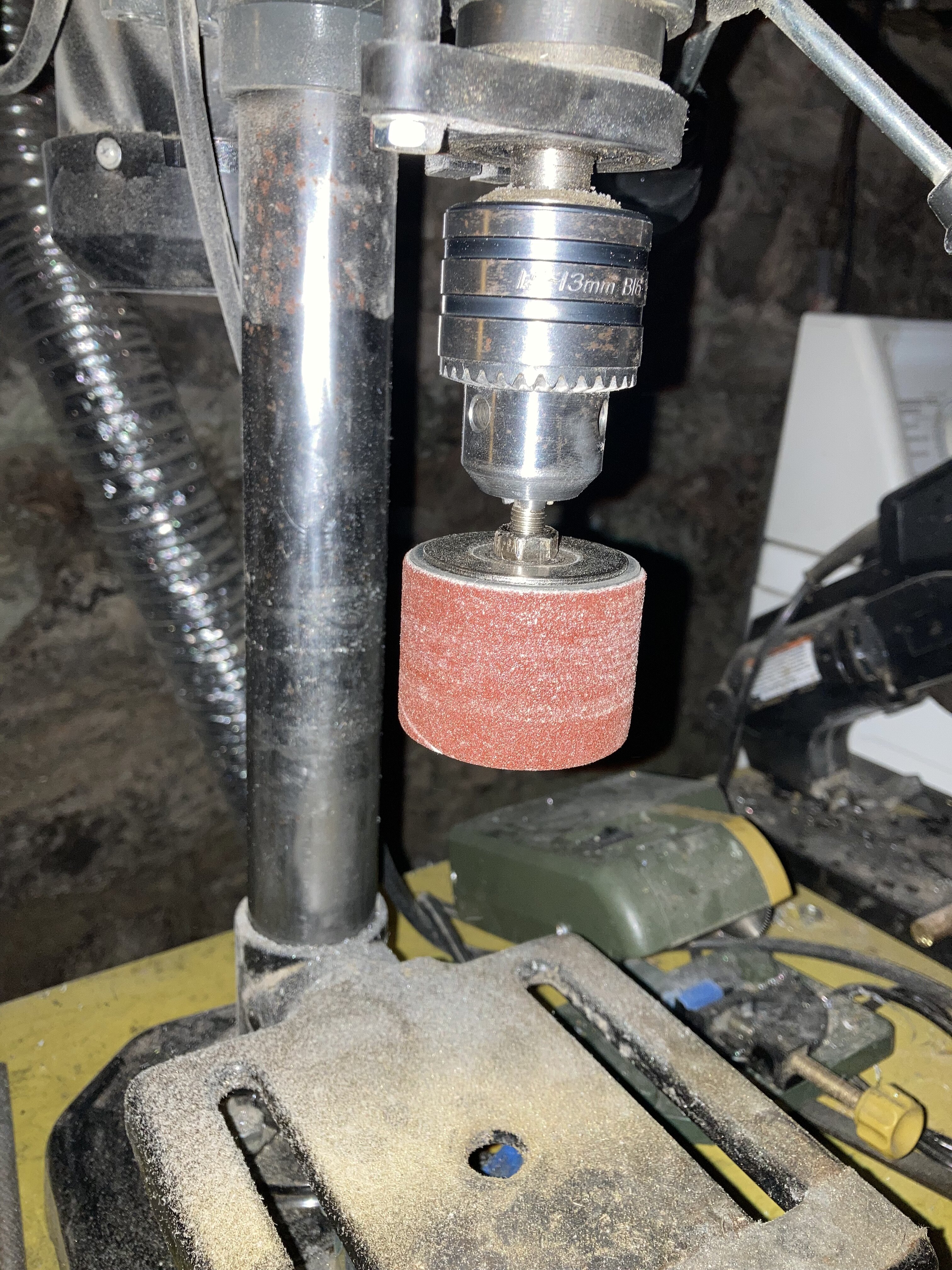

Oh yea, if anyone buys those big sanding drums from harbor freight, they’re left hand thread. It’s not righty tighty it’s lefty tighty. Guess how long it took me to figure that out lol

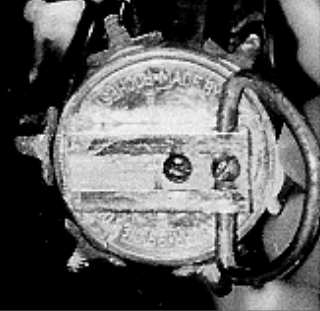

However, the disc is clearly not such a "perfect circle" like yours but it is quite roughly shaped. I think it could happen if they used a file (or a dremel, etc.) to roughly file off the rim/lip section by section (as much as the file width allows) and filed some sections too much. What is visible from the rim under the plate does not look unevenly filed though, but they could have cleaned it up a bit before assembling.
But how is the plate attached back to the flash? Could be the rivets go all the way through the clip, brass plate and into the supposed core inside the flash (but should have really long heads for that)? Or the rivets just hold the clip to the plate and the plate is maybe glued to the core?
And one last observation (or two). What's visible from the rim looks to be still chromed (although, could be painted over like the disc itself). The brass plate at least at one section appears to be over the rim on both sides. If it was the disc from the flash - the rim should have been brass, and the plate can't be with a larger diameter than the inside of the rim (unless the tube was slightly damaged and deformed into oval rather than a circle, but it does not look like it).

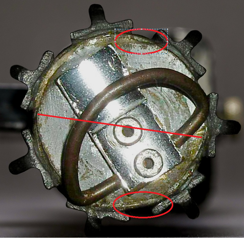

Yes - man this is good. I agree the hand cut plate is wider than the rim in a couple spots so it can’t be the original disc.
Also the rim isn’t evenly cut, I agree. The original milled lip is still the closest aspect of a graflex tube to these shots. If the tube was cut… the thickness of the tube wall would show right? If the Folmer lip was still there we’d see that instead. This thickness is smaller than the t track above it, which is wild to me.
I did darken this photo, for anyone following this. The rim is pretty light in color, I swung the contrast to bring out the rim from the surrounding material.
I can’t tell what’s under the hand cut plate. I was thinking maybe I should post up really good images of the wampa cave next to this shot to compare the damage.
The best I can tell… for some reason they needed the endcap to come out and possibly they destroyed the nice holes and had to patch it to reinstall the kobold?

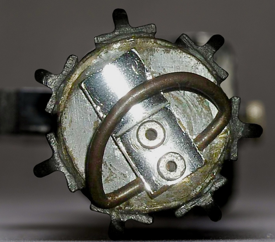

this is also good material for checking out the D ring block. The kobold I am banking on being the same. V312 and I found all these pieces of damage and tarnish that match: left of the rivets, bottom edge.... 2 or 3 dings on the sides... for example
To be honest, I think the shrunken kobold is an optical illusion because of the missing rolled lip.
I measured a folmer here at around 38mm in diameter and a real kobold here at 30mm long. I shrunk that MoM image down until the tube was 38mm and the kobold was dead on 30.

It looks like the endcap is screwed up on Dagobah. For sure it's screwed up in the 90s during the Magic of Myth tour, and that means most likely it was during Jedi filming. If IronDestinyProps doesn't mind, I took his photo of a recent project, cropped the real prop comparison and boosted the contrast to show what I see.
I have always seen a very thin rim around the endcap. That is.... underneath what I will call the "kobold plate"
So in essence... I see it in layers
1) Thin Graflex wall and filled endcap space
2) Kobold Plate and a washer? near the center
3) Kobold D ring and possibly the original rivets, lathed down

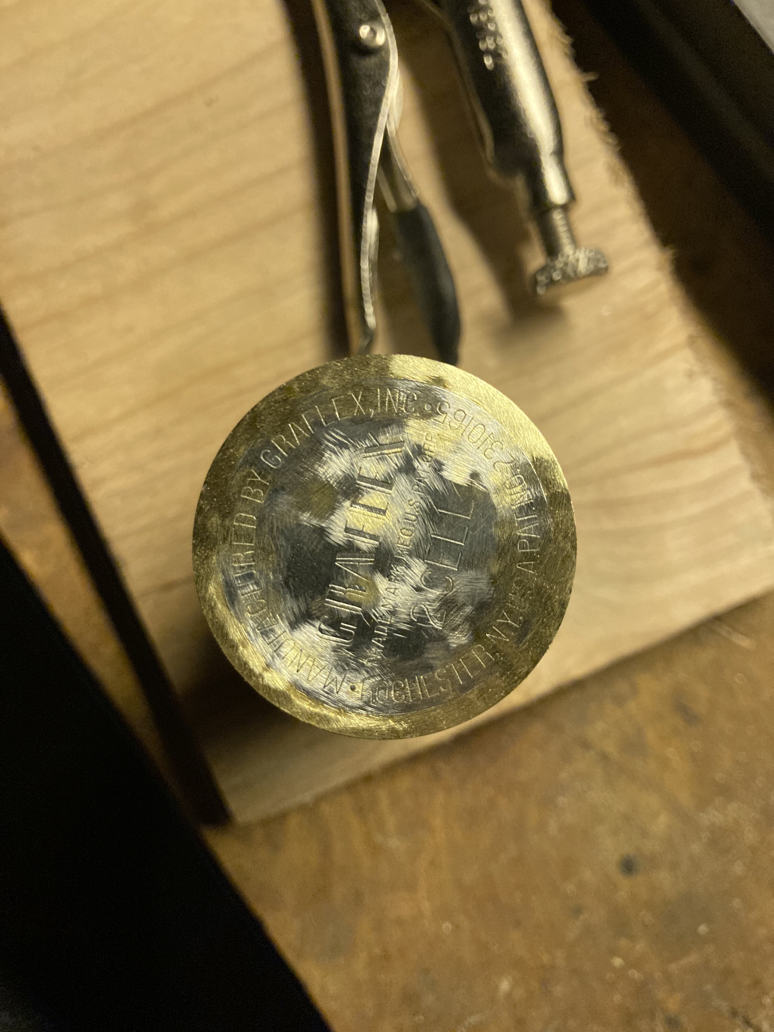

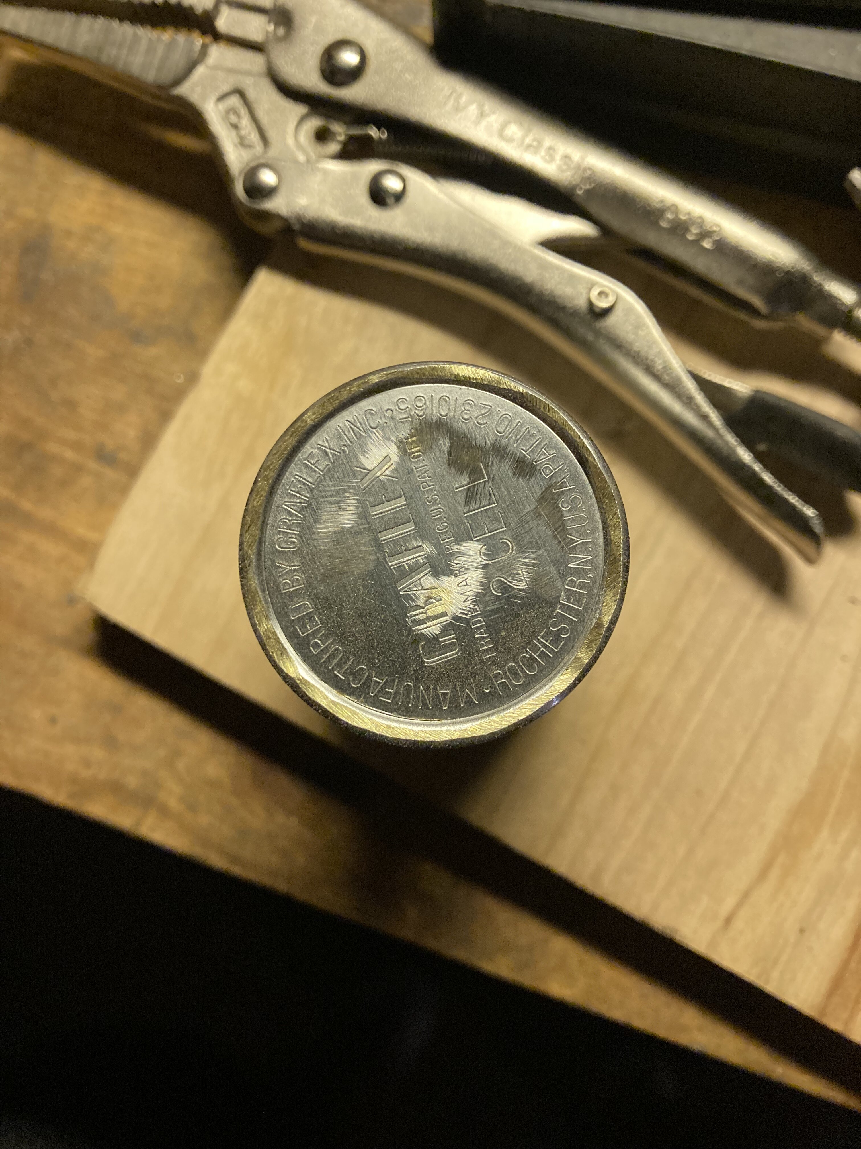

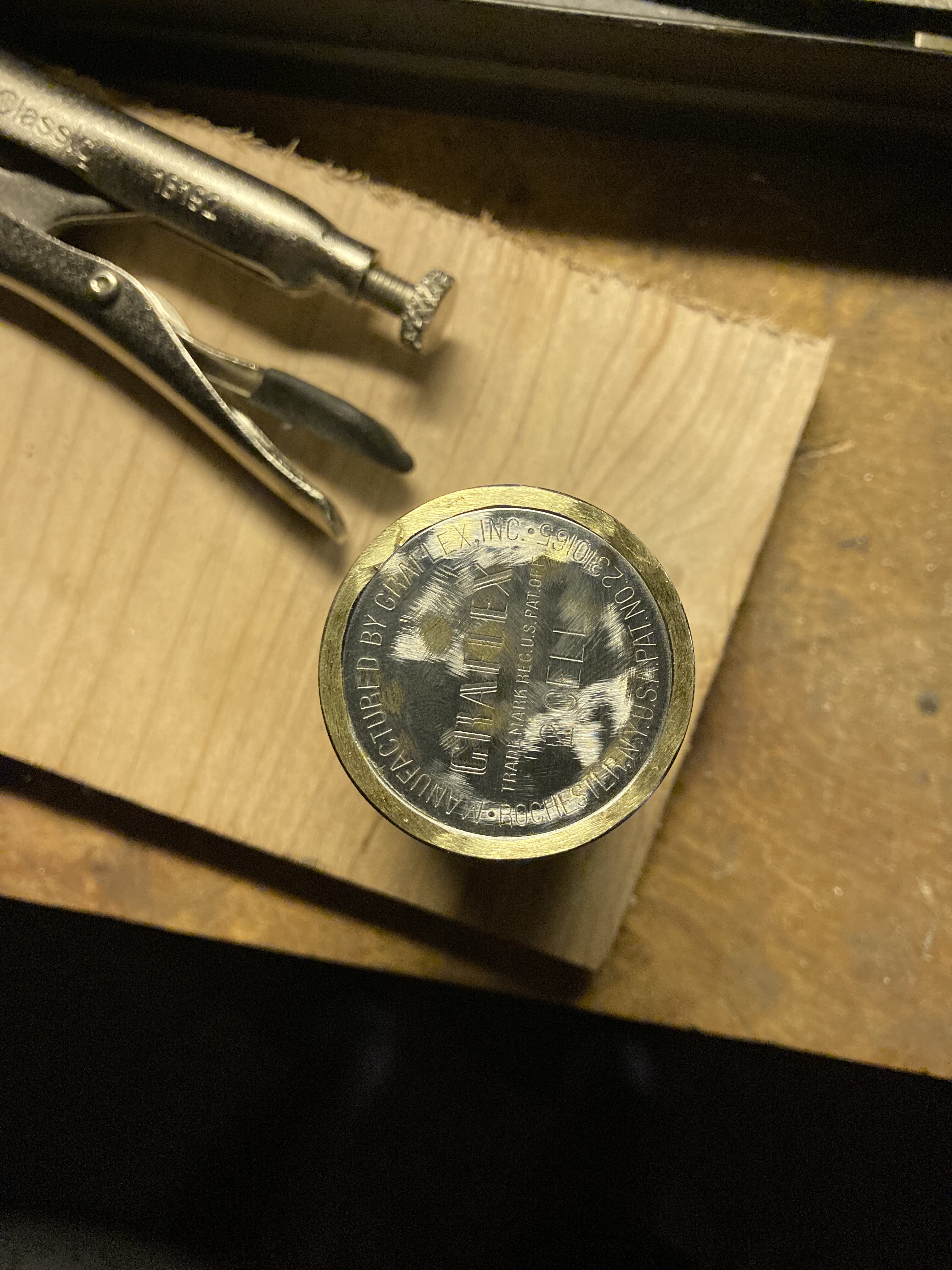

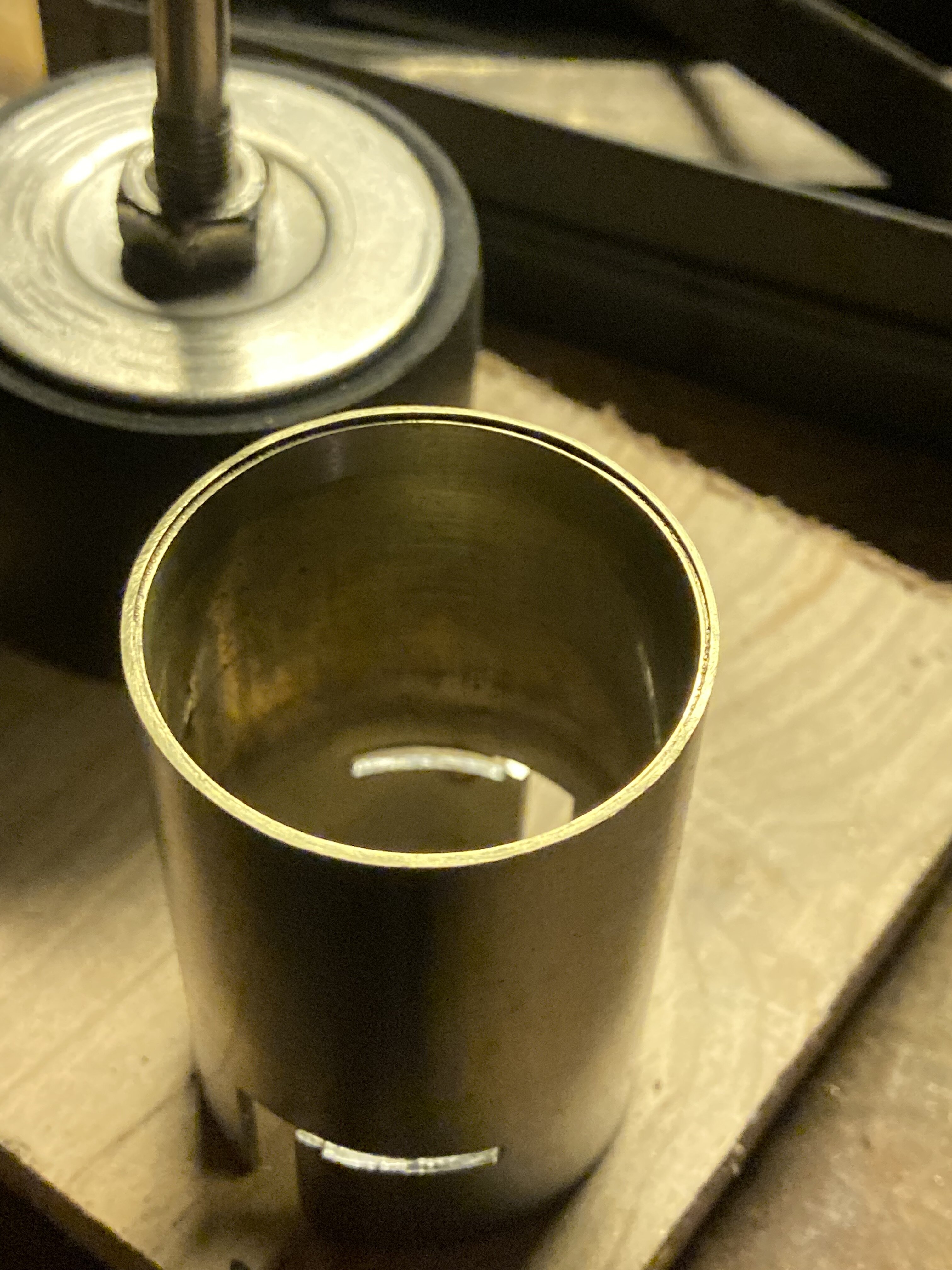

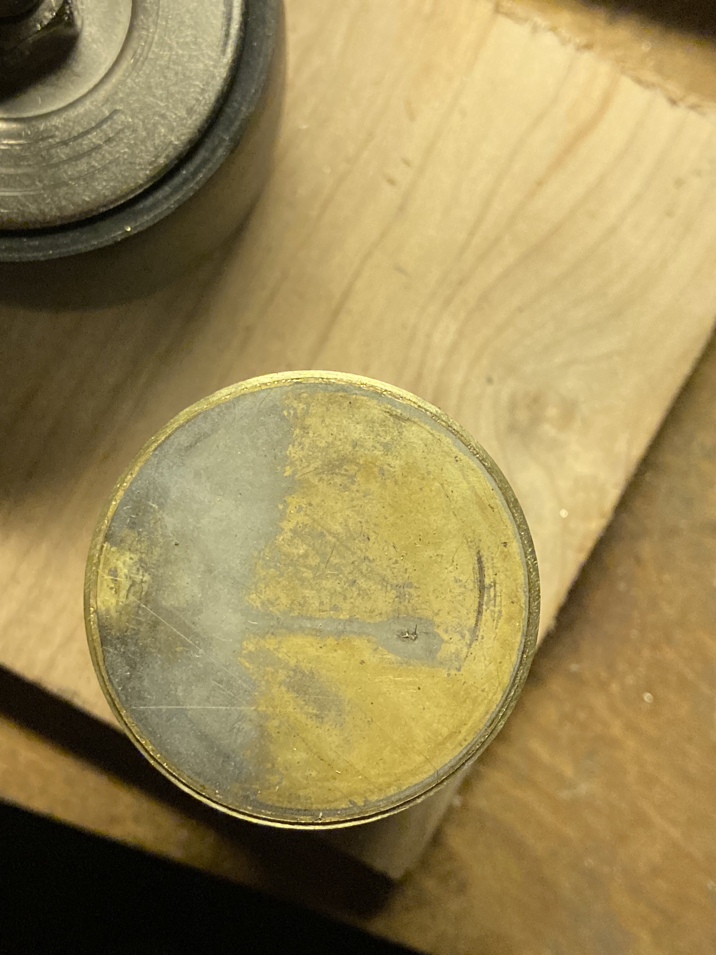

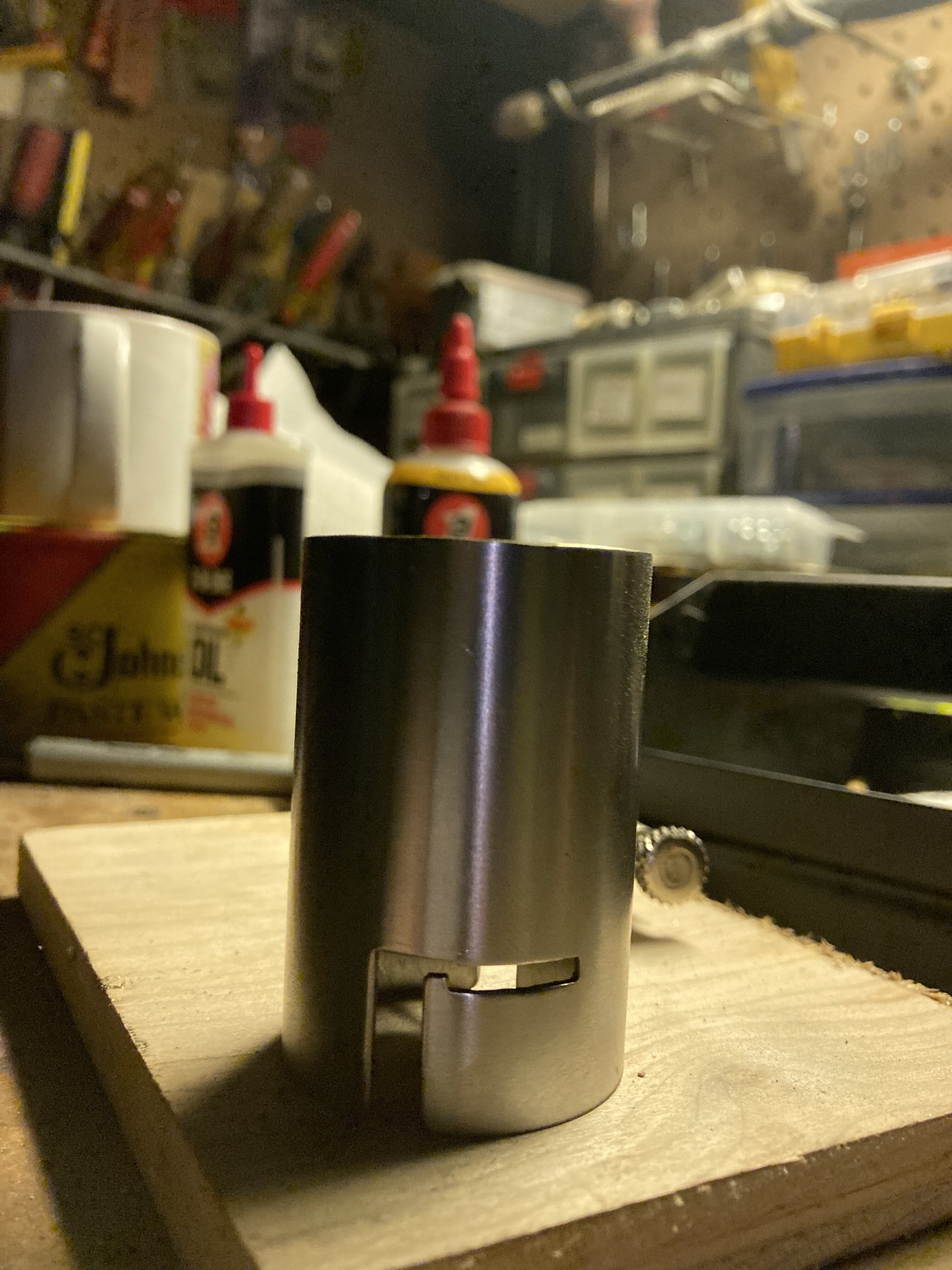

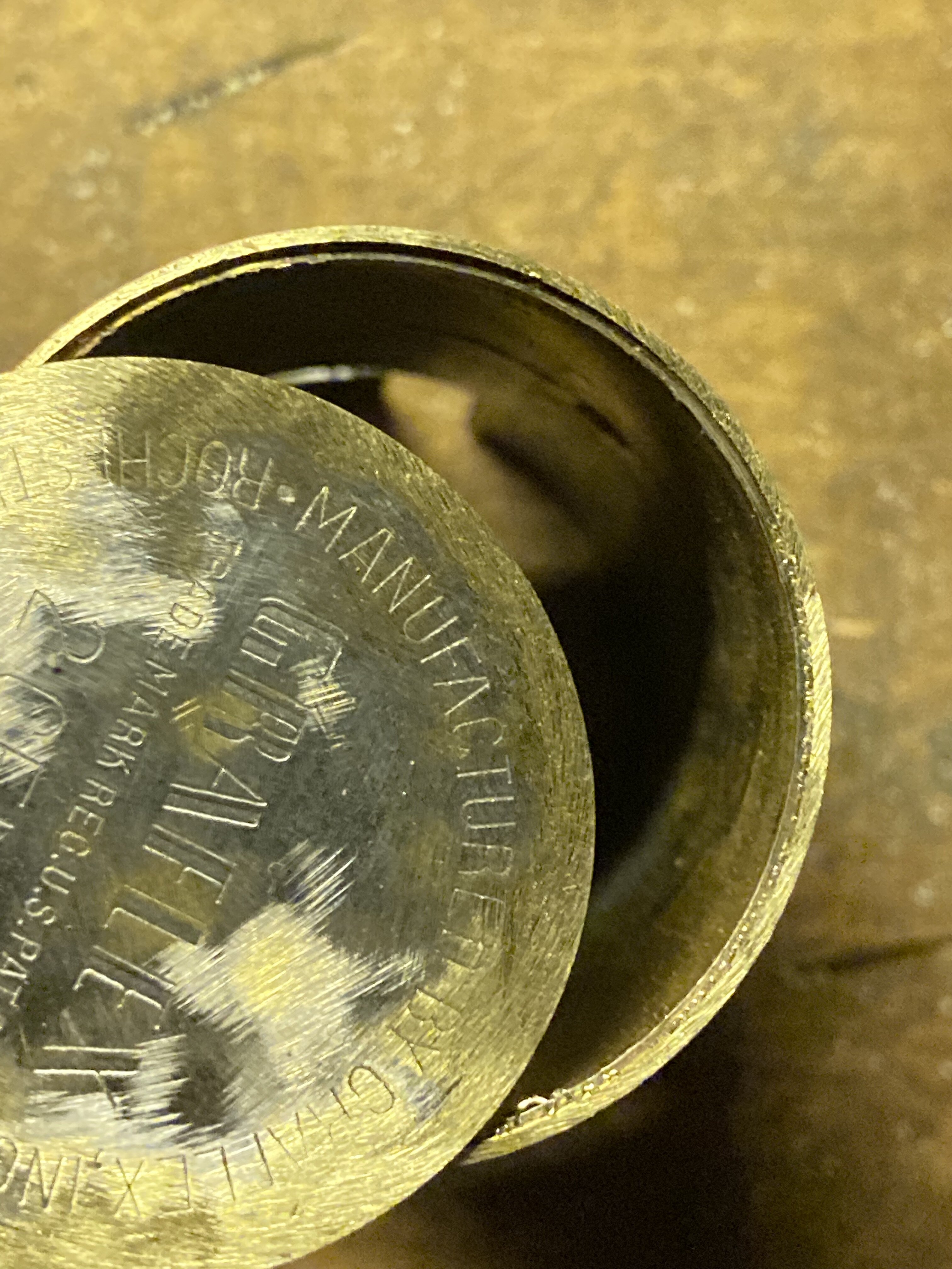

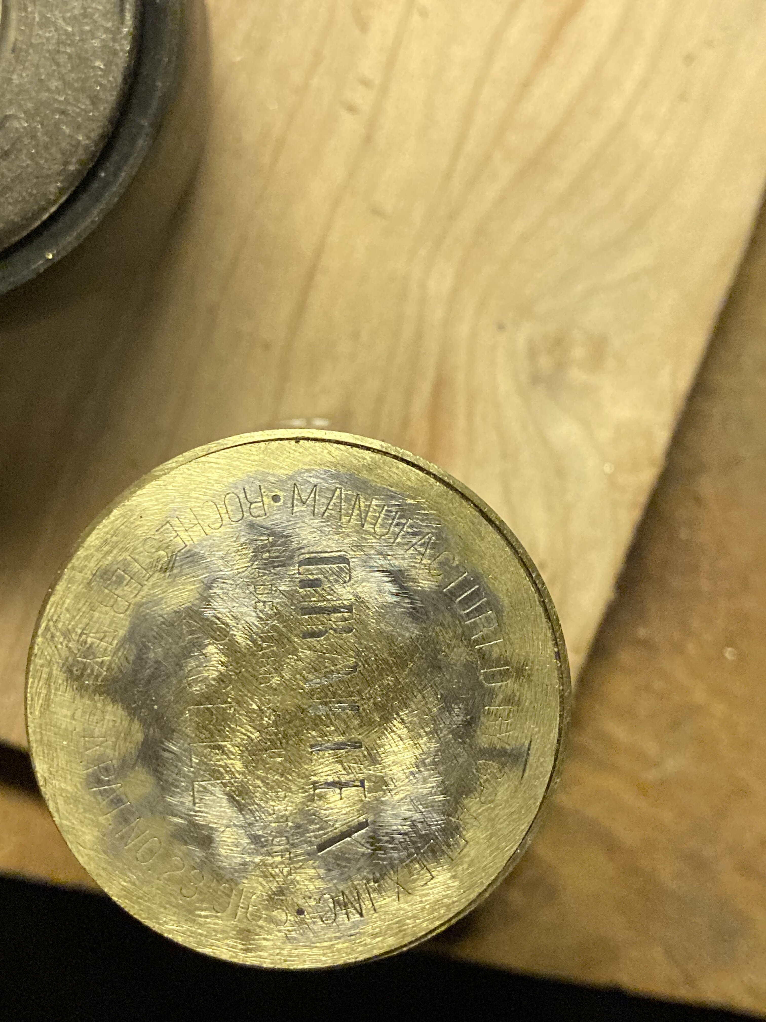

I have never been able to fathom how the wall could be so thin. The Graflex itself is almost 1/16" in thickness and then today.... an idea struck me. Where is the graflex wall thinner? Why... where it's milled for the endcap to sit! I sacrificed a 2 cell bottom to learn about the cross-section myself. Sure enough, I found a lip thinner than T track.
View attachment 1637846View attachment 1637836View attachment 1637837View attachment 1637838View attachment 1637839

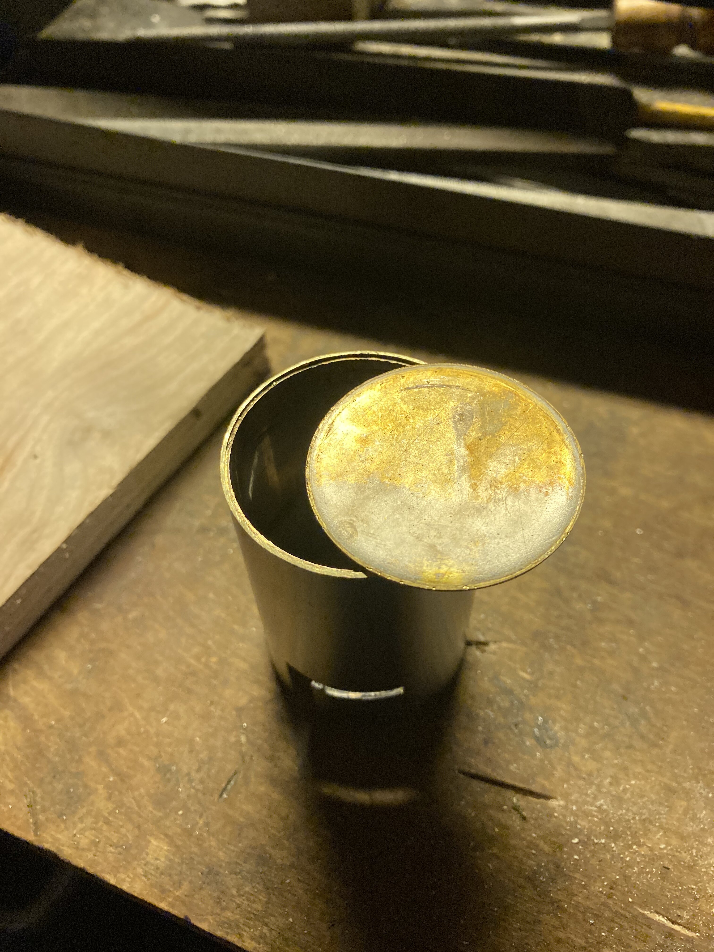

At this point the Graflex started to look like the DV6 but I couldn't find the seam-line of the endcap and wall!

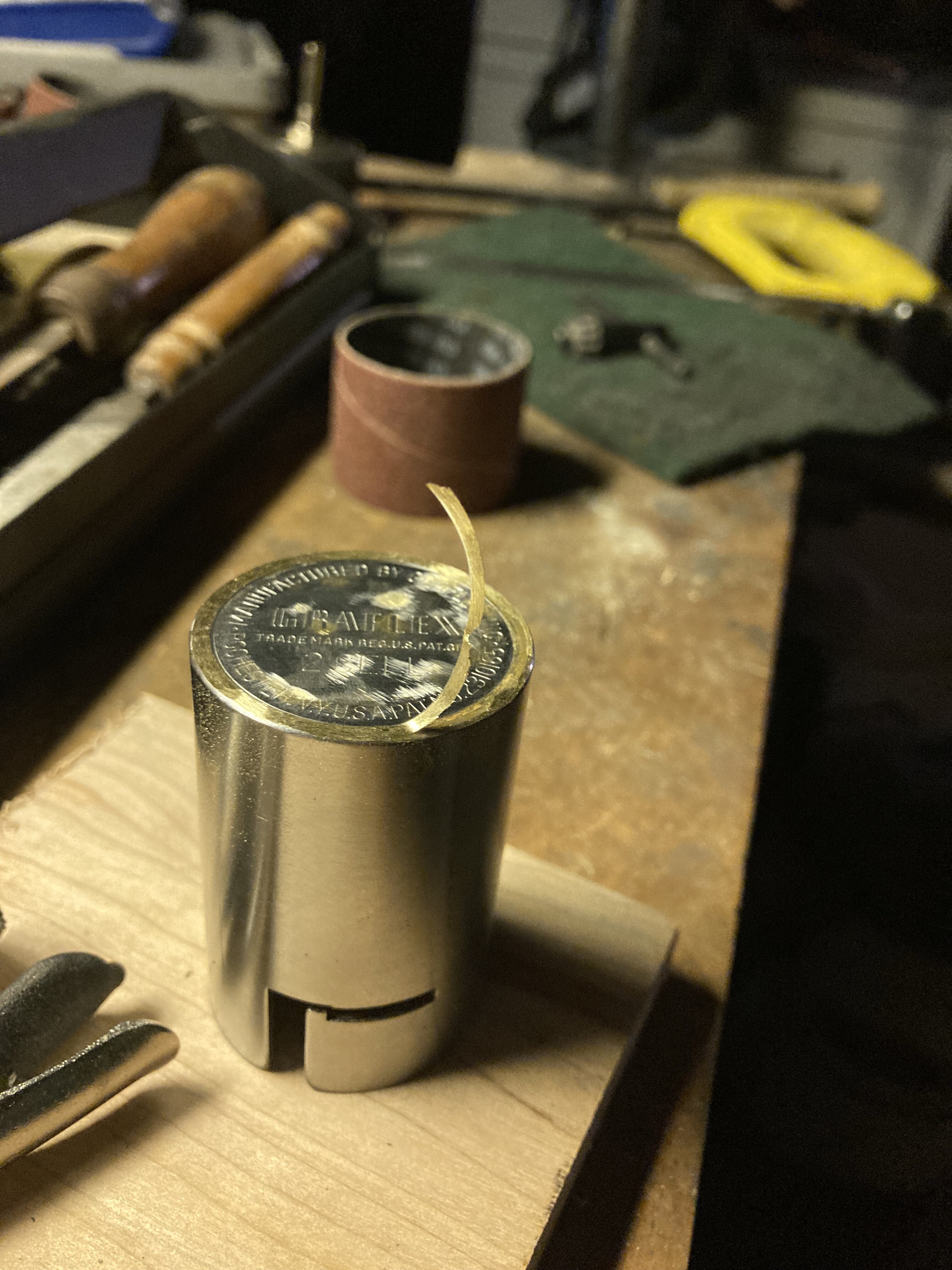

so I dropped one of my metal files, handle down in there, and whacked it with a wooden mallet. The cap fell out.
View attachment 1637841View attachment 1637842View attachment 1637843View attachment 1637844
I almost think they put the endcap back in place. Maybe upside down? Maybe the hand-cut "kobold plate" is the original endcap but flipped? I'd love to hear people's thoughts

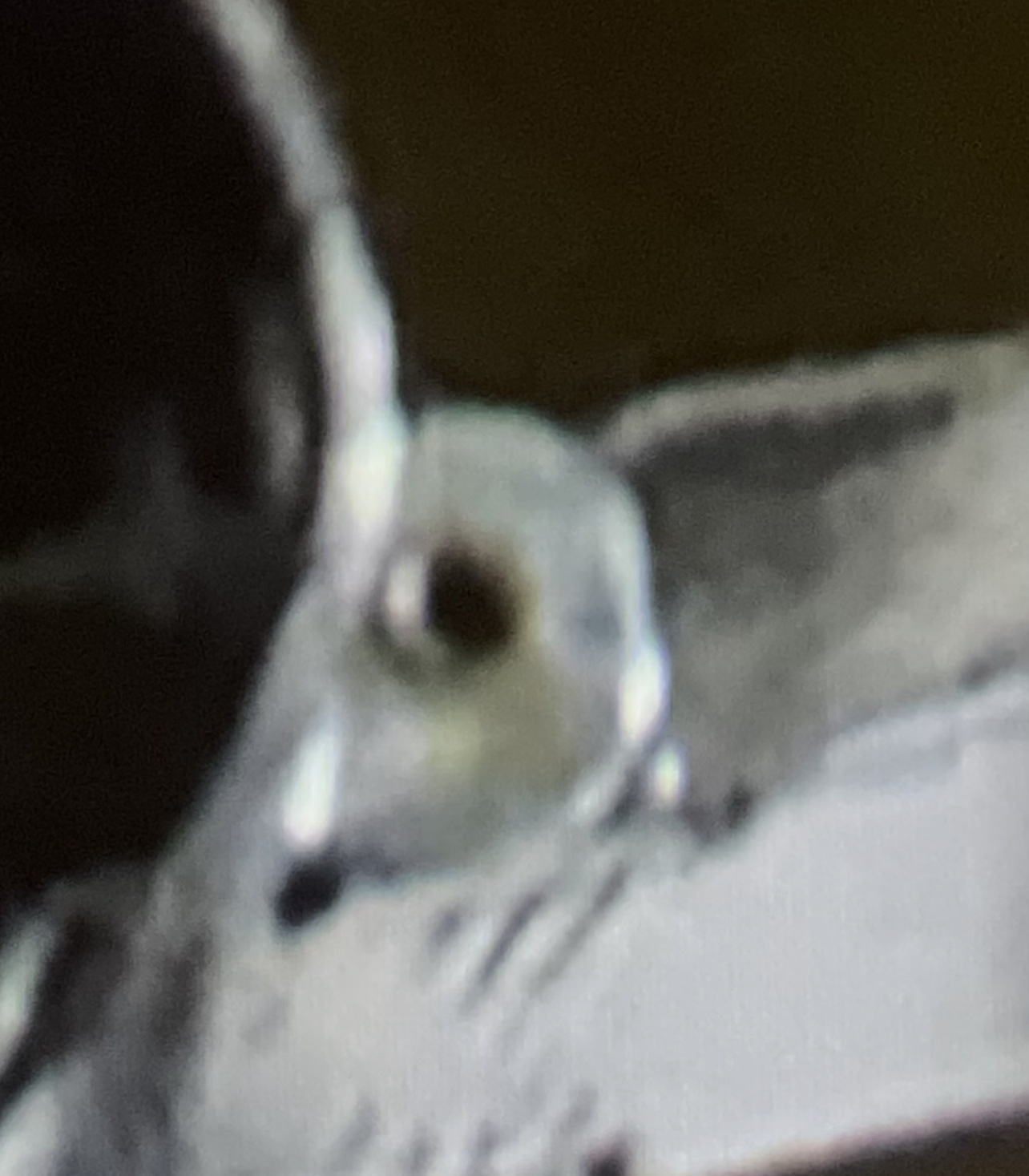

Late to the party…. I was wondering if what is holding the ears in is a “roll pin” these can be found in steel, and ironically coated in a non corrosive plating like what you see on brake calipers, cups, bolts and slide pins. Which is the same “dark gold” color
When hammered in, that gap sure be closed.. I don’t see a gap on the photos..
Curious if it’s pinched so tight we can’t see it

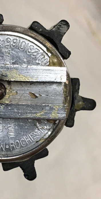

Thank you! Yes, the skywalker ranch belt hanger still has its endcap, and we can really see the difference between that and the missing lip on the bladed one!
Can’t say I see a gap anywhere here…
I really like Alleys alternative with the brass hollow tube
Could be! Wouldn’t we see a shadow going down into the top all the way instead of that weird cone shaped shadow?
Some times in my automotive experience when hammering these in, the pinch so hard, and then the elements get in there, i sometimes I don’t realize it’s a roll pin until the other side starts coming out and I see the seam
I don’t think this is the case on the ranch saber.. I don’t see a seam.. but it’s a possibility I guess
Actually, what I'm seeing that is interesting is that the lip looks ground down a bit on the ranch saber in a similar way to which your 2-cell looked when you started machining off the lip
Oh my gosh, great eye! Yes… it looks like when I just started to grind the lip. What the heck were they doing?

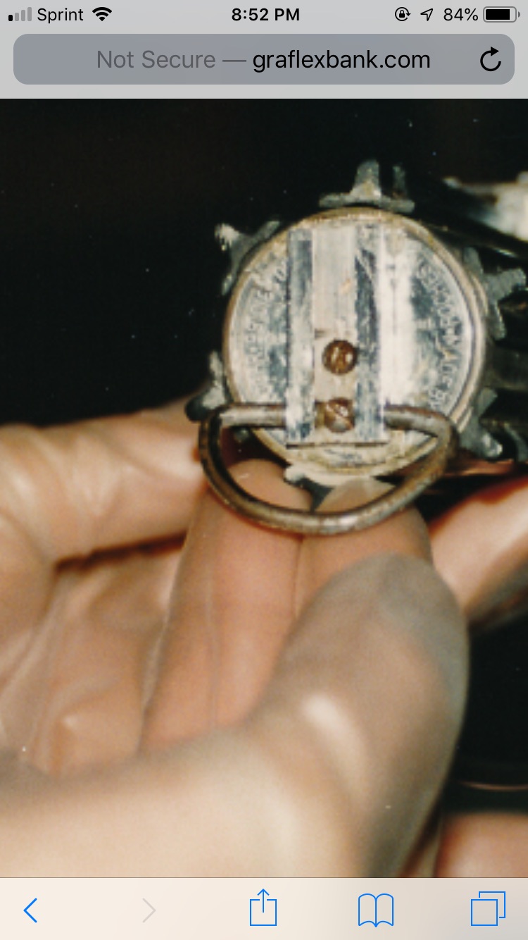

Another good shot of the end, from those unpublished photos from original prop blog
I’m of the opinion now that they put the endcap back in upside down and covered it with this hand cut and painted plate
